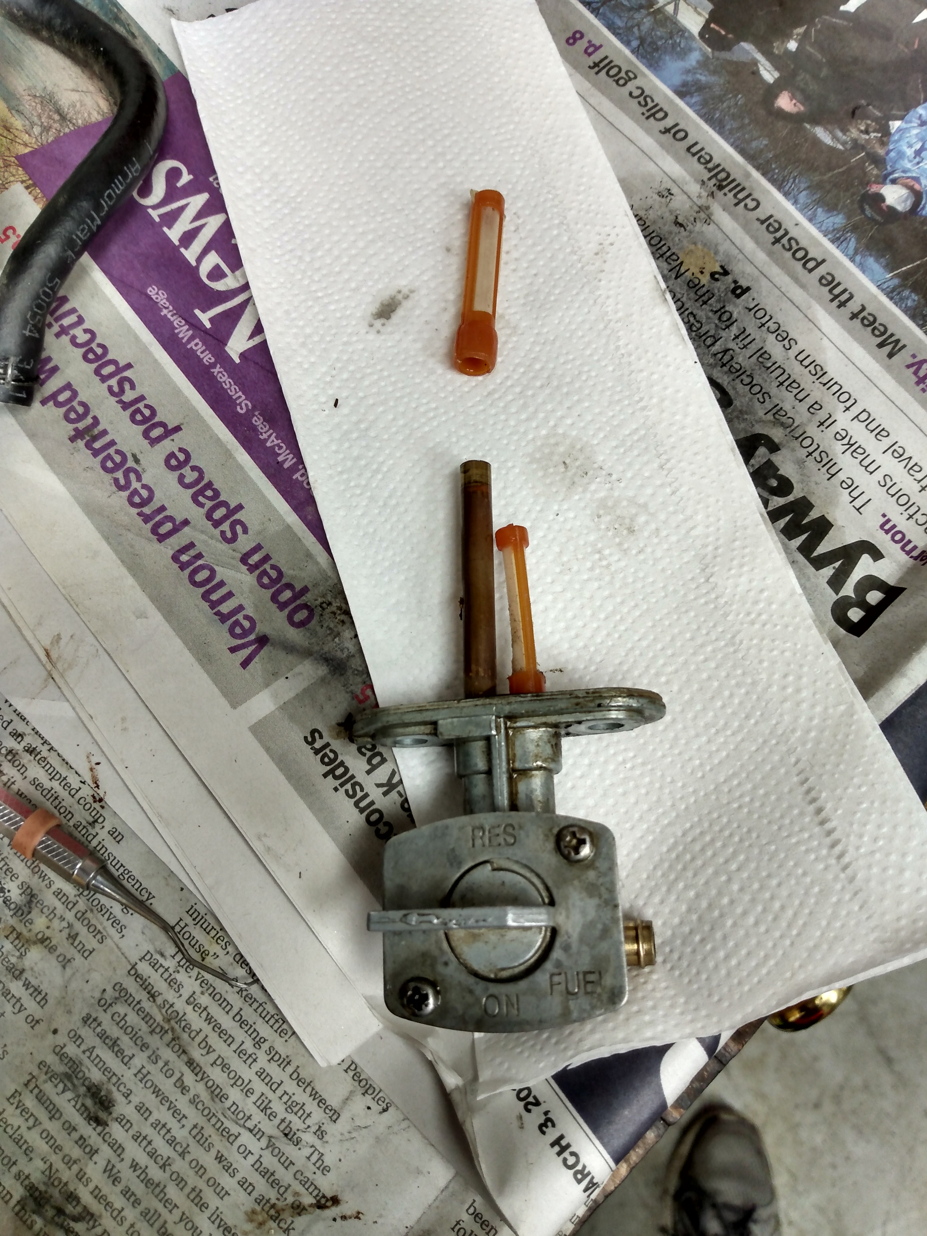

i found this the other day.
same thing happened to the one on the kz750 which i used jb weld to re-attach.
i bought some loctite stik n seal gas & oil & will try that for this one.
just a heads up for anyone using this petcock. probably not if but when
Edited 3/12/21
I tried the loctite stik n seal.
Didn't work for me.
Used the original 2 part jb weld epoxy for the repair
'02 kdx220, '01 drz470e/sm, '04 drz434s, '02 fxst, '80 kz750
Re: The infamous KDX petcock
so the plastic part broke off?
- Posts: 32
- Joined: 01:22 pm Feb 18 2017
- Country: usa
the filter for the "on" feed fell off.
when that happens, unfiltered fuel is coming into carb..
AH, OK! I see now. Thank you.
