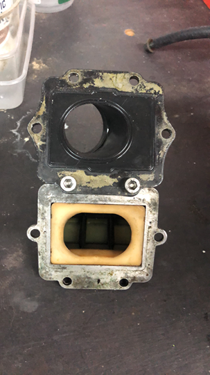

Thanks! The dyno run topped out at 22 hp at the rear wheel. With a mid range lean spike that we couldn't jet out. There's also detonation under load at high revs when riding on the dirt (didn't show up on the dyno bench). I just found out there was a mismatch between the E series manifold and the C series reed block. The two apertures don't line up (with potential sealing issues). The E series manifold mouth is offset, C series reed hole is centred. So I've put in an E series reed block and am hoping this was the issue.

This mismatch. Just found it by accident when servicing the top end.

Ah, gotcha, yea can visually see the difference there.
