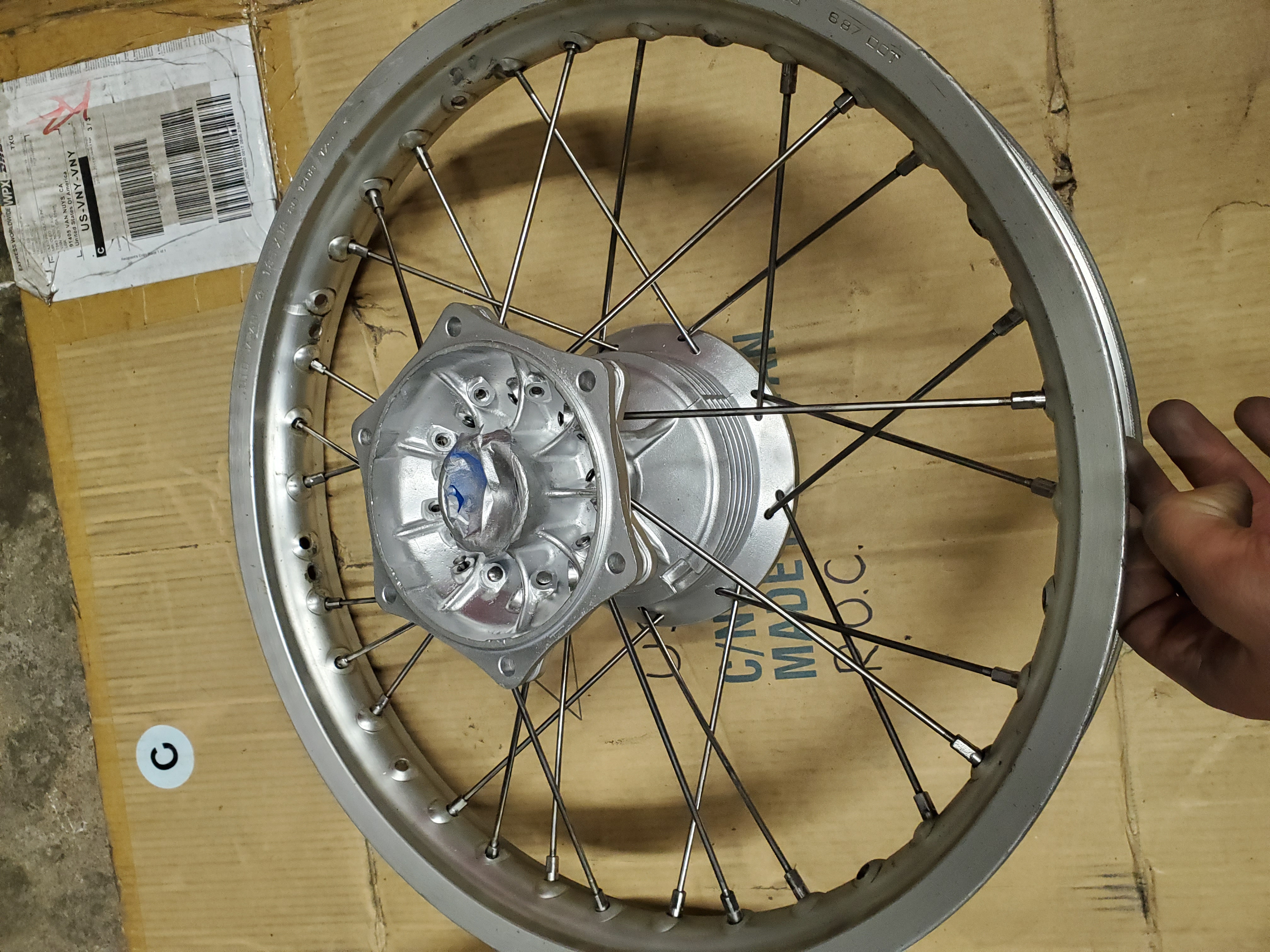

Little bit of an update on the Build:

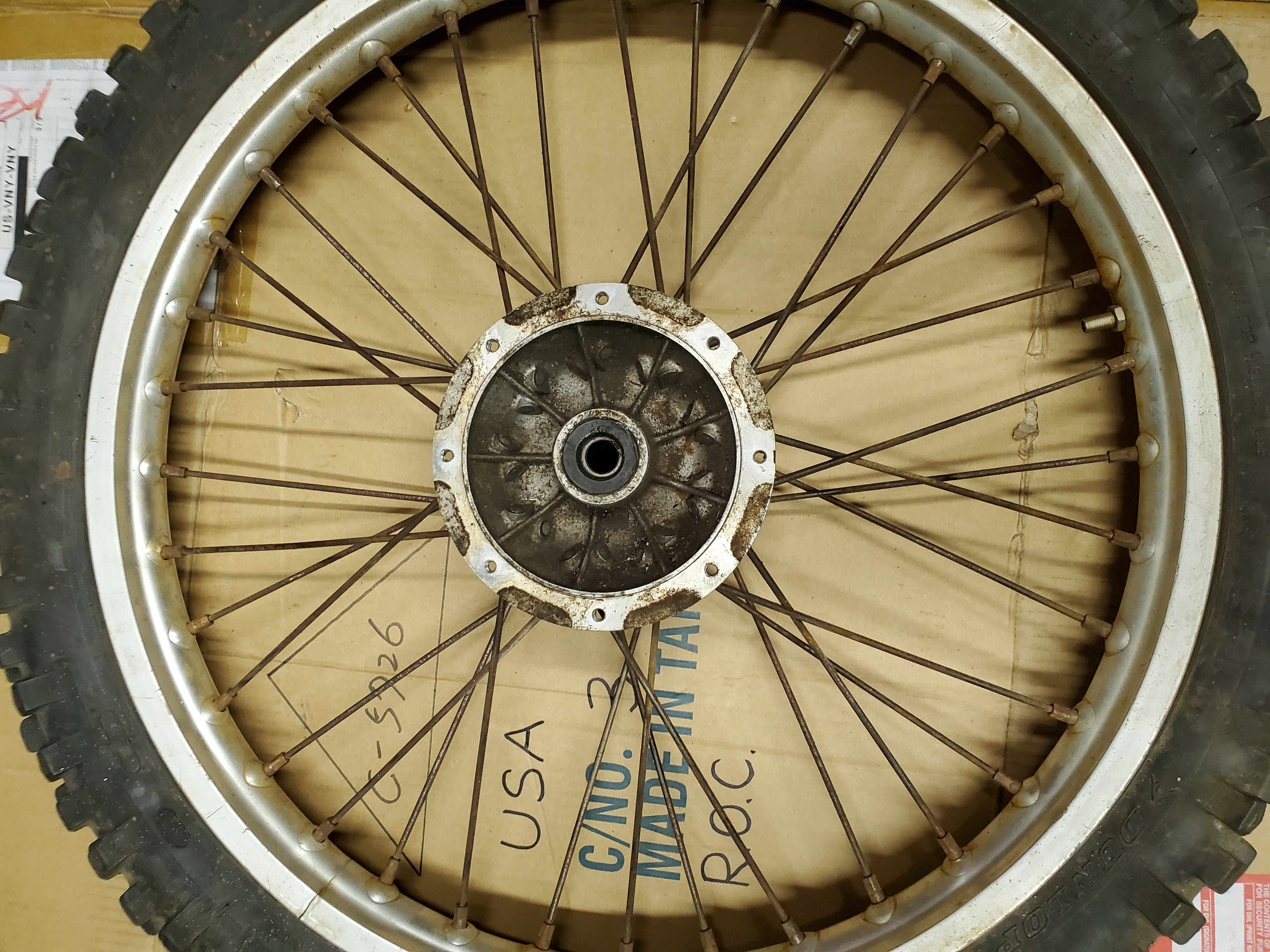

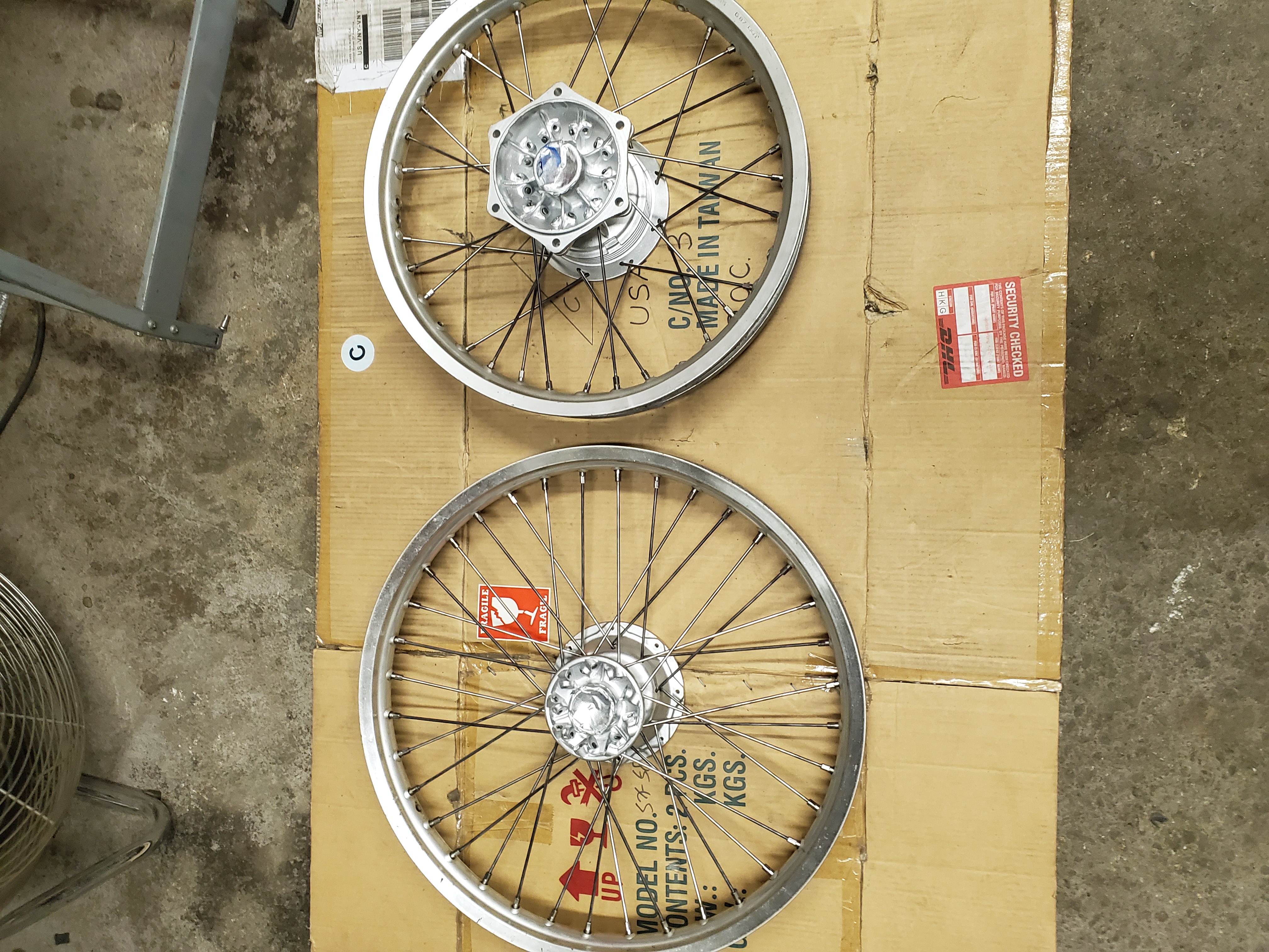

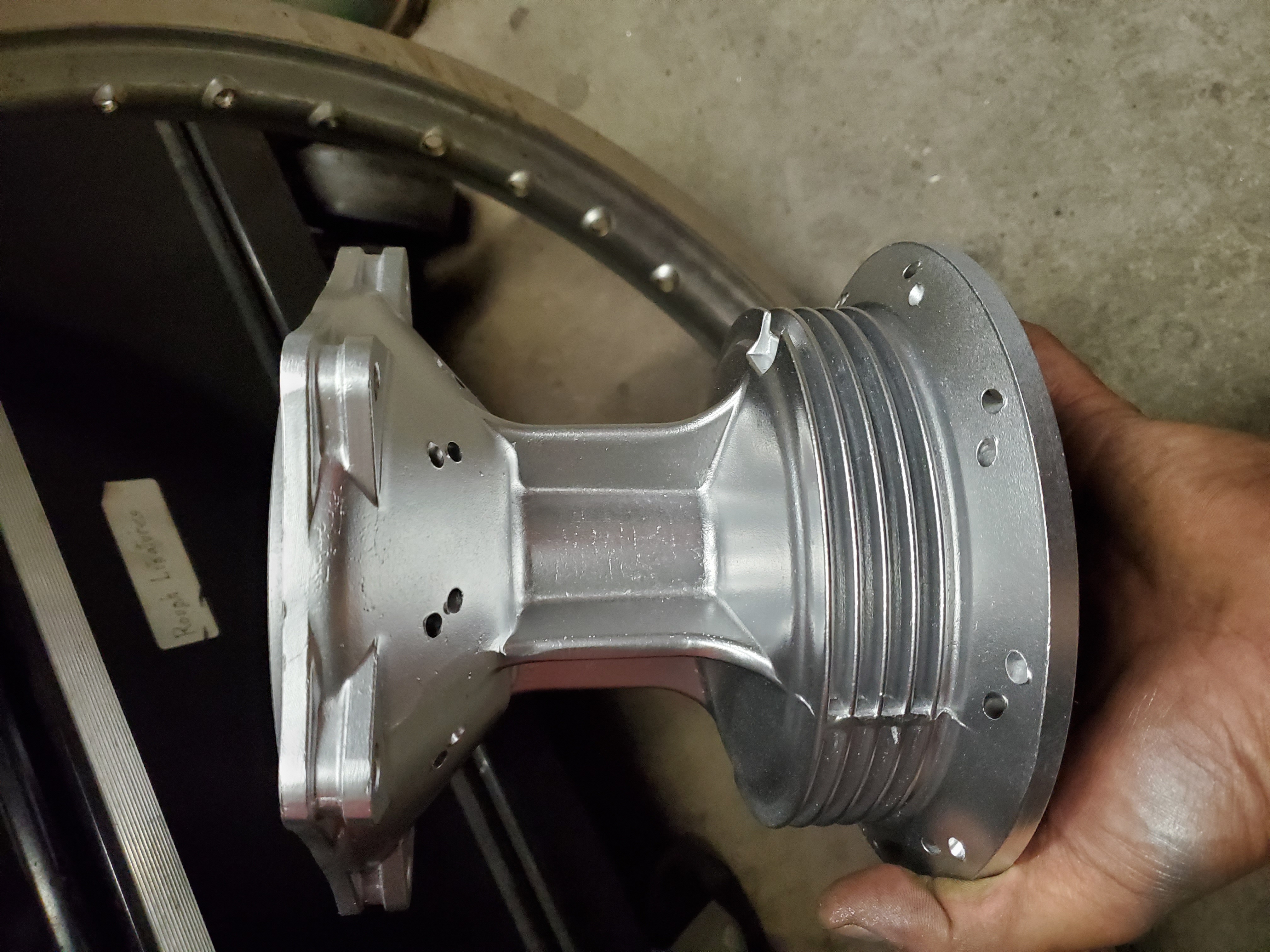

I managed to source enough spare spokes and nipples from a fellow KDX enthusiast on ebay to continue forward with the project. I decided to try wire wheel and polish each of the spokes and nipples since I had already started down that road. **WARNING** do not ever try and attempt that because it is a huge time suck and can be endlessly frustrating. Better off just buying all new spokes and nipples or for that matter just get new rims. I did save some money but I probably spent more time than I should have and lost money in that area.

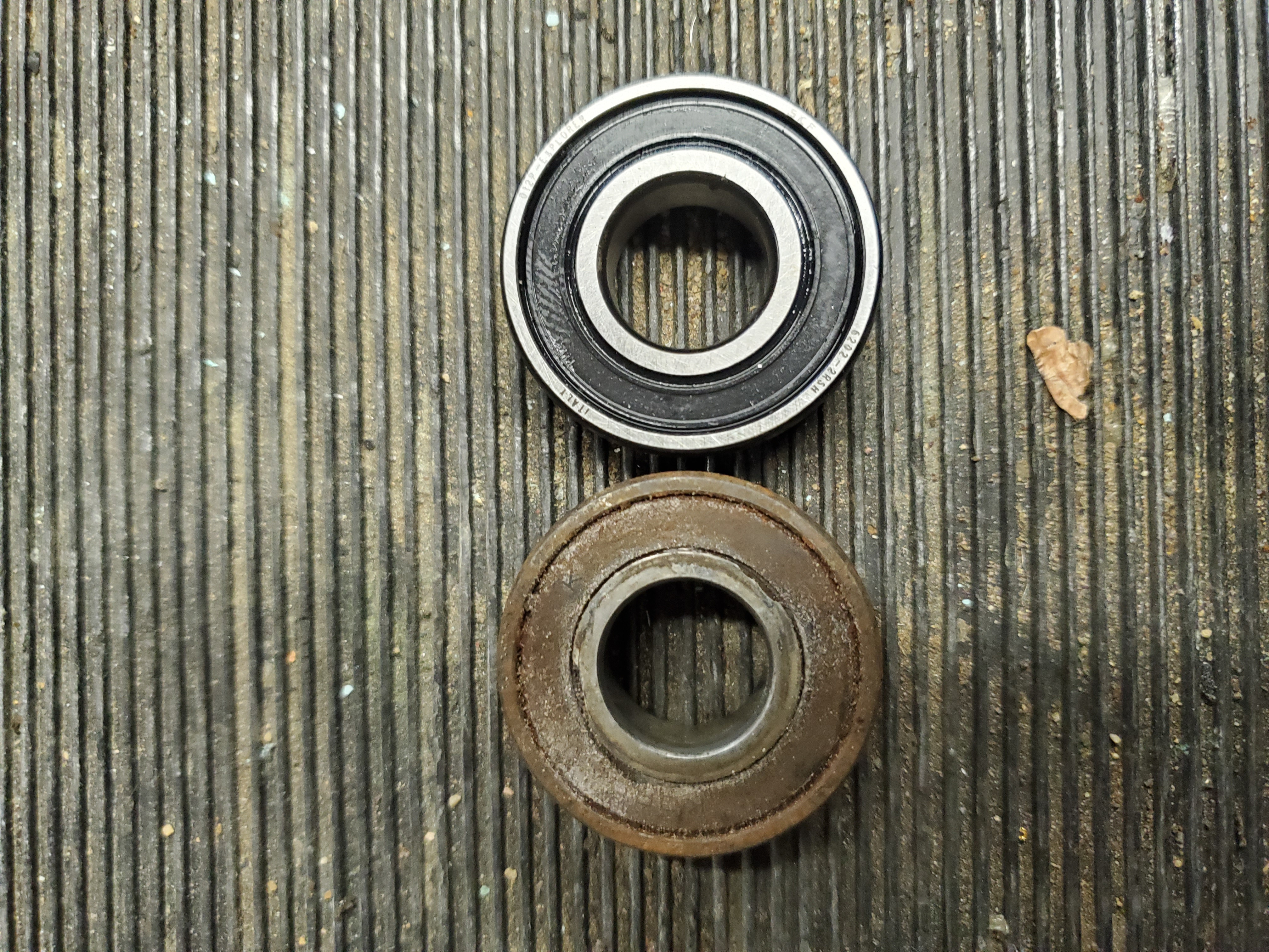

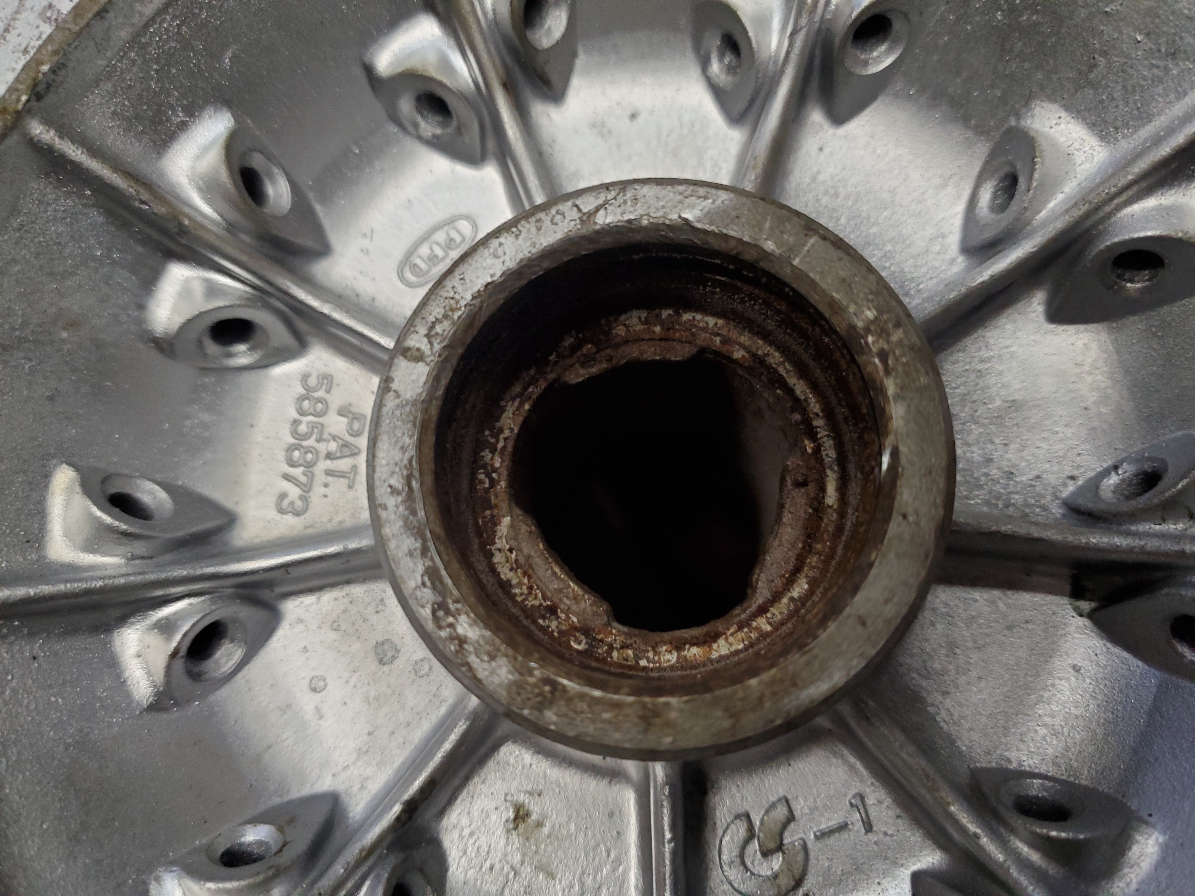

Removing old rusted bearings has got to be one of the most frustrating, time consuming, and lack luster parts of a build that I can think of. There is zero glory in it and it just feels like you are a complete idiot when the damn things won't come out. I had to "manufacture" some of my own tools and devices for the project because using punches, hammers, an blind bearing pullers just wasn't working too well. I would definitely suggest soaking the hubs in a tub of WD40 or penetrating oil overnight and then using heat on the hub if you think that the bearings might be rusted. These KDX hubs can be a real struggle...

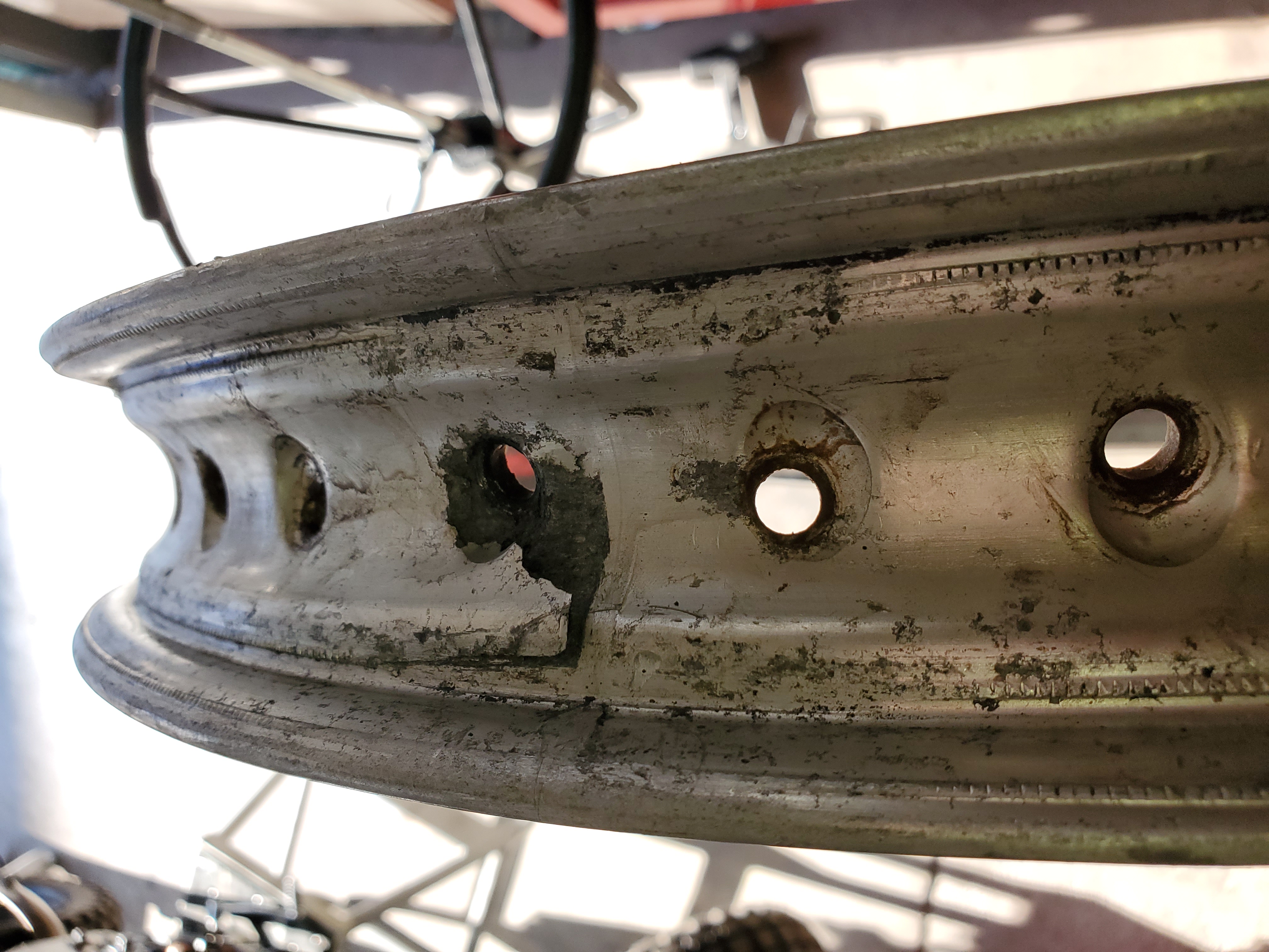

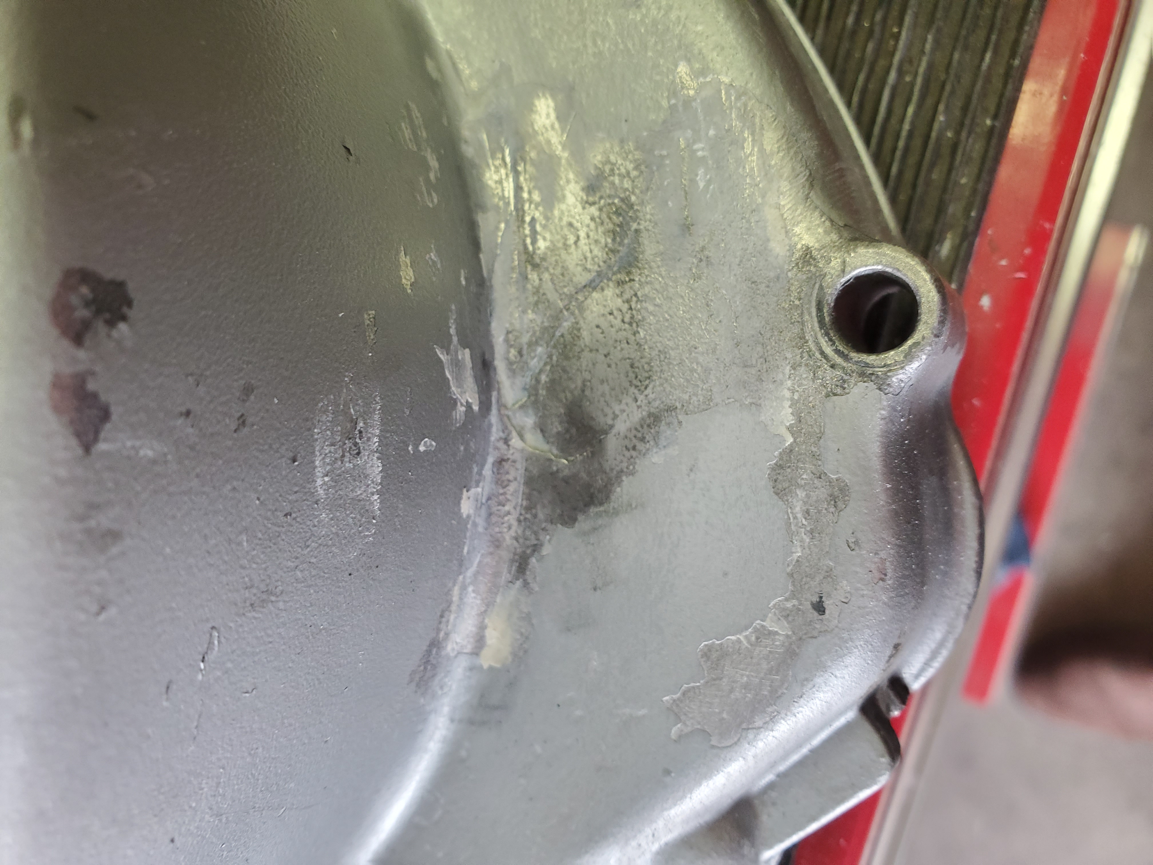

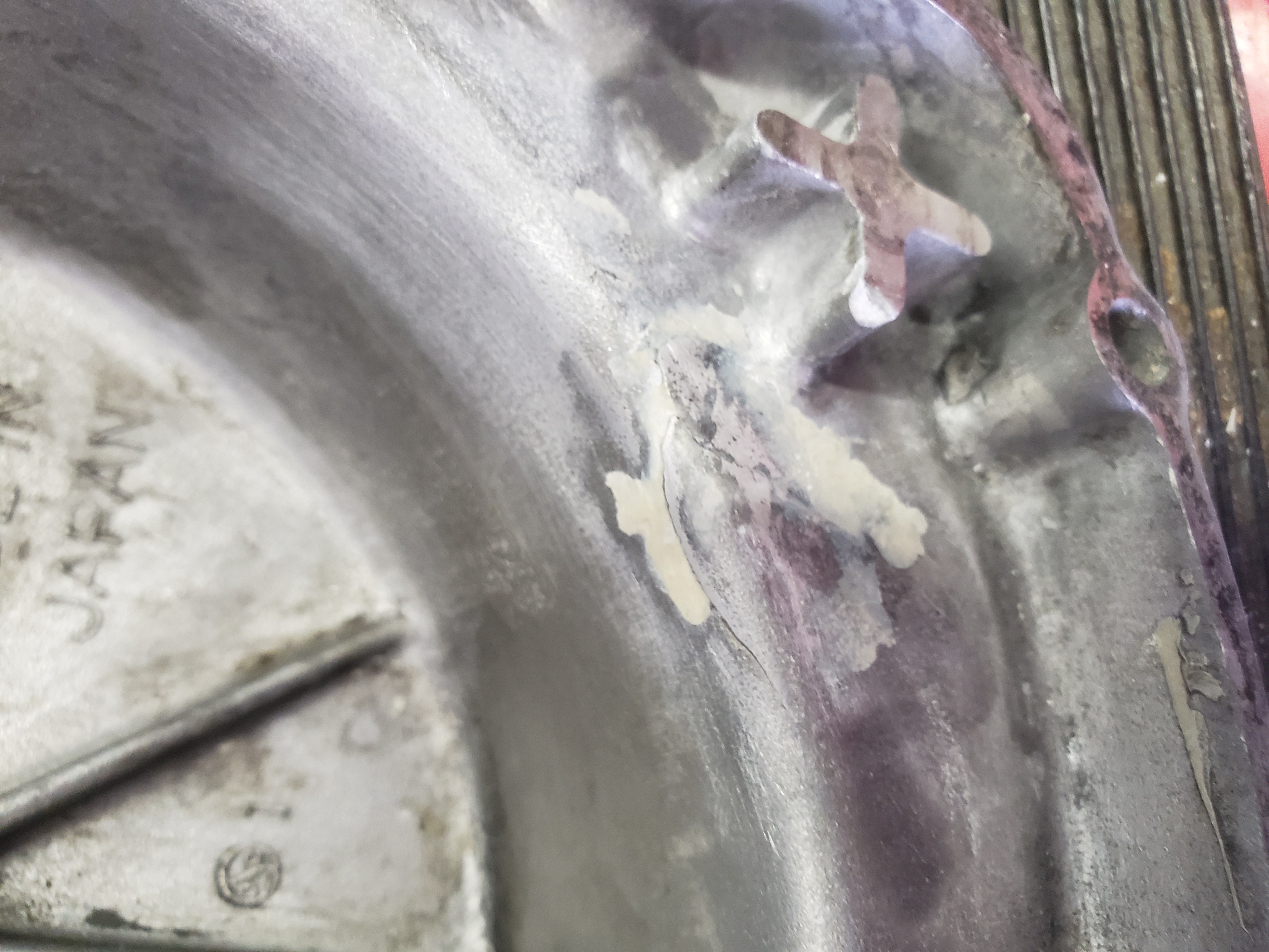

I also ran into an issue putting on the clutch cover where I decided to try and use my press to "gently" put it back on the last bit of the way and cracked the case. I attempted to patch and conceal the crack only to have it split even worse when I was tightening the bolts down the next time I tried it. Looks like now I have to buy a new clutch cover or have a welder repair it. Either way its a huge PITA and was a real motivation killer.
Hoping to have this thing on wheel soon and hopefully have the engine on the frame. The last part of this will be finishing up the original seat and trying my hand at coming up with a decent paint job using spray cans. I know... spray can jobs don't look good on plastic. But I've done enough research and had enough success in the past to where I think I can actually pull it off and am more curious to see how it turns out.

- Lets not even get started on how hard bearing replacement was
- 20200924_223056.jpg (4.21 MiB) Viewed 6767 times
- 20200928_221759.jpg (3.63 MiB) Viewed 6767 times
- what the original front rim looked like w rusted spokes
- 20200928_200641.jpg (3.66 MiB) Viewed 6767 times
- Finished product after way too many hours polishing
- 20200928_221754.jpg (4.28 MiB) Viewed 6767 times
- Hub spray painted with Duplicolor chrome
- 20200909_221155 (1).jpg (3.06 MiB) Viewed 6767 times

- cracked clutch cover after some metal filler
- 20200911_121259.jpg (3.08 MiB) Viewed 6767 times
- inside of the cover
- 20200911_121306.jpg (3.16 MiB) Viewed 6767 times
- Rust and dirt inside the hub that I had to fight
- 20200924_223100.jpg (2.99 MiB) Viewed 6767 times
- chipping inside the rim
- 20200905_173550.jpg (2.96 MiB) Viewed 6767 times
Re: 1988 KDX200 build thread : The gift that keeps on giving (me headaches)
Lots of fun!
I hope you chunked that rim onto the recycle pile. :-)
I actually decided to keep the rim since it didn't seem to have structural damage, I shaved the broken bit down and reinforced the section with metal filler. If it cracks then oh well.. more curious to see how this things holds up. I'm trying to see how to keep costs down while on this project since I just keep running into issues that are getting more and more expensive and I've still got to deal with painting the plastics and doing all the electrical components.
That is right by the rim weld, which has a crack on each side. GULP!!

As for the rim, I know that its on borrowed time. Won't be doing anything too wild on this bike for the time being and I'll probably upgrade both rims after this is all back together. But for now it is what it is.

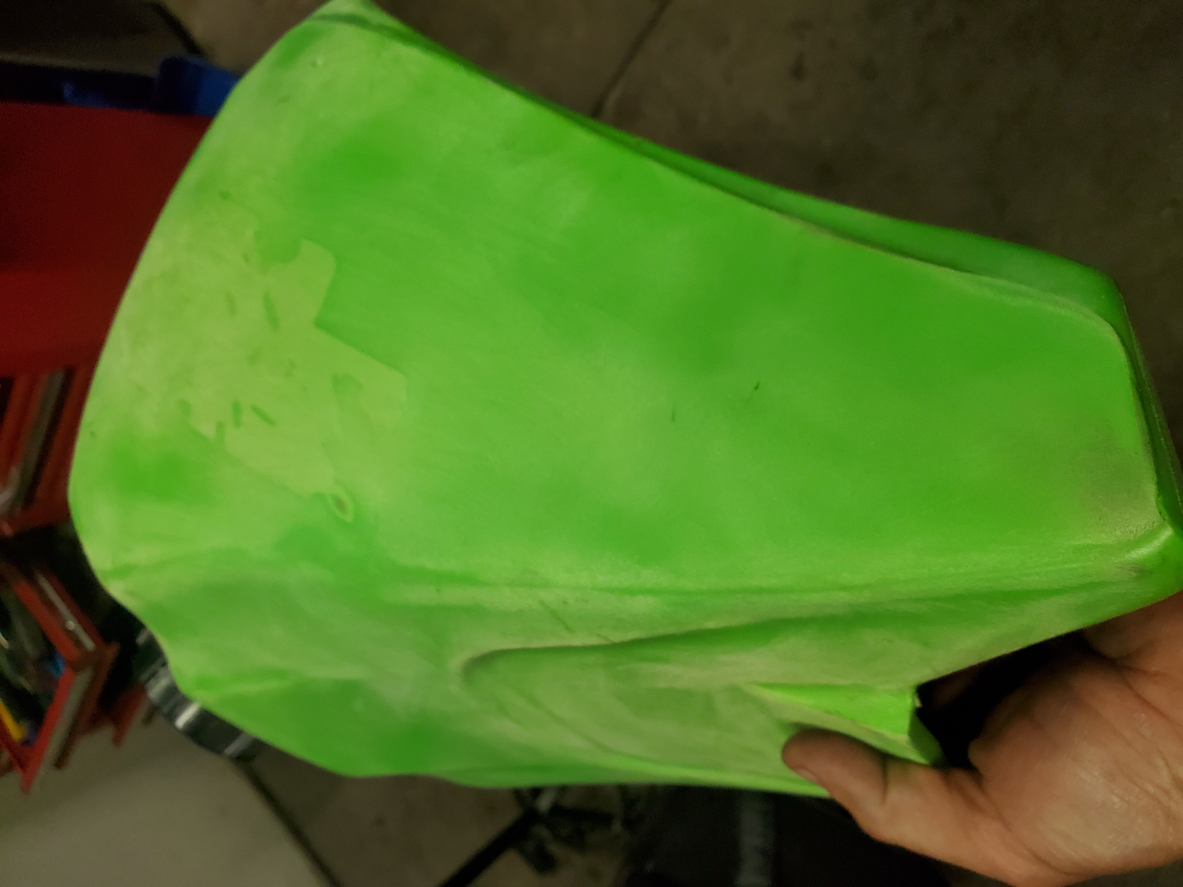

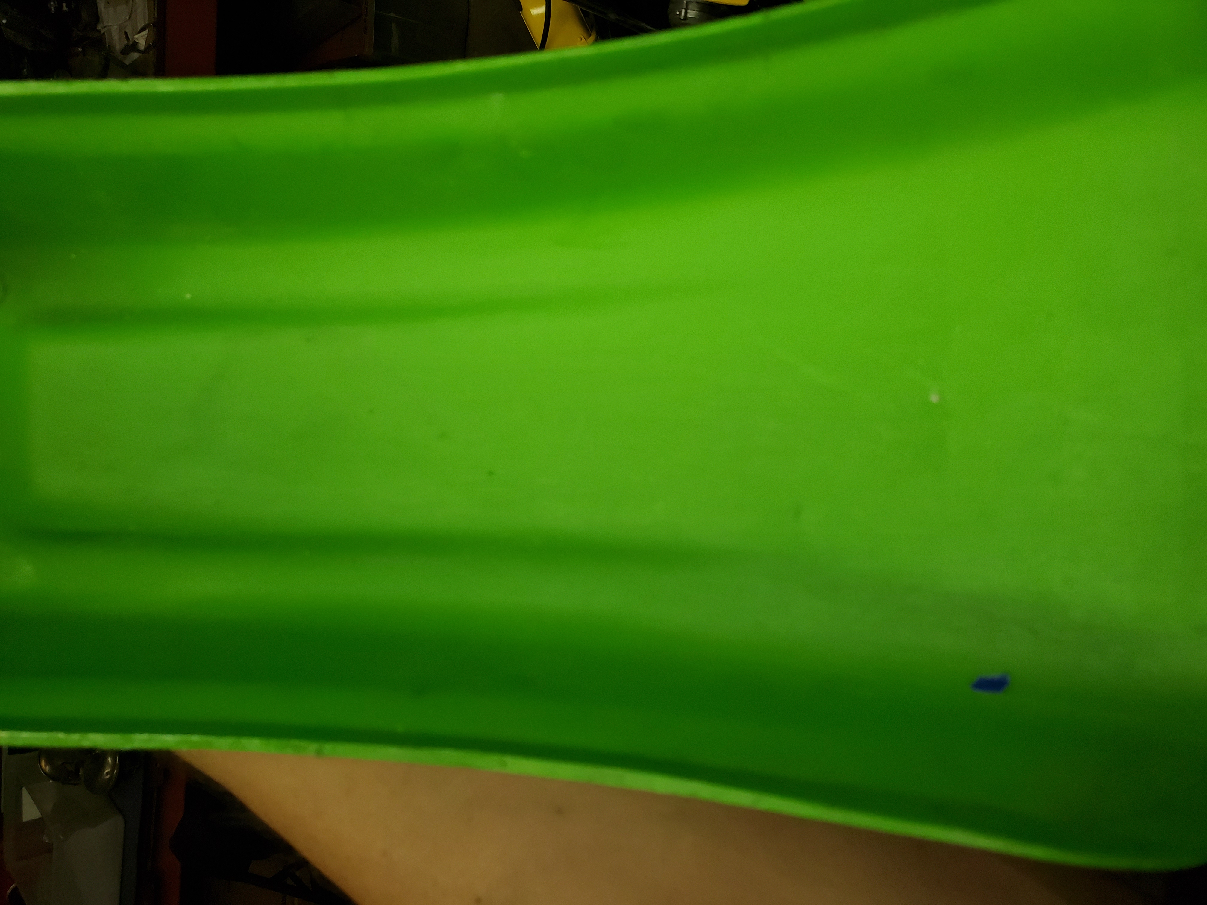

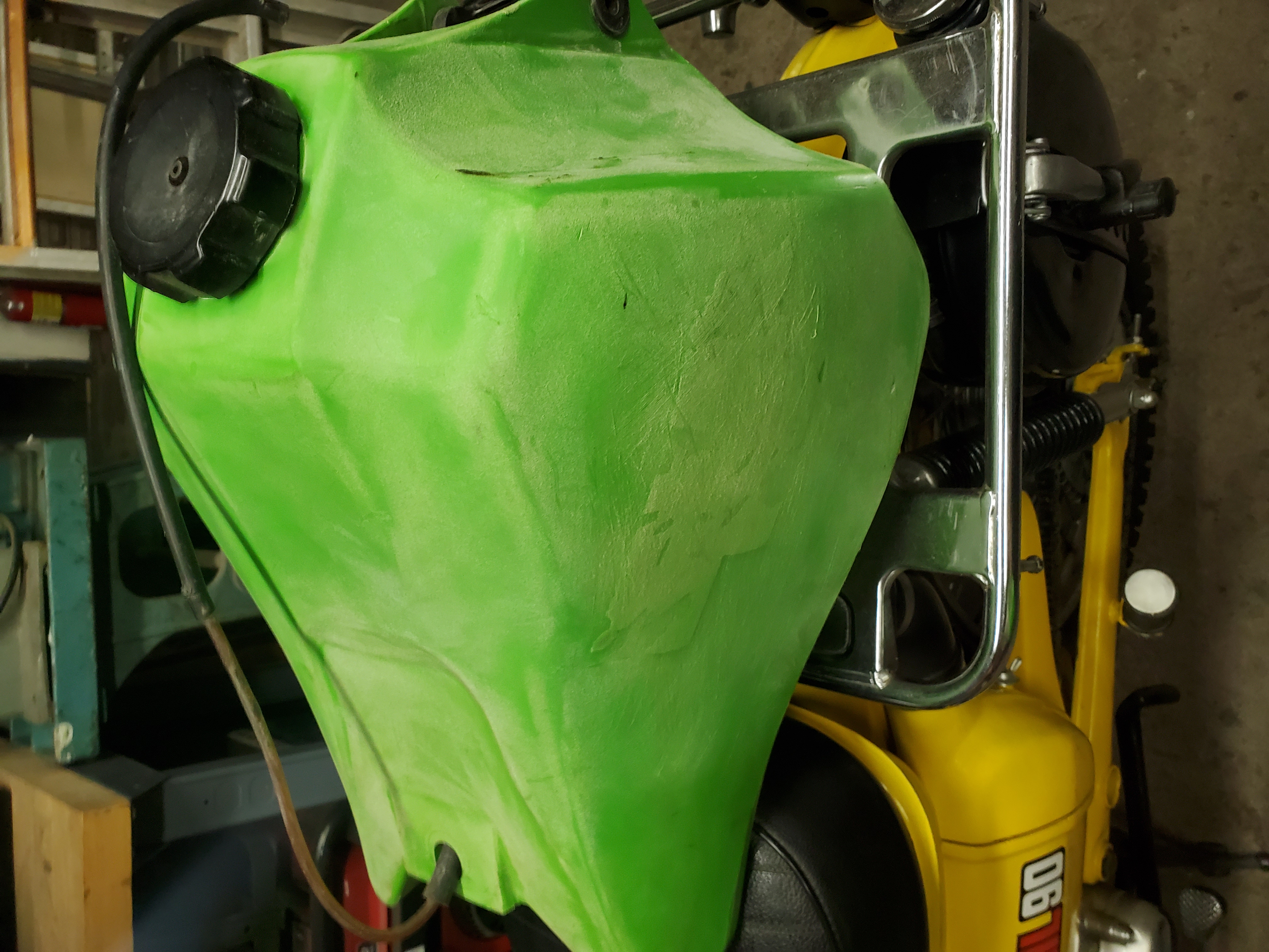

Just to give some idea about the condition of the plastics. The gas tank has been sanded down to 80 grit and I did a light bit of buffing on with the scotch brite pad. The different is minimal and I don't think the pad is going to cut it.

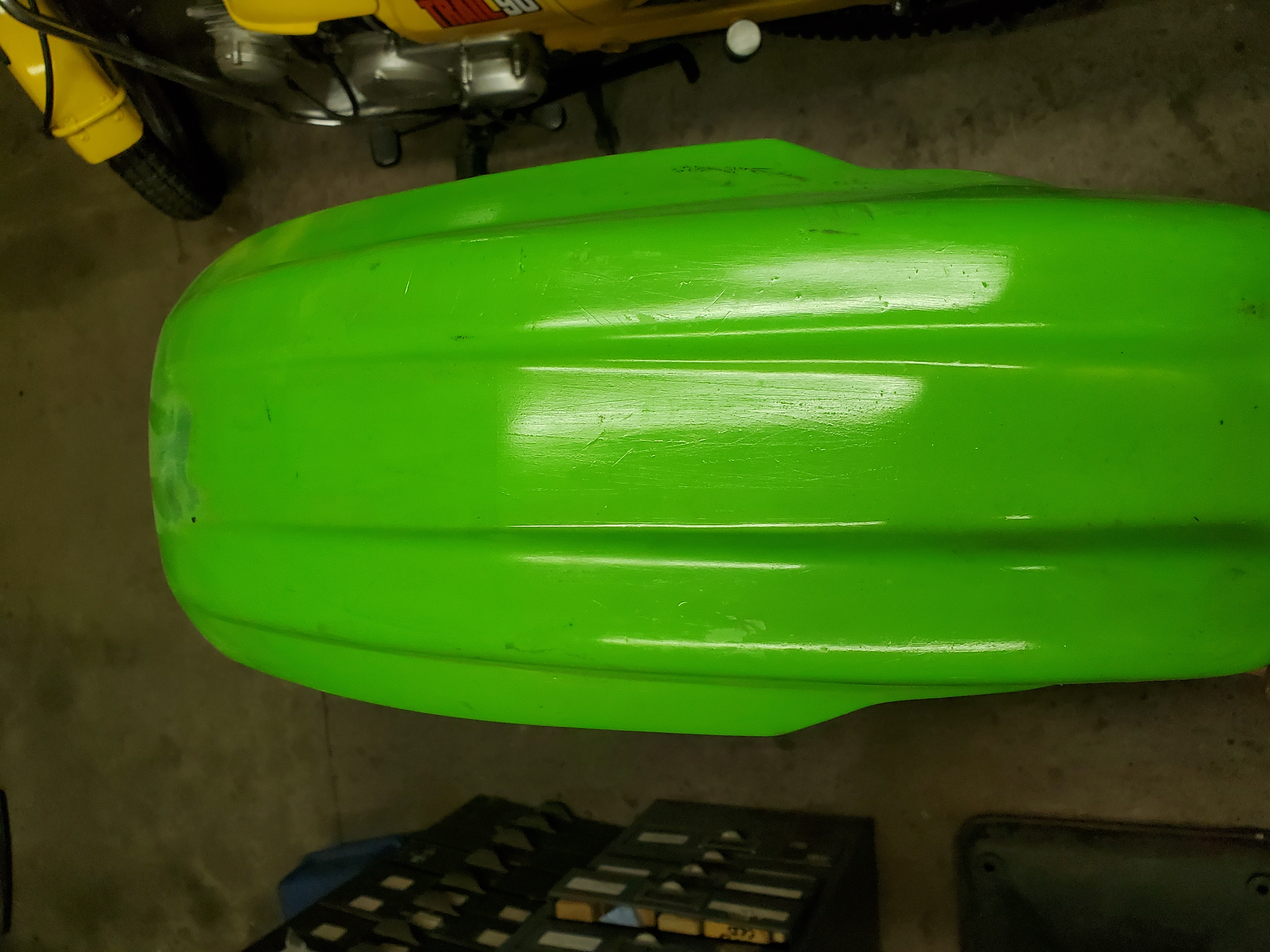

The front fender was painted with a spray can duplicolor engine enamel green once upon a time back in the early years of this build. The result was pretty damn good IMO considering there was not much prep effort put in and just adhesion promoter, primer, and the paint with clear.
This time around I plan on using SEM specific flexible primer , along with evercoat flexible filler to patch up uneven spots, and sealer. I'll probably go with a JP kawasaki green spray color and then finish it all off with Spraymax 2k clear coat gloss.
If it looks halway decent and shiny I'll take it as a win. I don't think spending hours on the polishing wheel or attempting to buff these plastics is going to look good or be worth the time.
I could always buy new plastics but... The thread is titled as such for a reason. I'm a glutton for punishment.
- 20201014_210445.jpg (3.54 MiB) Viewed 6714 times
- 20201014_210428.jpg (3.17 MiB) Viewed 6714 times
- front fender painted with duplicolor engine enamel spray can paint.
- 20201014_210421.jpg (3.82 MiB) Viewed 6714 times
- Plastics un painted
- 20201014_210410.jpg (2.99 MiB) Viewed 6714 times
You might want to watch the youtube video of the guy working on a red tank. He started with 220, then went to finer and finer grits.
As an initial step, I have used a razor blade to scrape off the outer plastic surface with excellent results. Just have to lean the blade backwards a little so it scrapes and doesn't cut into the surface. You gotta' get all that white oxidation off.
As K-Gar proffered, using progressively finer grit paper will get all the sanding marks out. My final effort included wet sanding with grits as high as ?1200(or higher). Then hit it with a heat gun(carefully) for the final polish.
As far as the plastics goes, I've tried to the sanding and heat gun technique with poor results. These plastics are so bad that it would be almost impossible to get them looking uniform. The heat gun does work but has a tendency to be uneven and can cause melting very quickly.

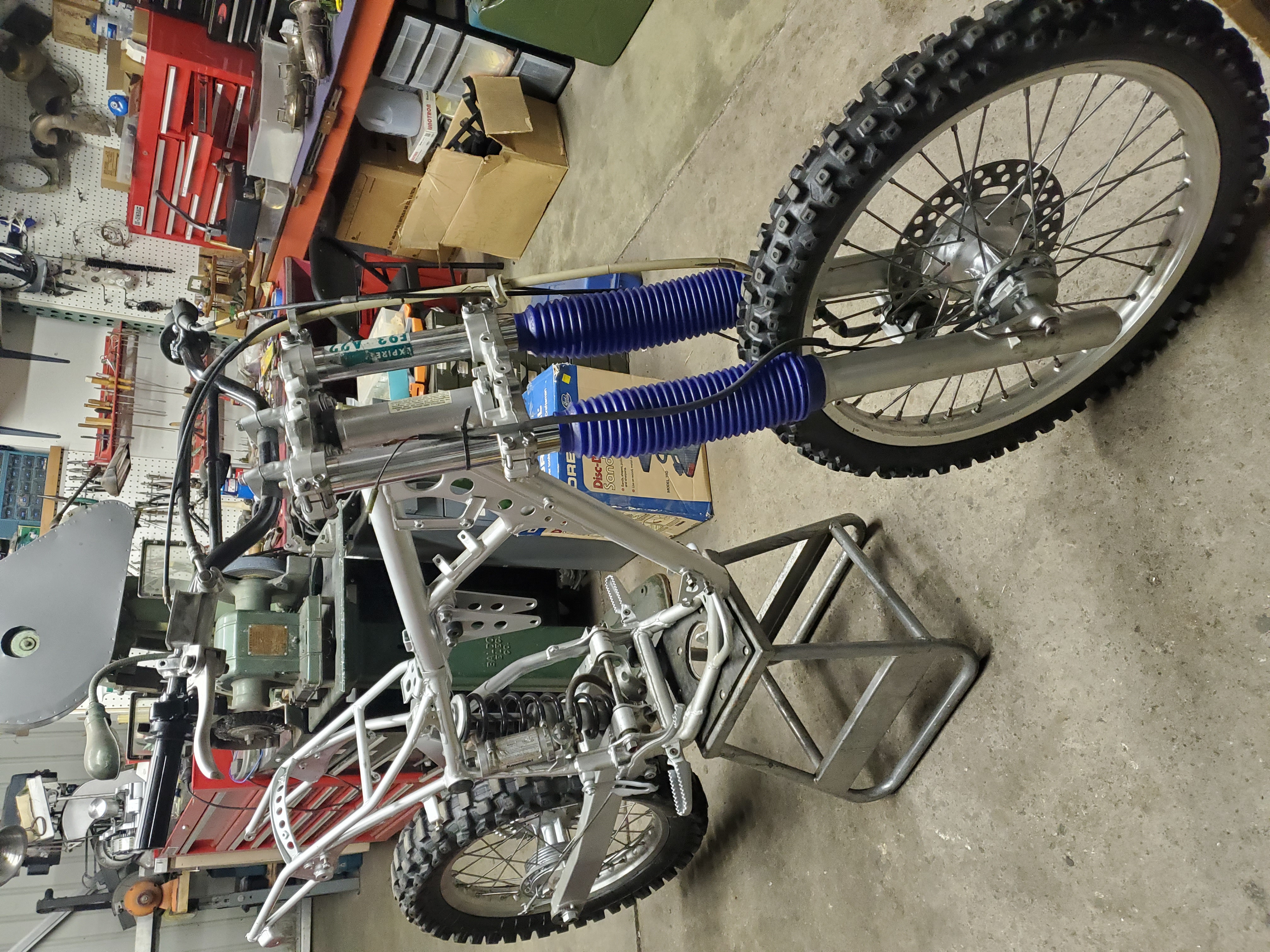

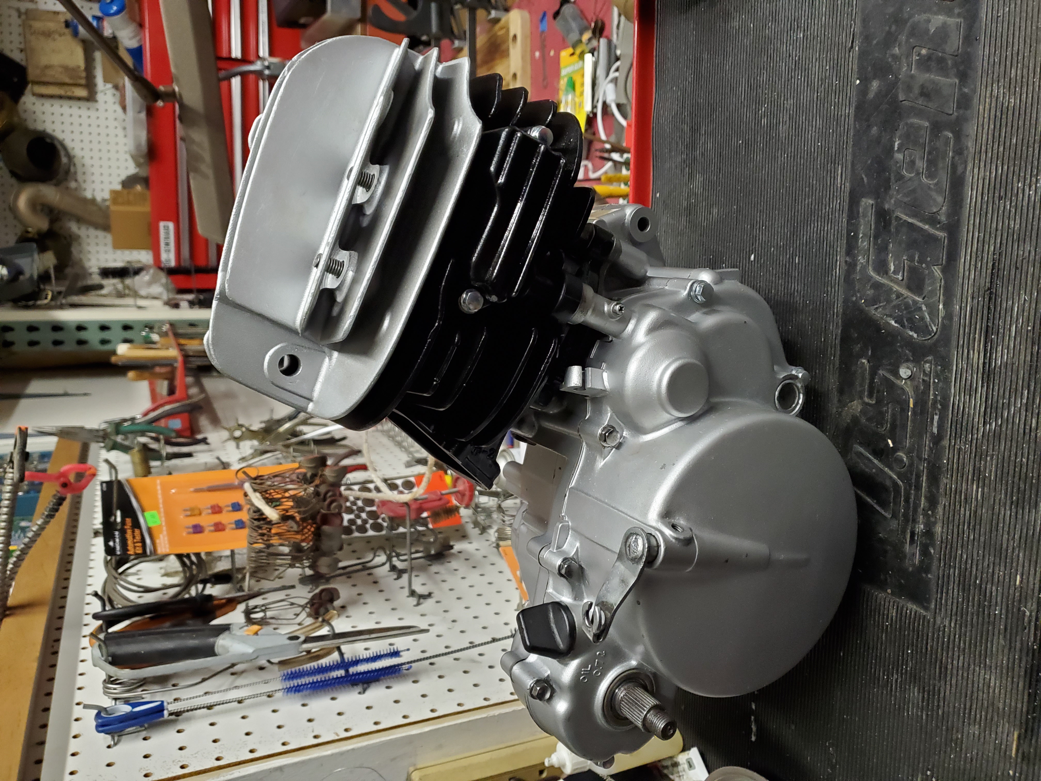

Posting some updates on my build. Finally got the engine put together and new piston in. Had some issues waiting on various parts and pieces that were missing . Will be installing the engine back on the bike over the weekend. Sending my flywheel and stator off to FRP racing because the magnets had fallen off the original . With regards to the rear brake guard does anyone know how it should be attached ? It looks like it needs a spacer or maybe mine is bent ? Ordered materials for painting the plastics and I've already laid down the primer coat on them. So far I'm real impressed with the SEM flexible primer and I'm planning to be using the Evercoat polyflex to fill in any gaps and surface imperfections. Base coat will be PJ1 Kawasaki Green and I'll be using a Spray Maxx 2k clear .
- 20201119_204404.jpg (3.79 MiB) Viewed 6556 times
- Engine finally assembled
- 20201125_202615.jpg (3.38 MiB) Viewed 6556 times

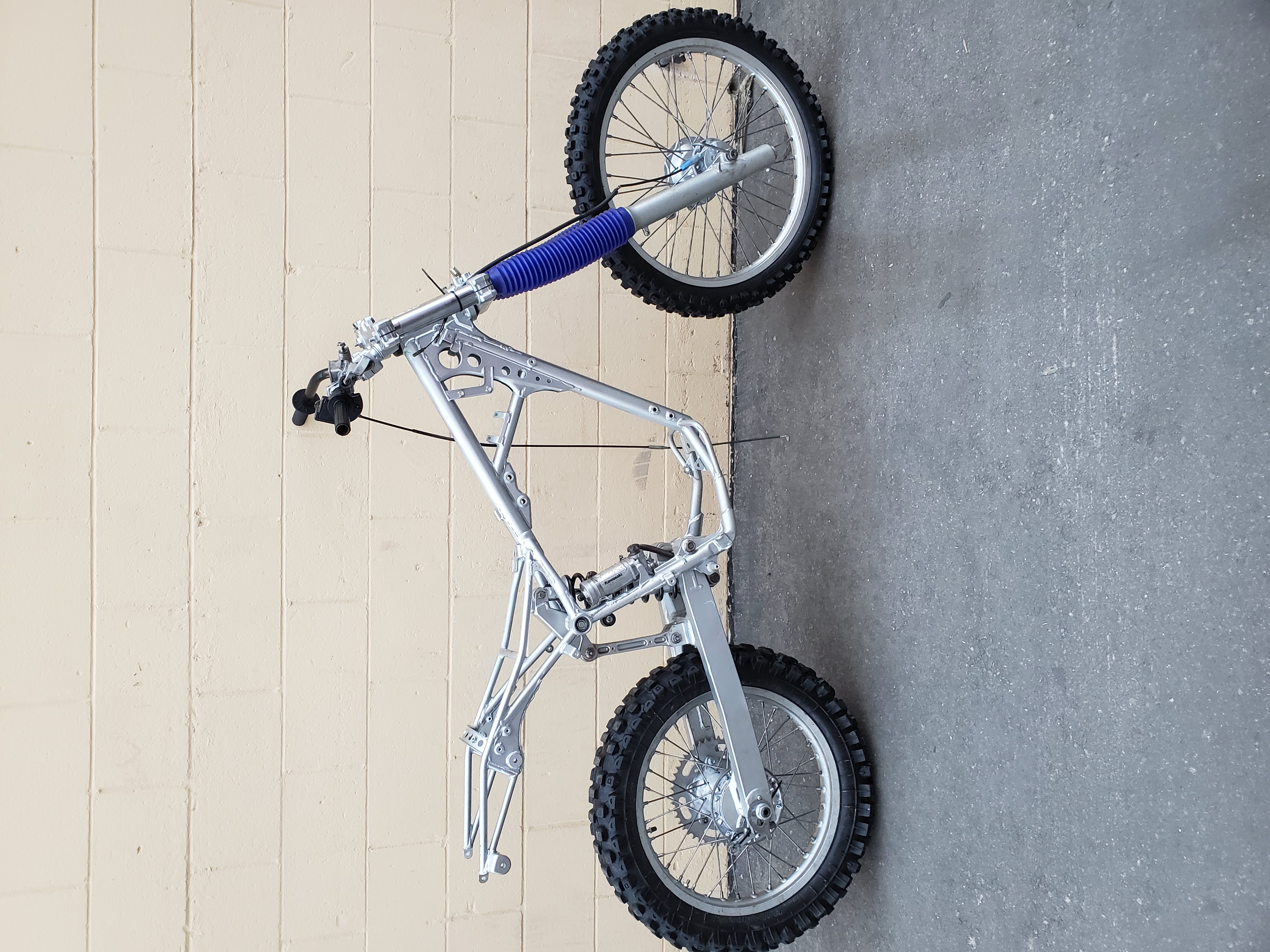

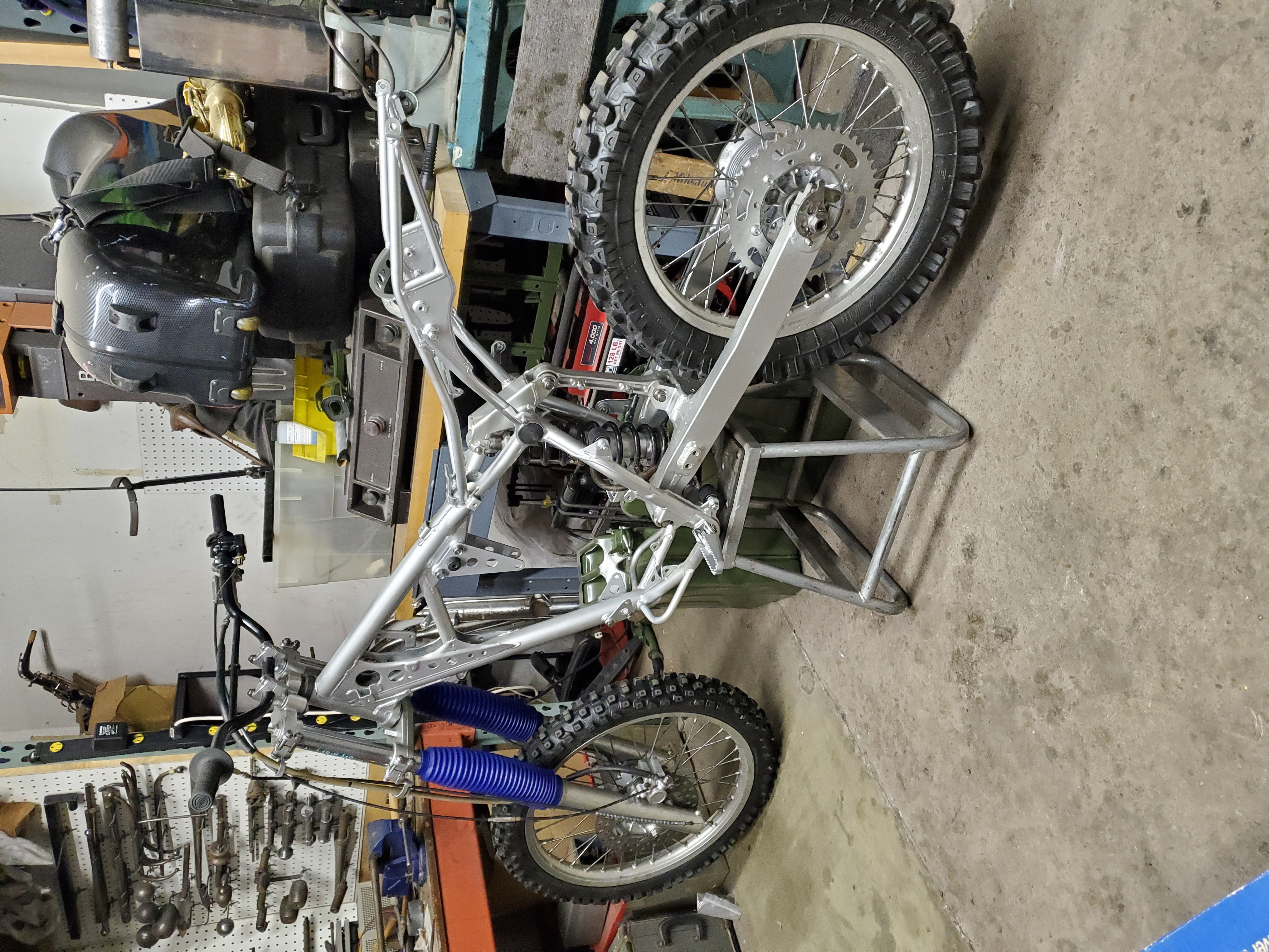

- Added more accessories and frame is 90 % complete
- 20201119_192156.jpg (4.05 MiB) Viewed 6556 times
- Finally a bare bones roller
- 20201024_174459.jpg (2.93 MiB) Viewed 6556 times

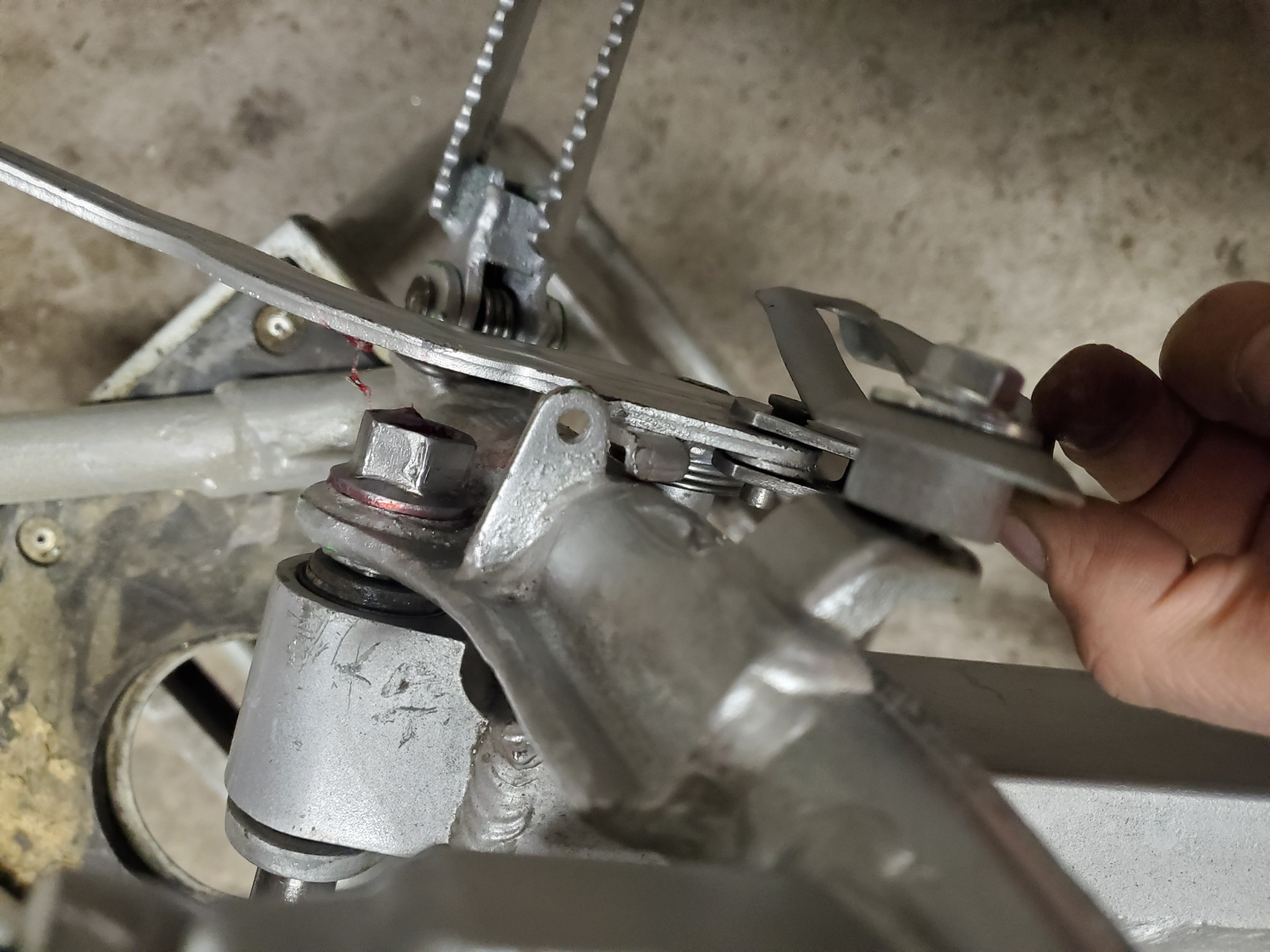

Looking good. Here's a pic of someone who did an Armor All restoration.
EDIT ADD ON: Please note that the bolt head hits the top of the brake pedal, not the end of the bolt as the Armor Aller did.

Thank you for picture KDX Garage . I've seen the exploded view diagrams and just wondered why I was seeing a gap between the portion on the top. It occurs to me that my bike may have the wrong part or a part from an earlier year...
Oh yeah! Some previous owner / Mr. Goodwrench may have "laid hands on it".

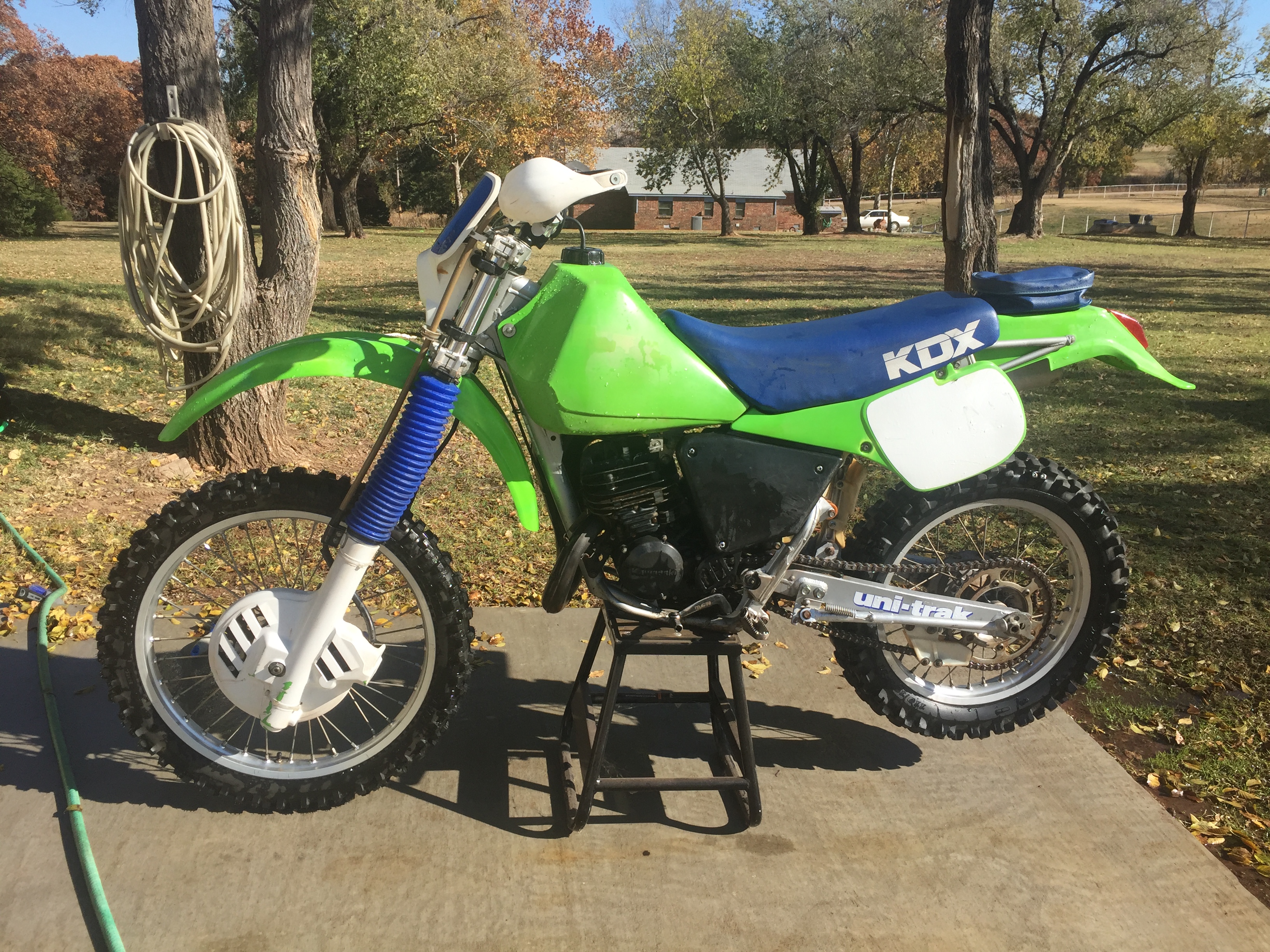

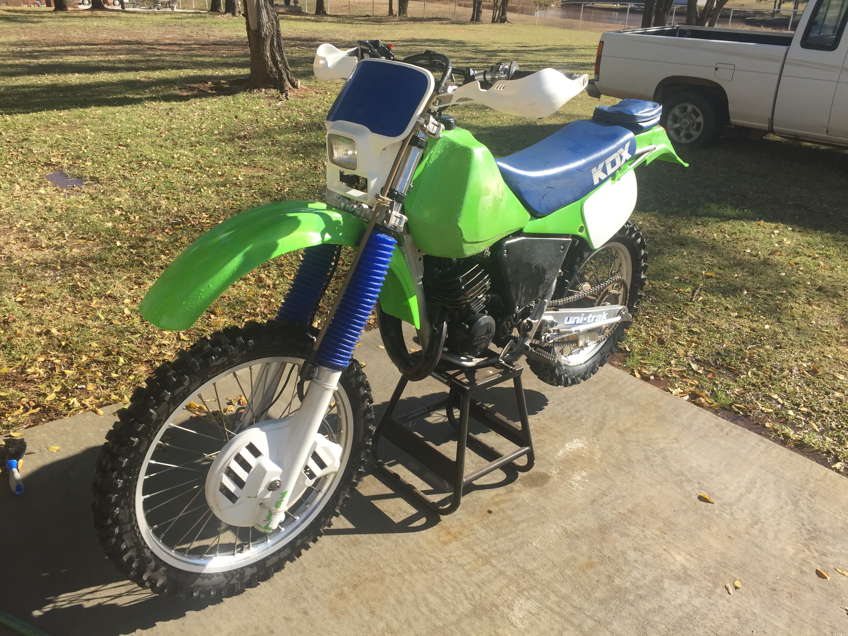

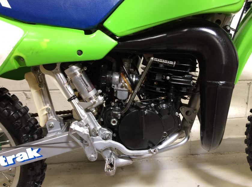

Here’s a couple of pics of my 87. You’ll have a lot of fun with yours when you get it done. Mine is stock other than a shock revalve and has been extremely reliable. It also draws a lot of attention on the trails. Everyone seems to have fond memories of these old bikes.
