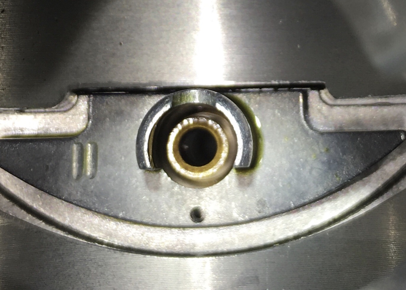

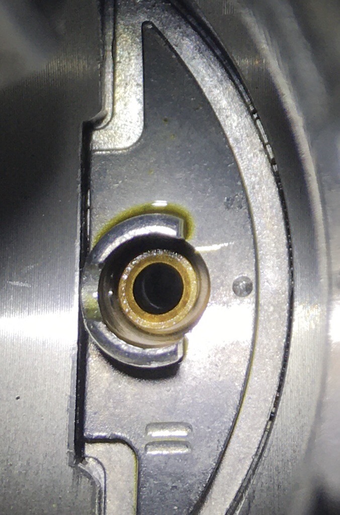

Not sure how this forum stuff works, not sure sure if I should start another thread or just keep posting on this one. Still waiting on case splitter and was looking things over and doing research. Came across jetting issues and the needle jet being oblong. So I took a few pics of mine. Took a bunch trying to get something worth posting on here. Not sure if this one is out of round, shadows or just my old eyes.

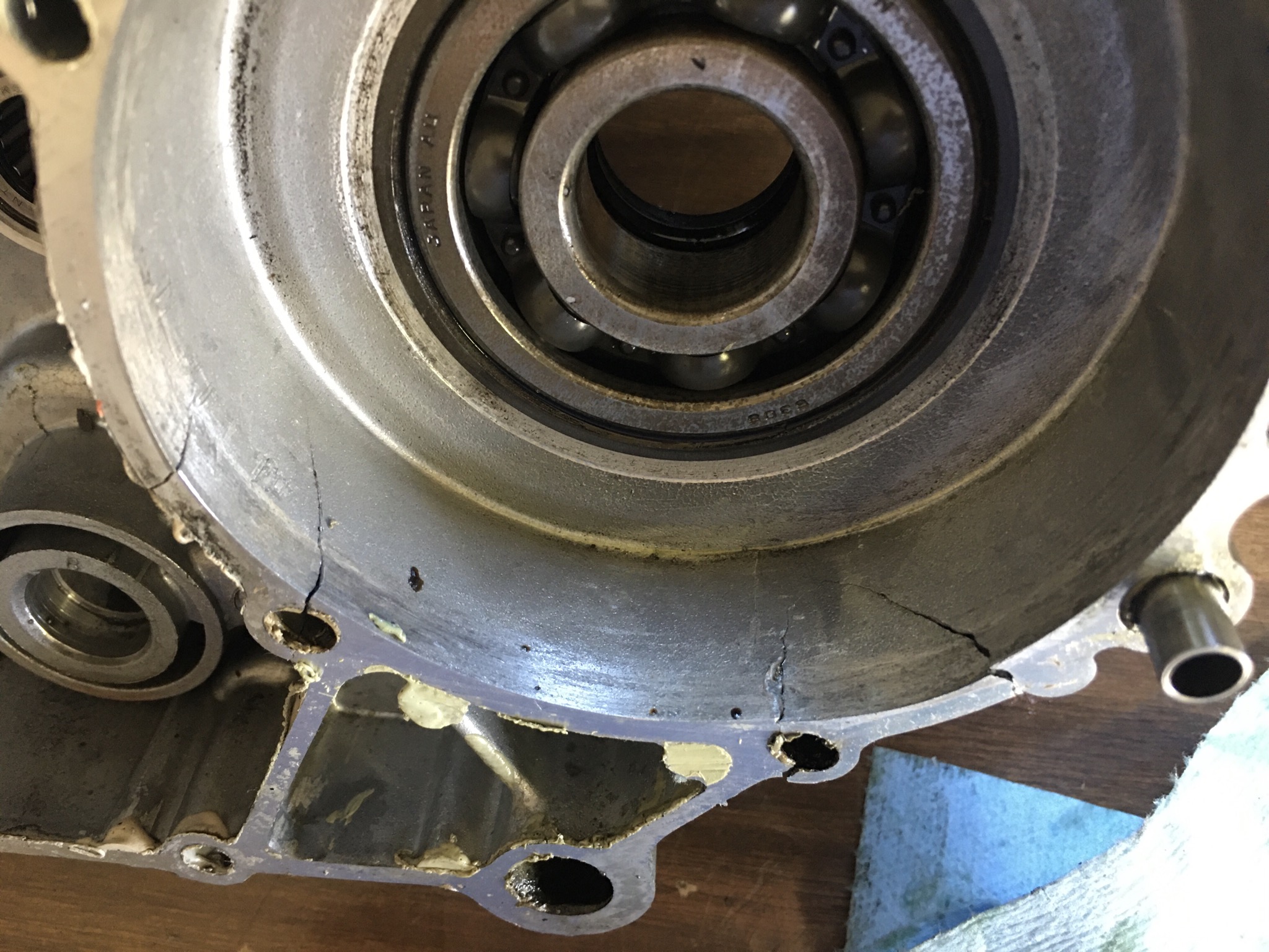

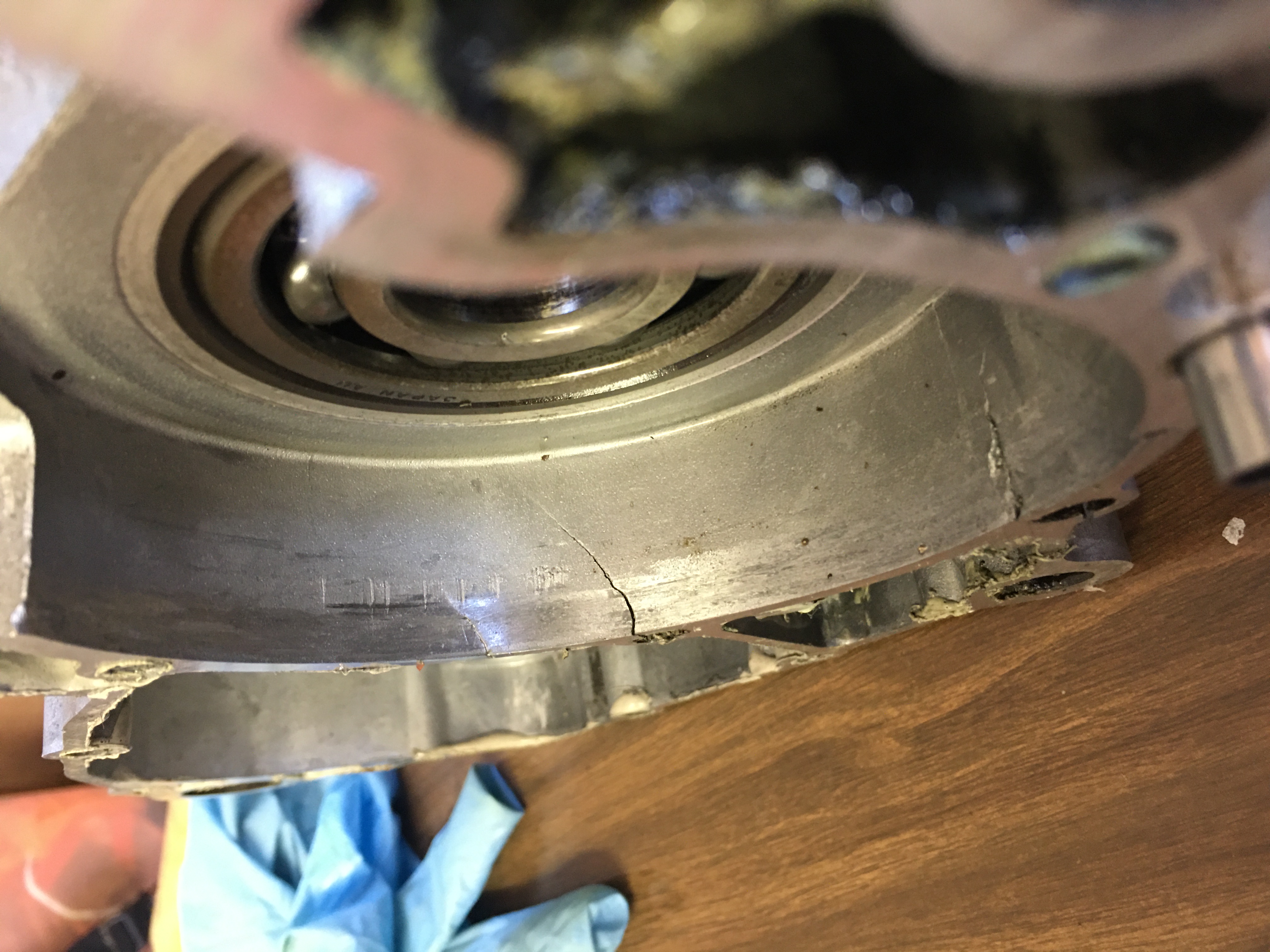

Finally got lower end split and it looks bad to me. But I don’t weld for living so maybe there is hope. Once I get this bottom end sorted out I’ll be looking to perform the mods mentioned. Thanks for the advice

- Posts: 3553
Re: Case repair?
IIWM I'd be looking for new cases rather than welding it up, as it appears it will need some machining afterwards. Those are major cracks and it should probably be subjected to a dye penetrant inspection as well. Interesting drag marks in there looks like something (a 220 OEM piston perhaps?) came apart and attempted to stop the crank from spinning so fast. Ouch...

I’m thinking The same thing, just bite the bullet and buy new case Halfs or a good set of used ones. Don’t want to do this again if it’s botched. PO said the top end had about 10 hours on it. Probably should’ve said 10 hours ago the stock piston flew apart. After being misled on every bike I’ve purchased, it’s going to be hard to take someone’s word on used cases. This forum seems to be full of good advice and honest people. I’ll post that I’m looking for engine cases on here and see what pops up. Thanks again everyone

Wow really sorry to see that. You bought it like this?, How did it run when you went to look at it and test ride it. I am amazed it didn't seize up with the 2 cracks at the front of the case, was there any sealant over the front cracks? was possibly sucking oil from the tranny too...

Ouch! Bearing is rusty, too.

Wow, that's bad. I would definitely replace and not attempt to repair that. Sorry my man.

It might be repairable, BUT... time and trouble considered, end result and finally price and total benefit comparison...
just shop for a set of used halves. People are still parting these out on eBay. Check craigslist and Facebook Marketplace (Letgo, etc.) for a parts bike.
I am sorry you got lied to by a POS PO.

That really sucks. Even if it’s welded there’s a high chance it could crack again. Looks like someone torqued the case bolts to 60 ft lbs and said “that ain’t going anywhere.” Find some used, matched case halves.
