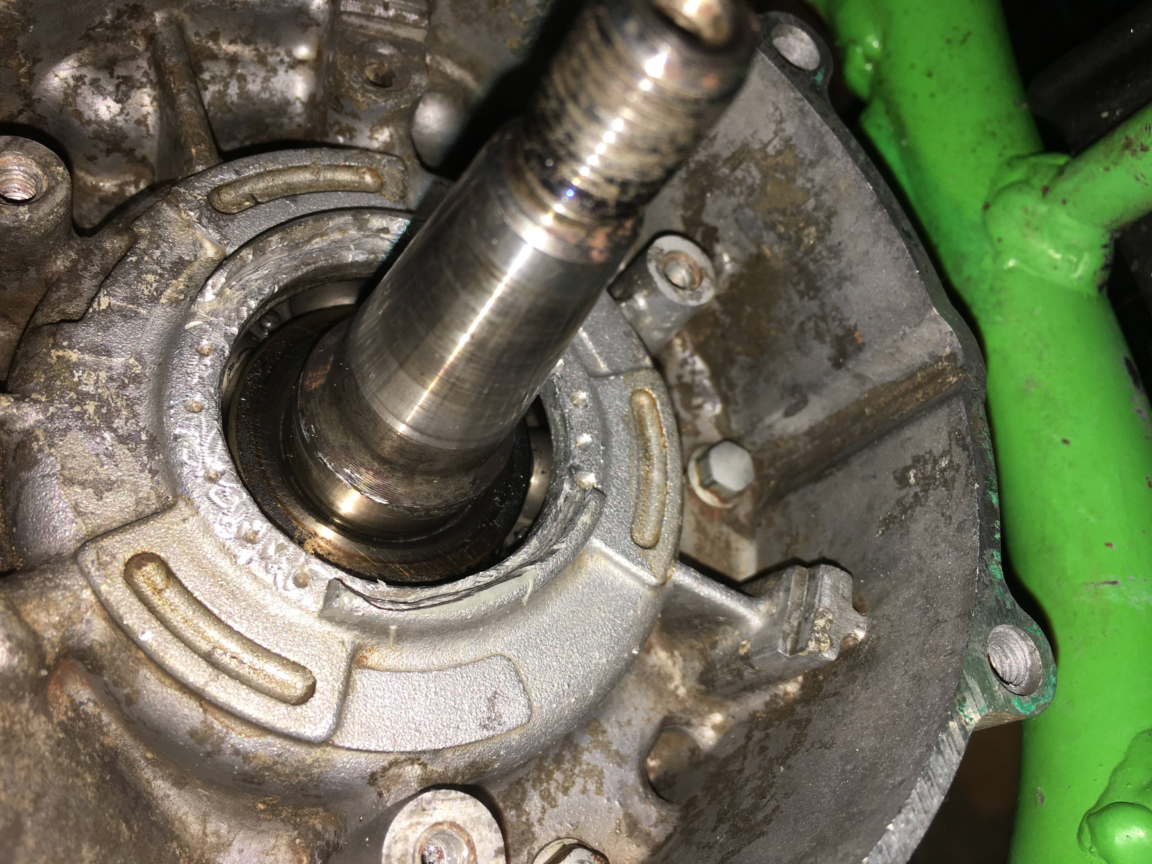

No, I haven't replaced the seal. I don't know how to figure out what Suzuki seal was used in order to try another one, do you?
And to try a Kawasaki seal, I think the outer metal band will not go in smoothly because of the hole distortion caused by the punch marks made when someone chose this method to replace the seal. What do you think?
I think the Suzuki seal appears to be all rubber and probably stands the best chance at being replaced if I knew what model bike it was from.

ChucksKDX wrote: 09:35 am Jun 30 2020 No, I haven't replaced the seal. I don't know how to figure out what Suzuki seal was used in order to try another one, do you?
Thanks for the help!
Chuck
Clean the seal off it looks like it has the sizes on it if not pull it, measure the OD and ID of the seal for size also width once removed, Look in your local area for a shop that specializes in bearings and seals, these places are good for replacement quality bearing and seals, NTN, SKF, KOYO bearings. often much cheaper then OEM. I can't see why the guy who did this would install a different size seal then OEM. You can ask if they have the seals in rubber or steel outer flange, make sure double lipped, get a couple they are cheap, Viton if you want something higher temp but general purpose is original, good for up to 250deg f, Viton up to 400deg f. Now for the case, depending on how careful you are you might be able to knock off the inner raised area from the center punch with a file( or rotary tool if very careful) but cleanliness is very important nothing allowed in the bearing. I don't see them causing a problem, me I would just leave them, the only spot I see where any significant amount of material would have been moved is at the 6 o-clock position the Suzuki symbol, others are to far out. Coat the OD of the new seal with case sealant or Loctite, this is my new favorite https://www.permatex.com/products/threa ... eadlocker/ . install the new seal with either a large socket or tube or gentle taps with a hammer, take your time. let the sealant dry over night then apply the JB weld around the entire area of the seal/case joint, once you remove the seal check for ANY movement in the crank, up/down side/side if any a new seal will most likely not help, sorry..

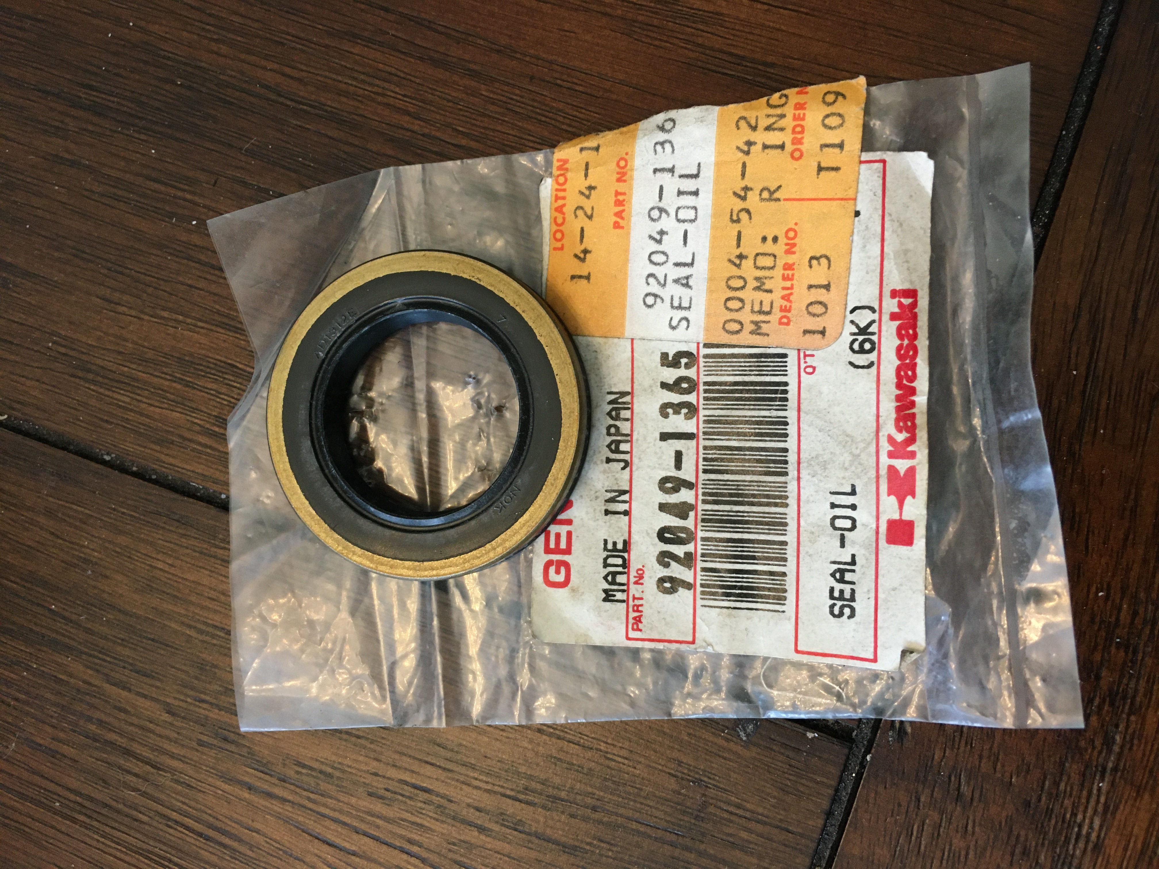

KDXGarage wrote: 10:30 am Jun 30 2020 Does it not have the numbers on the seal? Is it not the same size as stock?
Replacing the seal might be worth a shot.
Picked up an OEM seal for $9 shipped. Will have Monday. Think it's worth a shot before tearing it apart. Thanks for all the advice guys.

JimmyB wrote: 12:30 pm Jun 30 2020 Coat the OD of the new seal with case sealant or Loctite, this is my new favorite https://www.permatex.com/products/threa ... eadlocker/ . install the new seal with either a large socket or tube or gentle taps with a hammer, take your time. let the sealant dry over night then apply the JB weld around the entire area of the seal/case joint,
Thanks for the tip on the Permatex, I'll try that. Then the JB. Then...cross my fingers.

Okay guys, need one last piece of advice before I try this new seal. I only get one shot at this. I've cleaned up the edge of the bottom where the punch marks boogered up the outer seal surface. It cleaned up pretty good with a small file. Here's my dilemma; I'm not sure whether to try a thin coat of the orange Permatex locking agent around the outer edge of the new seal or a thin coat of hi-temp black RTV. I get the angle that the Permatex is to provide some protection from the seal coming out as the seal holders on each side were removed. However, I think I run a greater risk of hairline leaks around the outer metal surface of the new seal from the hackjob done with the punch. While I've cleaned it up the best I can, it still is not 'factory'. So I'm leaning toward a film of black RTV on the outer edge of the new seal. After I get the seal in, I'm also going to put JB Weld in place of the seal holders that were removed and slightly over the edge of the new seal. This is a $9 'hail Mary' gamble versus a $300 tear down and fix, but I'm going to try it. What do you guys think?
Chuck
