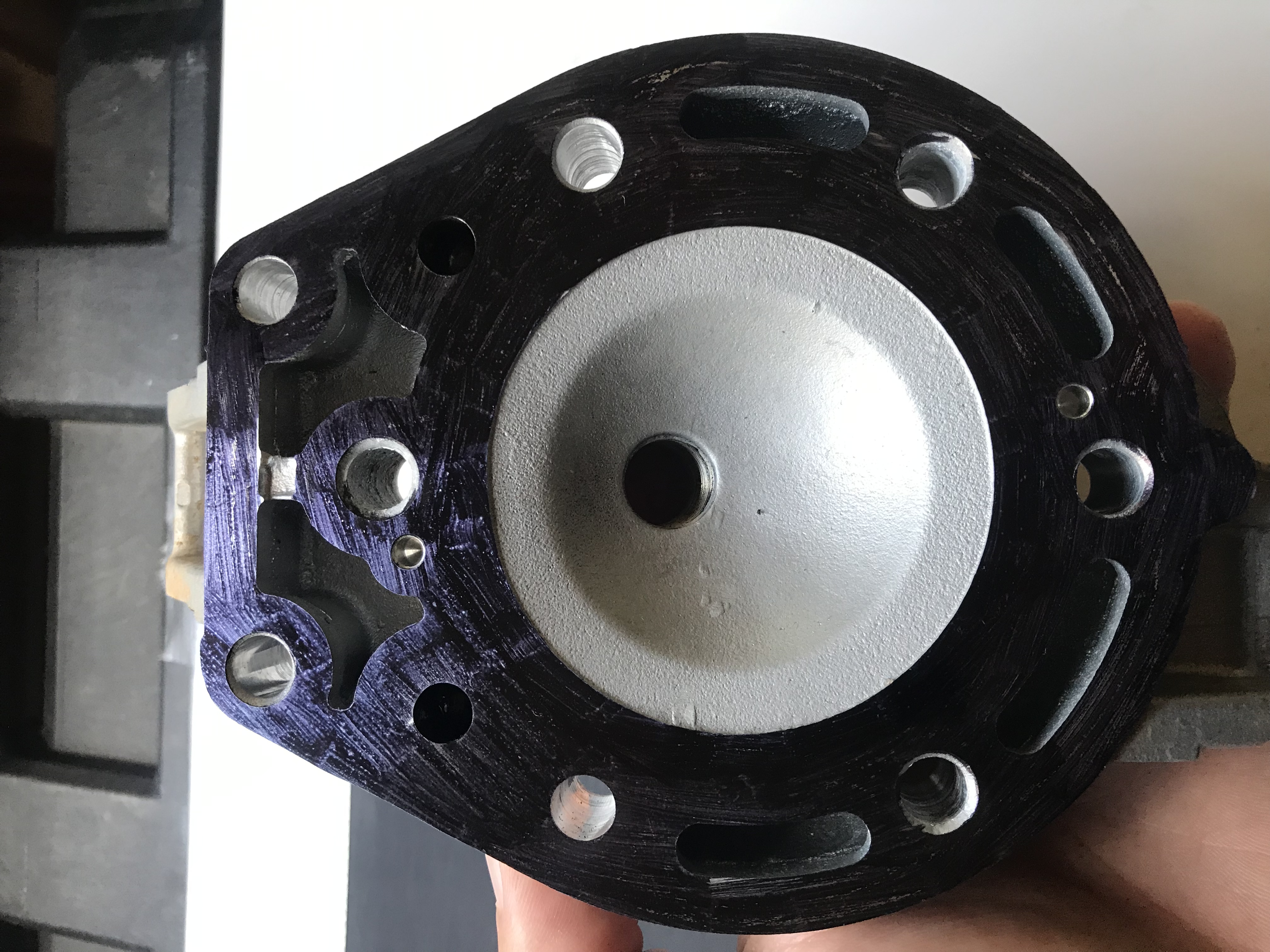

Got a little more prep work done after work today. Colored the head with a sharpie and then lightly sanded it over a plate with sandpaper. Looks good to me. Got the cylinder and KIPS pieces cleaned up and ready for reassembly. Did notice something with the connecting rod. It looks like it got hot to me. It’s got a blue discoloring to it. Does anyone know if that’s normal or cause for concern? It doesn’t have any up and down play and side to side is within spec.

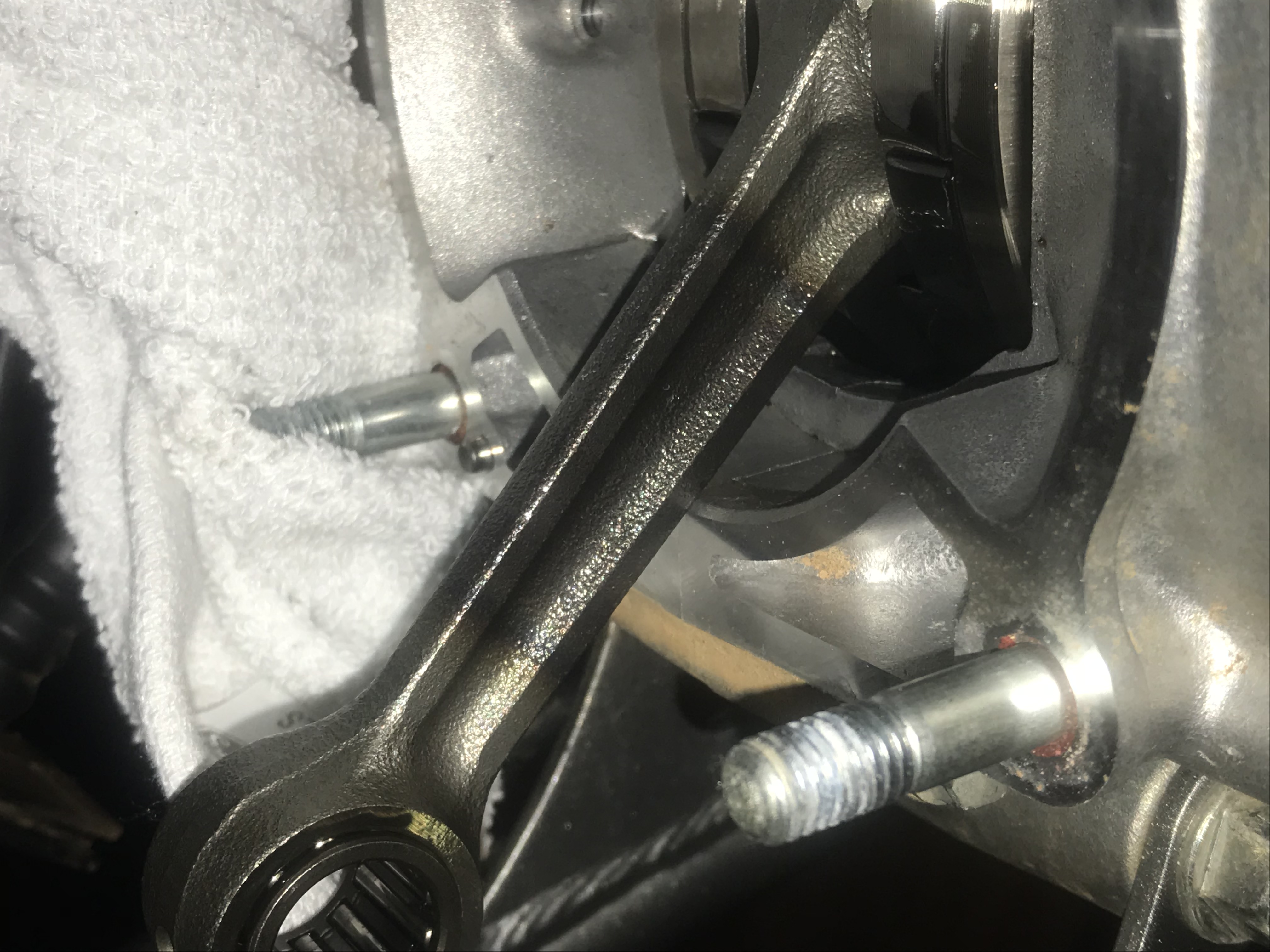

Regarding your rod, IMO I wouldn't be concerned about the color unless it was in the bearings area; both of which look fine to me.
As for the head, I would do what you can to smooth up the roughness in the combustion chamber. Won't really affect performance much one way or another, but should help discourage carbon build up.

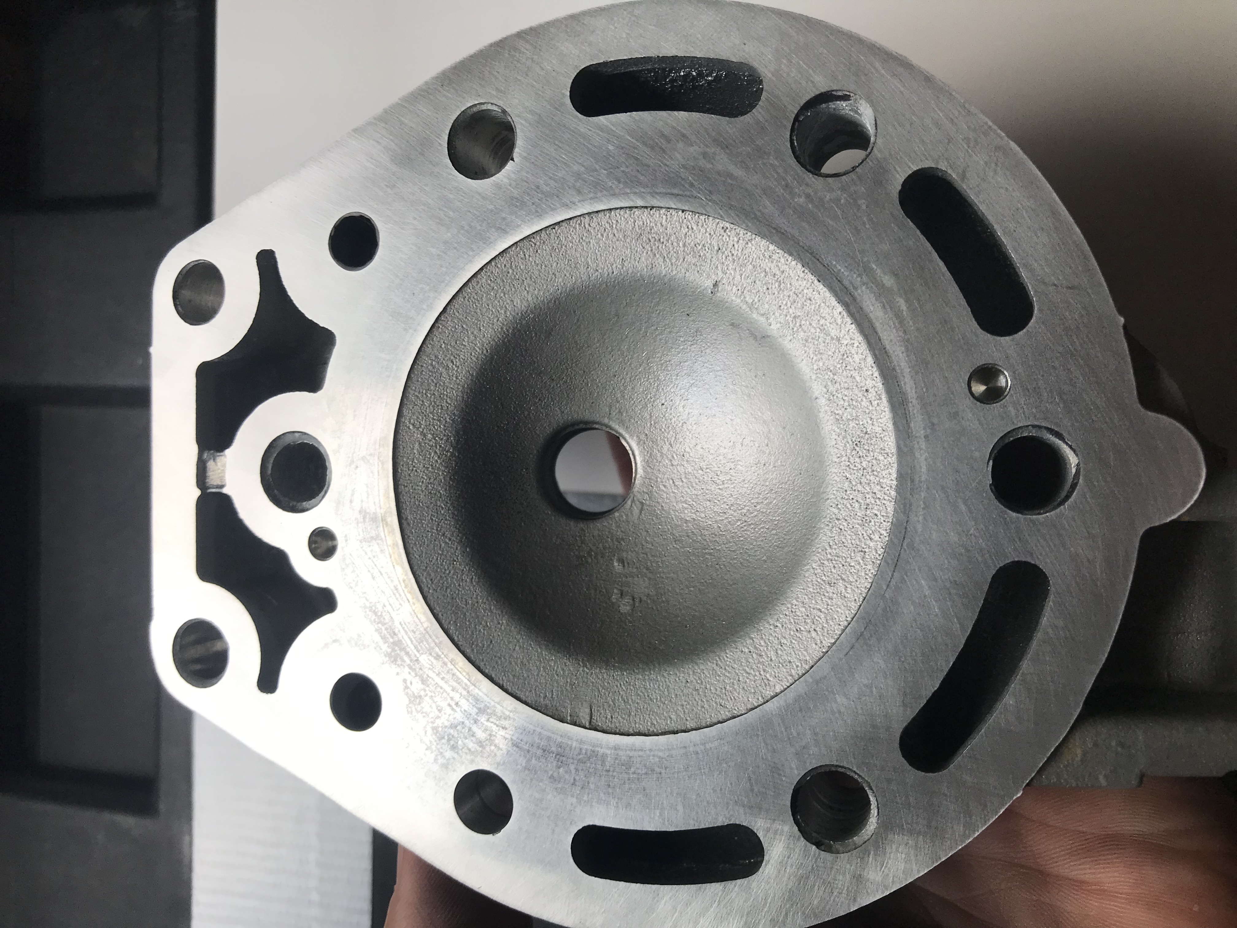

Sorry the quote didn't include the photos.I am just wondering, In your second photo just around the lower KIPS hole in the head was that moisture ?G22inSC wrote: 02:34 pm May 17 2020 Finally got a little time to do some more work. Got the top end off and found a cylinder with no scratches and a very clean head and piston. In my opinion, they are too clean like they have been steam cleaned by coolant. Didn't find any noticeable gasket issues but I don't really know what I'm looking at there. KIPS was all good but dirty. Going to take the cylinder and piston to a machine shop and see if I can get a good measurement on it all. Here is a couple pics of the head and top of the head gasket at time of removal. What do you'll think from the pics?

Around the subvalve circular hole? If so, yes but couldn't tell if it was an oil/gas mixture or oil/coolant mixture. I could be wrong but I'm assuming it was excess pre-mix from a rich carb. Is that NOT normal/typical?JimmyB wrote: 10:24 pm May 26 2020Sorry the quote didn't include the photos.I am just wondering, In your second photo just around the lower KIPS hole in the head was that moisture ?

Most likely is some pre-mix, just bleeding out and beaded up as you pulled the head off..

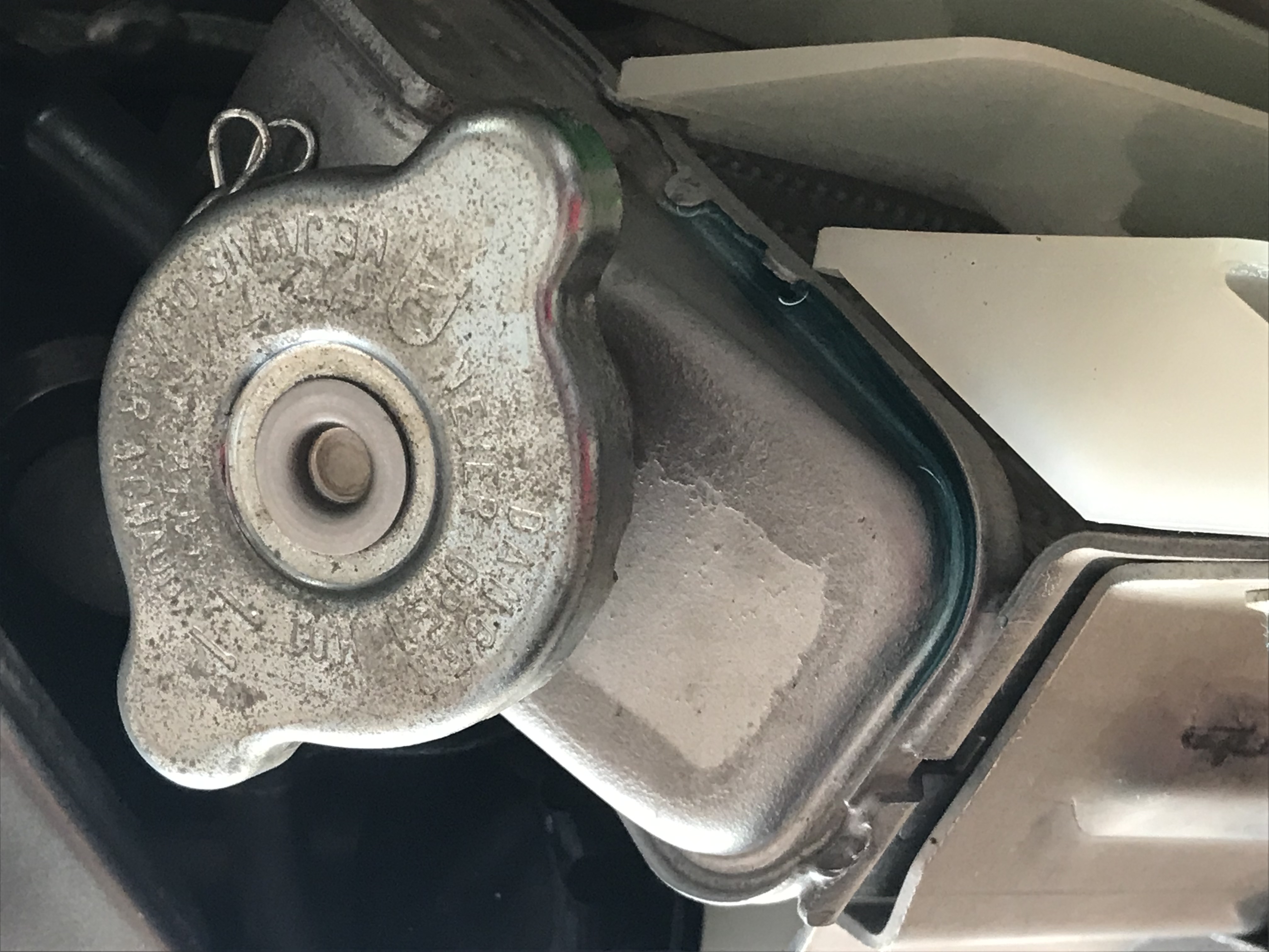

A bad cap can cause issues and coolant loss also. It keeps pressure and keeps the system from boiling over. if it doesn't hold pressure, you will get overheating and coolant loss.

Just an update for everyone. I needed a top end and glad I pulled it apart to do so and clean the KIPS. I believe I have probably tracked down the last issue...cross your fingers. Just the other day I noticed coolant around the neck. Did a pressure test on the cap and noticed it releases at the correct pressure; however, it does not hold pressure. Swap caps with my youngest boys KX65 and ran great with no coolant loss. Went back to my cap and once again had coolant loss. Couldn't see any external leaks but could easily be loosing coolant to evaporation. Have a new cap ordered from RMATV but it's backordered so it will be a little while. I will update everyone once I can. Thanks.
