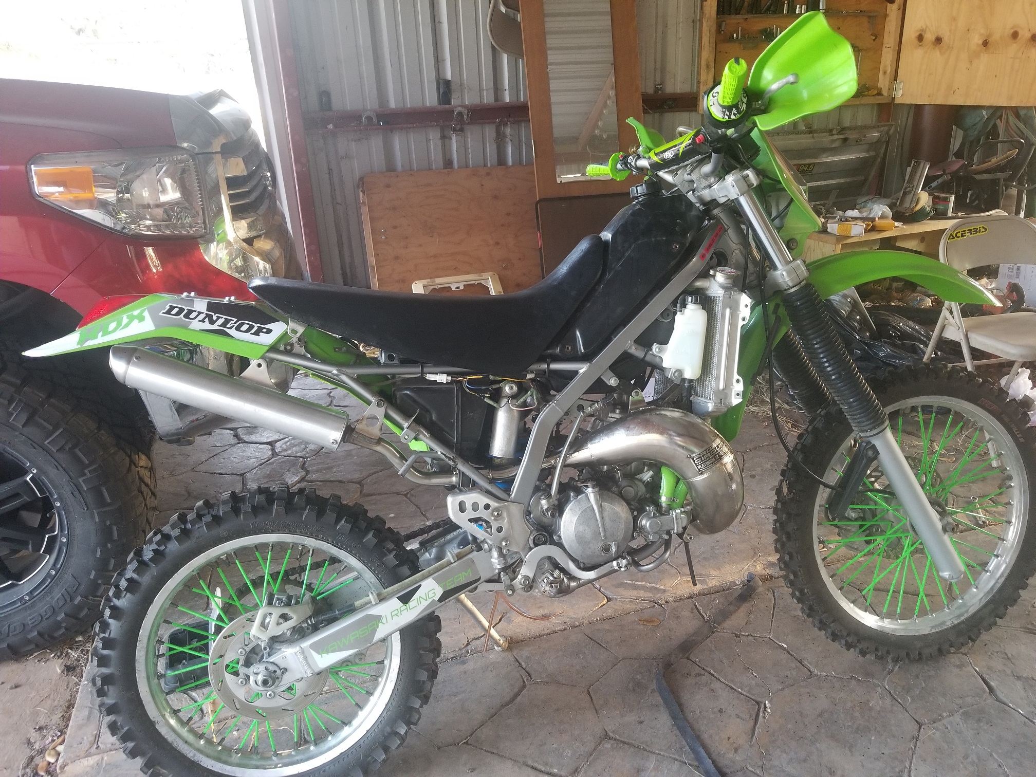

Are you able to take a picture of your bike? It would be helpful to see what you are seeing.
Thank you.

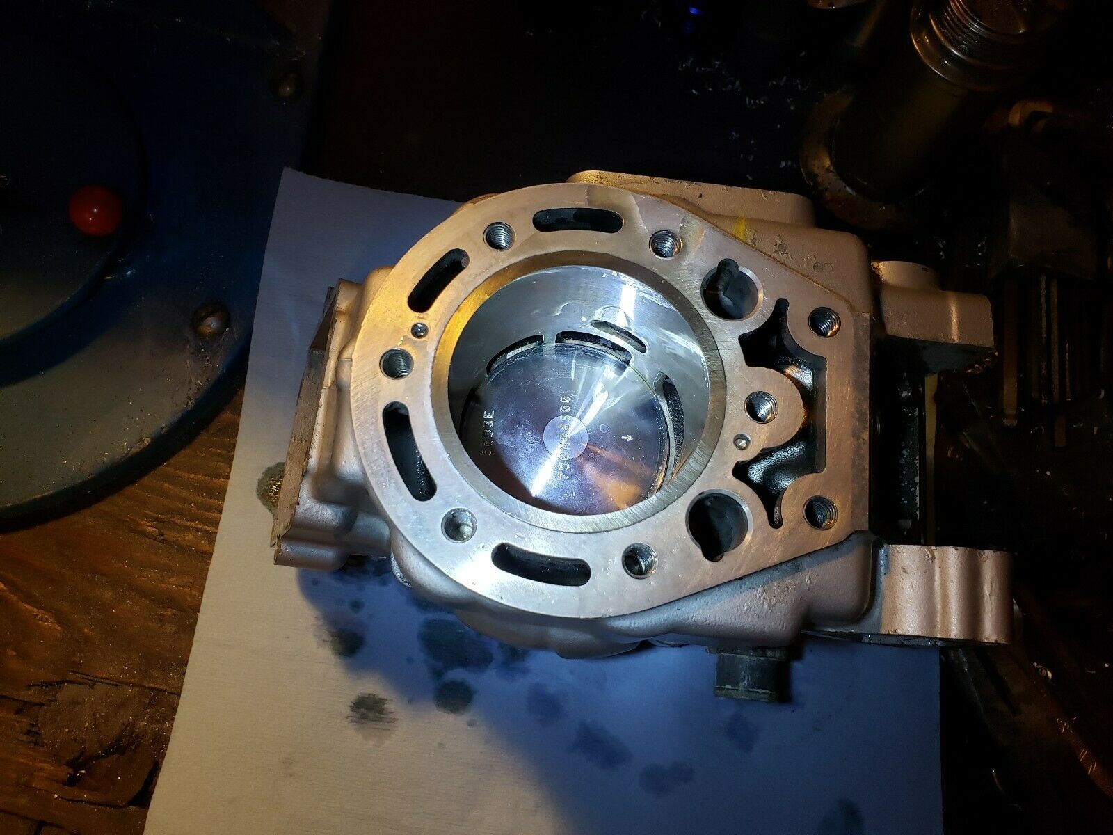

got my sleeve today
s-l1600 (1).jpg (219.59 KiB) Viewed 6564 times
Re: need some help pls not sure where locating pin go
All right! Take your time during reassembly. Don't forget about the left hand threads on the shaft and nut of the power valve system advancer rod.

Looks like a nice job. Now you can bore it to the next oversize. Are there oversized piston kits available? Or do you need to find a piston off another brand I.e. Yamaha?
