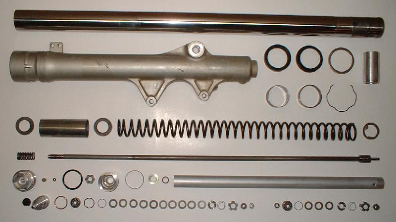

:bravo: Sometimes a preview of the work to be done helps. Not the gold valves but the tear down procedure lol

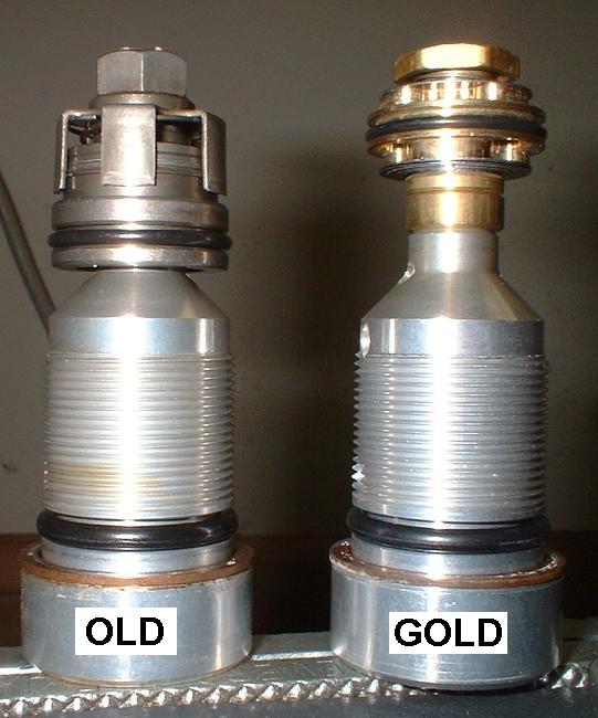

Hey one more dumb question: In an earlier reply you mentioned some nut on the bottom that is "peened over", that I should be careful to undo the peening before I attempt removal of the nut, thereby avoiding a gigantic headache. In this picture, can you point to the nut that has the peening?
The exact quote from before was, "The tops of the base valves have the nut on top. It is peened over. One MUST file down the top a little before loosening the nuts. Feel free to read through some old threads where people snapped them off. YOU HAVE BEEN WARNED! :naughty:"

nut on top of left base valve assembly
