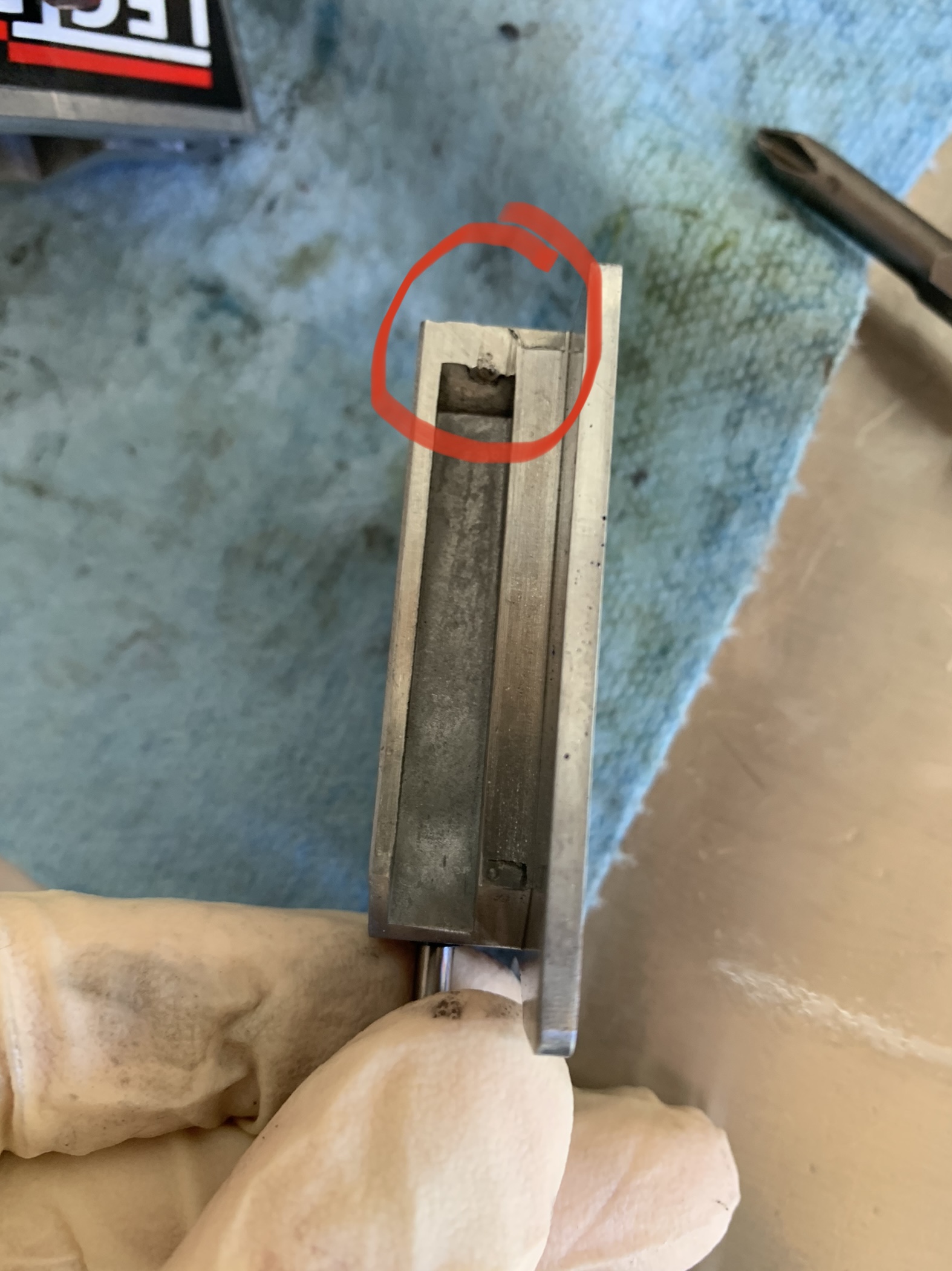

Well got the lectron in and got it on easy. Weird tho it runs really lean. Hard to get it to idle well when cold then it won’t take any throttle. It just sounds like it’s not getting any fuel and dies. Take a while to warm up then finally will rev. Just seems weird. I know it’s 35 ish degrees here but still. Not impressed so far. Never had a carb 2t struggle this much. I would guess something is not right.

Edit: got a call from them and I think they were pretty useless. Had me try to make my slide gap 1/8 of an inch. And measure my rod at 2.044 inches. I don’t think the rod would do anything where I’m at in the revs. I feel it’s a slide issue if something is not set up right. More seems like fuel is not getting in at all. If it was a carb I would think the pilot and main were clogged.

Update I think I figured it out. The guy told me to set the idle gap at 1/8in. Well it was at zero with the idle screw maxed. What happened was I backed the idle screw too far out and the slide dropped too far. I then turned it in and it hit the side of the slide making me think it was maxed. Well I pulled the slide up and ran the screw in and dropped the slide and it worked. I will verify tonight. Boy was I confused.
PSA don’t back the idle out all the way it gets messed up.
