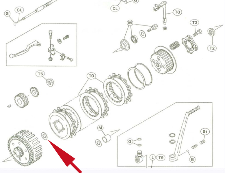

I got a problem, the clutch pin does not stick out far enough, so that the actuator arm thingy on the top of the case needs to be pulled/turned more than it used to before it starts to operate the clutch, more than 90 degrees relative to the clutch cable. Am I missing something?
I have the clutch nut, washer, and springs not pictured.
Re: I'm just gonna leave this here
Posted: 09:54 pm Jan 16 2020
by SS109
Double check the placement of the washers. In what order do you have everything installed?
Posted: 10:27 pm Jan 16 2020
by lizardfungus200
All the parts shown are installed in the order they appear

by bufftester
Check the washer stack up inside the clutch basket as well, sounds as if you're missing a washer somewhere

by SS109
Do you have the washer the red arrow is pointing to installed?
Clutch basket washer.jpg (102.14 KiB) Viewed 5870 times

by lizardfungus200
Hmm, I think I put that washer right underneath the nut
Posted: 06:43 pm Jan 17 2020
by lizardfungus200
Wait no, i lost that washer. If anyone reading this is changing out their clutch right now, could you please send me the thickness of this washer?
Posted: 07:41 pm Jan 17 2020
by bufftester
That would give you issues with clutch actuation. That washer is p/n 92200-1238 which is a washer with the following dimensions 20.3IDX30ODX2.3 Thickness
Posted: 02:10 am Jan 18 2020
by lizardfungus200
Thank you ao much buffteater

by lizardfungus200
Even after I found a replacement washer, I was still having the same issue. Upon further inspection, with the clutch springs tightened, the clutch disk was separated from the cluch plates, basically the clutch was disengaged and not grabbing. The inner clutch disk caught on a tooth from the plates when i tightened it up. This may explain why it is a common problem when people service their clutch. Anyway Finished that up and tested out my new asv levers and they made pulling the clutch a lot easier. I used a washer that was .2mm smaller, so that may have made a small difference. I was planning on lengthening the clutch arm, but not anymore.
