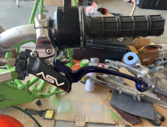

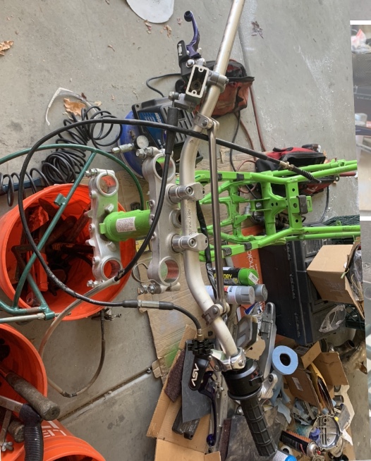

I will be updating and posting pics as I chip away at it. Recently I started to repaint the swingarm, I wanted to go with the bare aluminum look, but not bad enough to put in the work. A few thick coats of primer and paint covered up the scars I made with a wire wheel. I took the cylinder off to do some more porting since my new tool came in. This is still a budget build, so Im always looking for deals on anything i can do to my bike, for example, I picked up a set of like new asv levers for $25, some xr400 fork springs for $20, a free 35w hid bulb and ballast, cheap graphics, a used trail tech vapor I traded, and an 02 rm125 shock
Ive heard the flywheel can strip threads when trying to get it off, does anyone have a preferred puller?
Ss109, I saw you had an rm shock on your bike. I read somewhere it fits with a little grinding, but it makes the bike higher. Would you know if it possible to mitigate the height difference with just a lowering link?

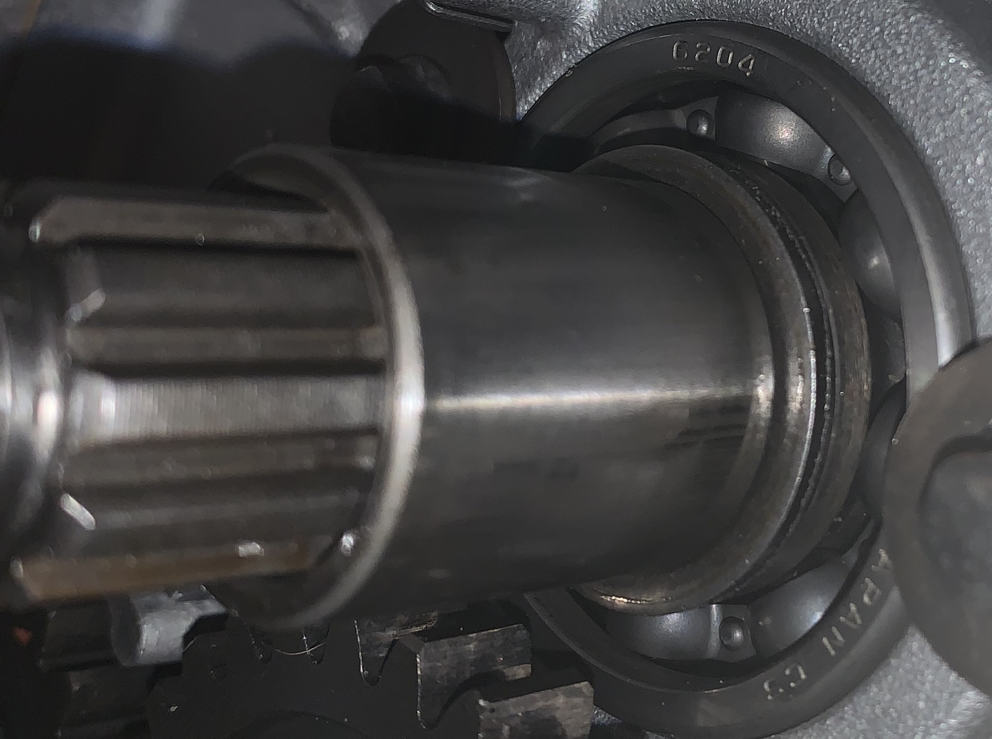

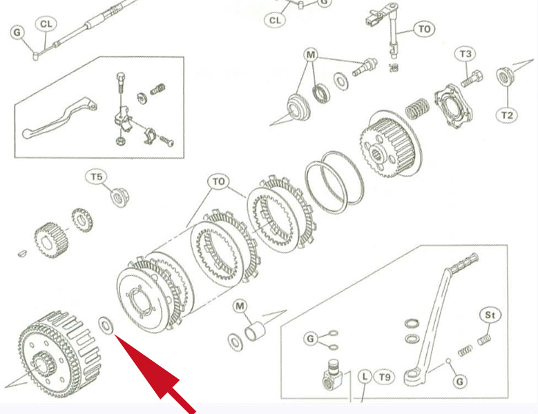

I got a problem, the clutch pin does not stick out far enough, so that the actuator arm thingy on the top of the case needs to be pulled/turned more than it used to before it starts to operate the clutch, more than 90 degrees relative to the clutch cable. Am I missing something?
I have the clutch nut, washer, and springs not pictured.

Posts: 6054
Re: I'm just gonna leave this here
Double check the placement of the washers. In what order do you have everything installed?

Posts: 3540
Check the washer stack up inside the clutch basket as well, sounds as if you're missing a washer somewhere

Posts: 6054
Do you have the washer the red arrow is pointing to installed?

lizardfungus200
Posts: 78
Joined: 03:52 pm Feb 06 2019
Post by lizardfungus200 »
Hmm, I think I put that washer right underneath the nut

lizardfungus200
Posts: 78
Wait no, i lost that washer. If anyone reading this is changing out their clutch right now, could you please send me the thickness of this washer?

Posts: 3540
That would give you issues with clutch actuation. That washer is p/n 92200-1238 which is a washer with the following dimensions 20.3IDX30ODX2.3 Thickness

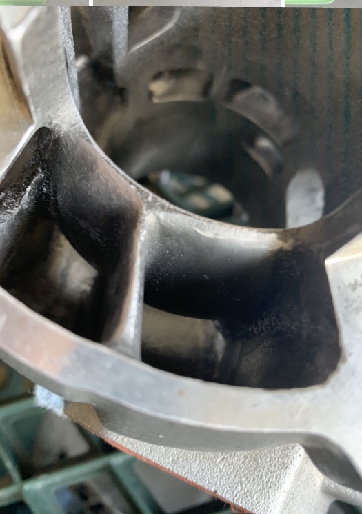

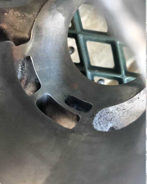

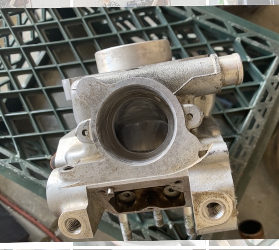

Even after I found a replacement washer, I was still having the same issue. Upon further inspection, with the clutch springs tightened, the clutch disk was separated from the cluch plates, basically the clutch was disengaged and not grabbing. The inner clutch disk caught on a tooth from the plates when i tightened it up. This may explain why it is a common problem when people service their clutch. Anyway Finished that up and tested out my new asv levers and they made pulling the clutch a lot easier. I used a washer that was .2mm smaller, so that may have made a small difference. I was planning on lengthening the clutch arm, but not anymore.
Here’s a few pics of the porting. Mostly just smoothed things out and matched the exhaust to my pipe. I did raise the transfers and exhaust just a hair, just a little closer on the bevel.

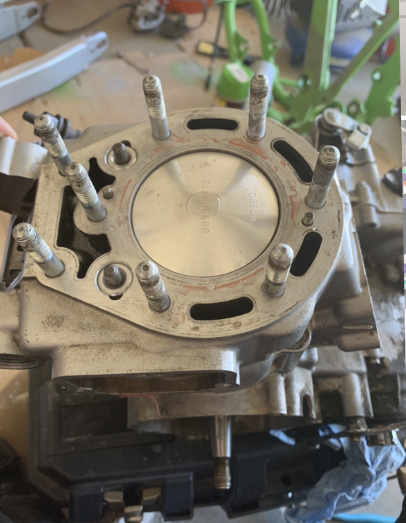

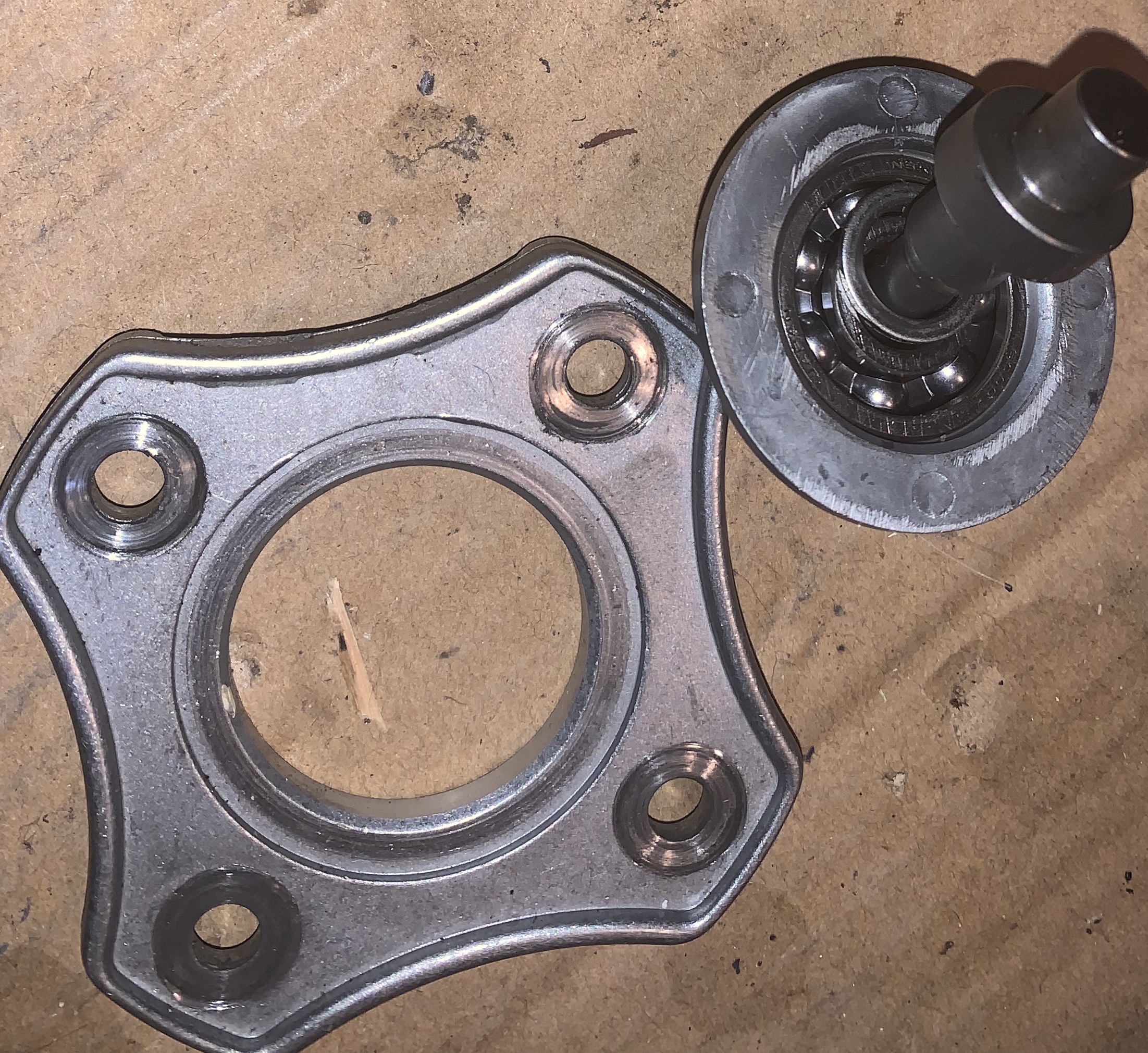

New wiseco piston. I was having trouble with the one kips rack with the o ring sticking and not moving easily. Honed and polished both tubes and now its like butter, however the central valve that slides in and out sticks where the acuator arm moves it with that little pin. Don’t know if its normal or not, there may be excessive play in that valve, but it doesn’t seem like it would be a problem at all when the engine is vibrating.
