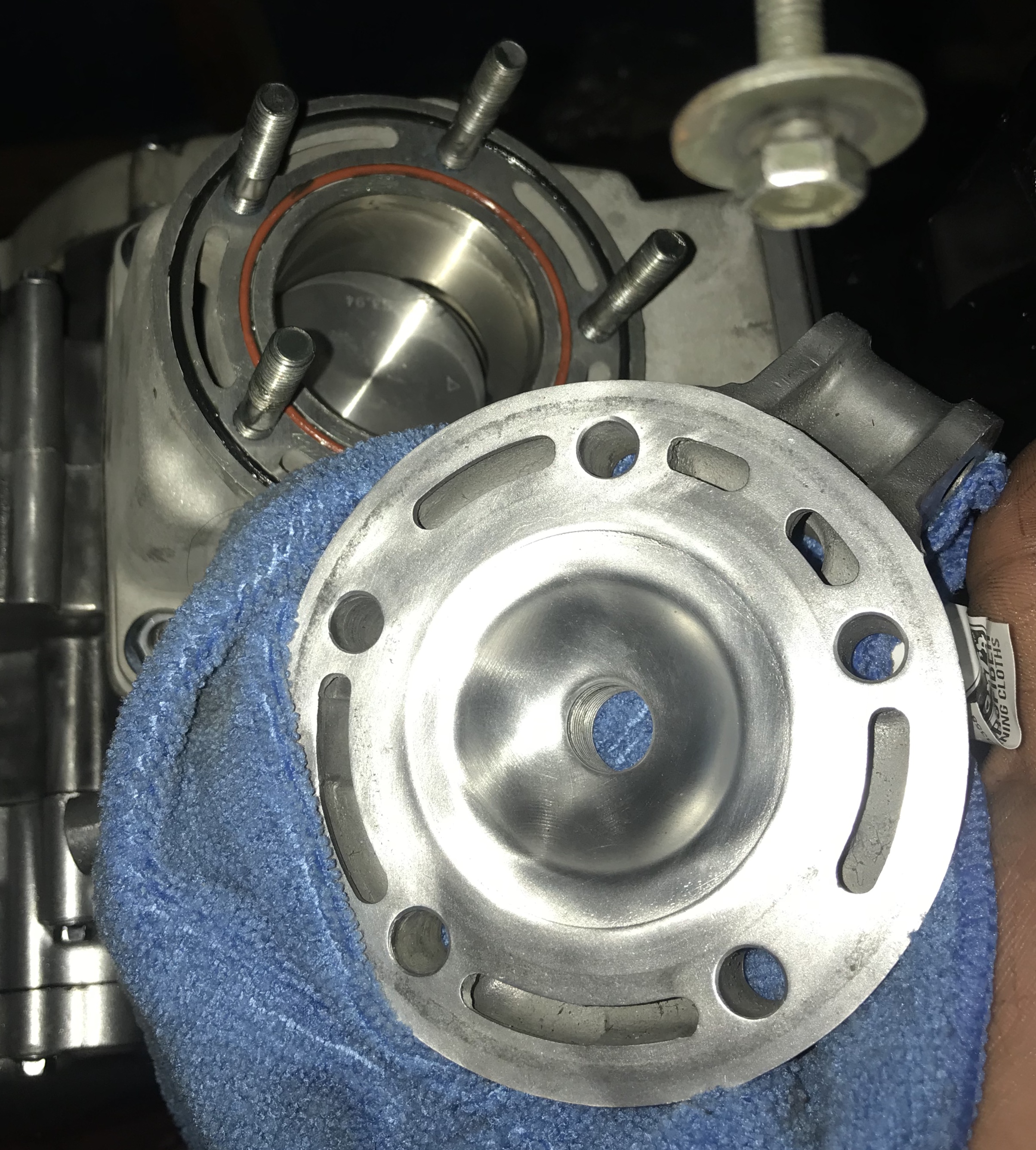

I’m gonna split the cases and see what’s in there. Not sure if that junk was just from the one hour test ride I did, not noticing that boot being loose, or if this has been over time. If it was sucking in regular air, wouldn’t one expect more scoring in the cylinder? That chip is really the only thing. As far as the head goes, I could send with the cylinder or get another. I’m just gonna continue the tear down and see if these main bearings are crunchy or not.

Look on eBay for a used head.
Any chips or flakes on a cylinder wall equals replating.

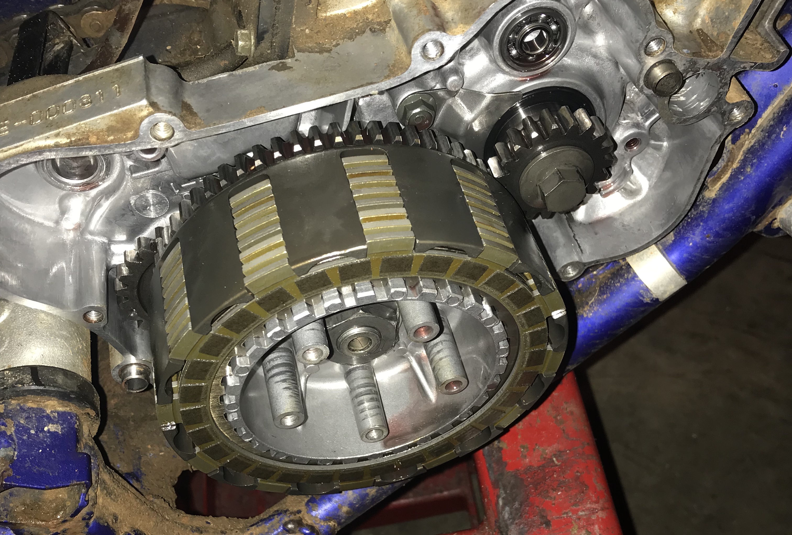

Re: Got the wrong color - new project!
Broke it down some more. Looks like an aftermarket basket. From the photo it looks like I might need plates. I do have a good pack sitting at the house. Right side bearing felt concrete from this side. Feeling optimistic, but I’m not forking over any cash until I know what I have. I was optimistic enough to buy some yamabond.

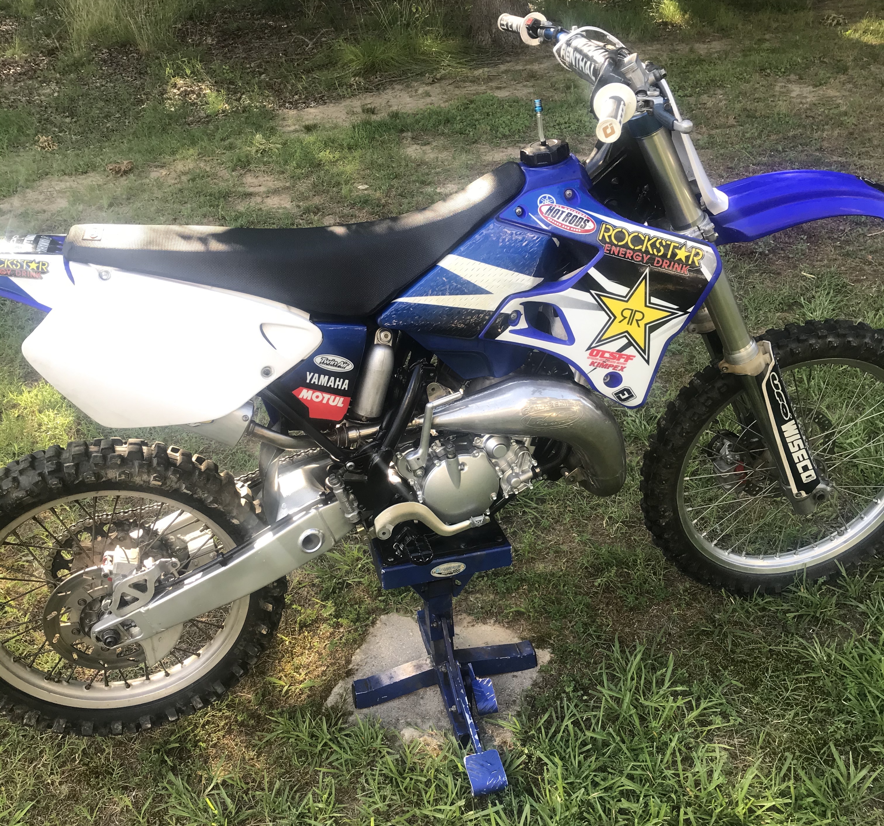

I ended up finishing this project last month. I just put a better rim on the back.
SHINY!!
Congratulations on getting it going!
