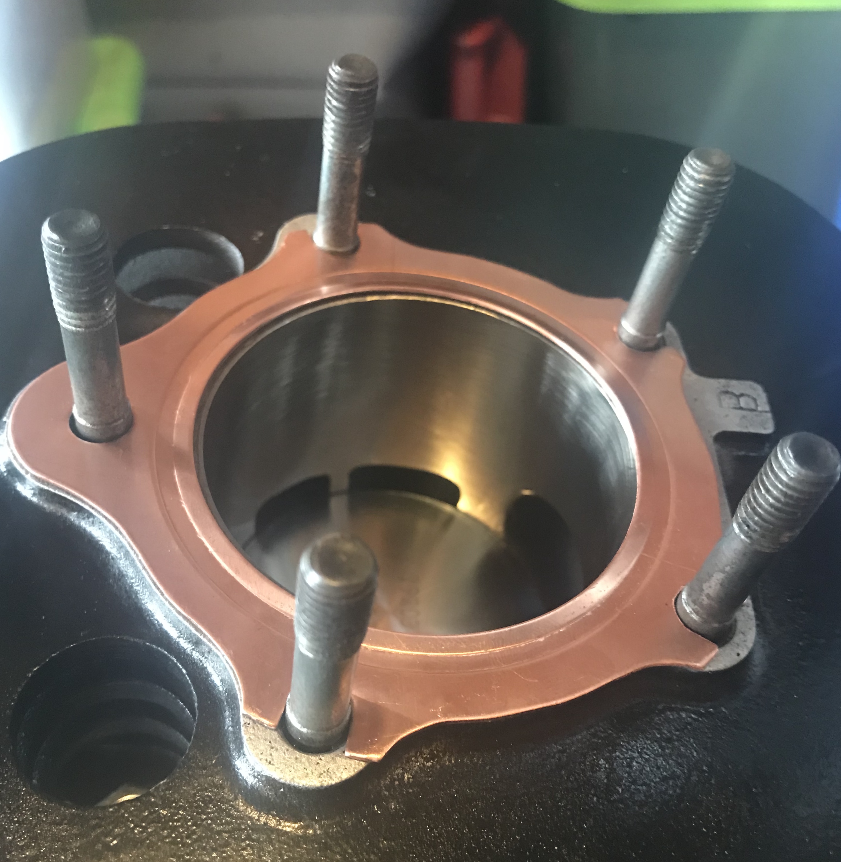

Re: Yet another rebuild thread
Had to modify my head gasket to get it to fit. My kit was for an 84, and I’d assume the stud pattern would be the same for an 85 cylinder but I guess not. My old gasket barely fit, but some of the gasket hung over the exhaust side of the cylinder. Shaved some material off of my new gasket and I got it to fit just right.
