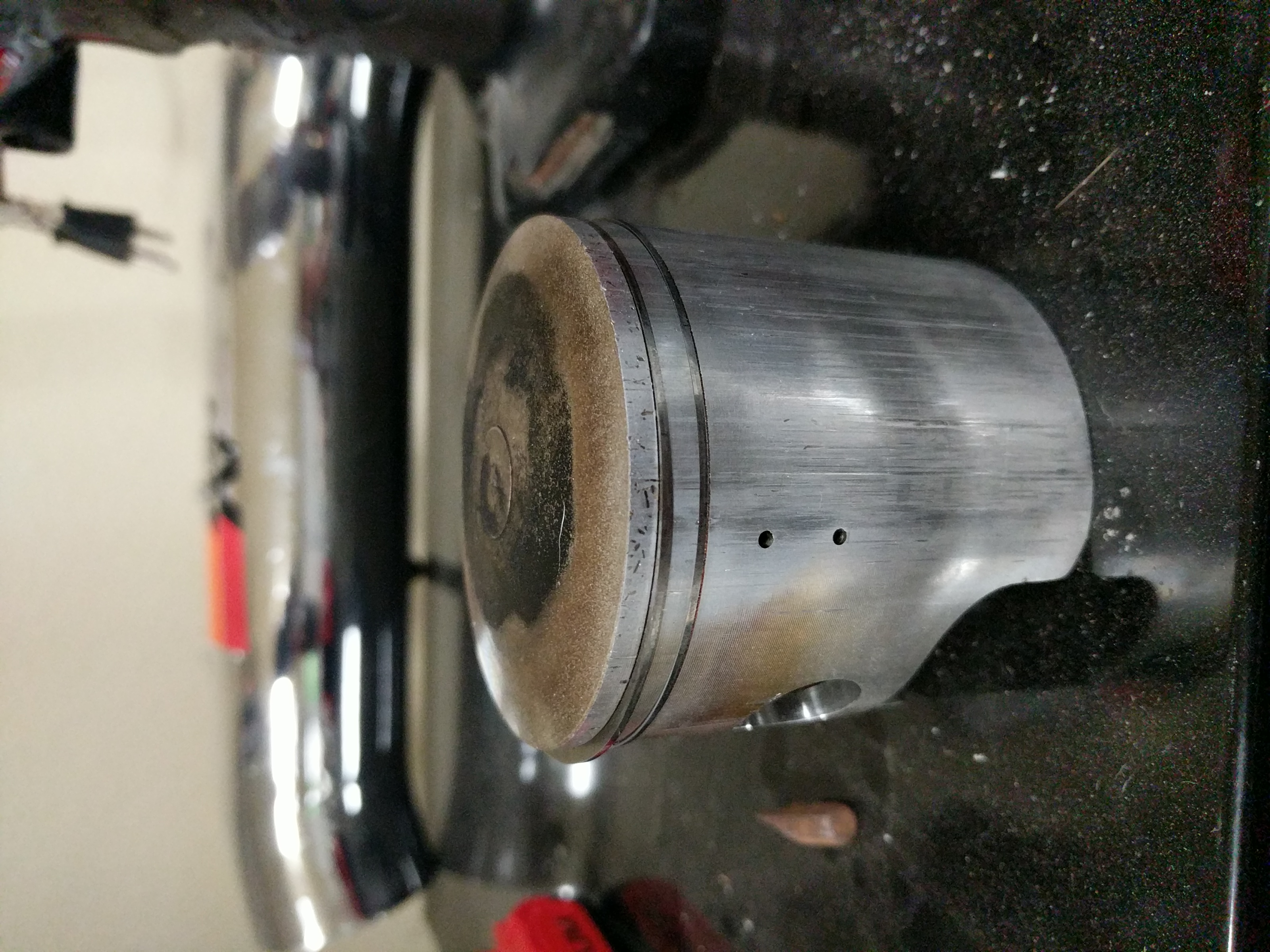

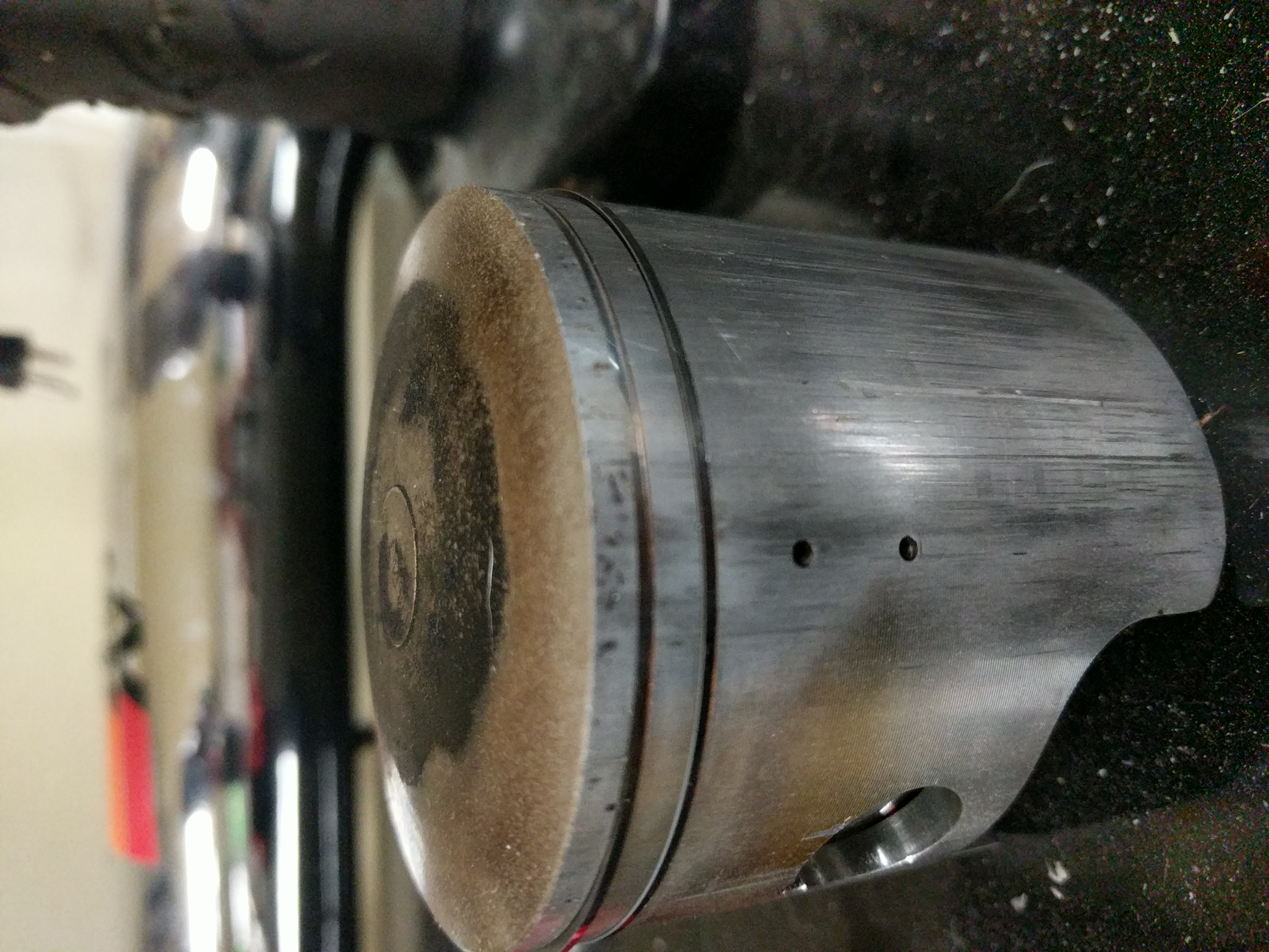

Piston
Re: KIPS rattle with a new MUCH louder rattle...help me out guys (with video and pics)
Posted: 07:17 pm Jan 05 2019
by B737driver
Piston

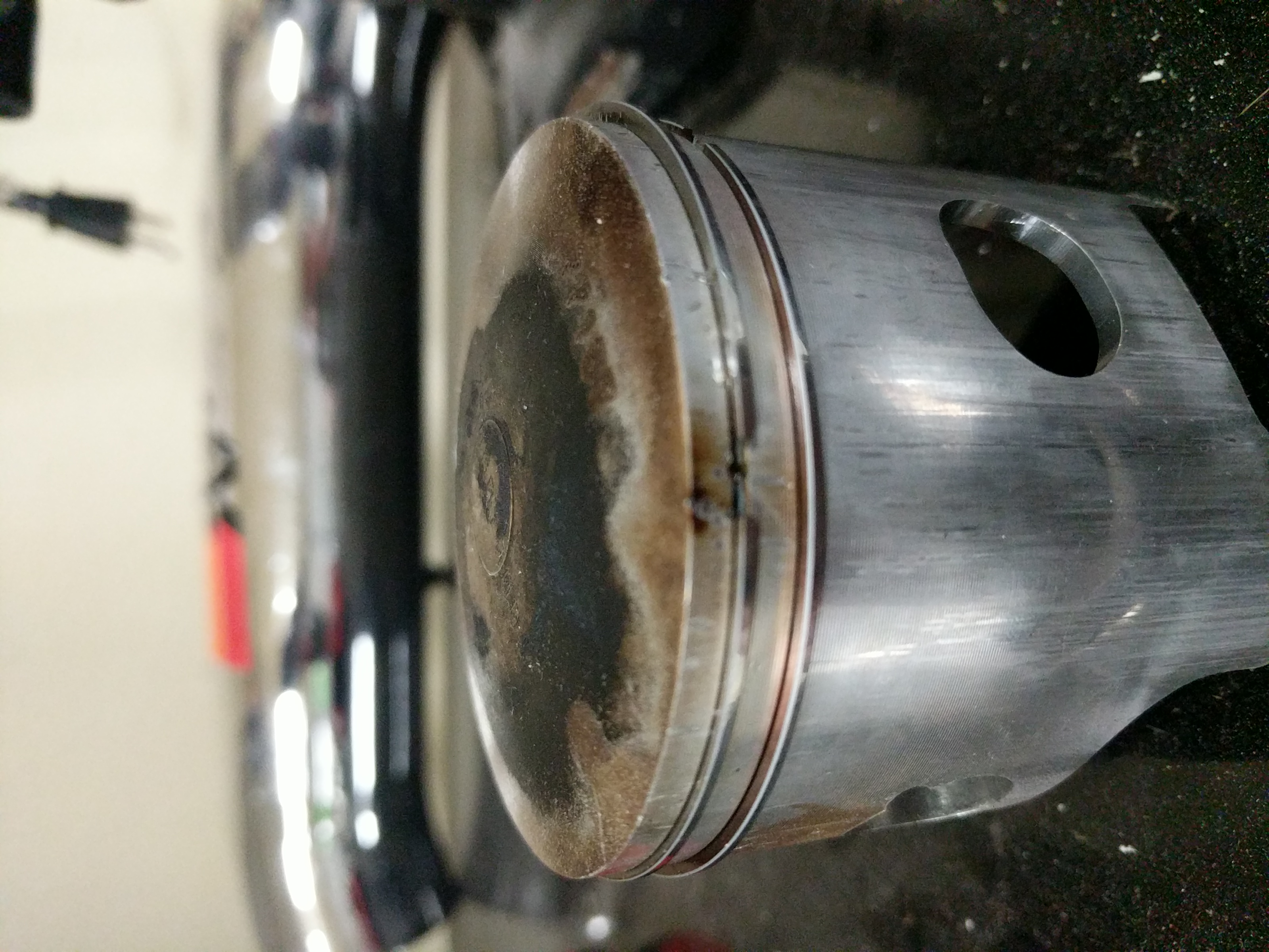

Maybe a little blow by where the upper ring comes together.

The little lines look like dirt scratches on the piston and cylinder.
If there is aluminum streaking on the cylinder walls, read up on muriatic acid.

That's a siezed or nearly seized piston, autolube or premix? I put a 38carb on my 250 and got it wrong. Before mine locked up it was making a ticking sound.
The piston skirt is getting to hot and pinching. Is piston the correct size for barrel?

Well the bottom end is currently being rebuilt. The main bearing on the water pump side was in the process of "letting loose". Really hoping to get some pics when he pulls it apart. He just rebuilt the crank and installed a new rod. He thinks that the metal shavings from the race coming apart were getting into the top end during combustion causing the piston scoring. He hasn't pulled the seal on that side yet to totally expose the bearing.

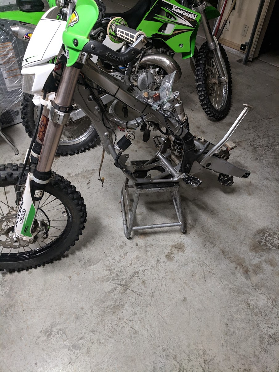

Kinda getting tired of this look...can't wait to ride it again,

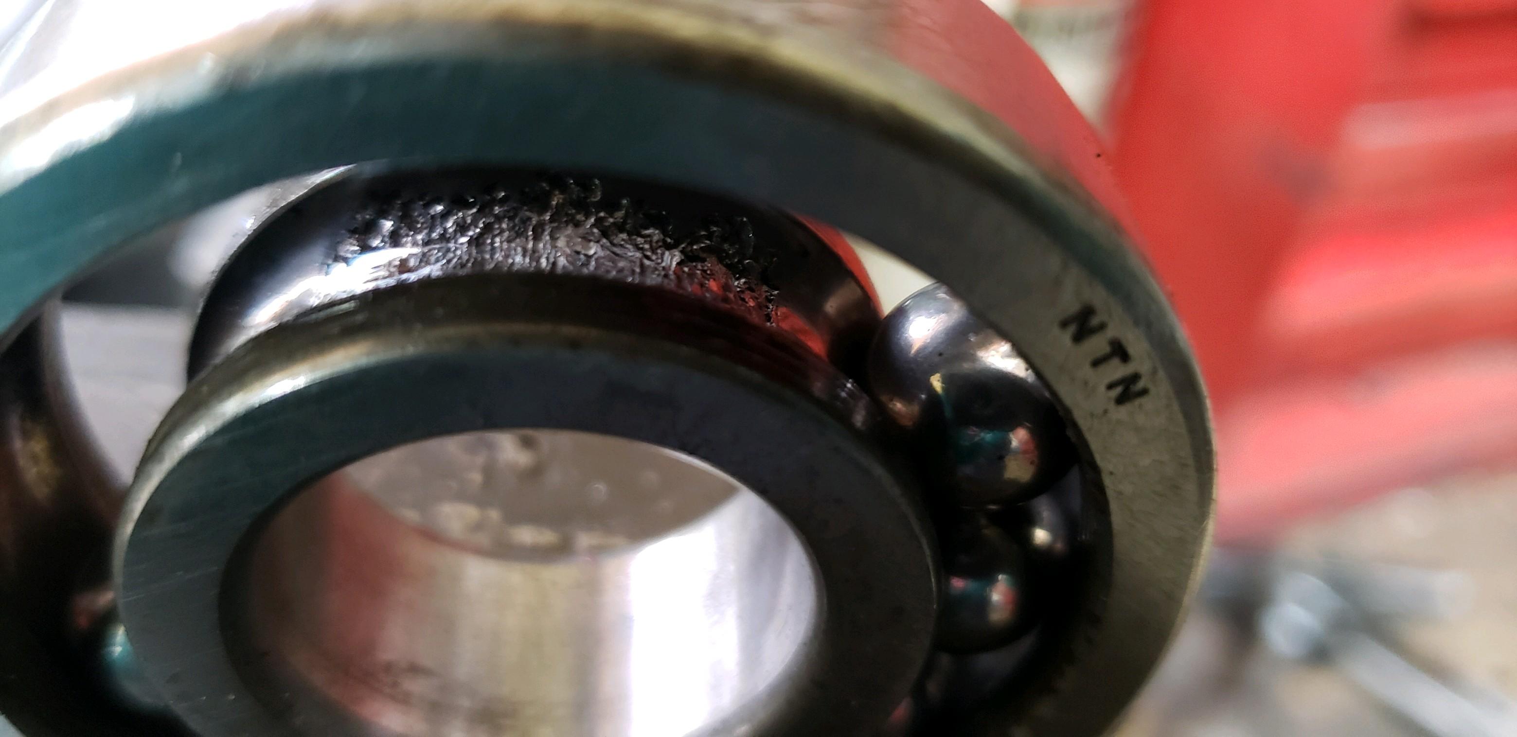

Well here is what I've got. The inner race on the main bearing (water pump side) was being chewed up. The metal that it was producing is what was getting into the combustion chamber. That metal is what you see on the piston. Fortunately, I caught it early enough to not mess up the cylinder or head. Lesson here is, if something doesn't sound right...shut it down before further damage occurs. Crazy thing is, the bike was still running normal.
It was also pointed out that the cases were not flush in some areas allowing pressure to move around in the bottom end where it shouldn't. Here is the image from the mechanic showing those areas. I guess it was a casting flaw from Kawi since this is the first time the cases have been split. He's going to clean that up and should have it back in a week or so. So... new top end, crank rebuilt, new rod, new bearings throughout...should be good to go for years.
