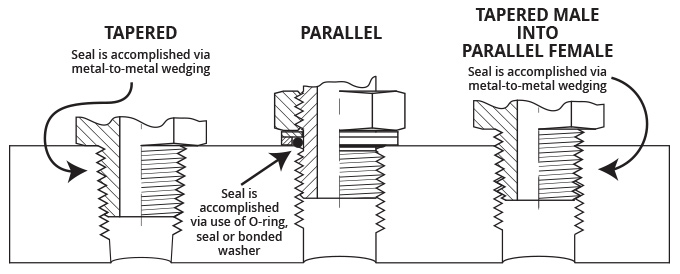

So they tapered 3/8" BSPT?
I need to buy one to replace my missing plug that PowerSeal USA removed and lost when replating my cylinder...

So are these tapered 3/8" BSPT?
Or are they straight thread 3/8" BSPP?
Both BSPP and BSPT are discussed here, and also referenced as just BSP.

BSPT has a tapered thread and seals in the threads like an NPT. BSPP is parallel threads would require a shoulder with an O-ring to have a seal.
