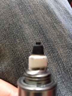

Here are some more pictures of main jet plug chops. Making multiple runs on one plug first started as a necessity because I don't have a long trail to hit 6th wide open. I found later that I like having a couple runs on it for better color. I start with a fully warmed up engine then put a new plug in and would take off from the truck 1st - 4th wide open, pull in the clutch but not kill the engine, turn around while idling then 1st - 4th wide open back to the truck this time pulling the clutch and killing the engine. That's what I'm calling 2 runs below in the description. It was a long enough run that I could hold wide open for at least 4-5 seconds after the bike is no longer revving any higher. It's weird at first because your brain is screaming at you to shift when your engine has fully flattened out. My instinct says it's gonna blow but it takes it like a champ. Start too rich and bring it down.
The first picture is a 160 main with 2 runs and shows why you can't just pull the plug and glance at it to see how your overall jetting is. This plug only has a minute on it and all three circuits look jet black from the overly rich main.

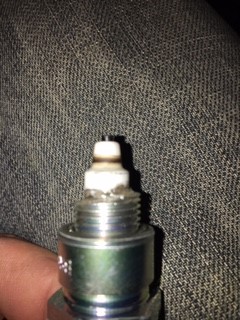

The second pic is a 155 main with 2 runs and it gained 640 max rpms over the 160

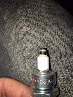

The third pic is a 150 main with 2 runs and it gained another 680 max rpm over the 155, 1320 over the 160.

The seat of the pants horsepower gauge says it gained a bunch of power from 160 to 150 and the 145 feels amazing, especially with the addition of the FMF Rev pipe. The occasional full throttle, 2 foot high, long pull wheelie from the 3-4 shift makes all that messing around worth it. It won't do that nearly as easy with a 150.
My bike has a trail tech with rpm readings but one of those $20 ebay or amazon hour meters that also record max rpms are a great thing to have. I have one on another bike and its been good for years.
Edit: These 3 plug pictures are from an Honda 250R but all the notes were from the KDX. The KDX plug chops looked exactly like these. Both bikes used the same 4 jets, starting at 160 and both ending up at 145.
