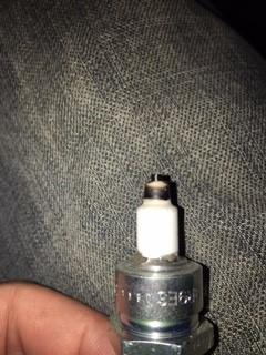

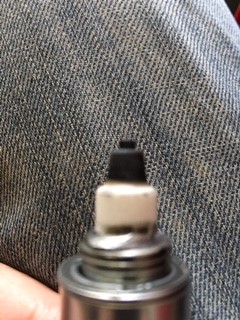

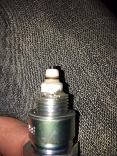

Here are some more pictures of main jet plug chops. Making multiple runs on one plug first started as a necessity because I don't have a long trail to hit 6th wide open. I found later that I like having a couple runs on it for better color. I start with a fully warmed up engine then put a new plug in and would take off from the truck 1st - 4th wide open, pull in the clutch but not kill the engine, turn around while idling then 1st - 4th wide open back to the truck this time pulling the clutch and killing the engine. That's what I'm calling 2 runs below in the description. It was a long enough run that I could hold wide open for at least 4-5 seconds after the bike is no longer revving any higher. It's weird at first because your brain is screaming at you to shift when your engine has fully flattened out. My instinct says it's gonna blow but it takes it like a champ. Start too rich and bring it down.
The first picture is a 160 main with 2 runs and shows why you can't just pull the plug and glance at it to see how your overall jetting is. This plug only has a minute on it and all three circuits look jet black from the overly rich main. The second pic is a 155 main with 2 runs and it gained 640 max rpms over the 160 The third pic is a 150 main with 2 runs and it gained another 680 max rpm over the 155, 1320 over the 160. The fourth one (which had something wrong with the pic and won't load) is a 145 with 4 runs on it. It looks pretty much just like the 150 picture. It gained another 430 max rpm over the 150, 1110 over the 155, and 1750 over the 160.

Edit: These 3 plug pictures are from an Honda 250R but all the notes were from the KDX. The KDX plug chops looked exactly like these. Both bikes used the same 4 jets, starting at 160 and both ending up at 145.
