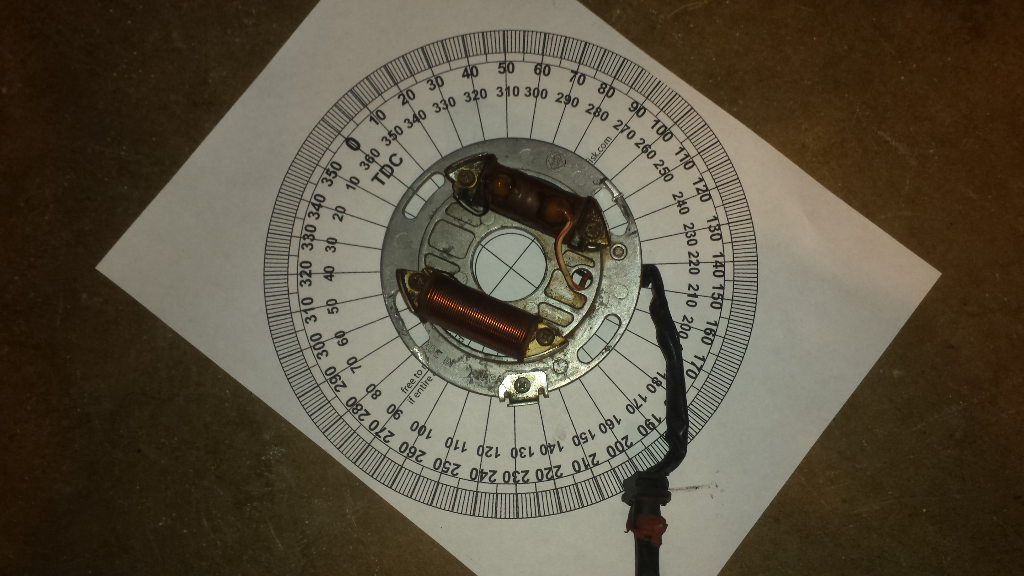

From stock position rotated counter-clockwise approx 90 degrees. The timing mark at TDC zero degrees is roughly matched to the timing mark on the case.
Re: CDI and coil interchangability?
Posted: 02:42 pm Oct 13 2016
by bob_jones
If you did it right, it could only be at 0 or 180. Otherwise you'd be in the original slots at 90 or 270. Referencing the the little triangle sticking out from the case at approximately your 10 or 11 o'clock on the case

That looks 180degrees wrong. Exactly backwards. The coil that's on the left, should be on the right. The pic that I posted is almost the same orientation as it would be in the bike. Go back and look at my pic again. Source coil on left, lighting coil on right. Unless something about your bike is different than mine. I take no responsibility.

The black wire would run about 1/4th the way around (clockwise) to exit the case unless you really configure the holder. If anybody can explain better, feel free to jump in.

Hi arjay. I used the c-series stator. Actually I've replaced with a rickystator high output stator for c-series. But the only h series part I used was the flywheel. [image]
