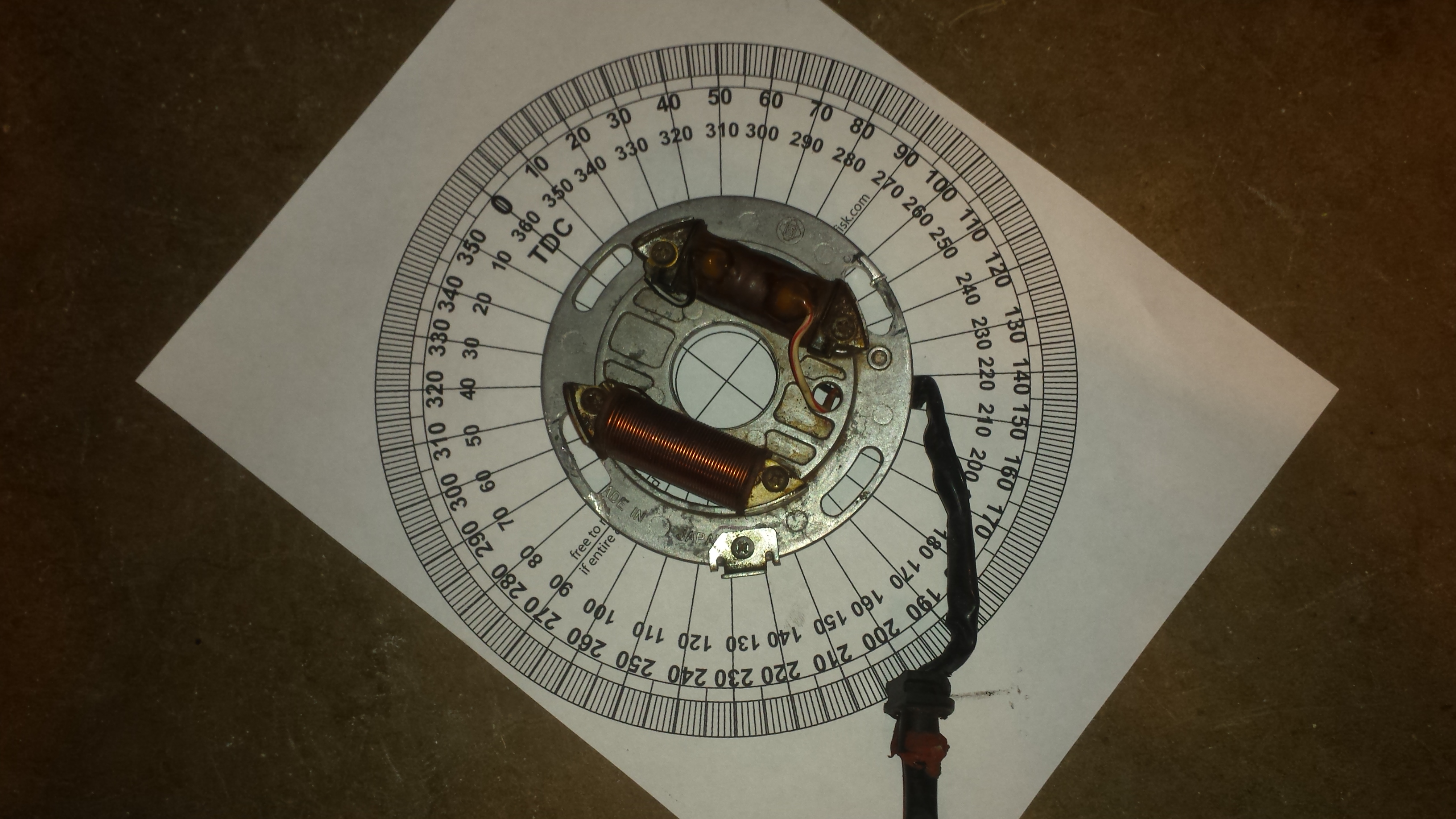

From stock position rotated counter-clockwise approx 90 degrees. The timing mark at TDC zero degrees is roughly matched to the timing mark on the case.

If you did it right, it could only be at 0 or 180. Otherwise you'd be in the original slots at 90 or 270. Referencing the the little triangle sticking out from the case at approximately your 10 or 11 o'clock on the case

Hi here is a pic of my stator as it is now.
So I have to go anti clockwise a bit more?

That looks 180degrees wrong. Exactly backwards. The coil that's on the left, should be on the right. The pic that I posted is almost the same orientation as it would be in the bike. Go back and look at my pic again. Source coil on left, lighting coil on right. Unless something about your bike is different than mine. I take no responsibility.

Yes got it, I will try it 180 about, thanks.

The black wire would run about 1/4th the way around (clockwise) to exit the case unless you really configure the holder. If anybody can explain better, feel free to jump in.

She lives! Re installed the stator 180 about and it's now running! Next question how do I set the timing correctly?
Here are some pics of the stator current position and the flywheel at TDC.

I had to do trial and error on the timing. Ride, adjust, repeat. When it got the way I wanted, I made a mark and went on about my business. Others might have better input on that. The way you have it now is as far retarded as it will go unless you lengthen the slot. My uneducated guess is that it might currently be too retarded... my uneducated guess lol

too far clockwise and the engine is better at low RPM but worse at high RPM.
find the position that is OK for power at all RPM
