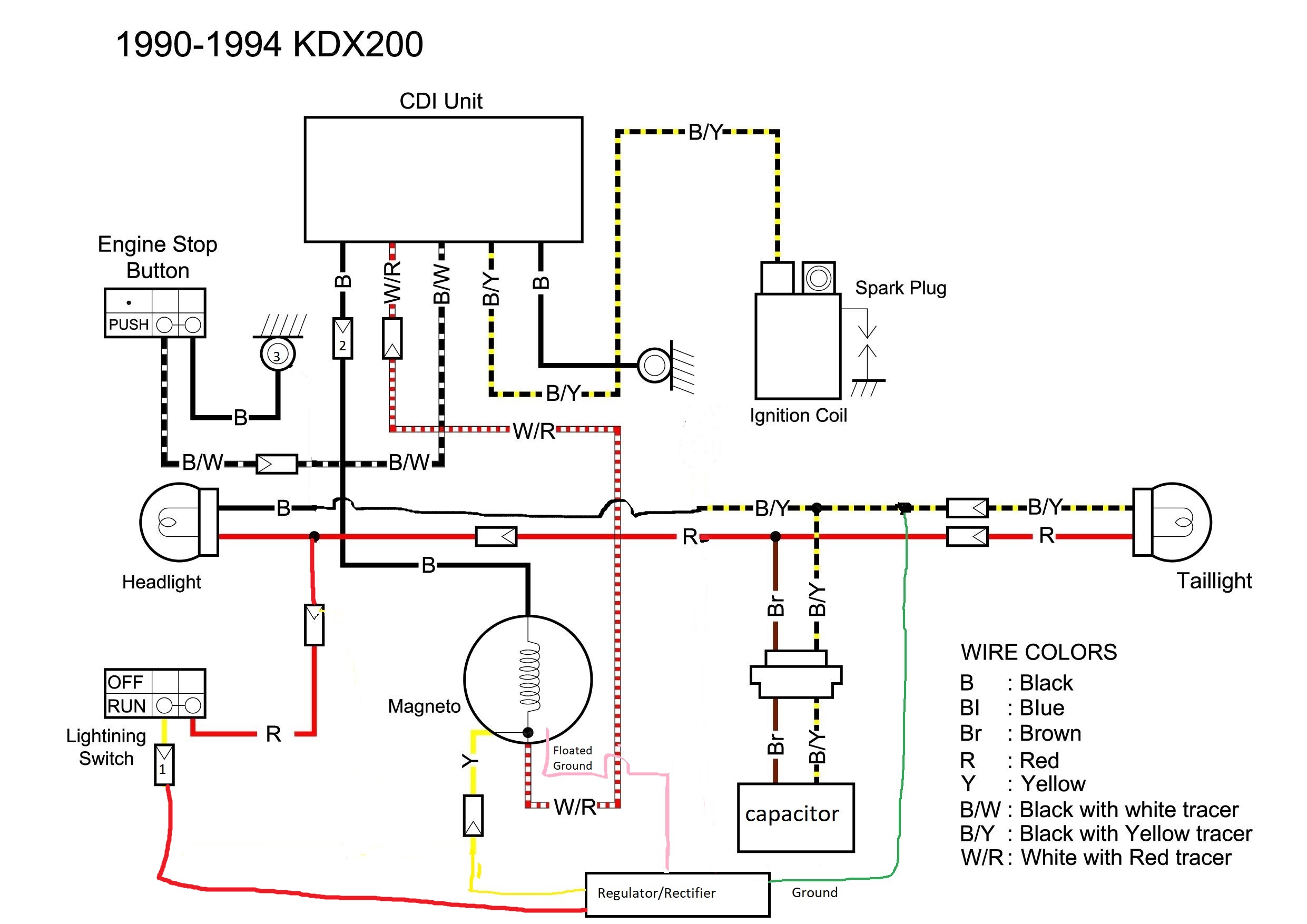

I'm wanting to add a voltage regulator/rectifier and float the ground so that I can run and LED head light. I'm hoping someone "bufftestor" can re post the images that photobucket won't show.

Does this look like I'm on the right track? Please excuse my crude graphics.
- regulator.png (216.35 KiB) Viewed 20480 times
- Posts: 3539
Re: rectifier / floating ground ? (ac to dc howto)
That will work, but you will only charge the capacitor when you have the light switch on. Not a big deal, but when you initially turn on the switch and the cap starts to fill you'll get dim output for a few seconds.

Thanks man, you have been a huge help. Looking forward to finishing this and posting results.
