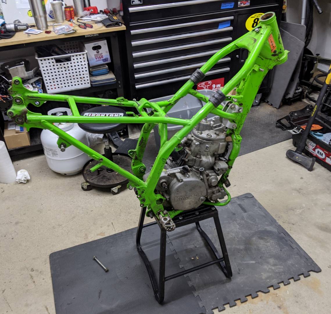

Thanks for the unlock. Here is the current progress. Spent a lot of time cleaning parts. I built a parts washer out of Harbor Freight parts and Simple Green cleaner. Works awesome on aluminum dirt bike parts. I will try to update this thread as I go. I need to source different triple clamps to work with the 1997 KX125 forks I have. I need to build or buy a bearing puller for the swingarm and linkage bearings. Will be slow progress but I am excited about this build again. Been 5 years since teardown.

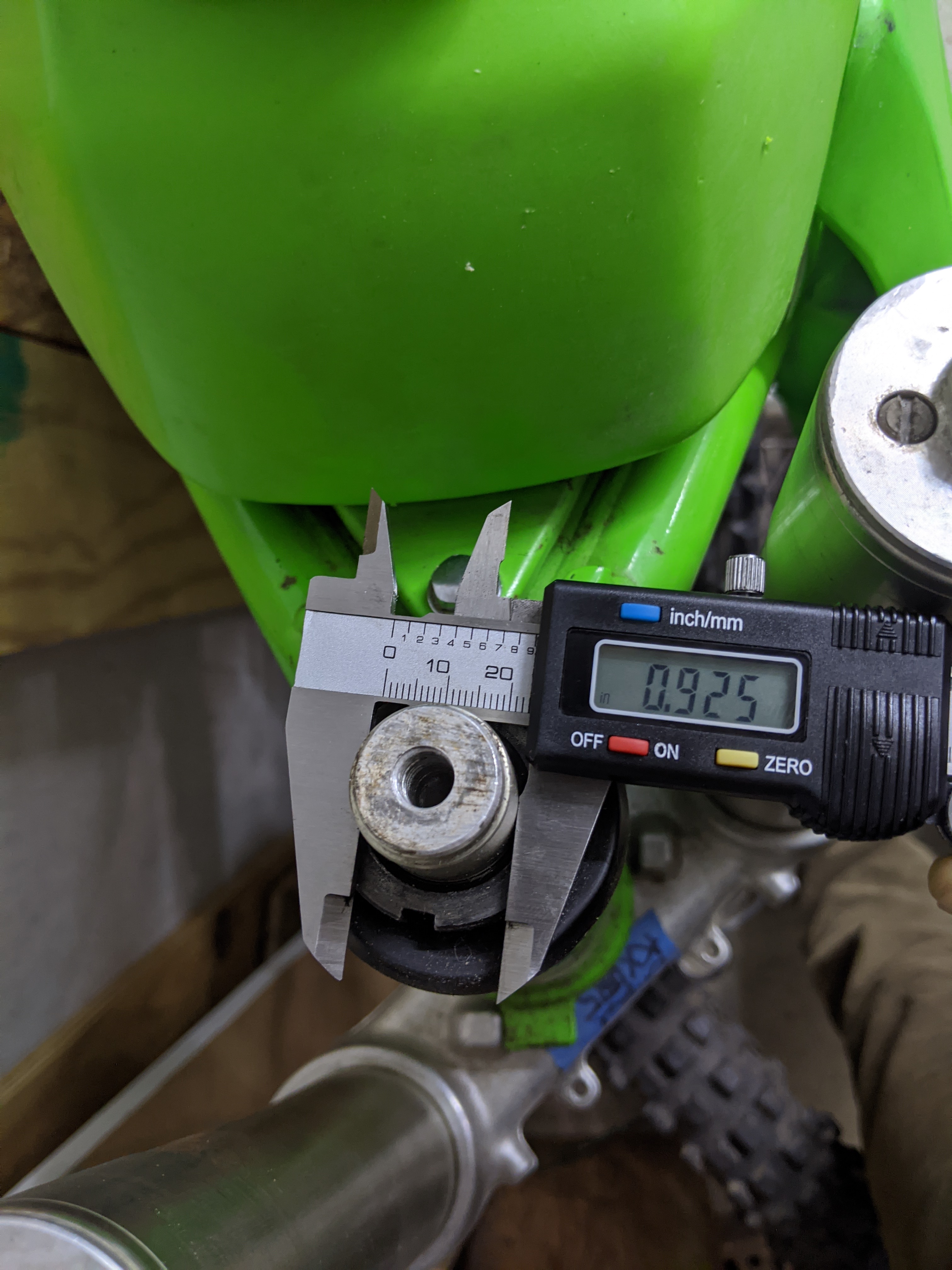

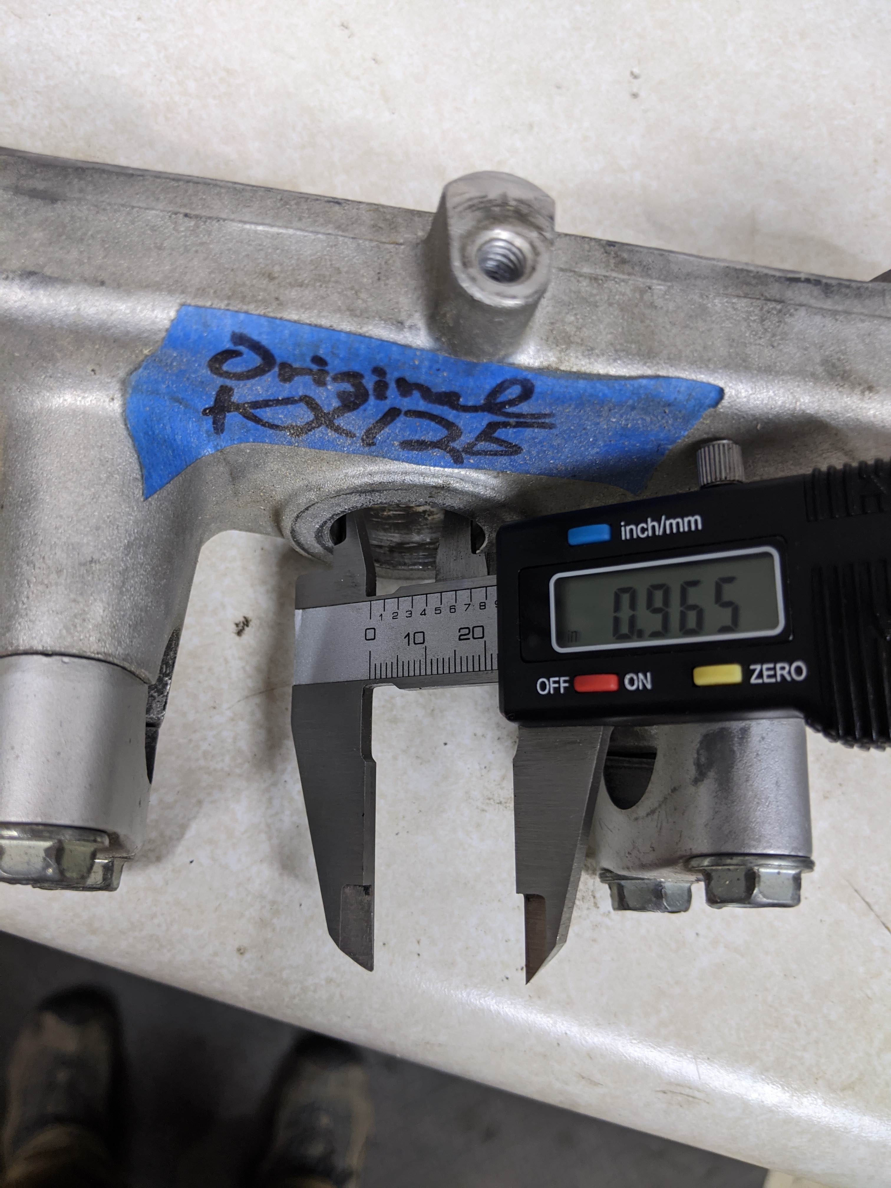

Slowly working on this project still... See attached pictures.
I am using the Stock KDX250 stem that pressed nicely into the 1997 KX125 lower clamps. The issue is the 0.040" clearance between the KDX250 stem and the KX125 top clamp. I need to take up the 0.020" gap. Any ideas?
Re: My $150 1993 KDX 250 rebuild
just buy some flat sheet metal and cut out a rectangle and stick it down inside there. I think I bought 0.025" LONG ago to put in there.
If all else fails, ... Coke can. :-)
The Coke can be used to practice on cutting it into a shape you need.
