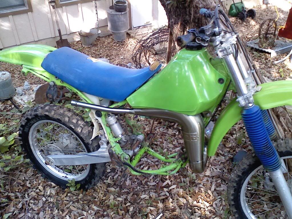

I'm getting really bummed out about the needle situation.Starting to think it's time to give it up as a bad choice.My wife is telling me to stop being pessimistic,we'll get it somehow.To that end we visited the local shop I talked about in an earier post.Was up there to see if he had a 5FL52,well he did till he sold it 3ish years ago.I was out taking the dog for a pee in his "junker yard" and what did I spy on a pile of forks but this
Does that look better or what?It even came with a clutch perch I was missing.
Had a battered lime green grip on it so I'm pretty sure it's Kawa perch but I'd like a confirmation please. While there we talked to the owner about the needle and missing airbox.He said he will have a look in his miscelaneos carbs box,no promises but.............
He also knows I need the airbox and from what I read into it he might just know a guy...................

not an 86 kdx perch. mine is much different. but it doesnt really matter what perch you use anyway as long as it works.

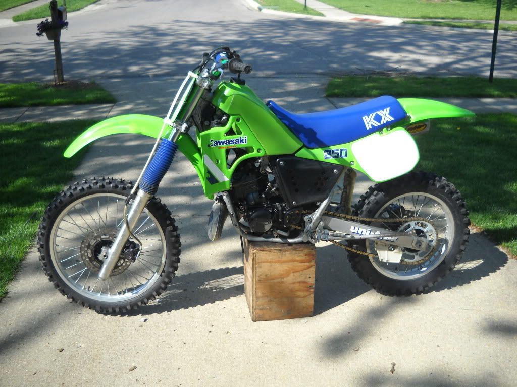

The 86 KX250 airbox looks very similar in this picture. Maybe someone can chime in here or you could check the part numbers and see if they are the same. The cover that is visible in this picture looks exactly like the one on my 87 KDX.
Goofaroo
- Posts: 531
- Location: Edmond, Oklahoma
Re: An ambitious 86 200 project
Nope. I looked up the parts fiche for the 250 and the 125 and they are different. You need to watch your local CL like a hawk for a parts bike.
Also, a complete airbox for a 1987 model just sold a few days ago for $20 on ebay complete with the boot and the lid. Keep watching and one will surface eventually.
I started by scraping all the white layer of sun rotted plastic off with a razor blade and a pocket knife. All the flat or outside curves I used the razor blade and for the inside curves I used a Buck 110 pocket knife. Start by scraping with the tank using about a 90* angle with straight even passes from one end to another. Try to stay at the same layer of plastic once you get down to the good stuff because it will continue to get darker as you go down and you will have dark splotches, you can kinda see it in my pictures if you look hard. You can do criss-cross passes to help even it out. Once you have the whole thing down to where you want it then start wet sanding it with your choice of grits, I only used 500 but It would probably be best to start at 400 then go to 600 and end up at 800 or so. After that then start with a fairly heavy compound on your buffer. I used a wool pad on a high speed bosh drill, It seems to work best when it gets a little warm but stay moving constantly.
Tony
