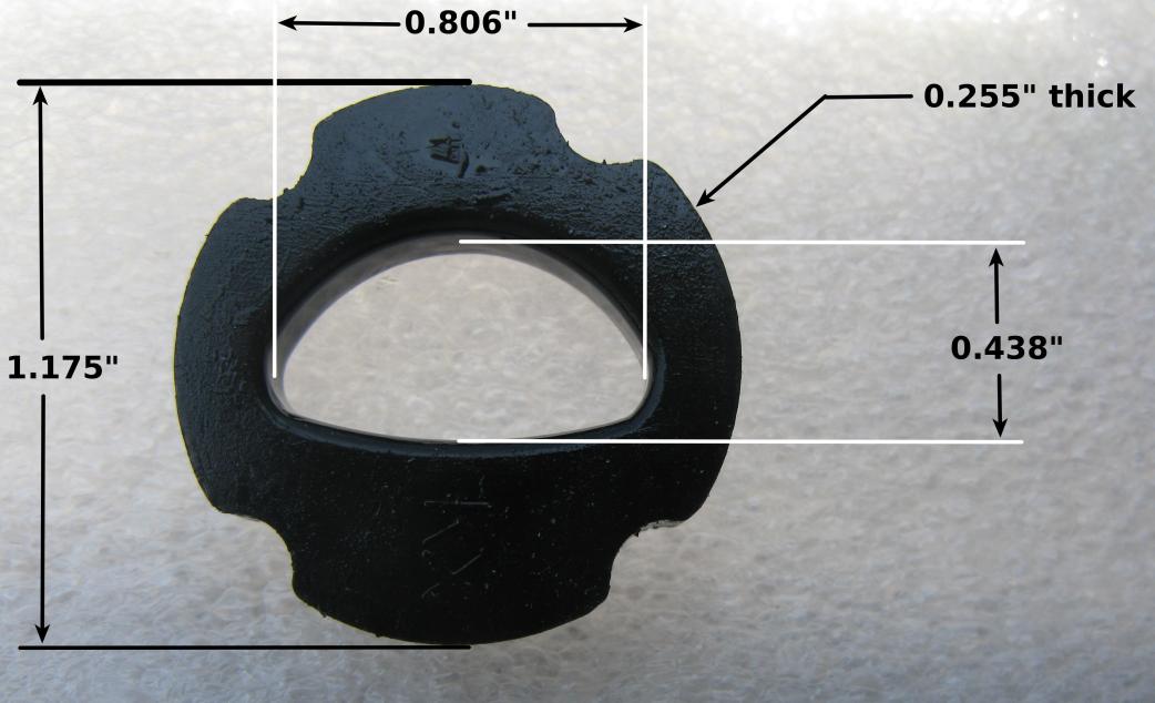

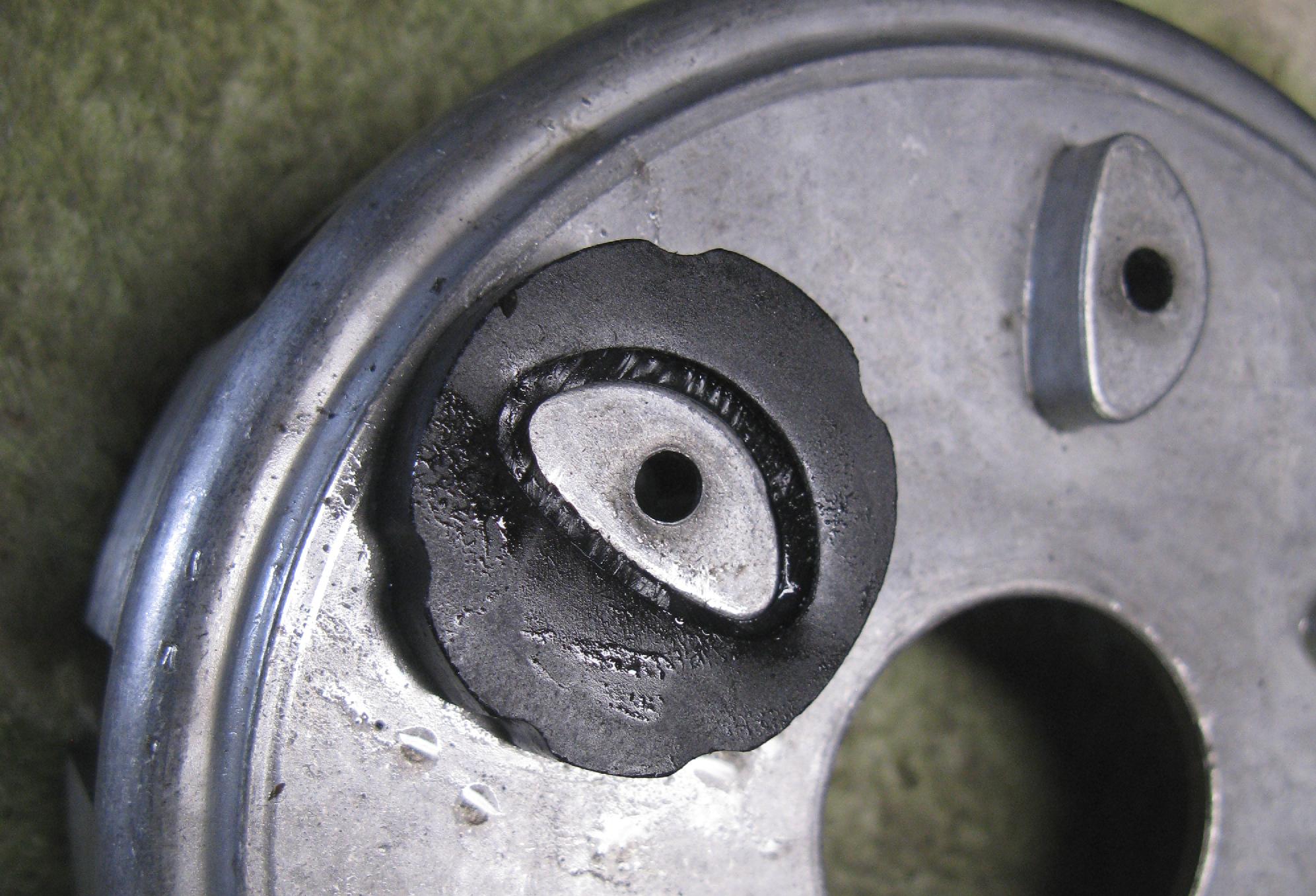

I got ahold of the KX80/85 clutch cushions and tried them out. The outer diameter is fine but the inner "D" is too large with a lot of slop. Digging through the junk box I found some vinyl tubing just about the right size. With a little heating I got it over the "D" post on the hub and trimmed it flush.
Clutch cushion shim
_click image to zoom_
The fit came out great!
Fitted clutch cushion

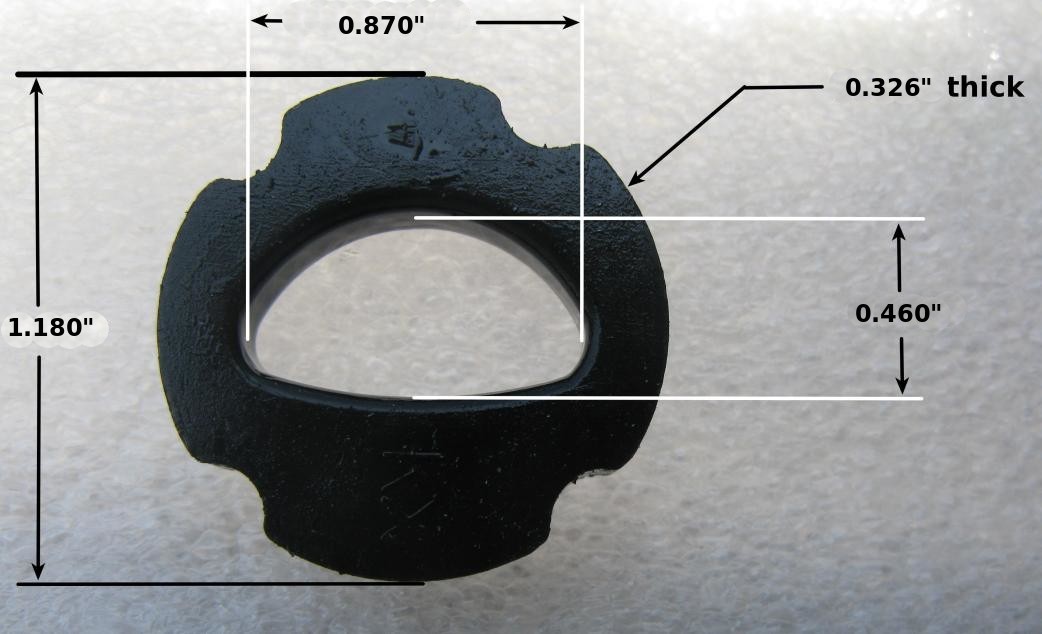

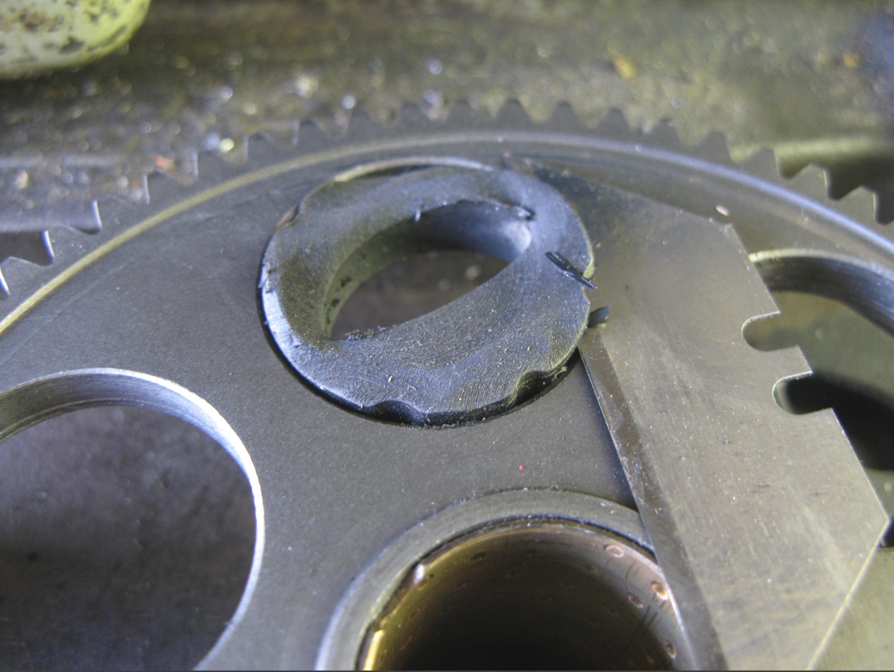

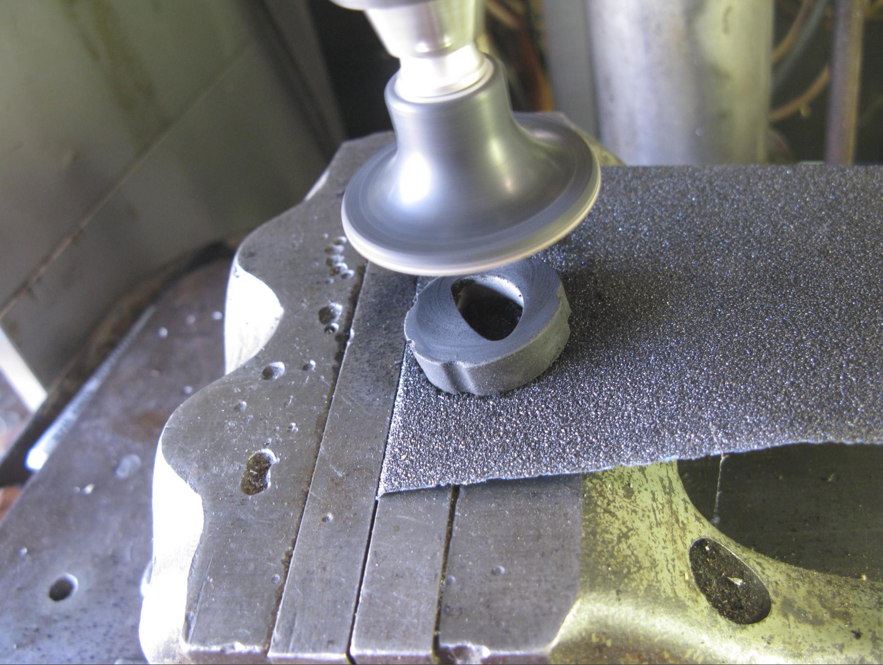

Next, the thickness of the KX80 version is too great so I tried a few ways to shave off a bit. Grinding seemed like a nice square method but the rubber kept flexing and came out anything but square.
Rubber grinding
So back to the basic razor blade. I used the 6-holed disk from the clutch hob to hold the rubber cushion while cutting and to set height at which to cut. The first one is chewed up a little from grinding but should be fine. Five more to go and then I can decide on rivets or machine screws for assembly.
Trimming to height

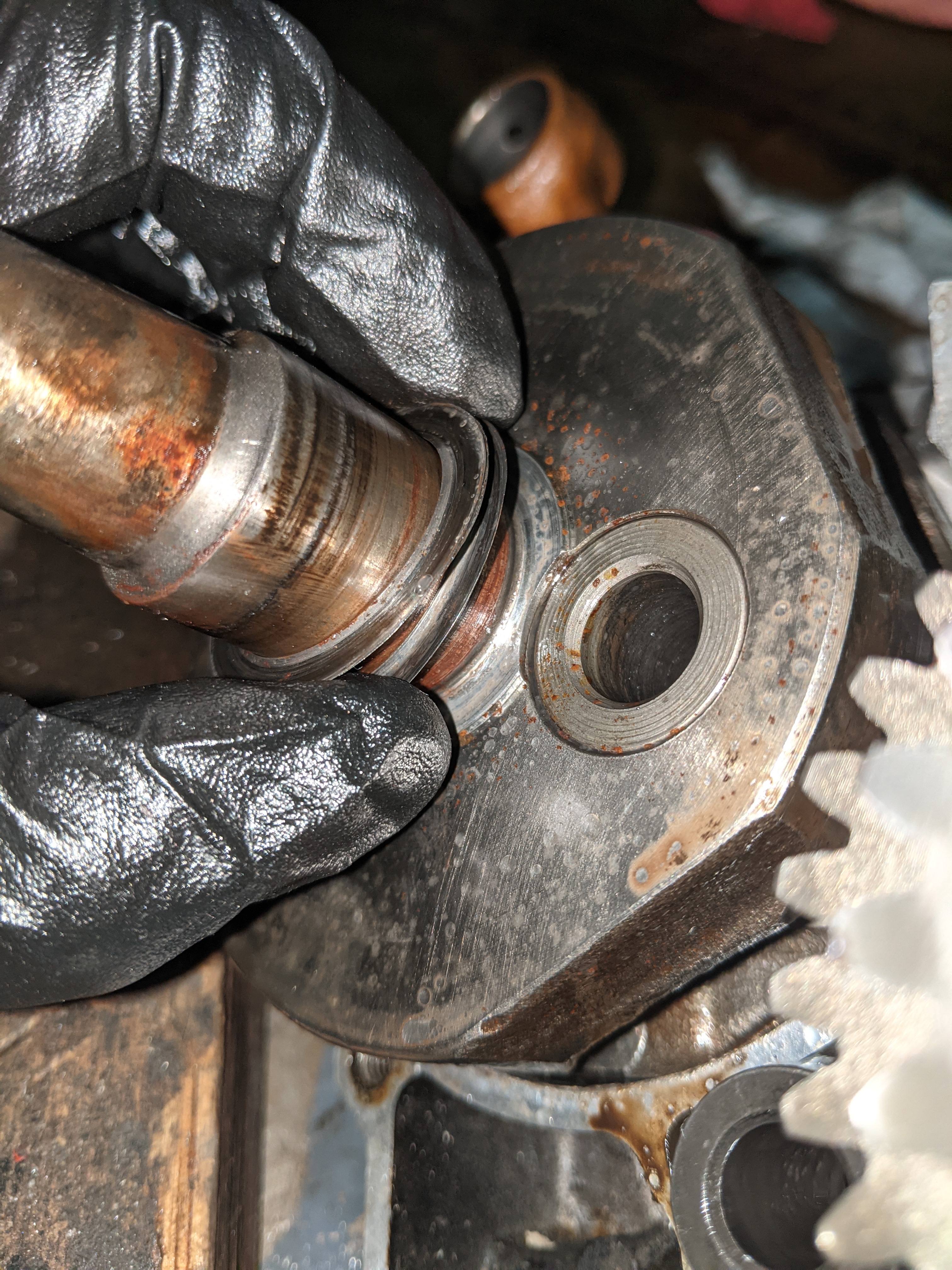

i just pulled a kdx175 motor down mine has very thin shims between the crank and bearing, i couldnt see this in you photos, i had a look at parts diagram and unable to see these shims. just cuirous thanks!

kaiser, can you post some pictures? That does not sound correct (as delivered when new)

Yea I thought it was odd as well. Here is a pic same on both sides.

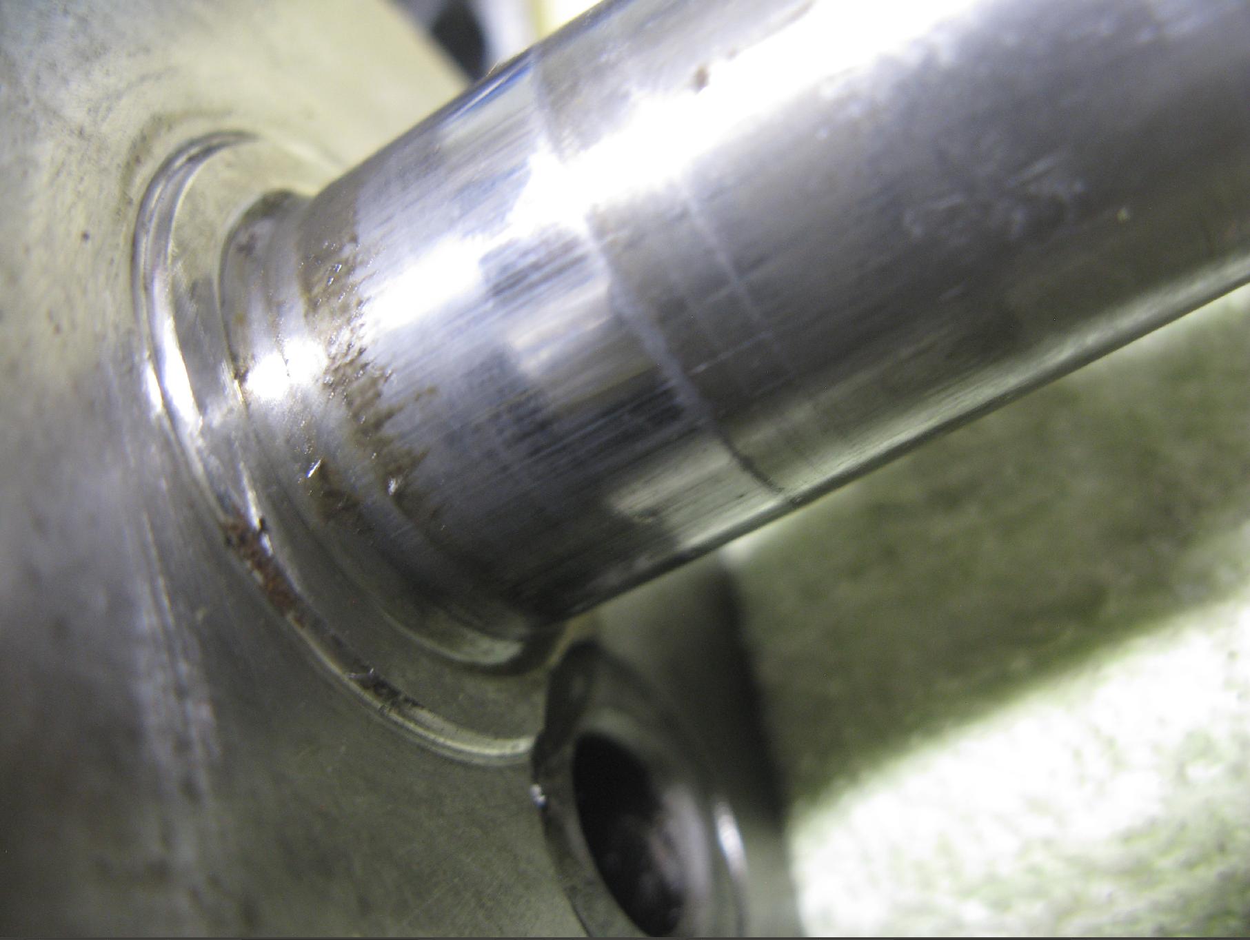

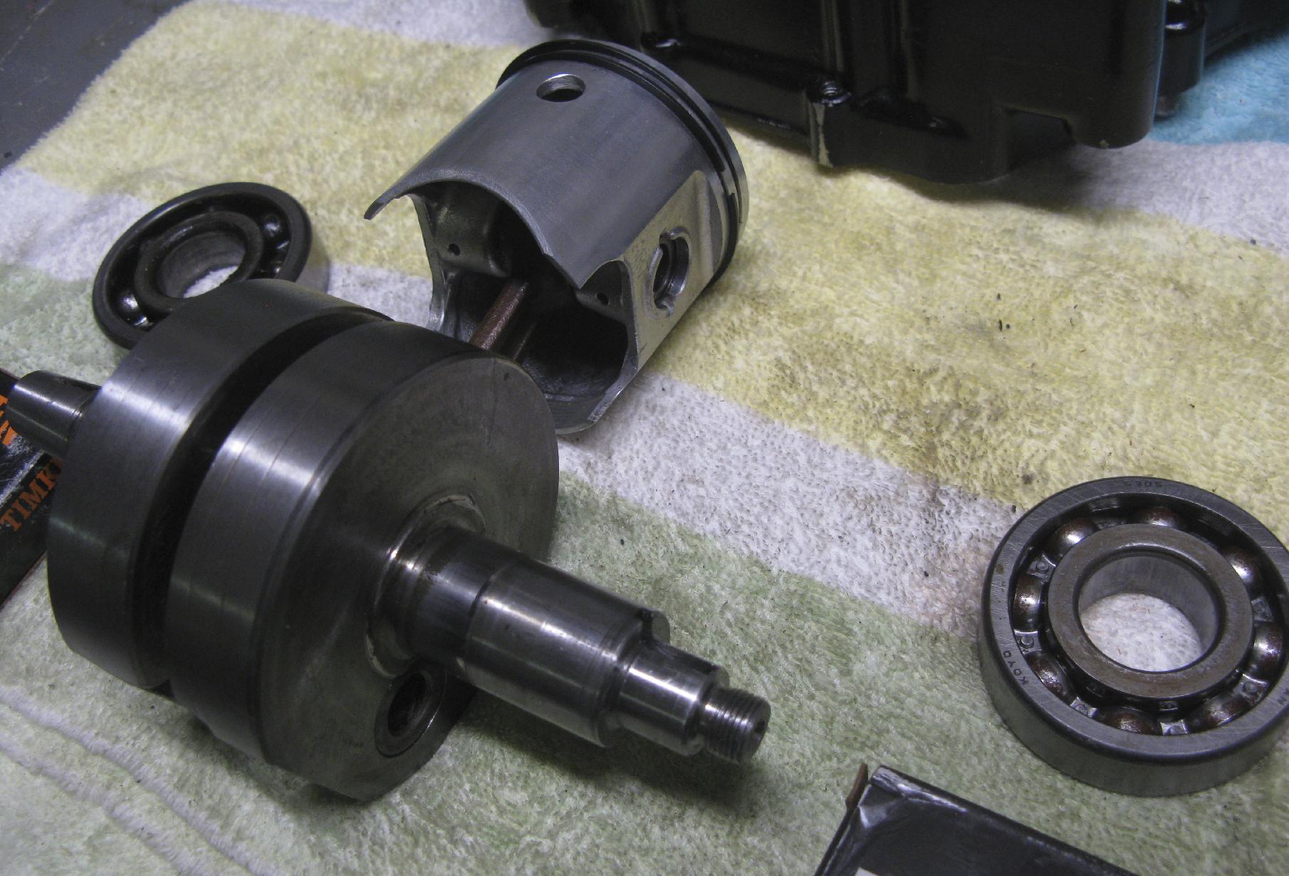

Hi Kaiser, Here are some additional pictures of my crank. I do not remember any shims between the bearing / web - I definitely do not remember two shims. And, I don't think I see any in the pics or layout. I am pretty darn sure I had no such shims.
No crank shims
The shims in your pics look thick enough to tell if things are binding up on reassembly. I would be surprised if the factory tolerances were that loose - but, maybe. Or, maybe some work was done (to clean up some damage?) that took off some metal somewhere.
If it were mine, I would do a test assembly without the shims and use a press to see if I could move the crank (wedging the crank with a chisel placed opposite the rod of course). A dial indicator or dial caliper would probably work if there was a good reference surface.
Or, I would just assemble it cautiously and check for binding by hand and watch for a small gap between the cases (mine had no gap after pressing together).
Actually, come to think of it, I am glad you wrote - my motor has been apart by a previous owner who performed some slip-shod work - my motor could just as easily be missing shims! I just finished the clutch hub (riveted, post coming) and will be putting the motor back together next. I will definitely check crank clearance.
Let us know how it goes and feel free to post again - I am interested to hear of you progress!

I have seen washers on both sides of the connecting rod. Like thrust washers. Other Kawasaki 175's had them. I wonder?

so i assembled without the shims, found i could push the crank side to side by about .25mm have decided to pull down my other kdx175 to look and no shims,
I have split the cases again and will put the shims in and see how it all goes.

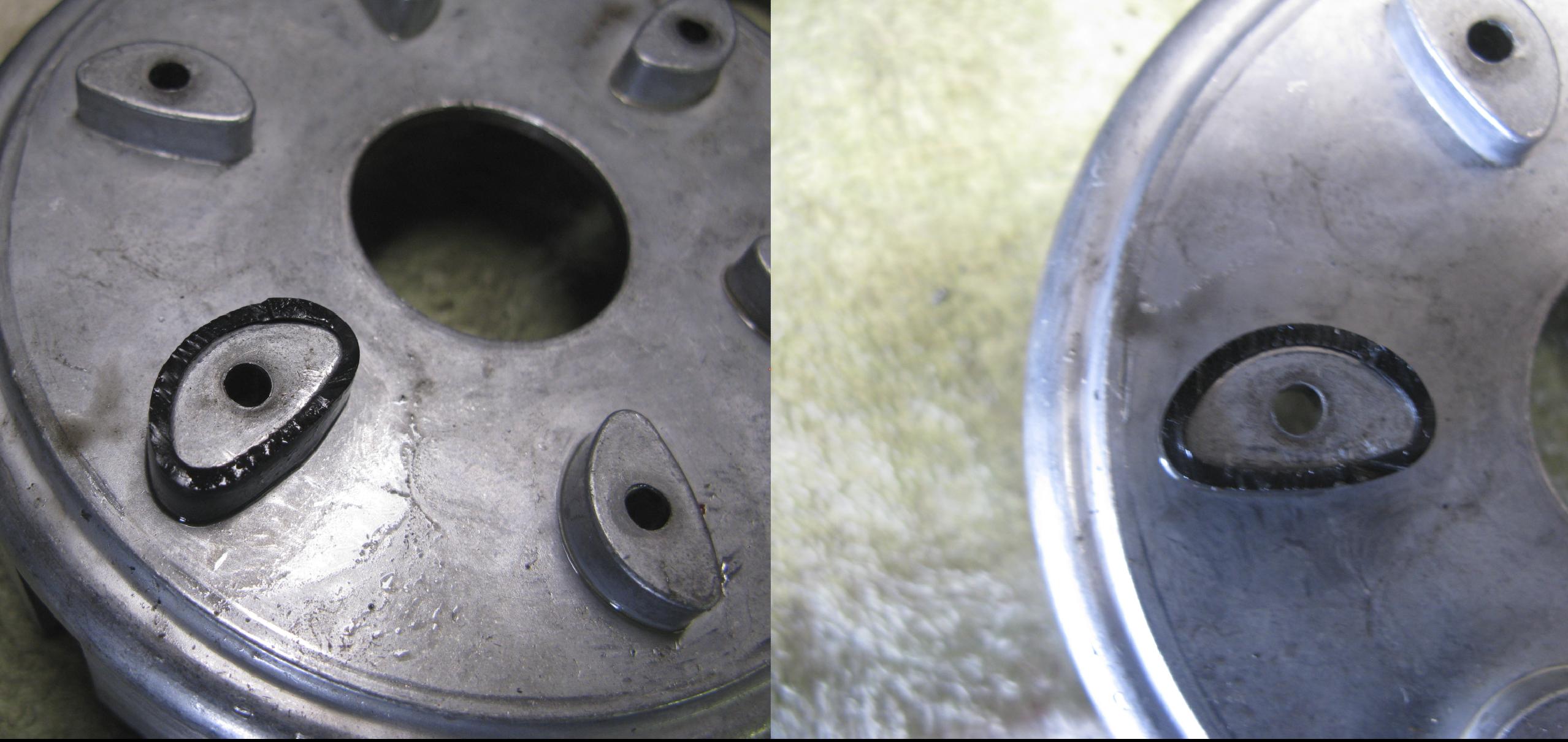

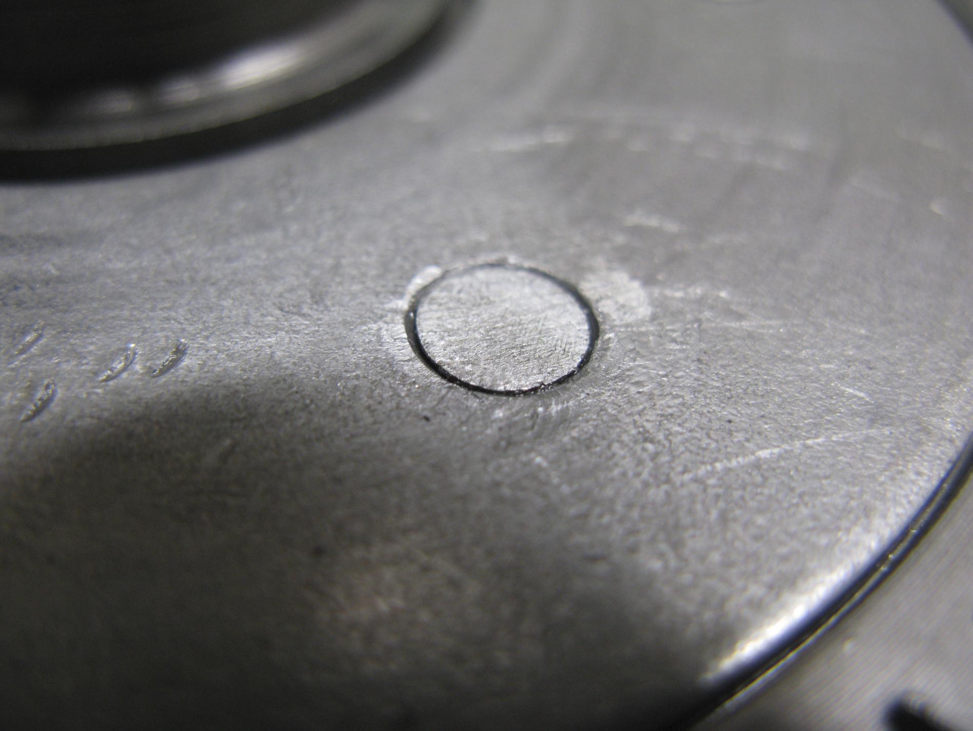

Back on my clutch with new rubber cushions - screws or rivets? I had a friendly back and forth with the local rivet place (Hanson Rivet) and they sent out their closest match. They were a little bit under on the diameter but seemed close enough.
My alternative would be to tap and use machine screws with loctite (which is not uncommon on replacement kits for clutch cushions and hubs).
It seemed like either method would be ok so I flipped a coin and went with the rivets.
Clutch hub riveting
_click here to zoom_
It did not take that long to hammer 'em down, some came better than others but, overall, I am quite happy with the result - one less thing to worry about coming apart :grin:
(Details and part numbers will be in a later post.)

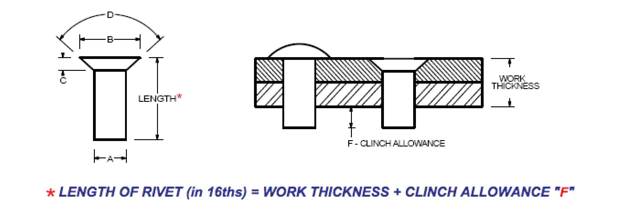

KDX175 Clutch Hub Rubber Cushion and Rivet Details

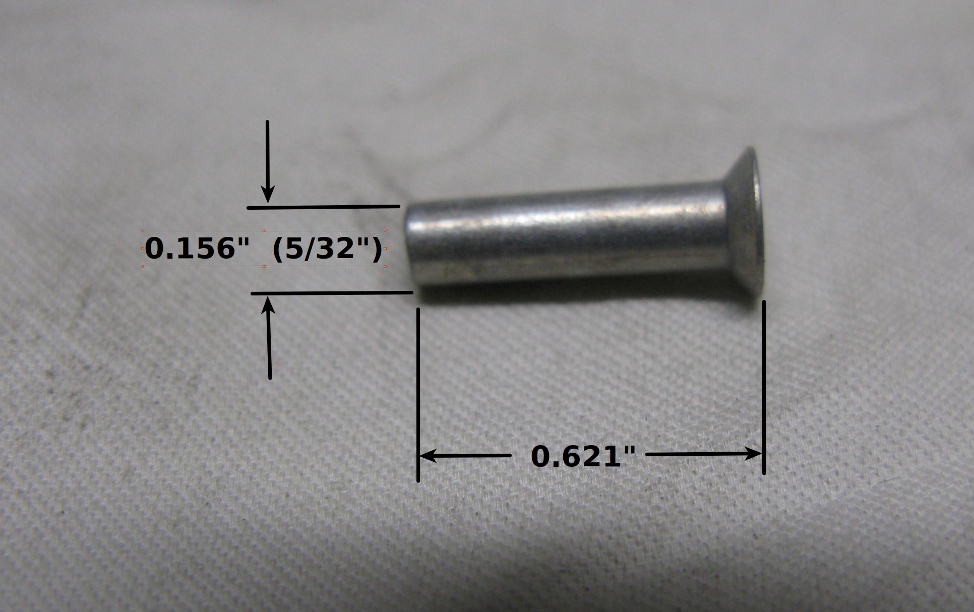

The clutch hub replacement cushion seems to be unavailable for the KDX175. The closest match that I could find is the KX80/85/100 '88-20. It is slightly larger than the KDX175 cushion and needs to be shimmed for a snug fit on the "D" post. The cushion also needs to be sliced slightly thinner to fit (see a few posts back for details).
The rivets are not listed by the parts suppliers and, presumably, are not available from Kawasaki. Working with a local rivet place, I used a close match to great success.
Part numbers and sources follow. See a few posts back for dis-assembly / assembly details and photos.
Quick list
Sep 30, 2021
OEM KDX175 cushions
Closest replacement KX80/85/100 '88-20 cushions
Rivet diagram
Replacement rivet - allow 0.156" Clinch Allowance for total length of 0.621"

Rivets
Rivets are also unavailable from the usual motorcycle parts sources. The rivet place I went to had a close
 match that was fine. If you contact other rivet houses, however, you may find a rivet with a closer match
 of the diameter.
Rivet Manufacturer and Supplier
Hanson Rivet part Number  Description
   Countersunk Head       Steel rivet, countersunk head, 5/32" diameter, 0.621" length
https://www.hansonrivet.com/rivets/solid-rivets/commercial-solid-rivets/
 - call to inquire
 - ask nicely and a sample of 10 rivets cut to length may be forthcoming :-)
 - the OEM rivet has a diameter of about 0.167"
 - the new rivet has a diameter of about 0.156"
