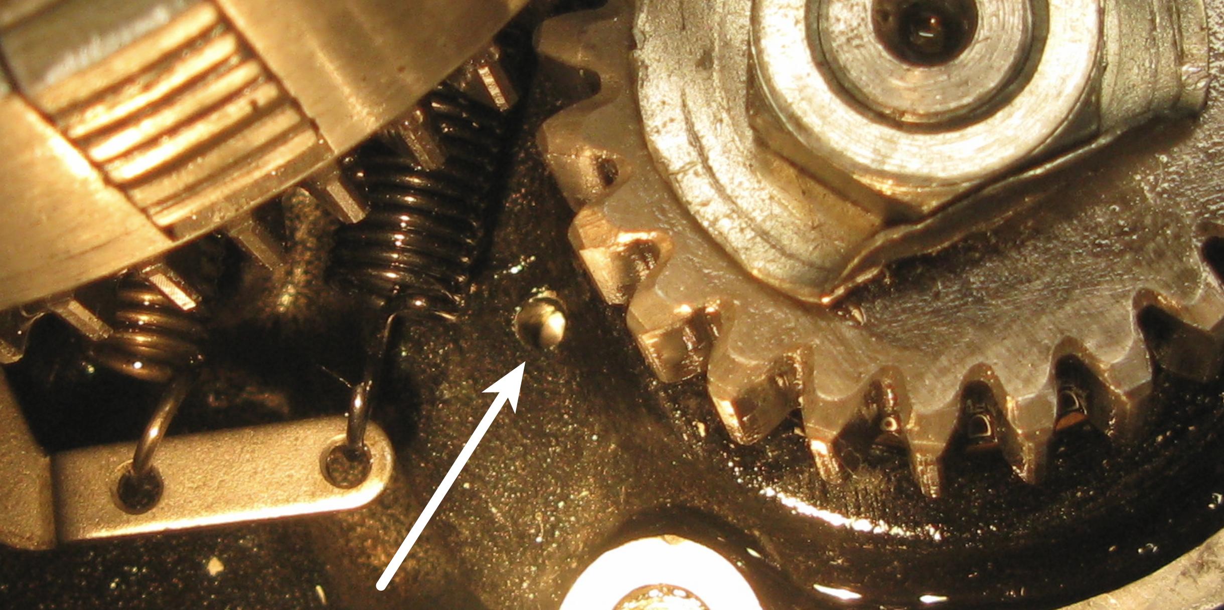

Thanks for the suggestion, this is a good idea. Here is a closeup before JB Weld.
1 of 3 holes

Welding the little crankcase holes
The first step was prep, grinding out all of the JB Weld that I initially used to plug the holes. At the time, the engine was mostly assembled so JB Weld was the easy choice. Now, that the engine is back apart (to try for a better crank seal install) the suggestion to weld those holes was apropos. Drilling out the holes one size larger got all of the JB Weld out.
Weld prep
_click image to zoom_
I looked up an old buddy and he came to the rescue (thanks Kimo!). He plugged two holes from the outside.
Plugged holes
The third hole was buried in that narrow space so it was tackled from the inside.
Third hole - plugged
The inside weld needed to be smoothed down as the crank bearing mounts here. Fortunately, a bit of variation in this area should not be too critical - only a small part of the machined surface is effected and its purpose is to locate the bearing axially on the crank. A little drill press rigging was fine.
Cleaning up the inside weld
It came out great :grin: so I went ahead and pressed in the seals - making sure to use a sealer this time!
Cleaned up and new seals installed

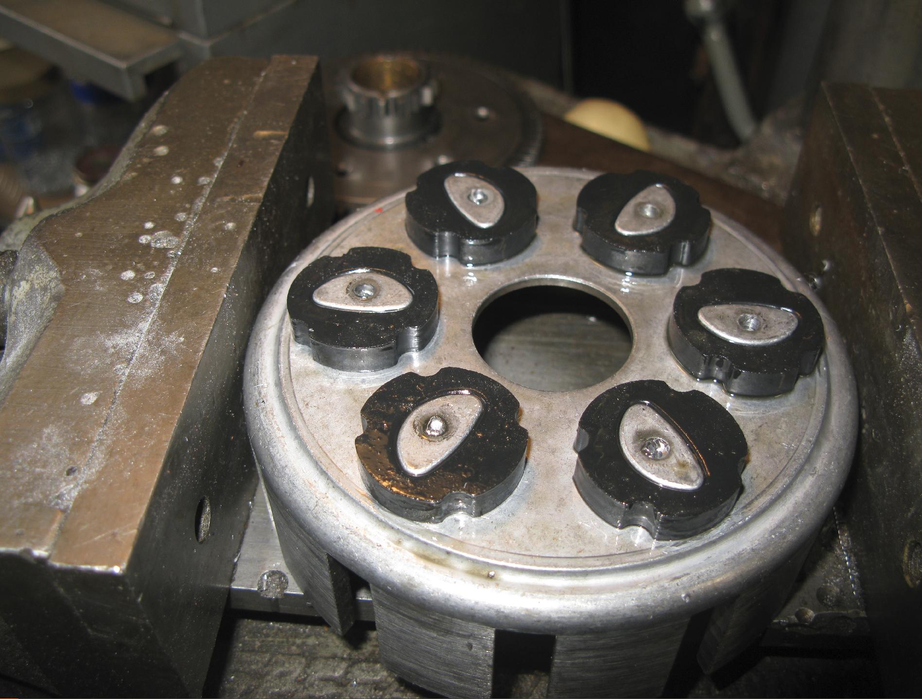

I got the rivets out and looked inside of the clutch basket:
Original Clutch Basket Rubber Cushion Bumper Dampers
Now I see how this works. This is the first time I have had one apart and I have somehow never looked at pictures - I assumed it was solid.
And, I can see how the rivets just hold things together without transmitting any torque
The hard part looks to be sourcing the rubber dampers as I see about a half dozen Kawasaki versions exist. If anyone knows the right version, please let me know! I will do some calling around and see if someone can take some measurements too.

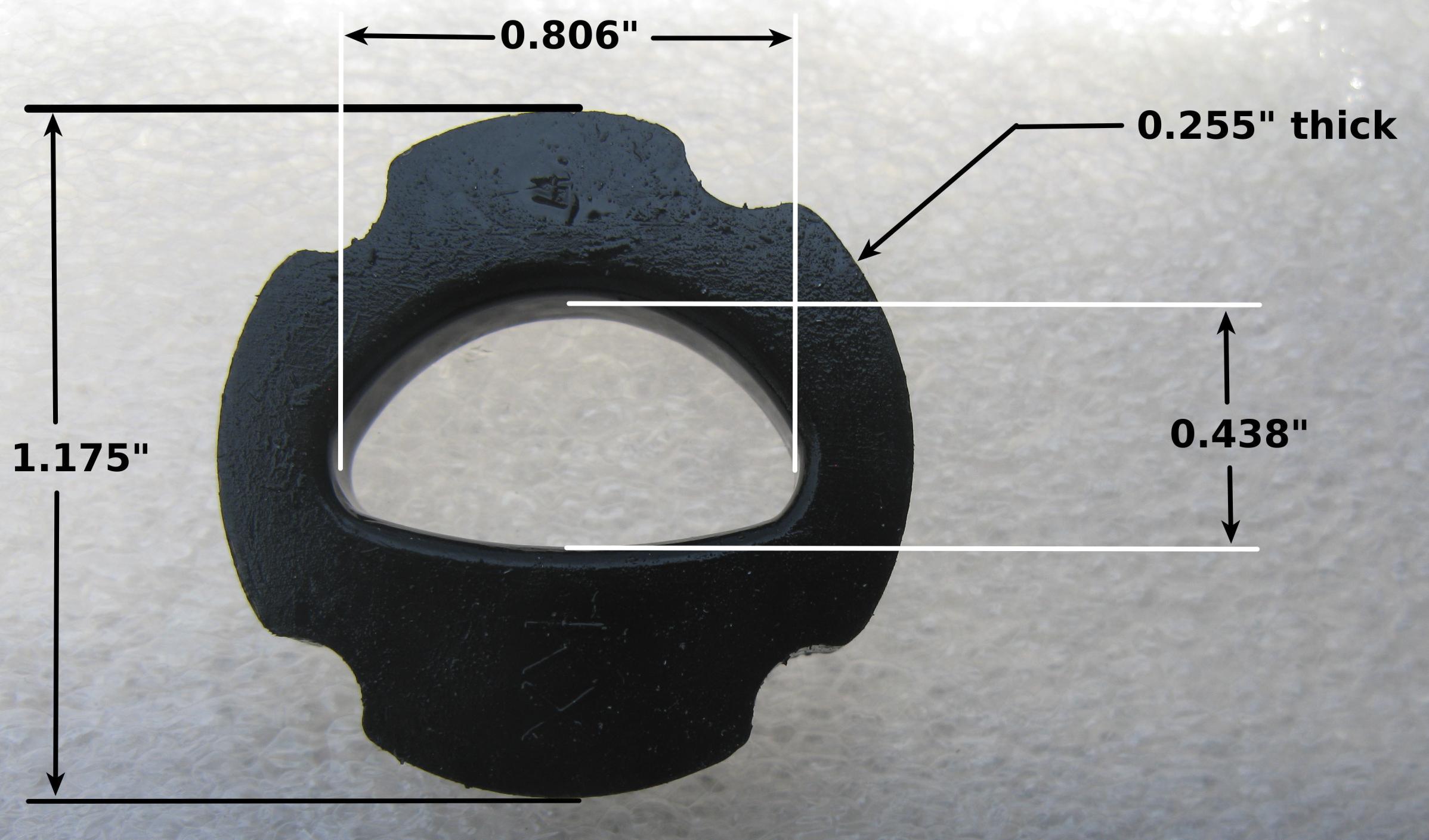

Here is what I have found on the the rubber clutch dampers (cushions) for the KDX175:
KDX175 clutch damper (cushion)
With help from HinsonRacing (thanks Robert!) it was determined that an exact match might no longer be available. The KX80/85 is pretty close but measures slightly larger. In particular, the inner "D" shaped hole might be too loose. Once I get the KX80 version in my hands, I will know for sure and, at that point, maybe I can shim somehow if it is too loose.
A better idea (or a closer replacement) would be welcome! Perhaps, given the correct rubber material, I could cut some on a laser cutter.
