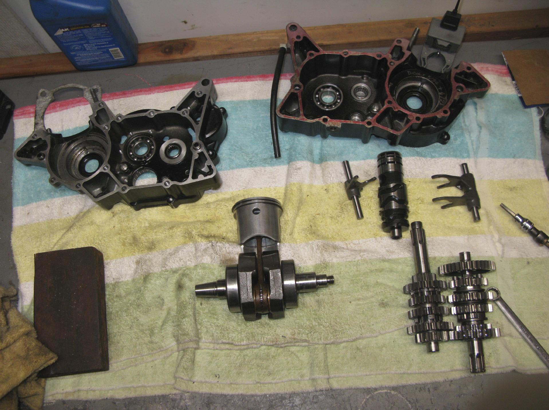

The engine is now pulled apart for crank seal attempt #2. The first attempt failed the leakdown test and air bubbles appeared around the outer edges of both seals.
Engine back apart
_click image to zoom_

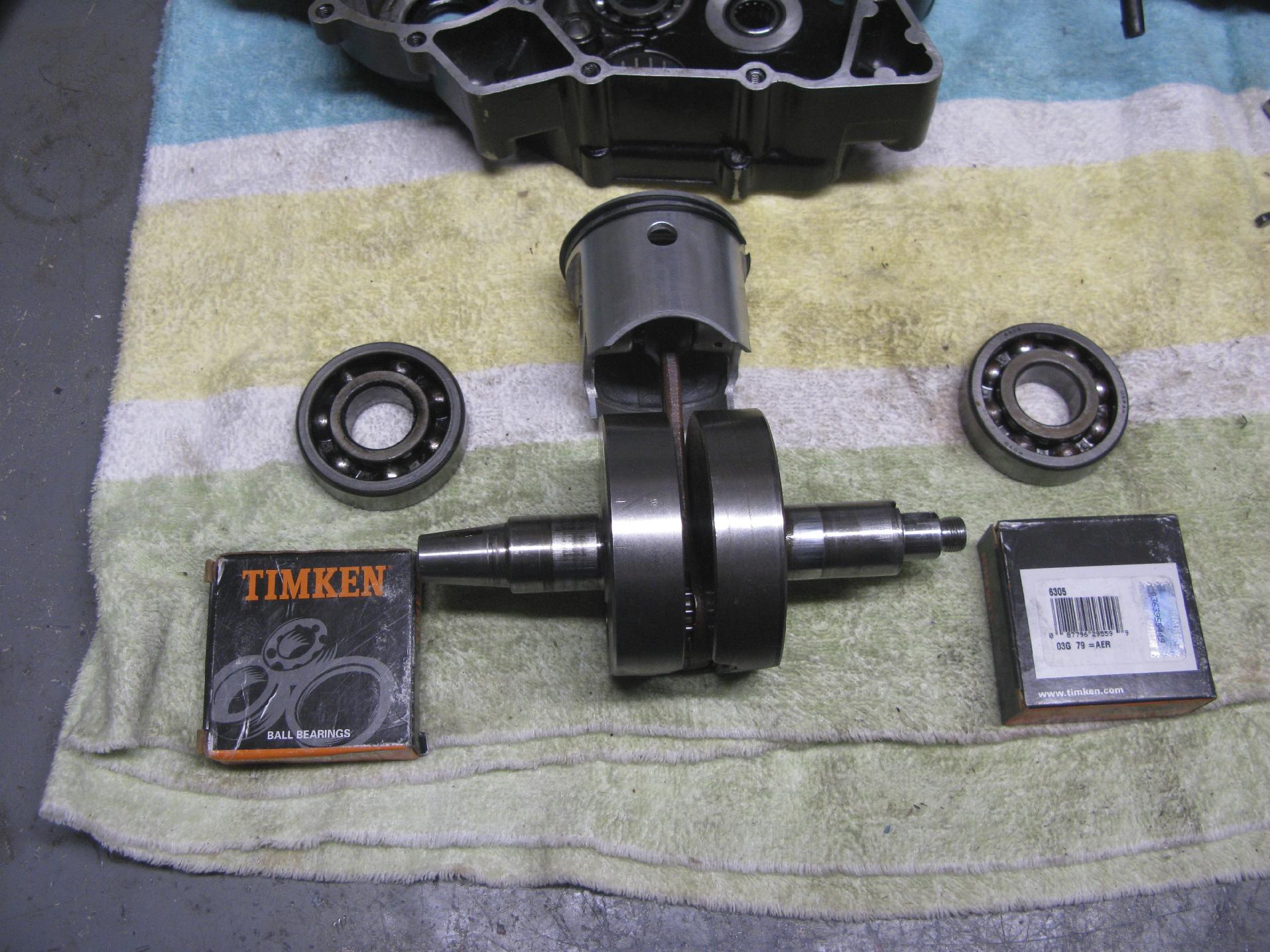

With the crank out, it seemed to be a good time to think about bearings. Although bouth had a good feel, one came with the bike and one was a replacement - both from about 30 years ago. Replacing with Timkens (6305) is easy at this point. Step one - remove the old bearings with a bearing splitter and press.
Old bearings coming off
The new bearings matched up so the crank was taken to the freezer.
New bearings - 6305

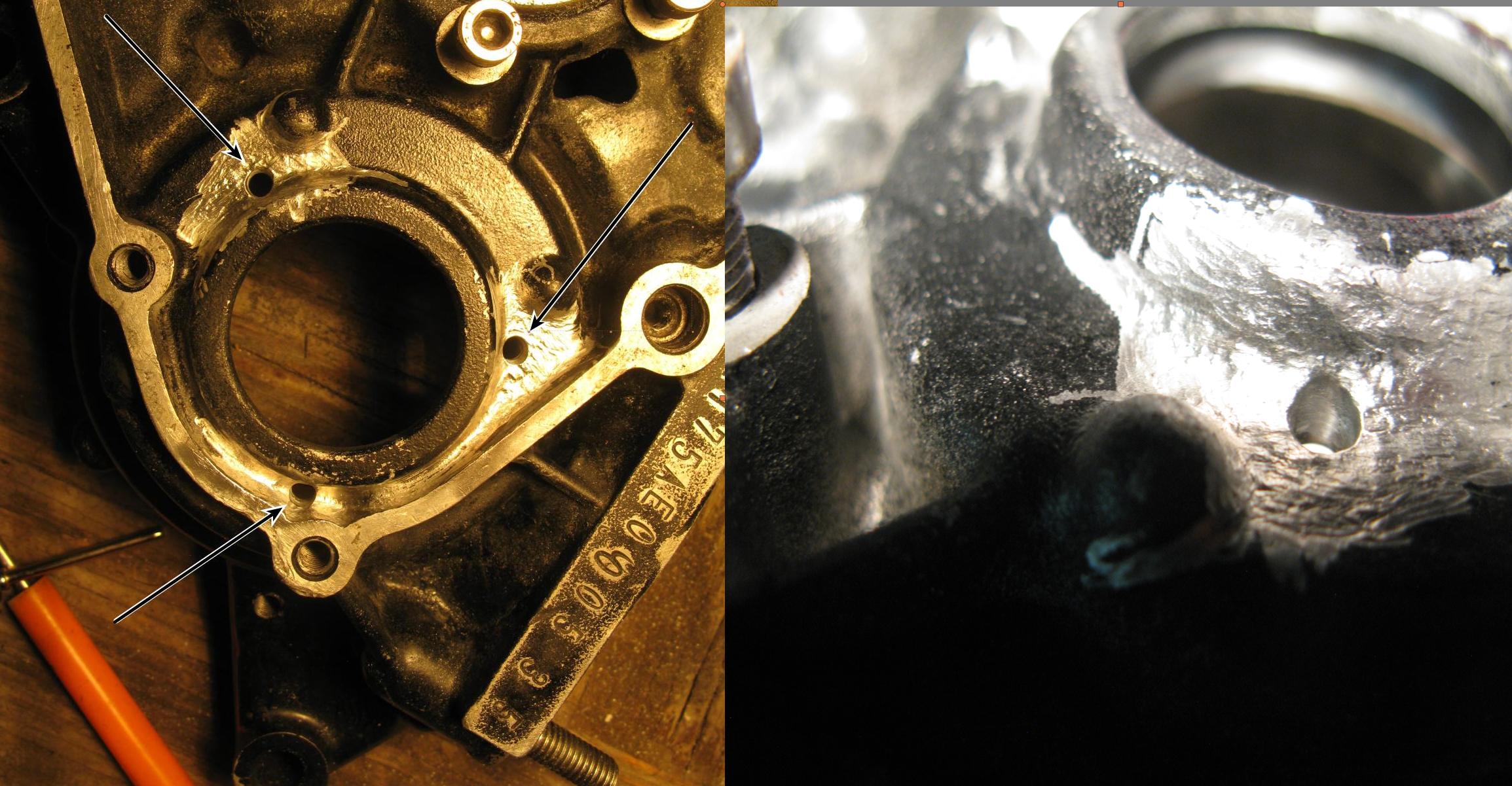

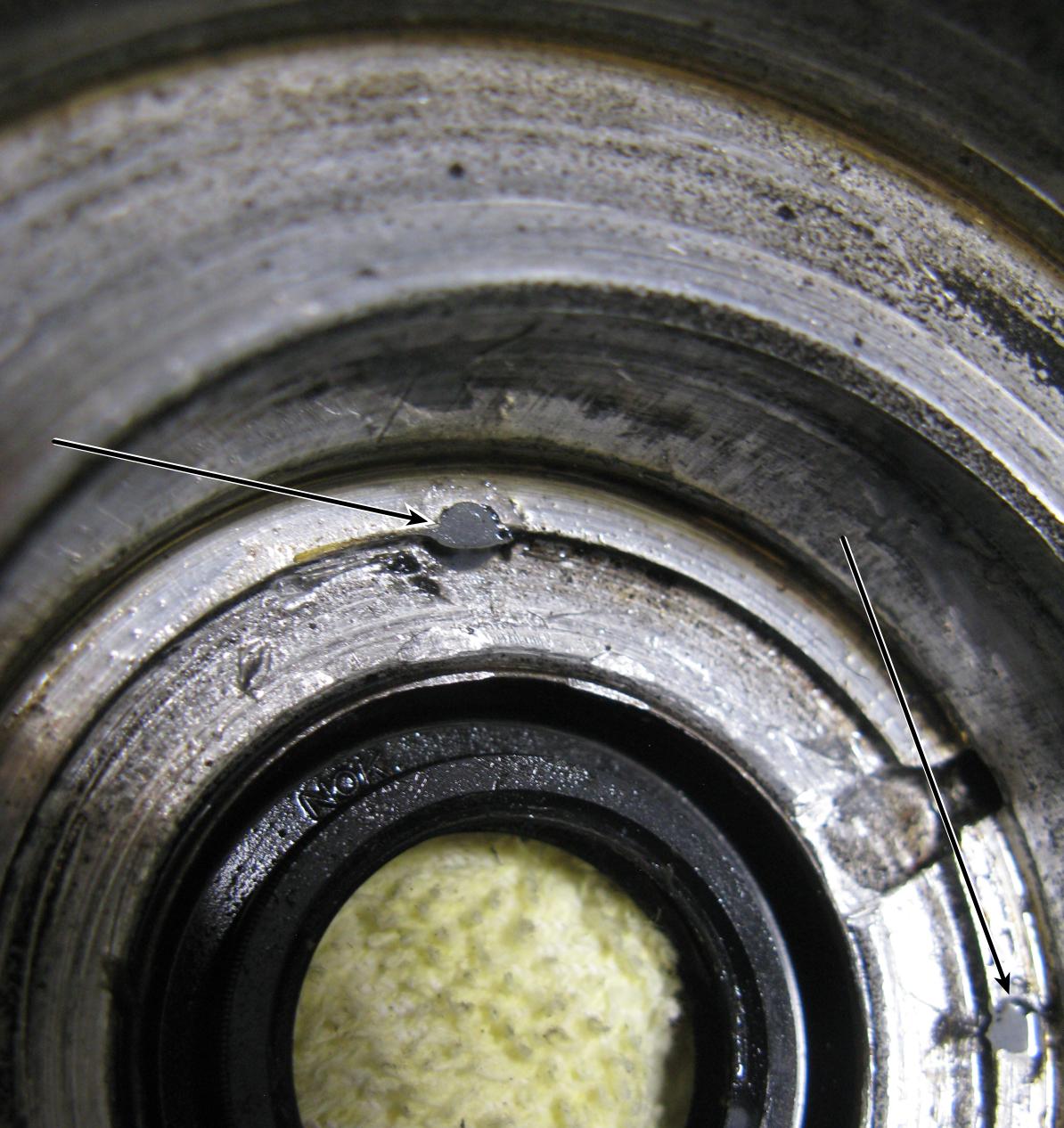

Here is an inside view of the errant holes a previous owner drilled through the crankcase (possible for bearing removal). They look nicely sealed :grin:
Plugged holes behind bearing
Now is a good to clean off the red Loctite sealant while the crank is freezing. I like Locktite products but am doing some research about sealants - I may end up switching.

any thoughts to take the case half to have it TIG welded and sanded down?
Molly's 70 on here is a welding guy. See what he thinks.
Posts: 669
That might be a tough one to get the tig torch positioned right & still be able to see what your doing. I need more pictures of both sides.

OK, I went back to refresh my memory. I think I could get to it from the outsides of the cases. It would be nice to have closer-up pictures.
However, If those holes were plugged with JB Weld,(I think I read that) its pretty much a "no-go" unless every bit is removed. In fact, JB weld might be a good solution in this case.
Thanks for the suggestion, this is a good idea. Here is a closeup before JB Weld.
1 of 3 holes

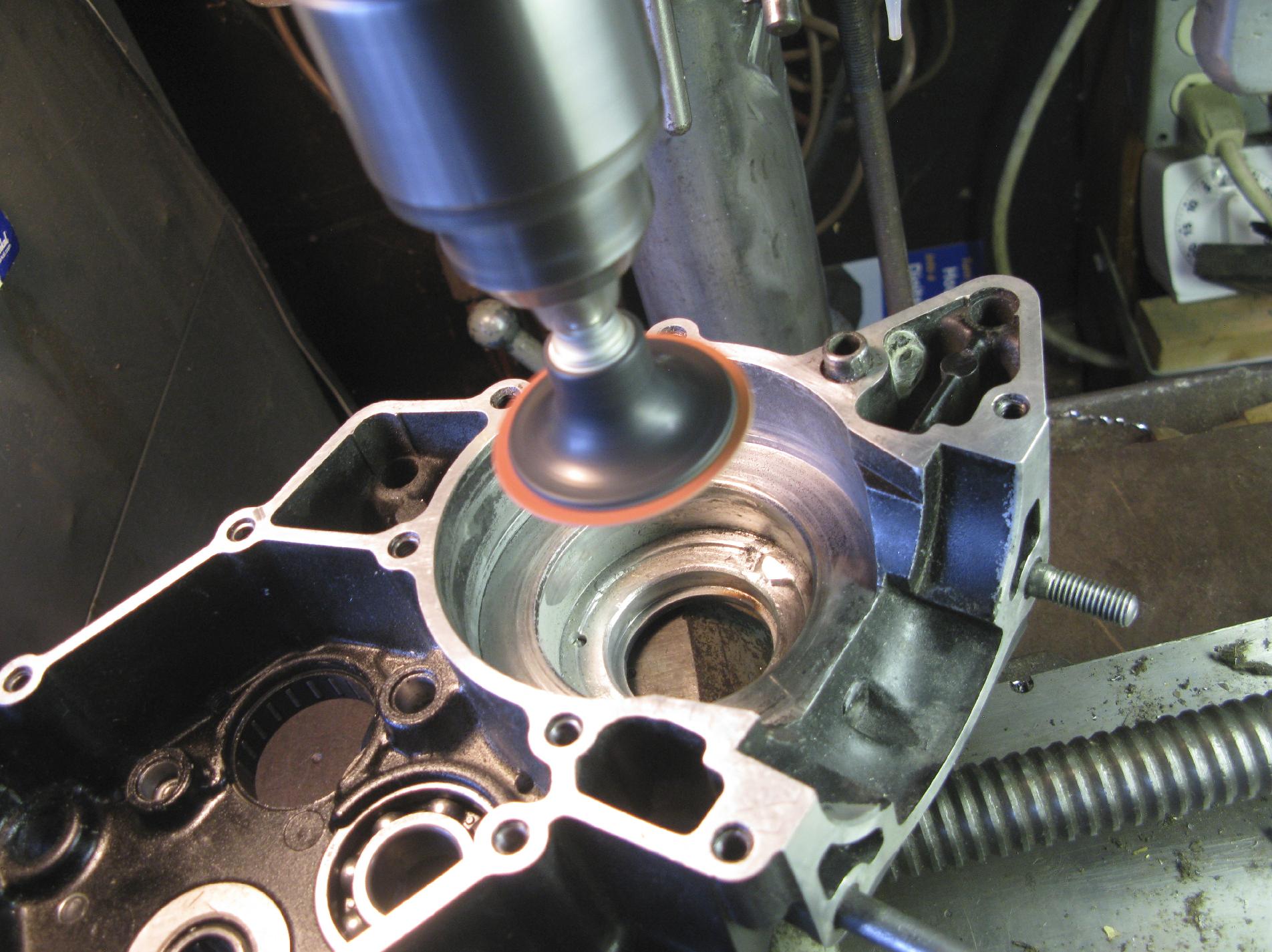

Welding the little crankcase holes

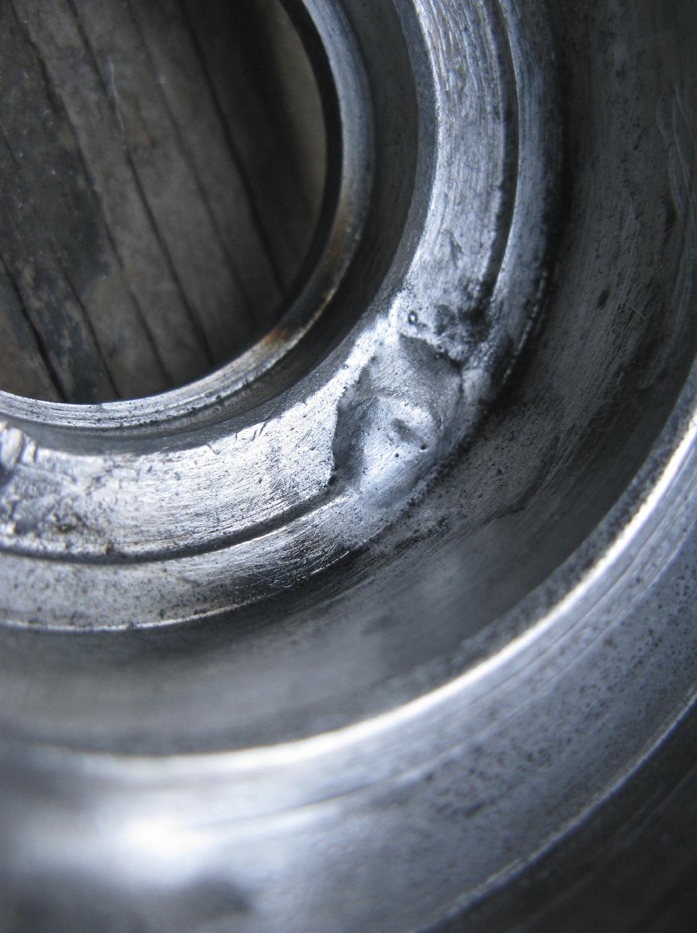

The first step was prep, grinding out all of the JB Weld that I initially used to plug the holes. At the time, the engine was mostly assembled so JB Weld was the easy choice. Now, that the engine is back apart (to try for a better crank seal install) the suggestion to weld those holes was apropos. Drilling out the holes one size larger got all of the JB Weld out.
Weld prep
I looked up an old buddy and he came to the rescue (thanks Kimo!). He plugged two holes from the outside.
Plugged holes
The third hole was buried in that narrow space so it was tackled from the inside.
Third hole - plugged
The inside weld needed to be smoothed down as the crank bearing mounts here. Fortunately, a bit of variation in this area should not be too critical - only a small part of the machined surface is effected and its purpose is to locate the bearing axially on the crank. A little drill press rigging was fine.
Cleaning up the inside weld
It came out great :grin: so I went ahead and pressed in the seals - making sure to use a sealer this time!
Cleaned up and new seals installed
Posts: 14676
Has thanked: 67 times
Been thanked: 20 times
Nice! Thanks for the follow up!

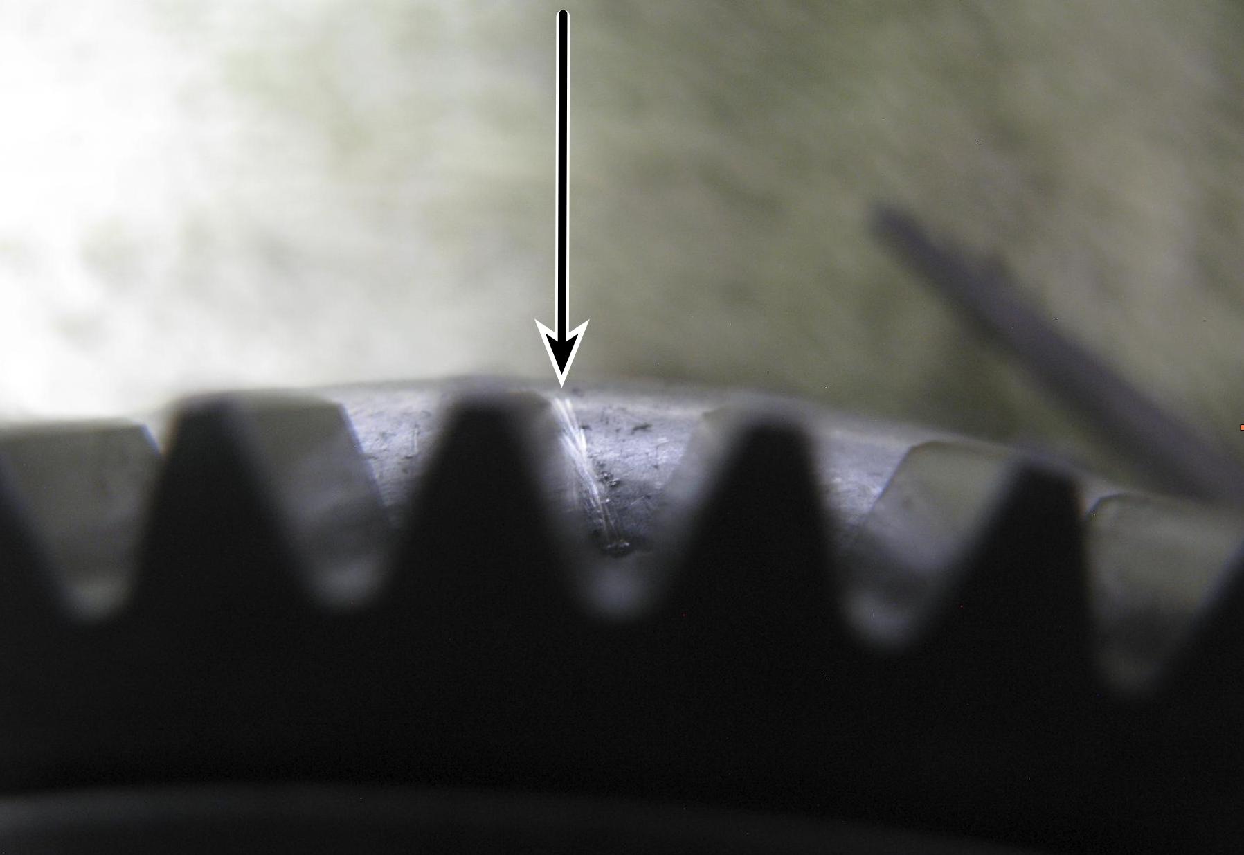

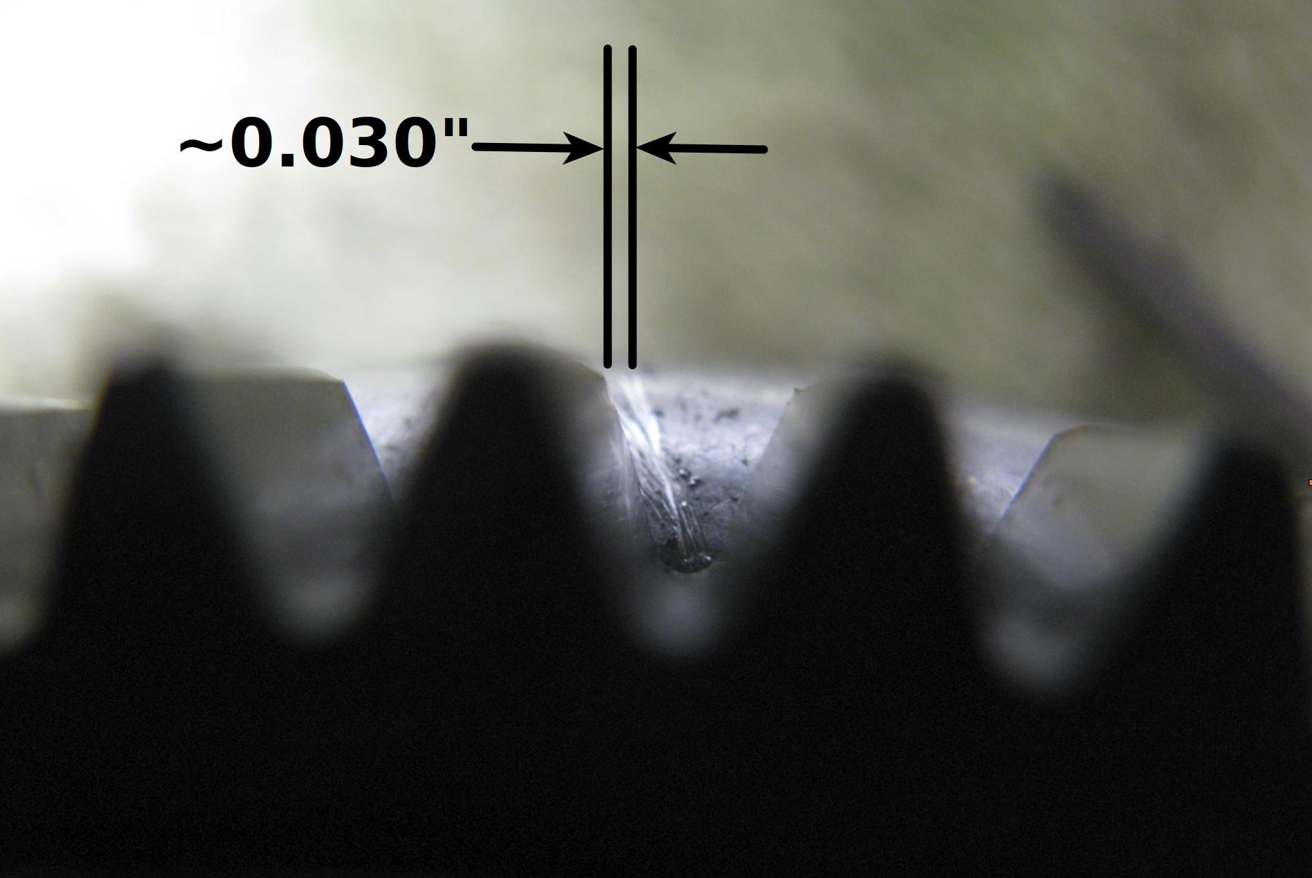

Well, now one more problem - while getting everything cleaned up assembly, i noticed that the gear on the clutch basket has some slop. Not a lot but definitely more than zero as the gear can be rotated a degree or two while the basket is stationary.
Clutch gear rotated right
Clutch gear rotated left
Looks to be under half a millimeter or, maybe, 0.030" at the outer circumference. I think I am correct in assuming that any discernible movement is too much?
Keeping alignment while putting in new rivets seems like it would be hard (even if my press would do it), I may have to look around for a replacement clutch basket.

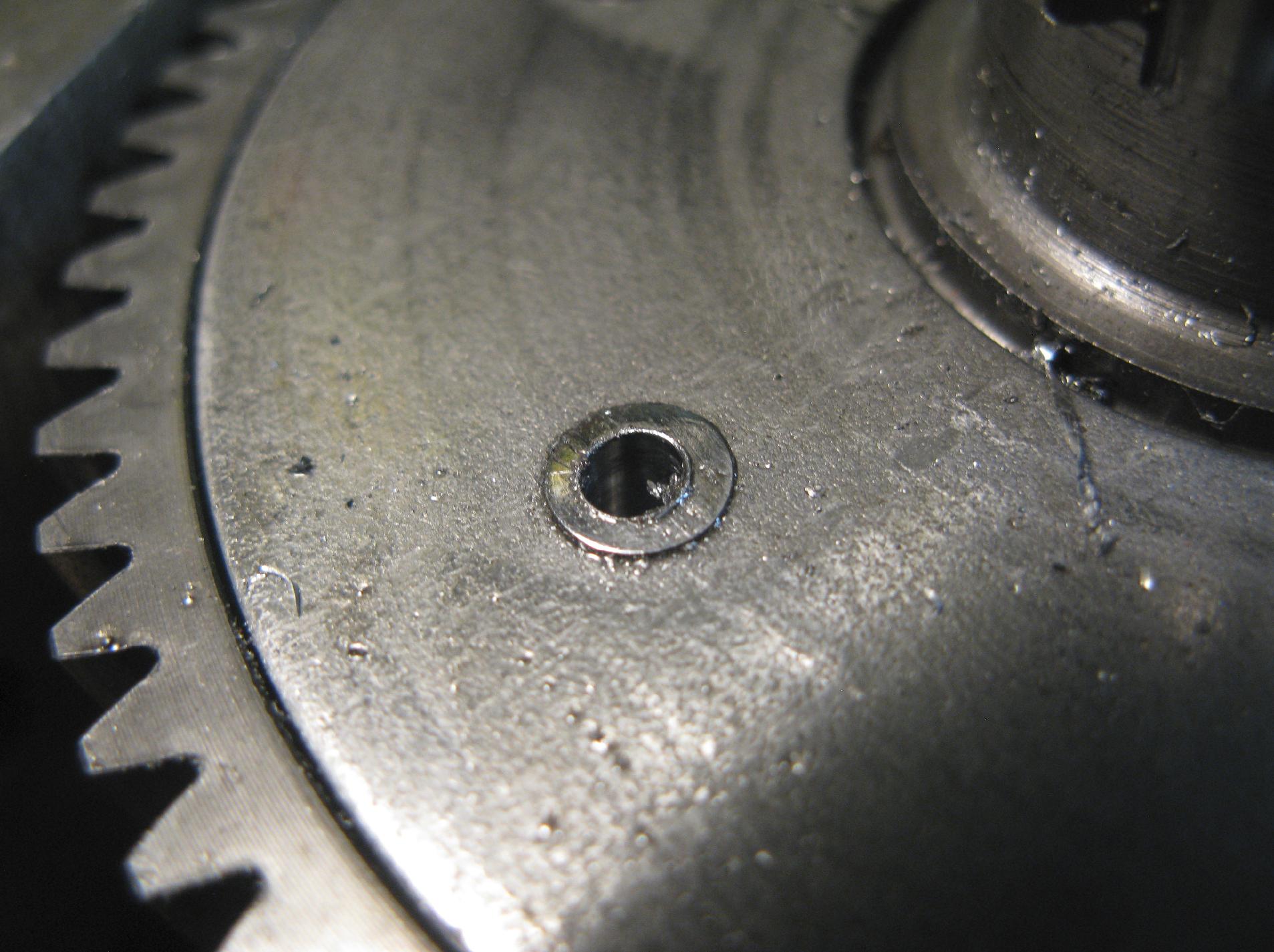

HopFrog175
Posts: 80
Joined: 11:50 pm Jan 26 2021
Location: Los Angeles, CA
Post by HopFrog175 »
Thanks Molly's 70 - all the welding credit goes to my buddy Kimo - he knows his stuff!

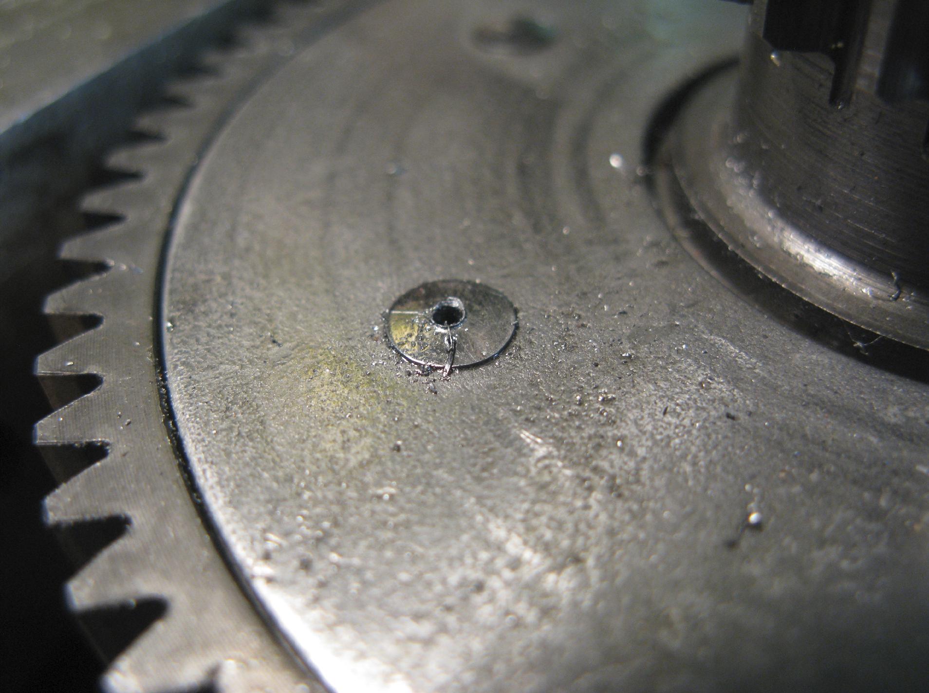

Slick_Nick, thanks for the suggestion, I already started removing the clutch basket rivets. My initial thought was to stop by the local rivet place and see how close of a match they had.
I like the idea of drilling and tapping though - mainly because I would be able to more closely match the tension of each fastener to some nominal value (compared to flattening the rivets, one at a time, by hand).

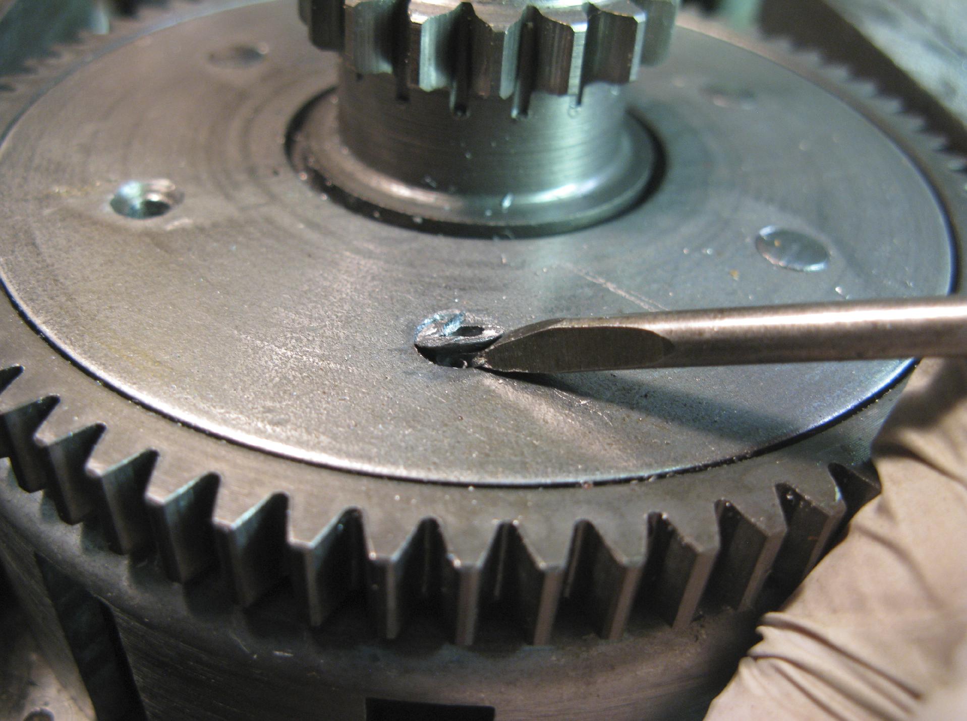

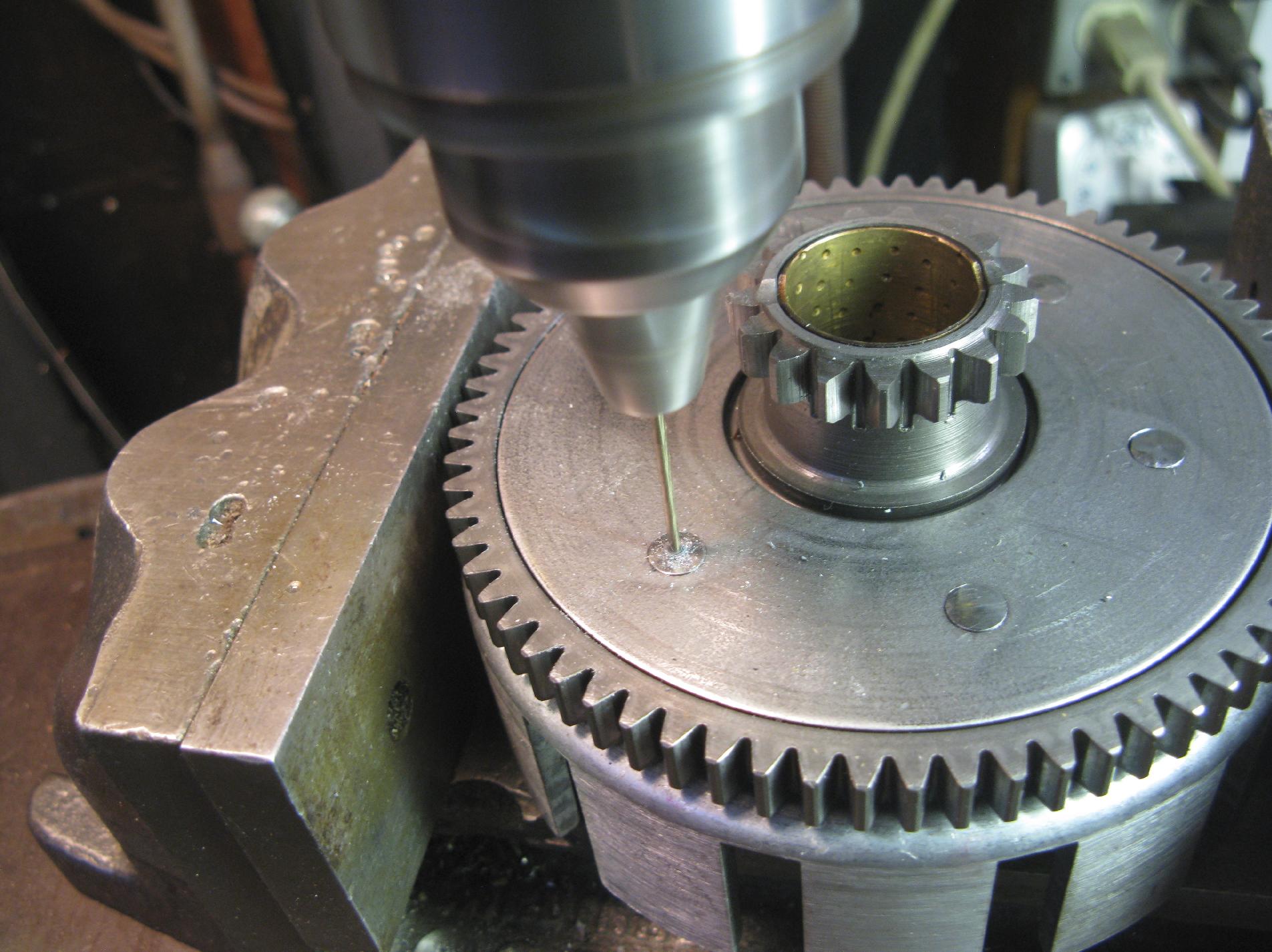

Pilot drilling a rivet with 1/16" bit
Moved up to an 1/8
Chiseling off the rivet head
The rivets are about 0.160" diameter and somewhat over 0.422" in length. Hansen Rivets lists slightly under and slightly over. I imagine best to go slightly over and will talk to them. Then, I will check out screws.
Clutch basket rivet

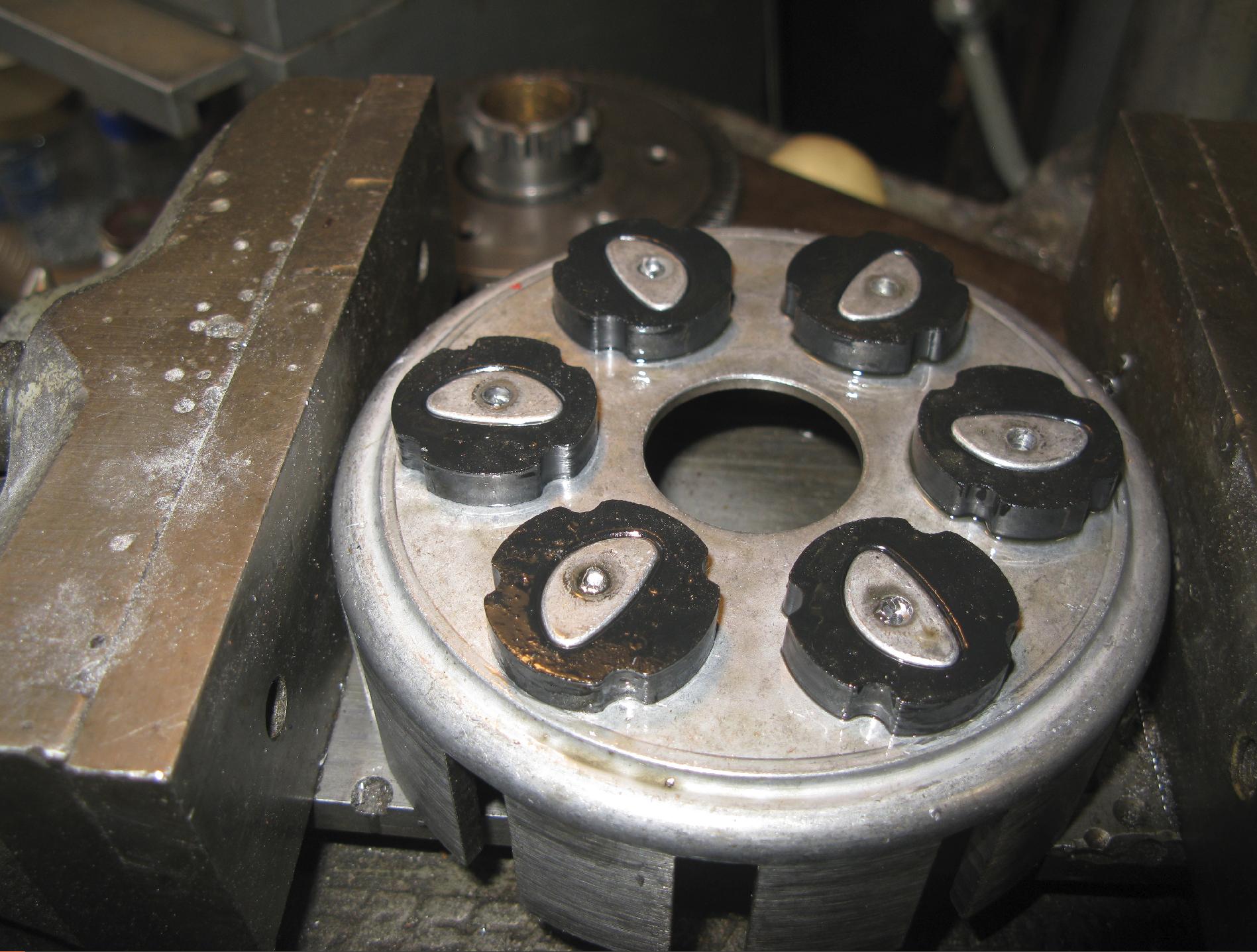

I got the rivets out and looked inside of the clutch basket:
Original Clutch Basket Rubber Cushion Bumper Dampers
Now I see how this works. This is the first time I have had one apart and I have somehow never looked at pictures - I assumed it was solid.
And, I can see how the rivets just hold things together without transmitting any torque
The hard part looks to be sourcing the rubber dampers as I see about a half dozen Kawasaki versions exist. If anyone knows the right version, please let me know! I will do some calling around and see if someone can take some measurements too.
Posts: 1691
Been thanked: 2 times
You might have to do some measuring and poking around some various manufacturer catalogs since there likely isn't a listing for a bike as old as yours.
