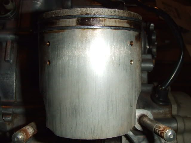

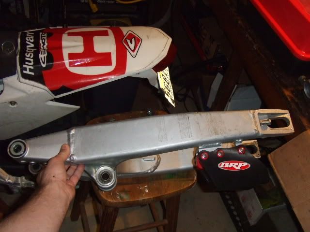

As promised, here are some pics.

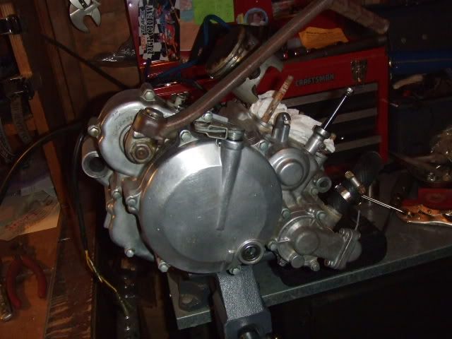

Cases cleaned up pretty well with just a wire wheel on a corded drill--probably won't paint after all.
Swingarm gets a pretty, new chain guide.

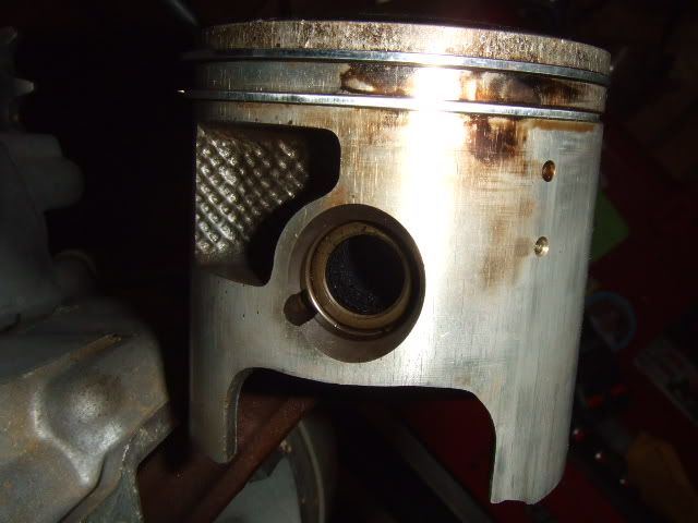

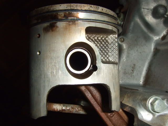

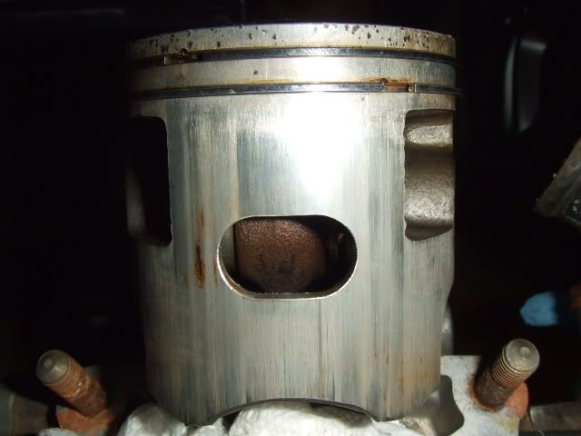

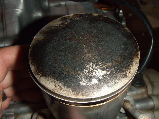

Some piston pics. It's a bit scuffy, but not too bad. Going to be replaced with a Wiseco shortly.
KIPS Carnage

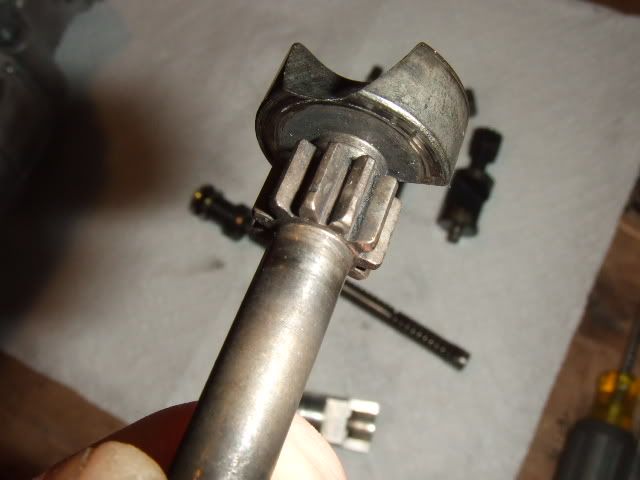

Check out the gear for the valve on the right--totally stripped of teeth!!

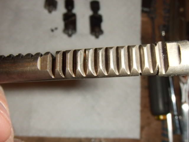

Lots of wear on the toothed pushrod.

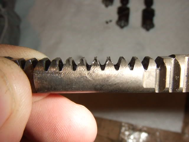

Main valve is in good shape except for some wear on the gear. I plan on replacing it with a new one since I'm replacing the pushrod. New gears all around!

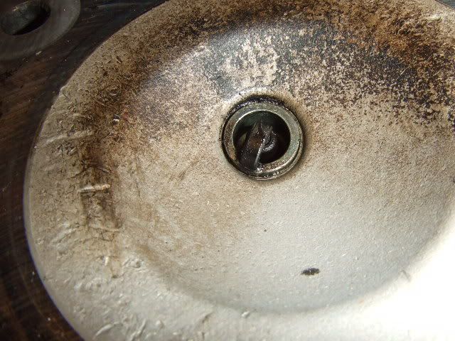

Head has a couple of irregularities in the domed portion, but I can't tell if they are from the original casting or from trauma.

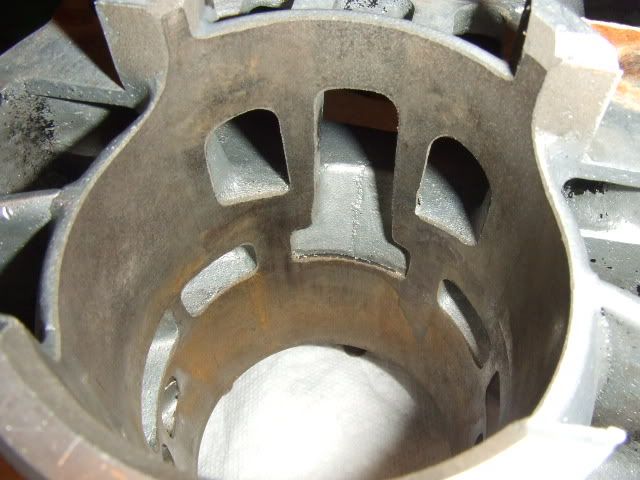

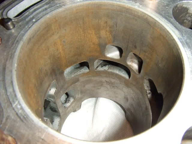

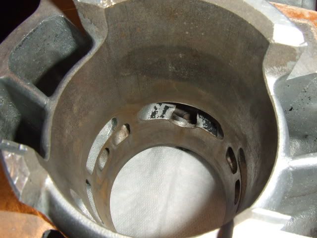

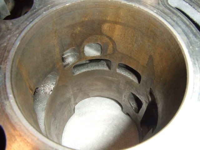

And here are some angles of the cylinder.
No detectable grooves/gouges/scrapes. However, I'm a little surprised at the orange patina. It almost looks like rust. I'm definitely no expert, but I can't detect the presence of a liner, so I don't know what the orangey coloring is all about. It certainly doesn't look to Nikasil-y--I'd have thought it would be shinier.
Any experts want to chime in on whether I need to get the cylinder replated? Those little irregularities in the head going to be a problem?

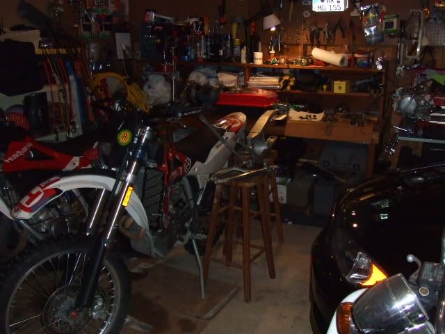

There's JUUUST about enough room for one more bike in there. Let's make it green...

did you grenade the piston or something? cuz that head doesn't look like casting marks...looks more like pieces were in there...
I get the same "rusty" stuff in my cylinder if I clean and leave them for a few days. Good or not I've run them with no issue .... so far.

Grenade the piston? Dunno. Maybe on a past top end. I have put a grand total of ten minutes of running on this engine before tearing the bike apart for my project.
Probably sending the head and carb to Ron Black for him to work his magic--hopefully those defects aren't bad enough to make the head unusable.

juliend,
Good to know. I'll scrub it down and measure it up before I decide whether to have it recoated. As a precaution, I took out the head studs today over lunch. A little penetrating oil and the double-nut trick got them all out cleanly.
Bike Bandit as well as Cheapparts.com both are telling me that the toothed pushrod is no longer available. Put an offer on a used one on eBay today. Hopefully it comes cheap and in good condition.

Update: Cylinder in the mail to Powerseal. I sent the Wiseco piston along for them to get it all matched up.

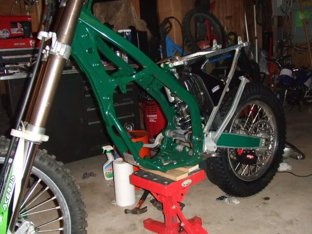

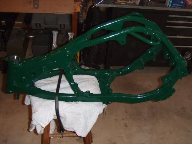

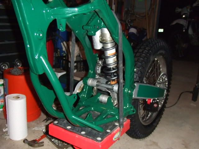

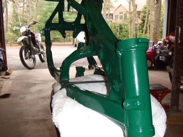

dfeckel
- Posts: 644
- Joined: 07:46 am Nov 09 2009

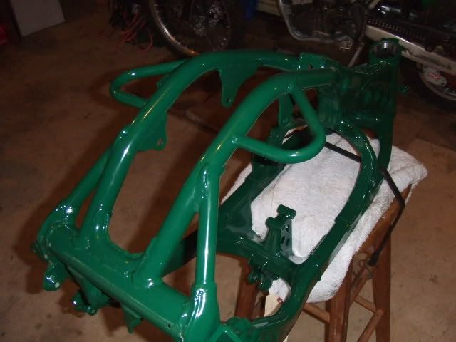

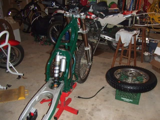

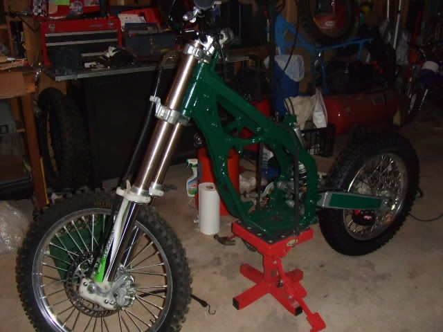

As promised, here are some pics!
Don't get too jealous, little Husky--I'll still ride you sometimes...
It's starting to look like something! (finally...)
