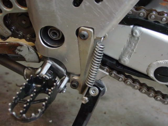

When I go riding with my son, I can never seem to find a tree, so I got the kickstand installed.
And I'm working on an 18 inch rear tire.
I've never really looked at the linkage and swingarm of a KDX, but I could only guess that it would take a lot of work to make it fit correctly and work properly. Now that would be a one of a kind hybrid!

Can you do me a favour and measure the two mounting bolts centre to centre,I have an 00 hybrid and want to adapt a kickstand to it.Tedh98 wrote:When I go riding with my son, I can never seem to find a tree, so I got the kickstand installed.
Thanks

trailtech makes a kickstand for kx...(you can adapt it for KDX too)
http://www.kdxrider.net/forums/viewtopi ... ight=stand
