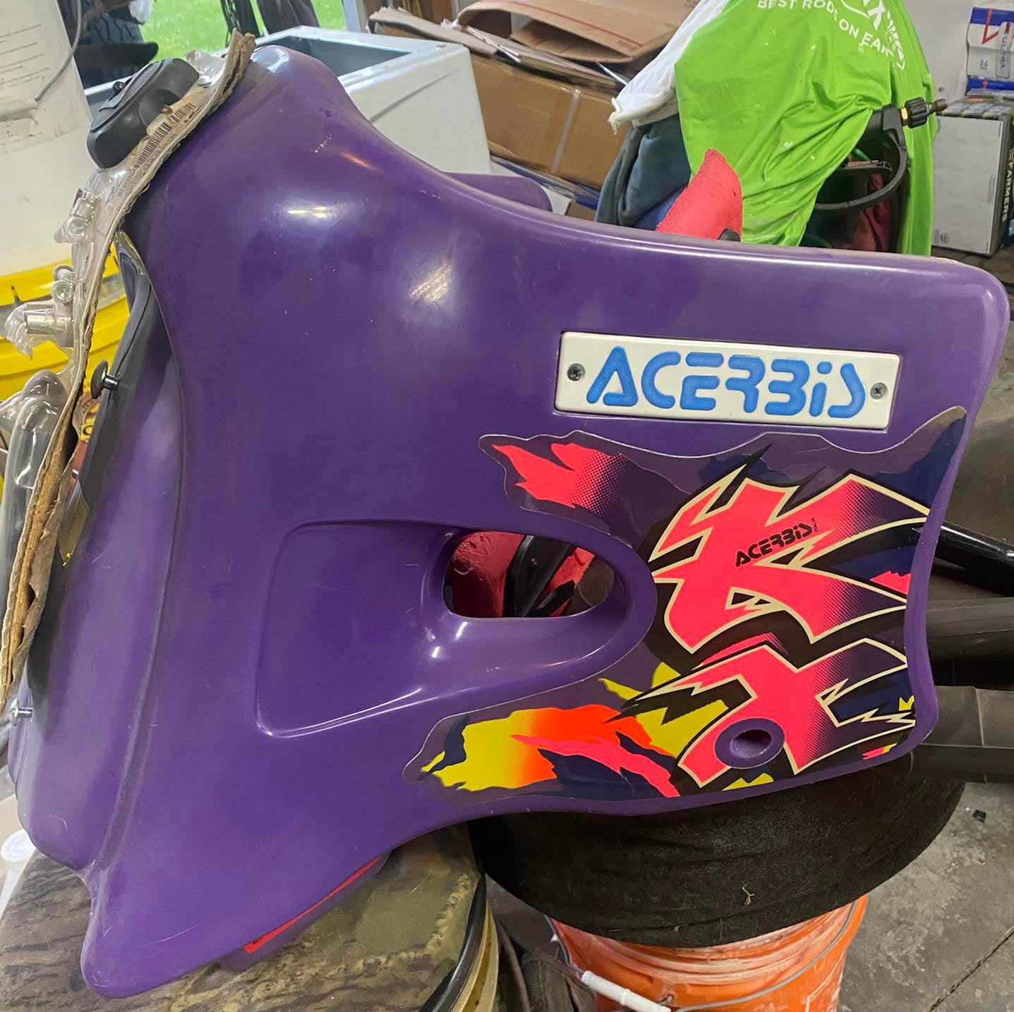

This really brings the 96 or better yet 97 or 98 with purple shroud graphics on black shrouds, and a purple seat, back into the running. Every time I would look at a 99-02, I liked them better than the 03 Plus or the four-stroke steel frame or aluminum frame bikes, but nothing looks as awesome as the purple 96 KX 125 and it's siblings of the same generation.
I've still got a lot of big plans to rebuild at least one of my two KDX220's with a ton of titanium parts and all the other go fast parts and suspension goodies that I have, but I really am hoping to get a 125 chassis for a good deal and build up a hybrid as well in order to see how much lighter of a feel I can get.

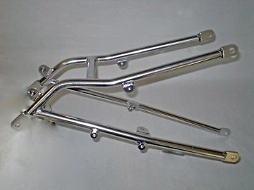

Finding an AC Racing aluminum subframe for the 94-98 is a bit difficult, stock was steel, that was another reason for going with a 99-02. But apparently a 99-02 aluminum subframe will bolt onto the 98 frame, but apparently you need to use all 98 plastics tank. I might try and do some sort of hybrid of a hybrid and use the 99-02 aluminum subframe and air box, and draft on mounts for the 98 side plates and 98 seat and possibly rear fender.
It's all a pipe dream now and just brainstorming ways that I can get even further weight reduction on my 220 builds, especially with a lower center of gravity. I'll already be swapping different suspension onto both the KDX's and the proposed KX 125 hybrid, so the 125 suspension is not really of concern to me (sell it to another KDX'er as an upgrade) because I'll go with something better suited for tight woods riding anyway. I have at least three rebuildable sets of 98 RM125 forks + several more for parts with a few rust pits and chips in the chrome etc. Those are my go-to woods/enduro forks. DRZ400E & 96-98 RMX250 forks are right behind. And 01-04 RM125 shocks & other related 05+ Showa 50mm shocks on KXF, RM-Z, & RM '05-'08 models.

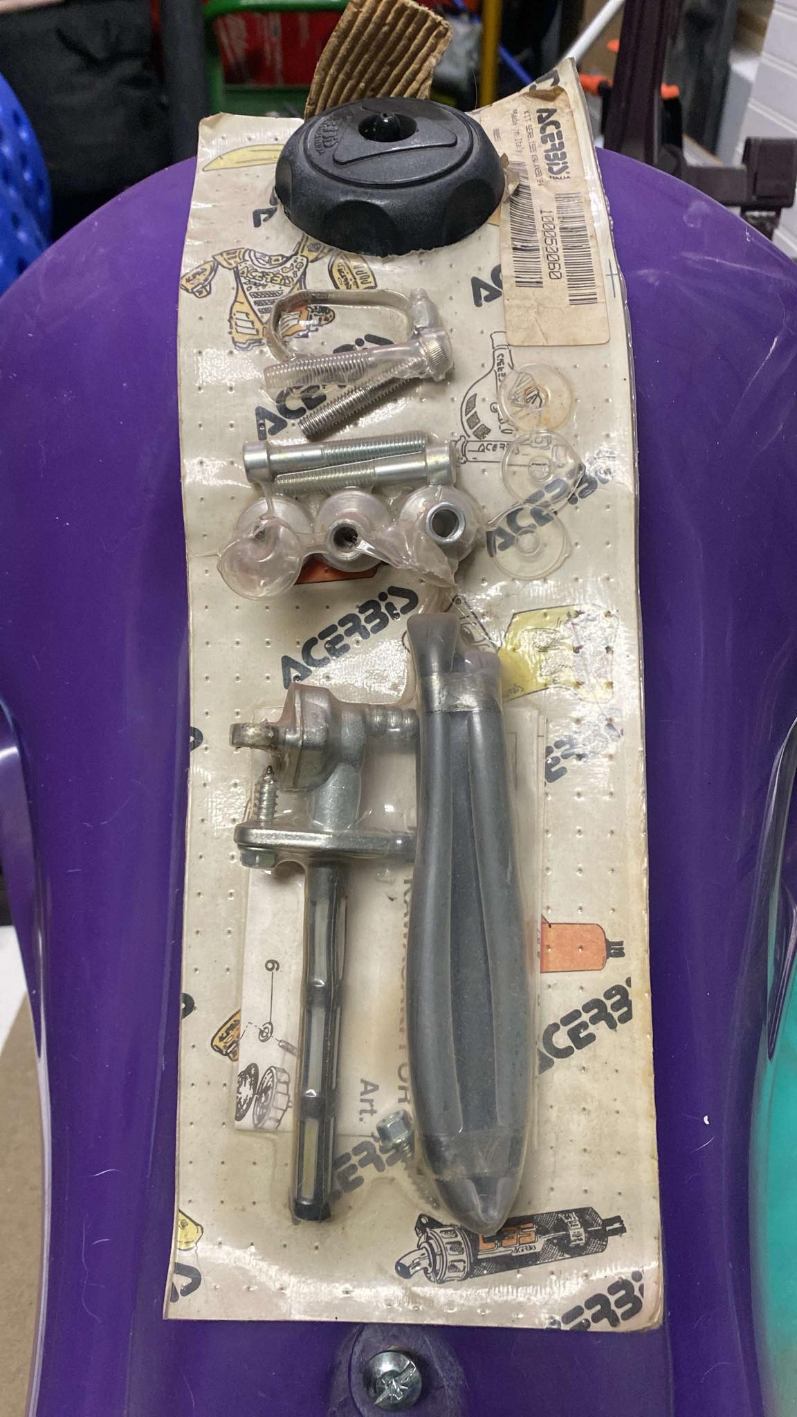

I've now found a New Old Stock still in packaging 94-98 KX125/250 Acerbis desert tank, which has integrated shrouds which also carry fuel in them, and of course this is a problem for me because it was a PURPLE version! SOLD! The tank normally sits within the perimeter frame and the shrouds bolt to some brackets on the frame and wrap up the tank to the seat and the filler neck, almost entirely concealing the tank. On this desert tank, with integrated shrouds, since the shrouds would normally go on top of the outside of the frame and the top of the tank, this tank with integrated shrouds actually hangs over the outside of the frame and carries additional fuel outwardly and basically at the same height or lower than portions of the rest of the tank. All of the wishbone type KTM enduro bikes also have their fuel tanks exposed on the outside of the bike unlike the KDX and standard KX configuration, so this is similar to that. It may be an interesting fit, but I'll try it out and see how it feels, and still could pick up a stock tank or the IMS 3.0gallon oversized 94-98 KX tank that is just a slightly expanded version of the stock tank but then requires you to cut the top of the shrouds off as it bulges up above the filler cap.

The very next day, I found the aftermarket aluminum AC Racing seat subframe for the 94-98 KX125/250 that I'd been searching for over a year for, popped up on eBay! A bit distressed with a bolt snapped off in one of the lugs, & basically all other threads stripped out, but all fixable...
(The stock seat subframes on this generation are steel, not aluminum-like basically every other KX generation 1988+, and these aluminum subframes are reportedly significantly stronger than stock and also look cooler in polished aluminum!)

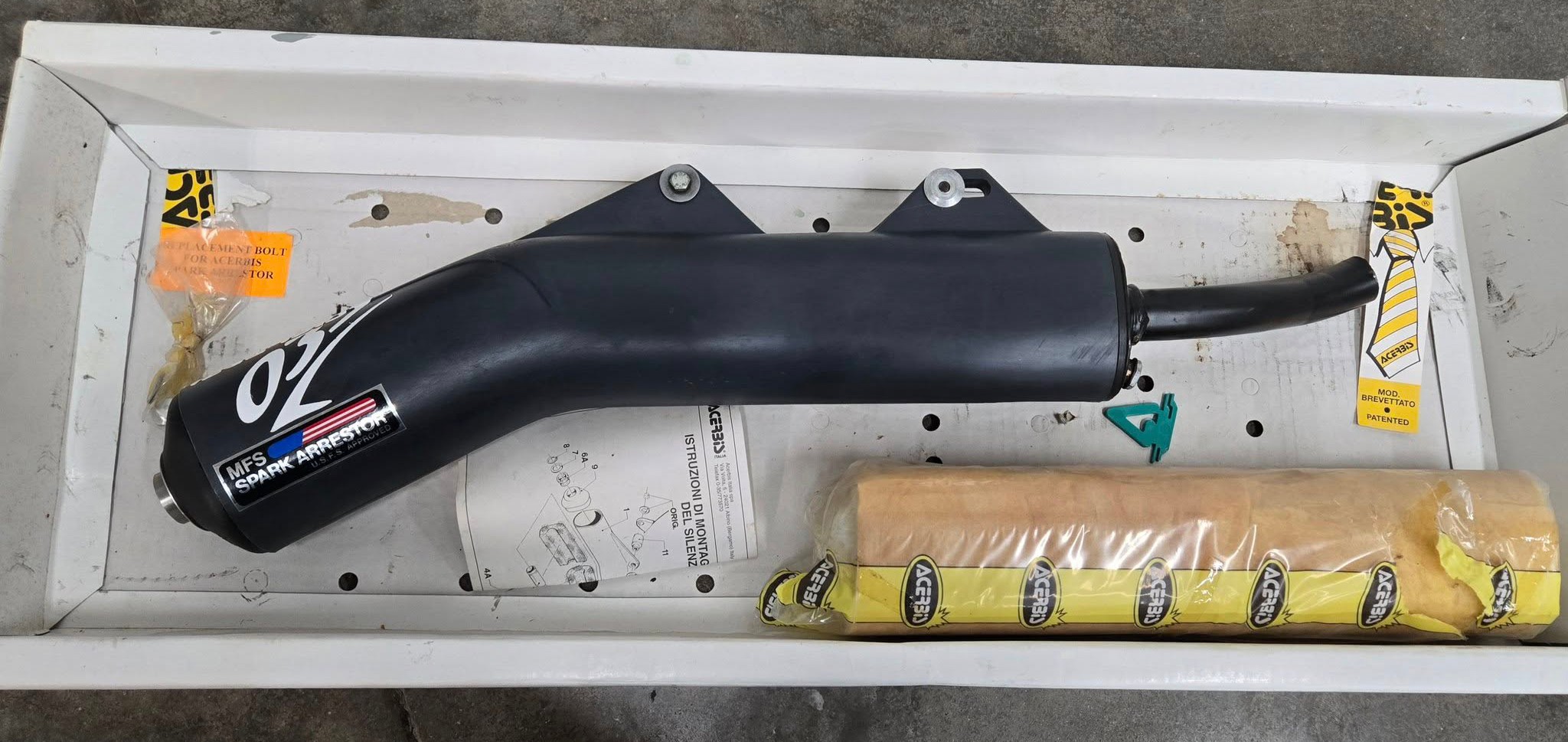

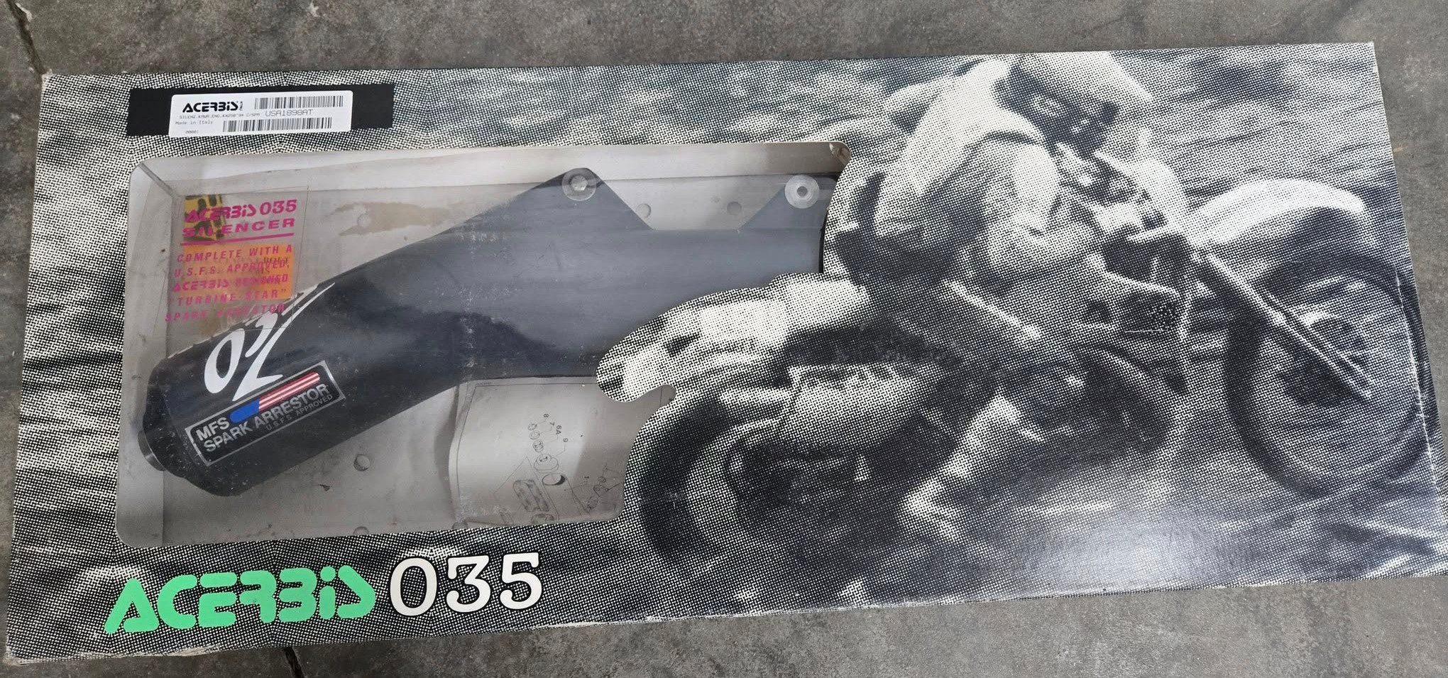

Additionally I'd also recently found a New Old Stock Acerbis 035 spark arrestor silencer for the 94-98 KX250, which is the spark arrestor application that most hybrid builders of the 94-02 KX125 chassis KDX200/220 hybrids end up using in conjunction with a 95-06 KDX pipe...
That kicked off a Marketplace search late last night as well as eBay search to buy all the parts individually. I'd found 95-98 KX125 frames for a $125-$325+ shipped. Several air boxes, one lot of rear plastics with the fender and side plates, several '97-'98 KX125 swing arms & linkages ( I could also go with a '97-'98 KX250 swing arm if I wanted longer wheelbase even, for hill climbs)... Rear brakes to fit that swingarm and frame as well.
