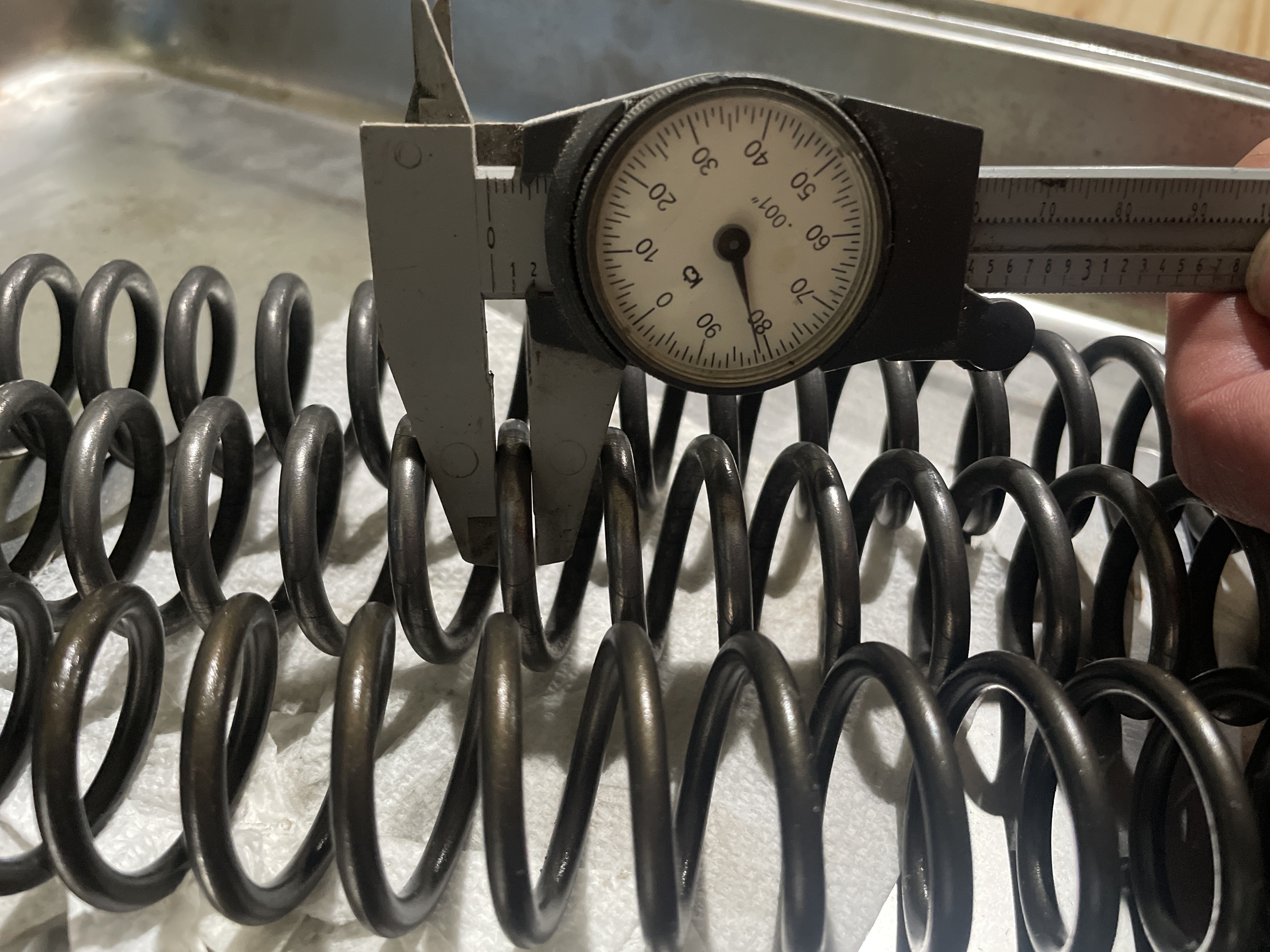

I’m trying to confirm that what I have are springs from a drz 250. I think the diameter will help if someone has some laying around from a swap.
I had a drz250 at the same time as a dr650 7 or so years ago and I swapped the front ends. (I wish I had put them in the bike I ended up keeping around :doh: )
Now I’m faced with the dilemma of probably having the springs I need for my weight to go with these gold valves but I’m not sure if they are the springs from the drz or some progressive aftermarket springs that were In the dr650 forks when I got them(stock ones came in a bag). They are the correct length and look the same as the drz250 springs I saw in a rebuild video on YouTube. I’m having a hard time just finding a photo of the stock drz springs, or the spring diameter.
The aftermarket progressive springs(likely cogent) for the DR are longer than the stock ones in it so there’s a chance I have those instead(probably like .47 or something).
It’s probably a ridiculous shot in the dark but drz forks are a common swap so I figured the chance may be greater than zero. Thanks for reading!

The spring length is correct, 502 mm. I don’t have a length on the aftermarket springs.The aftermarket for the dr are longer than stock, I just don’t know how long they are supposed to be. And they are both progressive.
These are probably correct and I’m just second guessing it be because I don’t have confirmation.

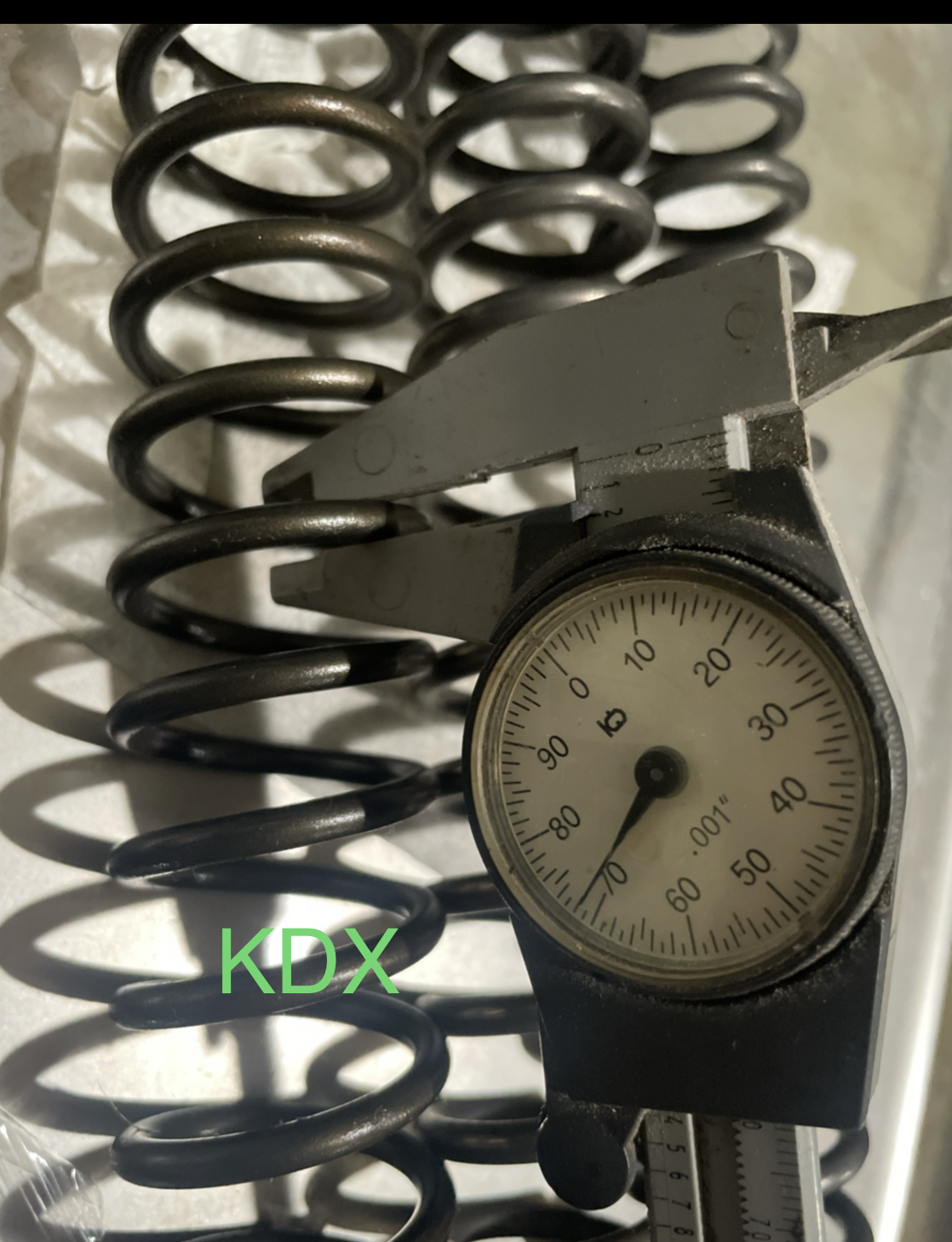

This is from a dr650 work swap with drz250 on TT. It confirms my paranoia that the aftermarket dr springs look the same as the stock drz250 springs. Length and progressive winding. And I don’t know which I have.
Re: Help ID drz 250 fork springs.
Look at the spring ends to see if there are any markings, like engraved lines. Some springs had those, not sure about Eibach or Suzuki.
