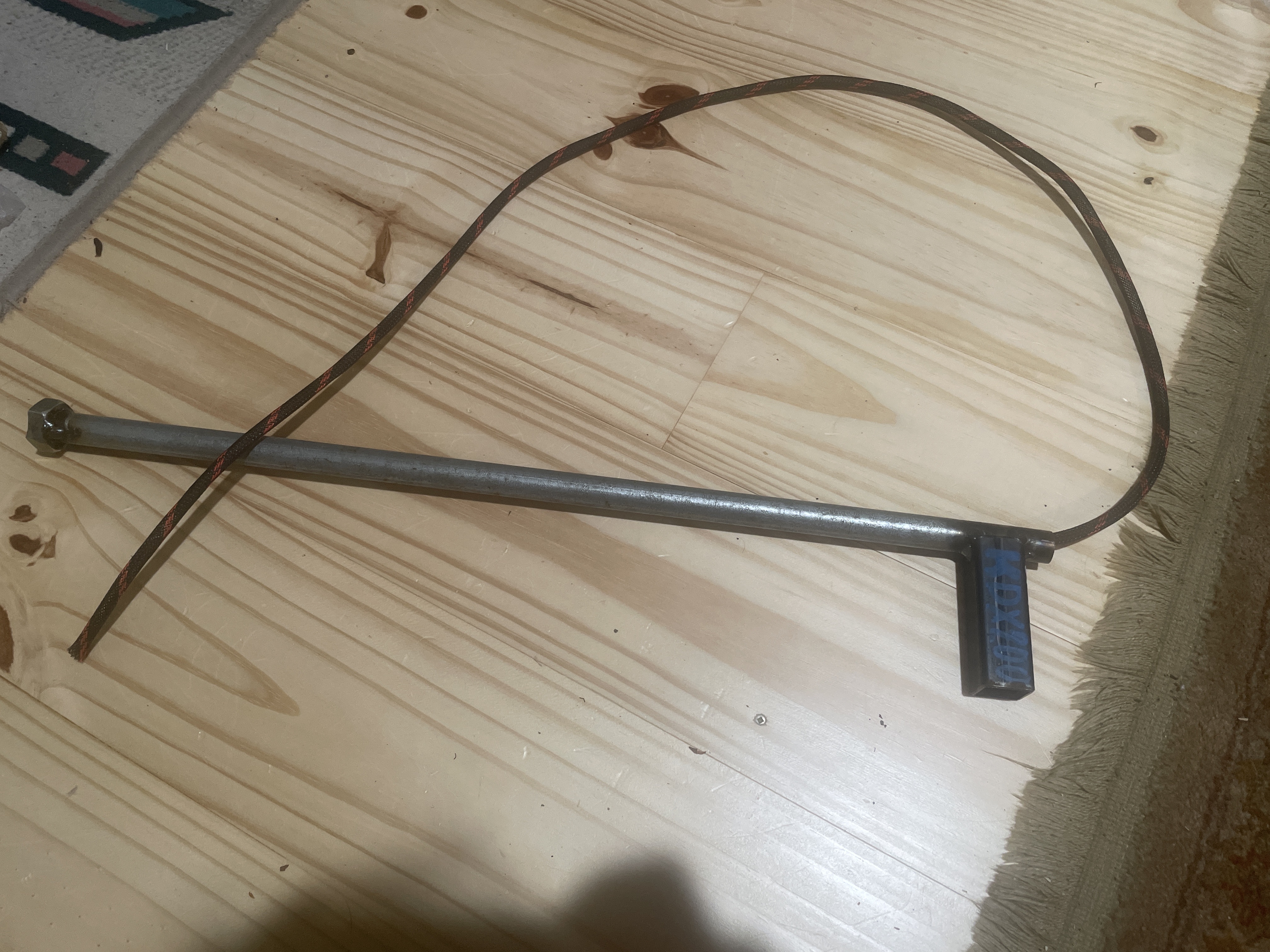

Re: Build your own KDX fork cartridge holder
I used a ford explorer radiator intercooler fitting. I had this stuff laying around. It was hollow and had an o ring inside it that protects the damper rod very nicely. The cable protector was thin enough that it made a good liner because my pipe was a little rusty.
The square tube chucks up nicely in the vise, and I can stick a cheater bar over it too
pretty cool with the o-ring in it!
