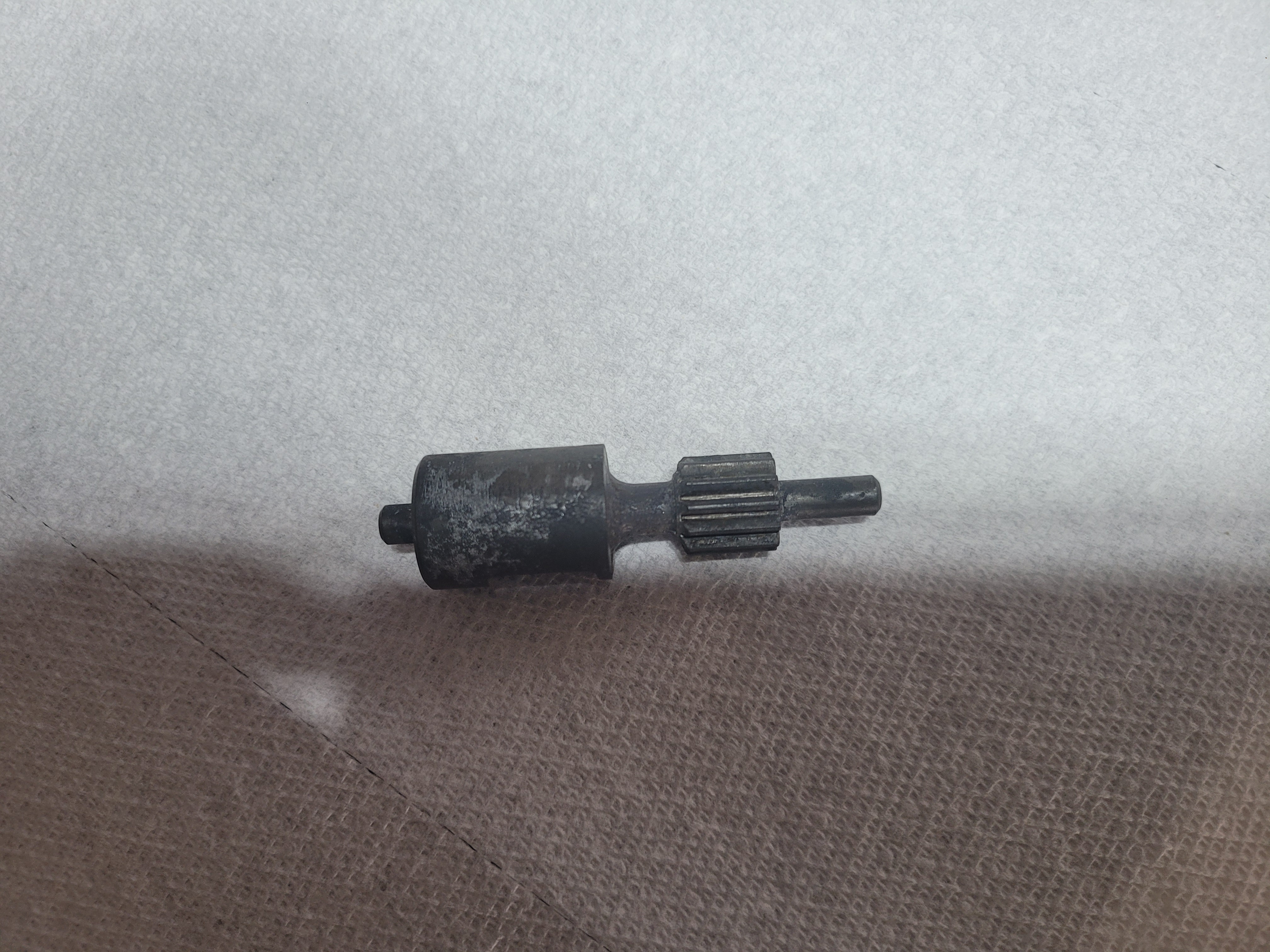

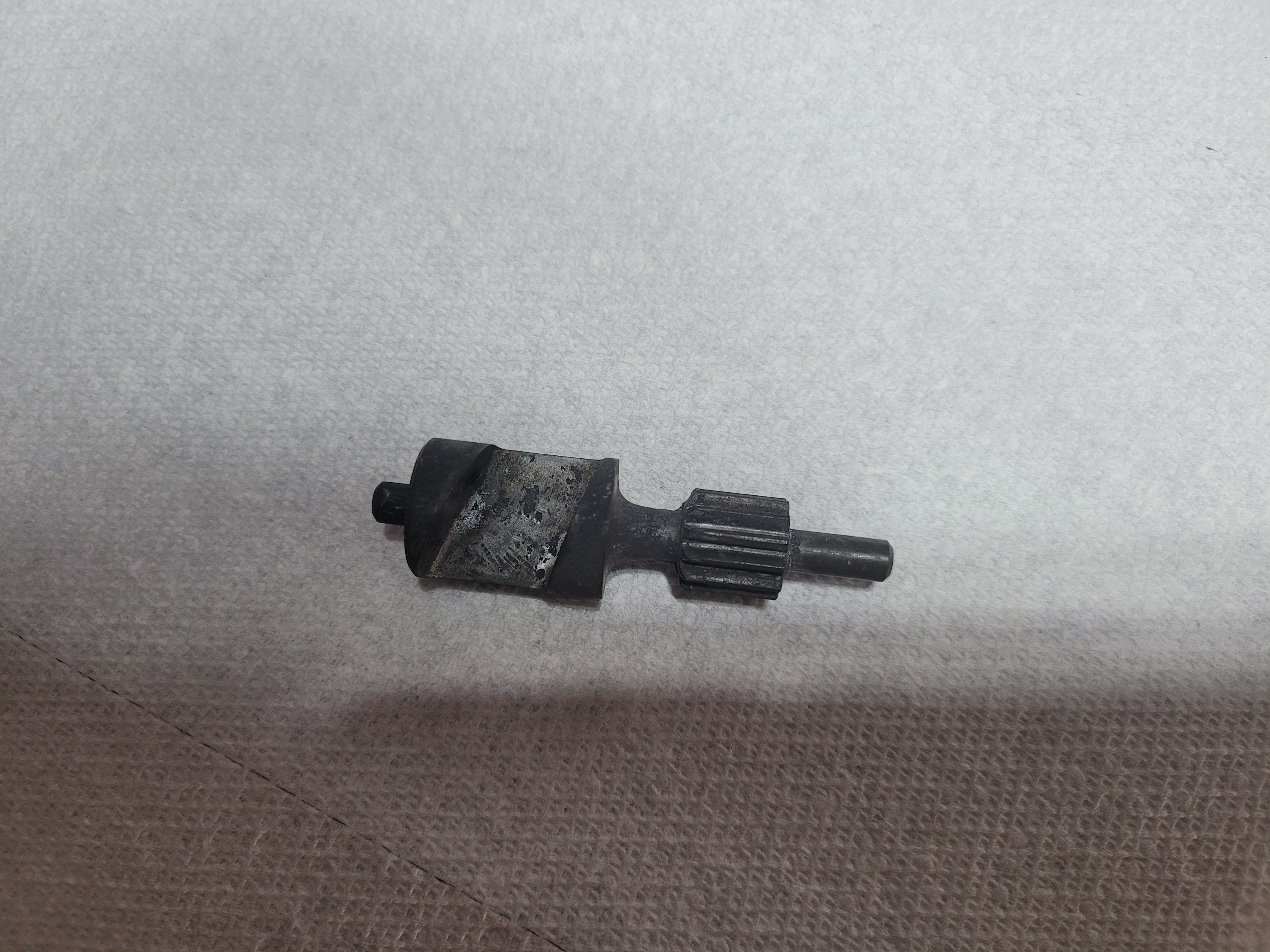

- Posts: 64
Re: Main exhaust removal dilemma
Here's the valve, no stripped teeth, etc. Should be the left side.
- 17427405976646816945106814613130.jpg (3.12 MiB) Viewed 10100 times

- Posts: 13
- Joined: 10:25 pm Feb 04 2025
Wow that looks miles better than mine. Shoot me an email at colem349@gmail.com and we'll work out shipping and stuff

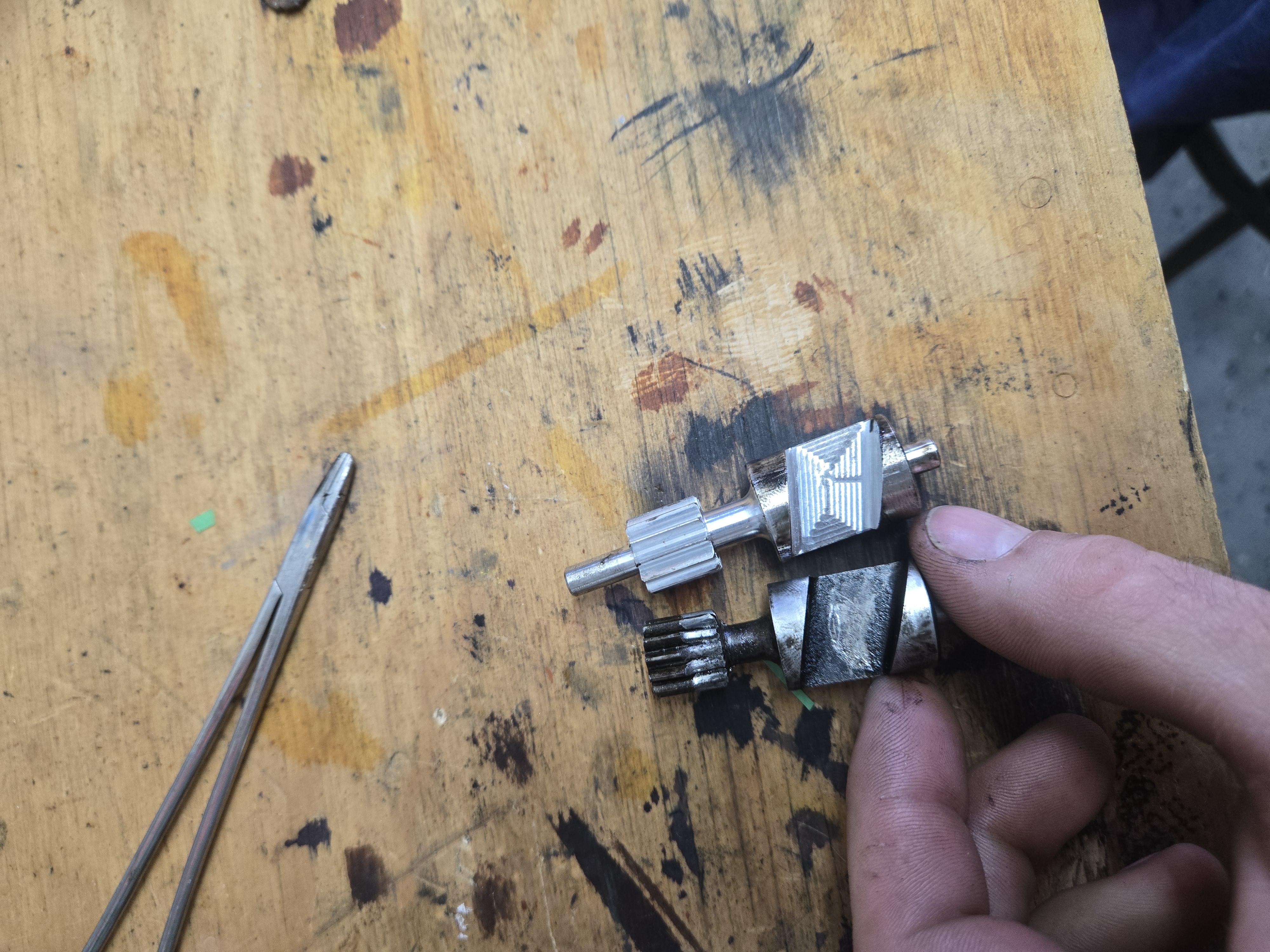

So I took a chance on the kx powevalves guy on facebook. It was $70 to the door, and got to me in about 2 weeks. Guy was a little spotty on responses and had me a little nervous while I was waiting. It looked and fit great, but didn't have an index mark, so I just went off of my old one, and it all lined up great.

I personally would never reuse the OEM '89-'94 KIPS pieces in question, and would always go aftermarket to get stronger materials of higher melting point... BDK has been pretty well proven. Hopefully the KX Power Valve parts will be the same in the long haul
