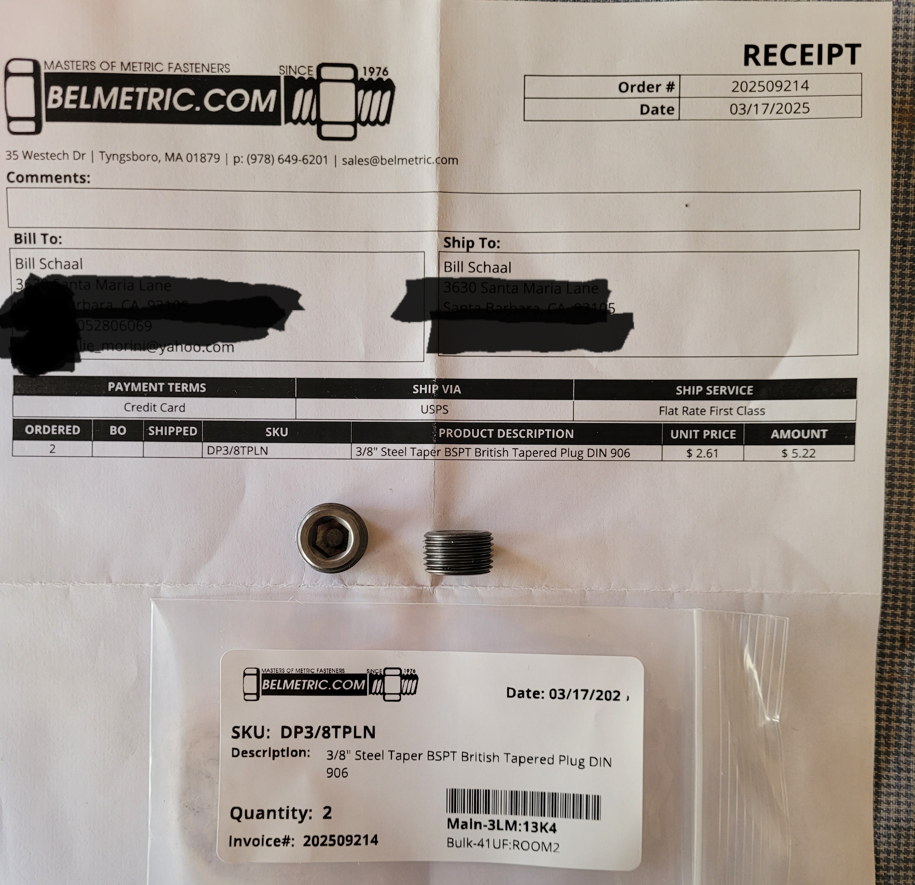

Received today. Spares to store away.

THANK YOU all for the info!
Nice pictures, billie
