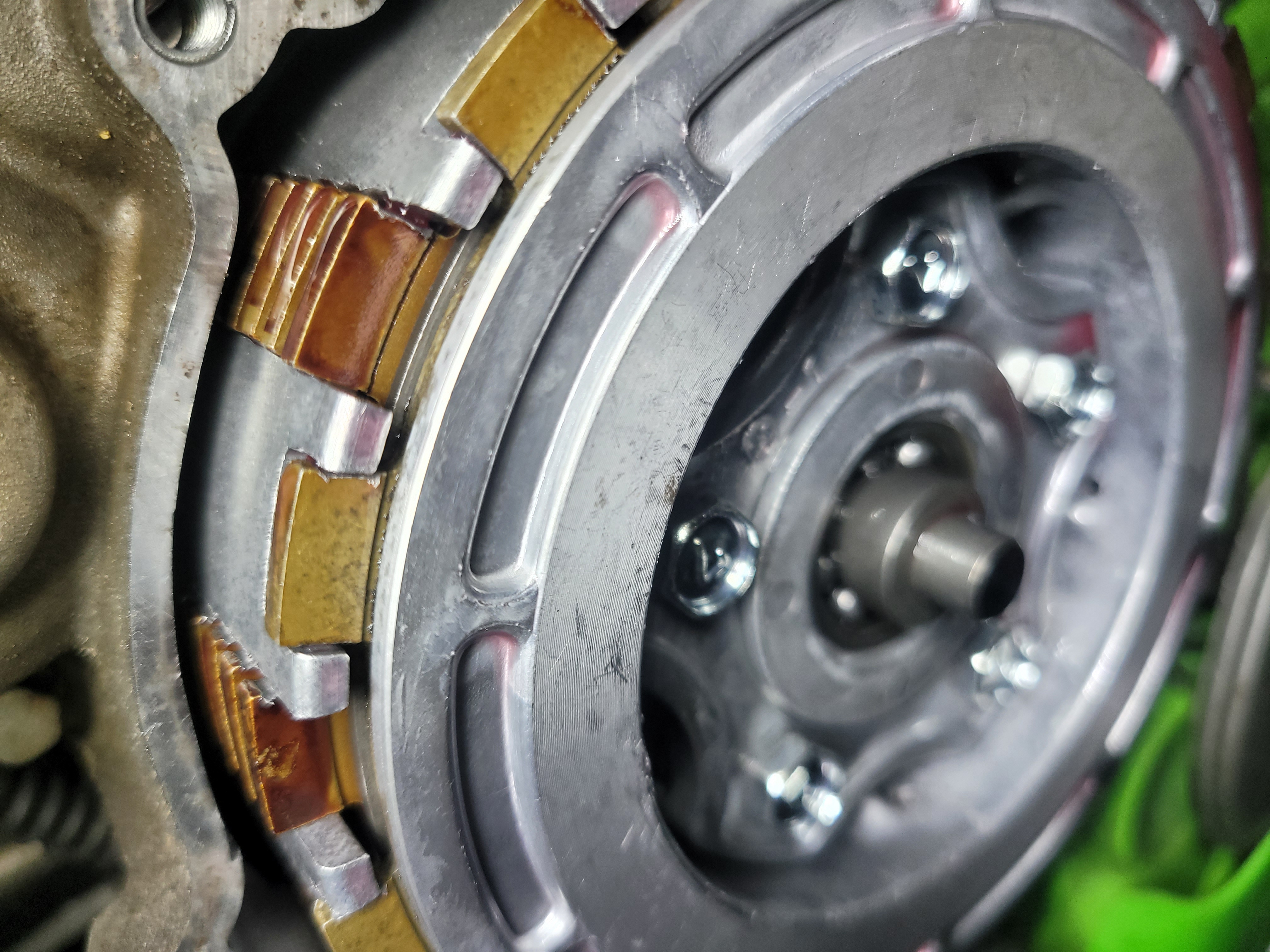

Hey everyone! Recently my KDX200 has been dragging a lot in first, like the clutch isn't disengaging all the way. It's always dragged a bit, but I was messing with the lever a bit and now I can't seem to get it back to anywhere that it isn't dragging really badly. So I took the clutch cover off and can see the clutch basket is notched. I don't know how badly it is as I don't mess with the clutch very often, so I figured I'd ask you guys to see. I was wondering if it could be filed down, or if it needs replaced. Here's a photo. It seems like the friction discs are notched as well.
Thanks!

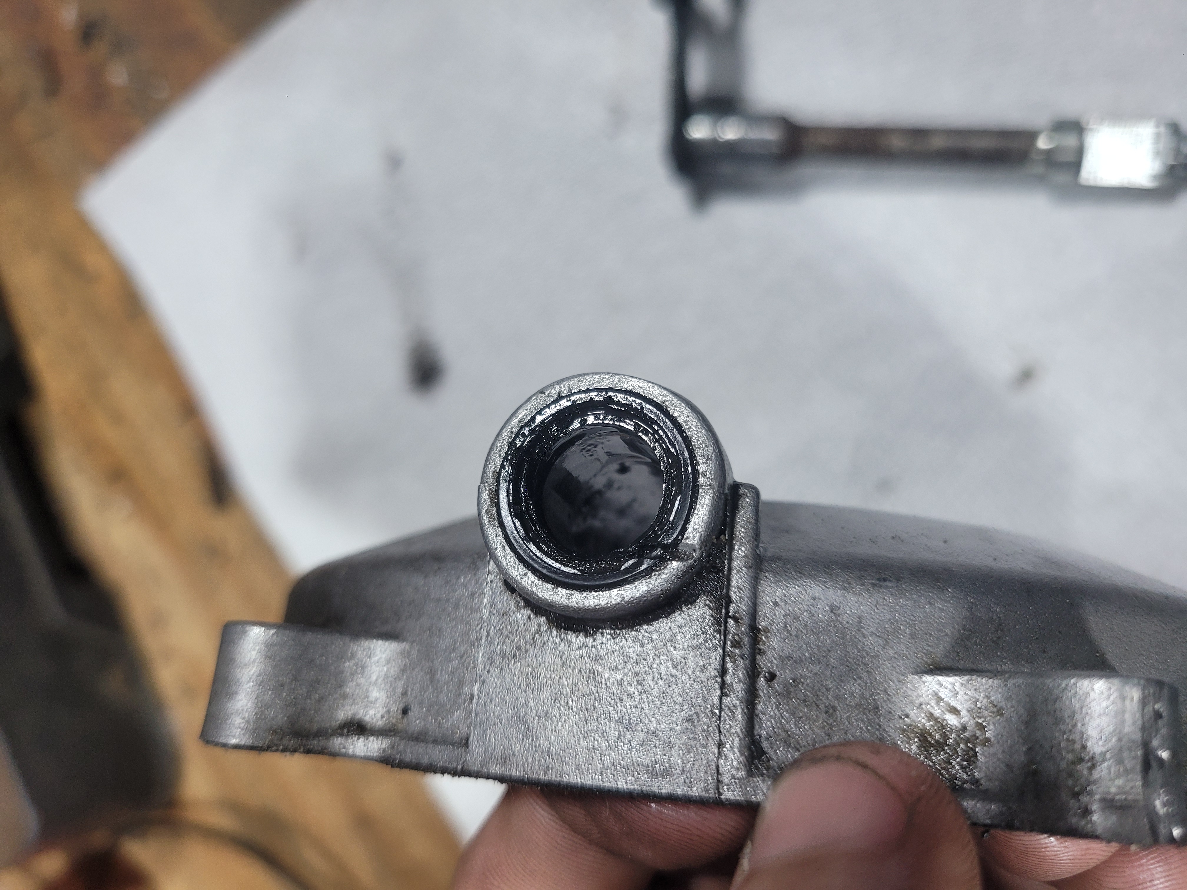

Also, the oil seal where the push rod goes through the clutch cover (inspection cover) is definitely shot. I've been looking online and I cannot seem to find the correct one, and the partzilla diagram is kind of a PIA to read.
Here's the photo of the seal. It's been leaking oil and apparently letting a little bit if dirt into the case, which needs to be fixed ASAP.

The replacement seal number is 92049-1262.
On your dragging first gear, take a look at your clutch basket. Notice the notching. That will cause the clutch to drag as the clutch plates cannot slide freely. Those notches look pretty nasty but you could try filing them flat but it will only work for so long. The other option is to replace the basket with anew ProX one.
EDIT: Just noticed your plates are pretty notched as well. I would definitely replace them.

I appreciate the information! I'll look into buying a new clutch basket. I figured you guys would suggest a new one with how deep the notches are.
Do you have any suggestions on friction plates? Are the Pro X plates any good?
Edit: PartsGiant has a ProX clutch basket for $200 so I'll go with that. They also have the ProX Friction Plates for $80 so I'm going to buy those as well.
Edit 2: Nevermind, the ProX plates are out of stock on a few sites. I'll take some recommendations on what plates are good :)

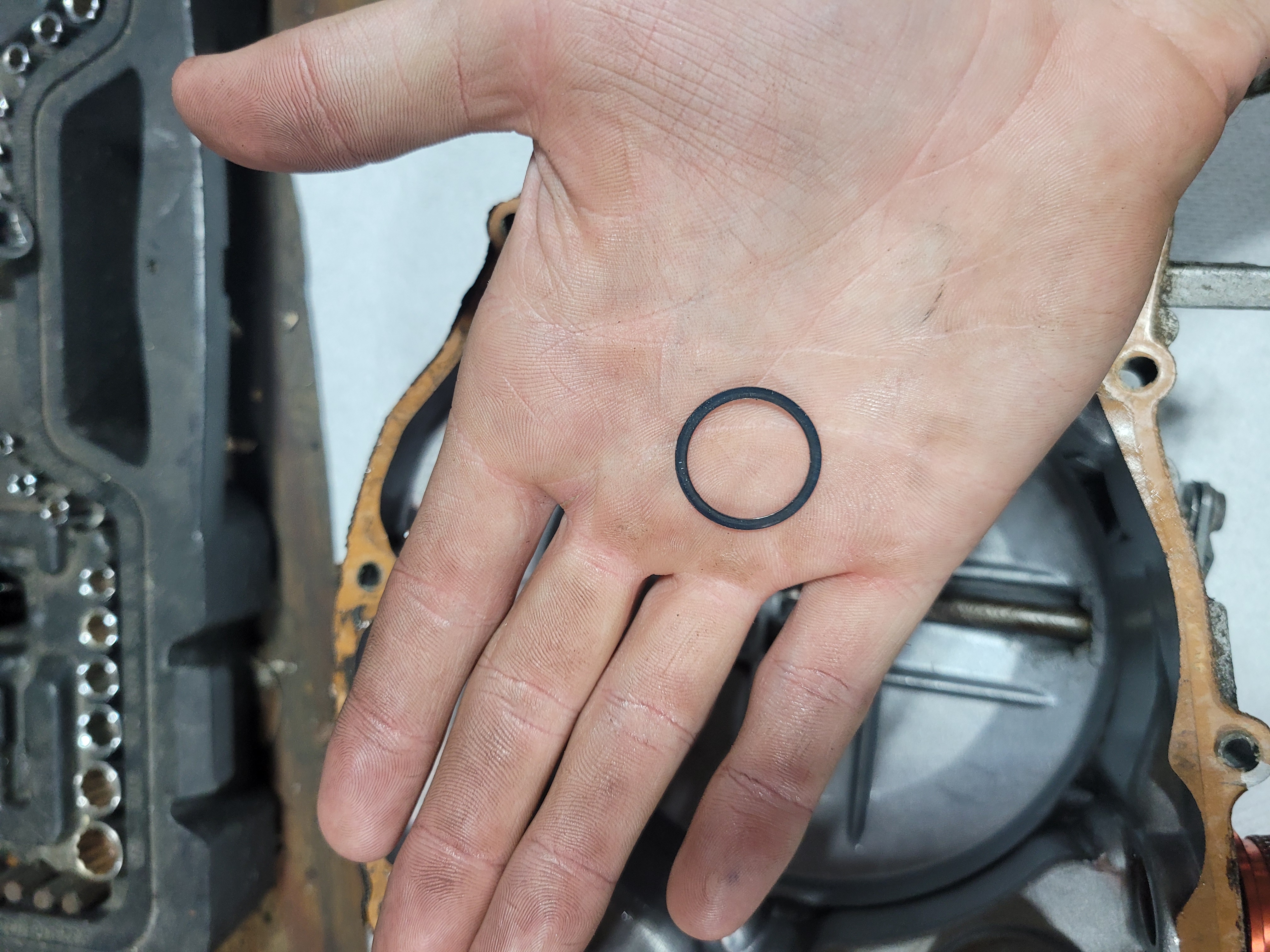

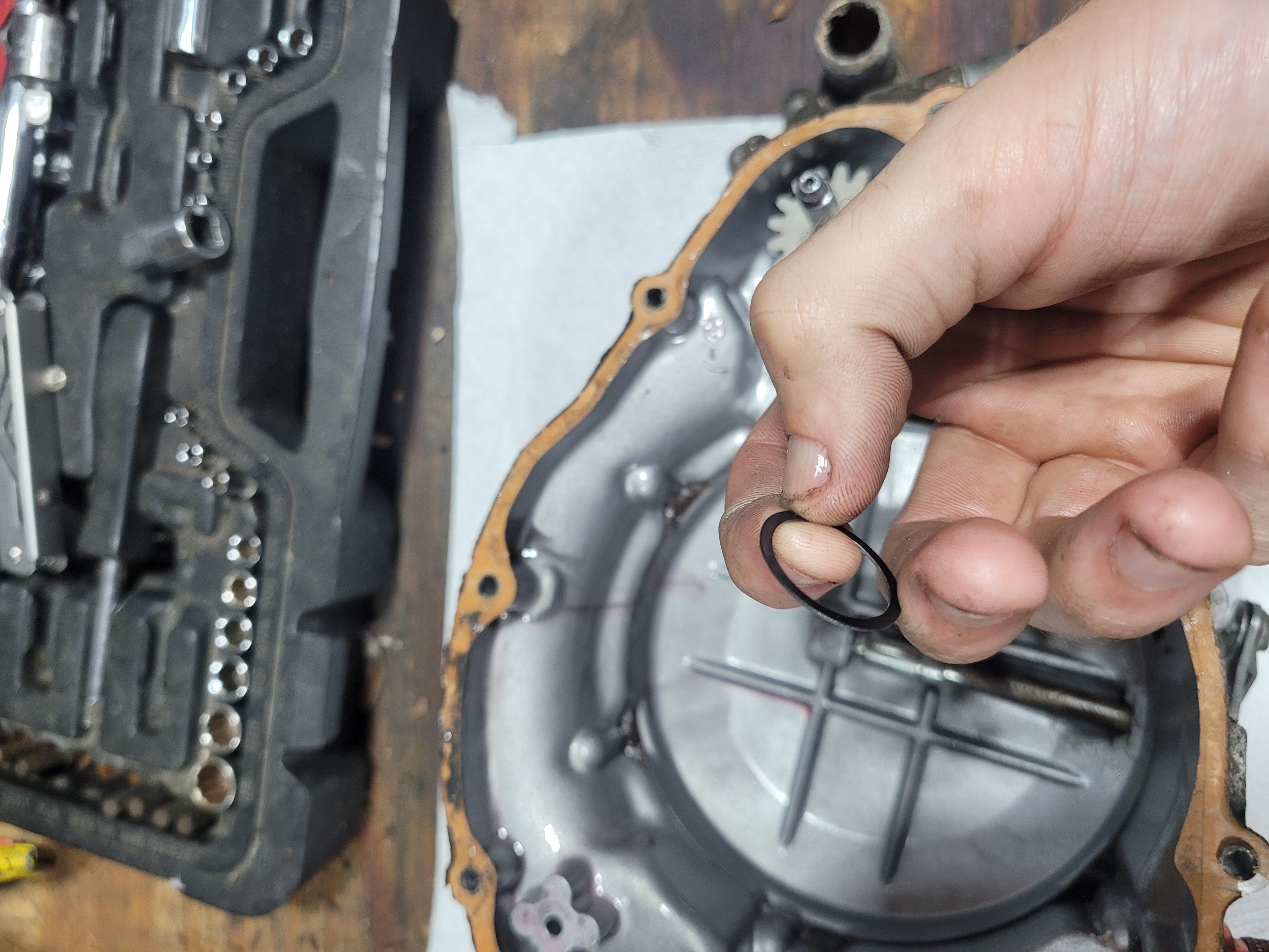

One question: When I pulled off the cover, there was a metal ring that came with it and I'm trying to figure out where it goes. Any clues? I tried looking at the partzilla diagram but no luck so far. Here's a photo:
Thanks!

I might've figured out what it is maybe: 92022C for the kickstarter mechanism? Right on top of the collar that holds the spring? That would make sense. :)
Re: 92 KDX200 Clutch Cover Basket is Notched
92022C is a reference number, not a part number. Do you know the part number?
- Posts: 64
Ope, good point. It's under 'Kickstarter Mechanism' 92022-271 "Kawasaki OEM Washer".
Thanks :)
Edit: Yep that's it. I believe it just stuck to the side case and fell out when i turned it over on my workbench.
Cool. Magically extra parts are always a concern. :-)
