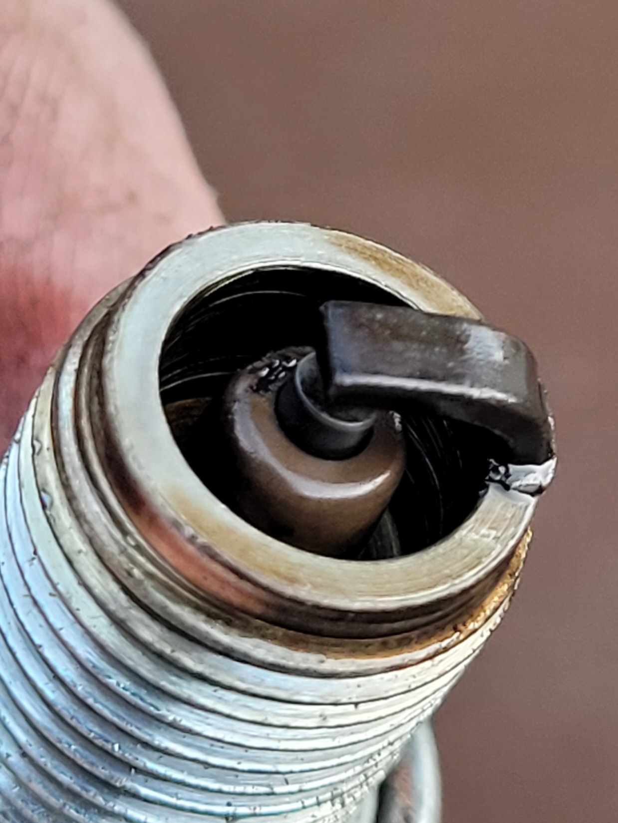

Here's mine pulled from my KDX 220 after several hundred miles. The majority of my riding is 2nd gear & moderate RPM in very steep mountains.

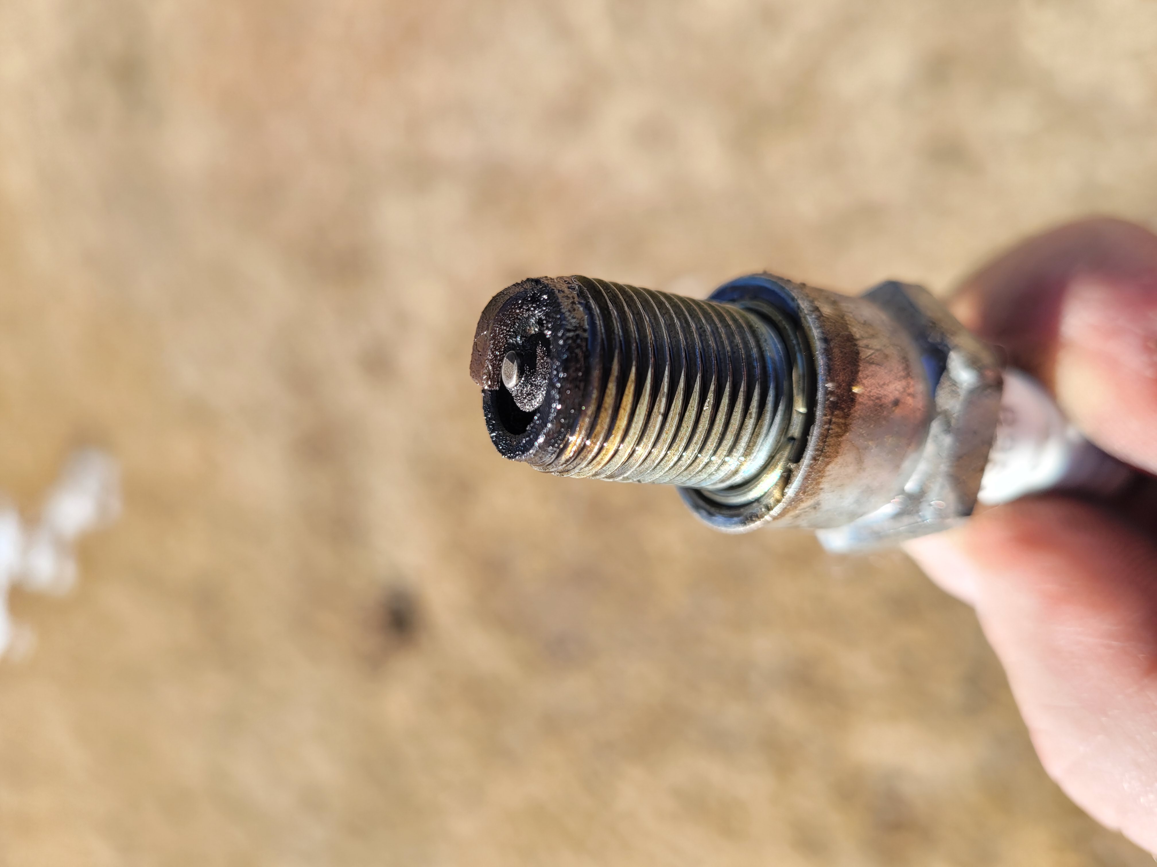

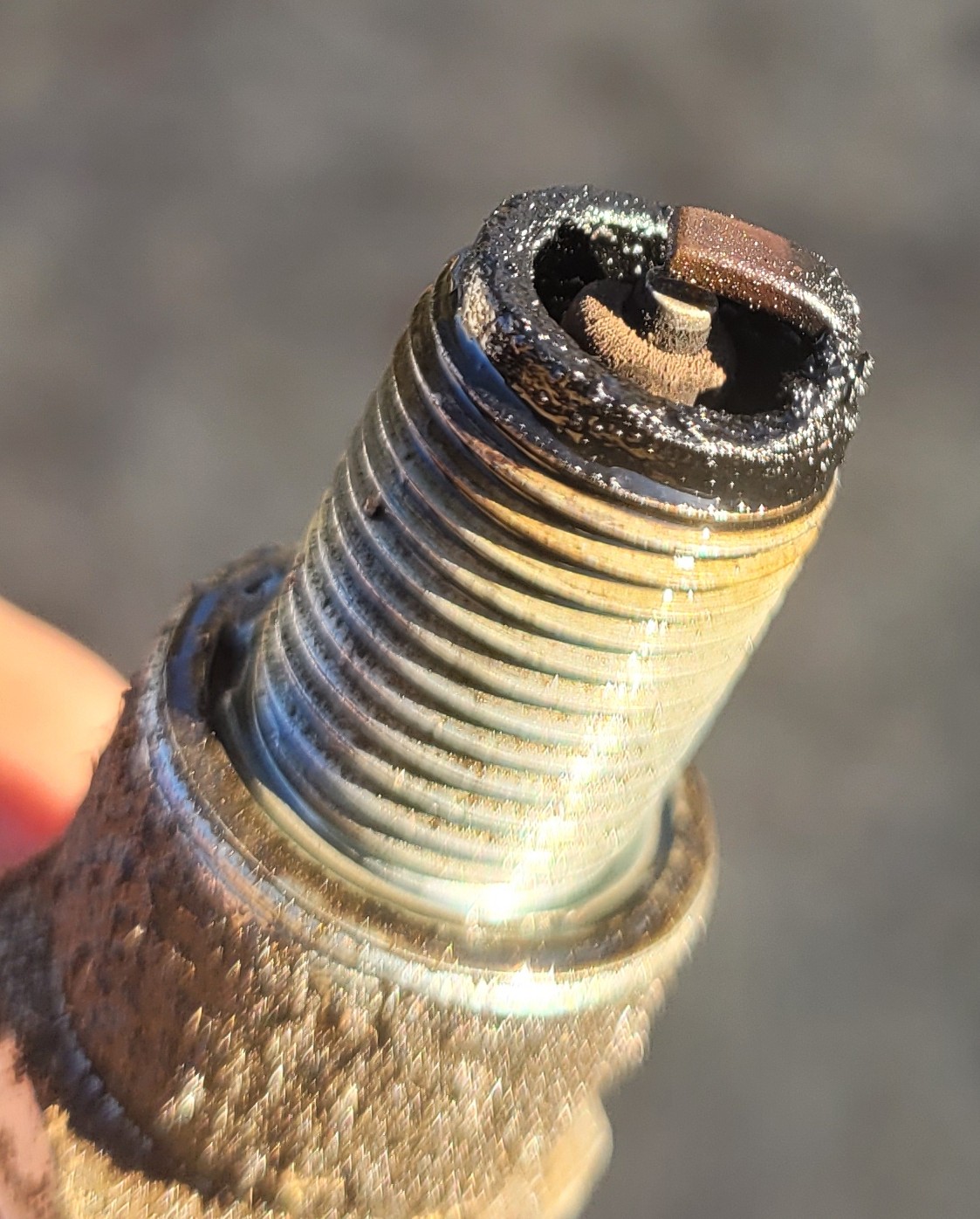

Not an H model... '93 200E. Wife's bike, pretty wet and gunky. She doesn't get it up into the higher RPMs much. I'll pull my 220 plug tomorrow.

What plug is that? What heat range?

Re: Spark Plugs -- Let's see 'em
KDX-G,
if you are asking me: "What plug is that? What heat range?"
Then my answers are BR8EG and 8.

Nah, bradememan's

Switch to an 8, please. That, or go tell her she is going to have to wring it out a lot and then tell her "DO WHAT I SAY". OR....switch to an 8. Either way.

What is all that crust on those plugs??

The 220 plug had decent amount of spooge leaking out around it as it was a little loose. Couple that with a chalky desert dirt ride a few weeks ago and no wash since.
