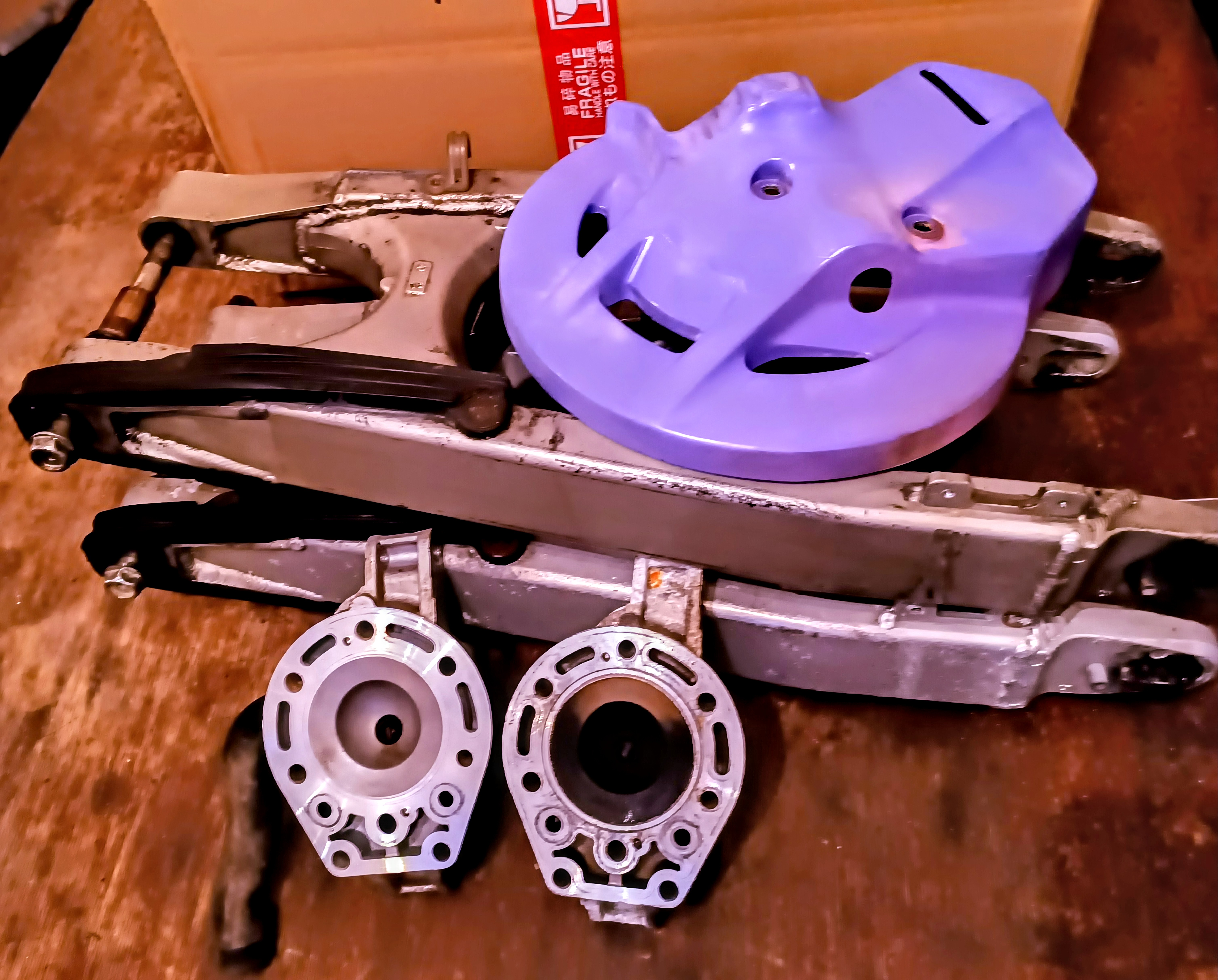

Chuck78 wrote: 07:48 am Jan 30 2025 My Yahoo Auctions Japan bidding is finalized, I picked up a purple front rotor guard for $7.xx, a 2nd 220SR head for $14.xx, & a 2nd 220SR swingarm for $14.xx...
It seems 2,000 Yen is a pretty standard opening bid price, and 1,000 on the small ticket items, no other bids on those. Now, the wait begins....
I ended up at $124-ish in auctions.yahoo.co.jp KDX parts, + $212 in shipping on an auction package shipment "consolidation" via Buyee Air Mail.
Japan EMS post was significantly more money, abd most times they end up using EMS if selecting Buyee Air Shipping option anyways, the Buyee Air option just means they get to choose which is most convenient for them EMS, DHL, FedEx etc.
$25 KDX220SR swingarm
$15 KDX220SR swingarm
$59 KDX220SR cyl head t-stat coolant flange nice shape
$15 KDX220SR cyl head t-stat clnt.flng corroded exterior
$10 KDX125SR purple front disc guard
Not bad! I wish I could've found a KDX200SR or KDX220SR gearbox/transmission with a good output shaft though... But I'm perfectly happy with the 200E/200H/220R gear ratios as-is, but on a future rebuild, an SR 1st gear might still be in the cards. I do have 2 bikes but 3 engines... The 99 220R''s cases will get split soon to send out the crank, but will get a good complete bottom end swapped into it for now, the original bottom end will be the spare then, and I can wait for the 200/220 SR gearbox...

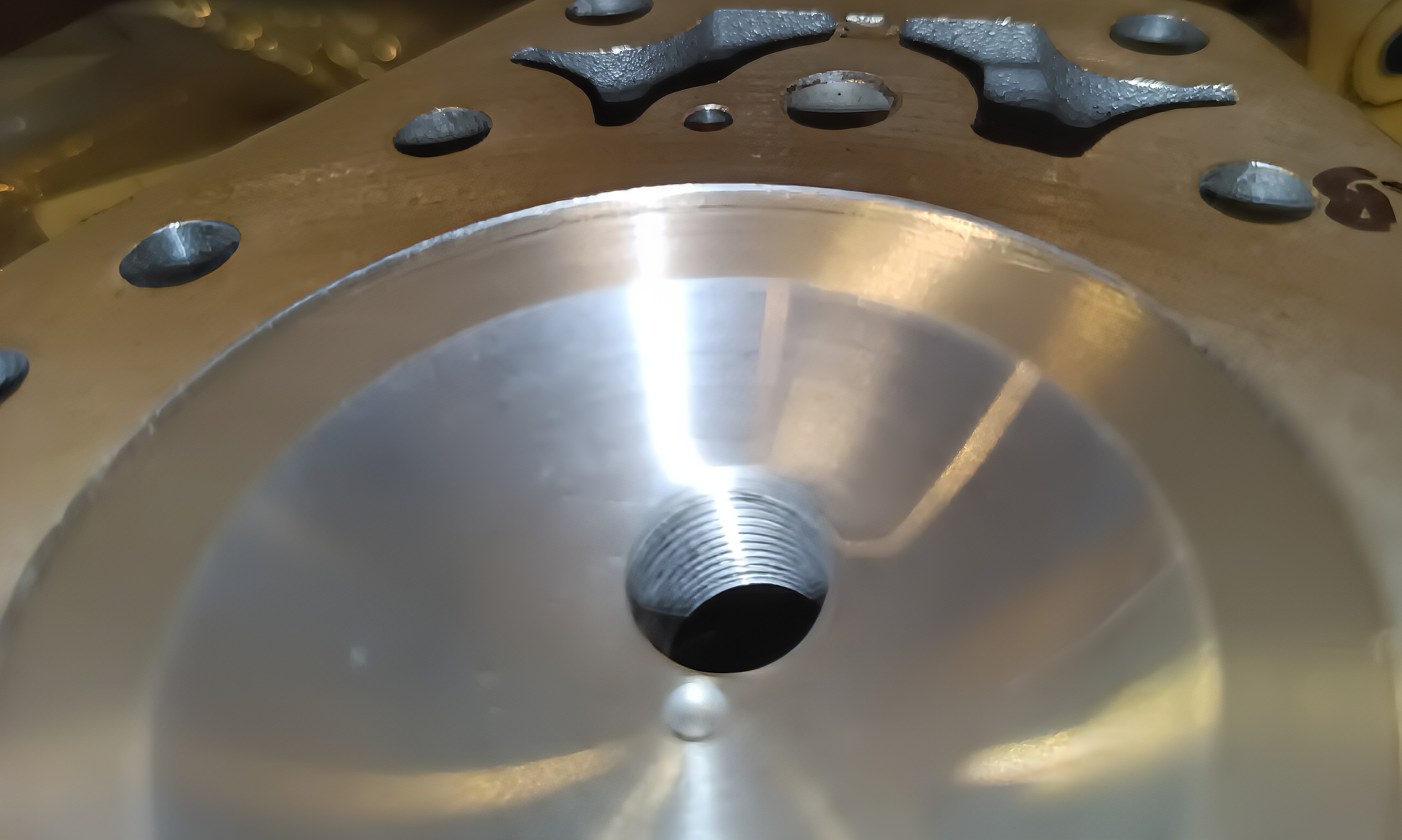

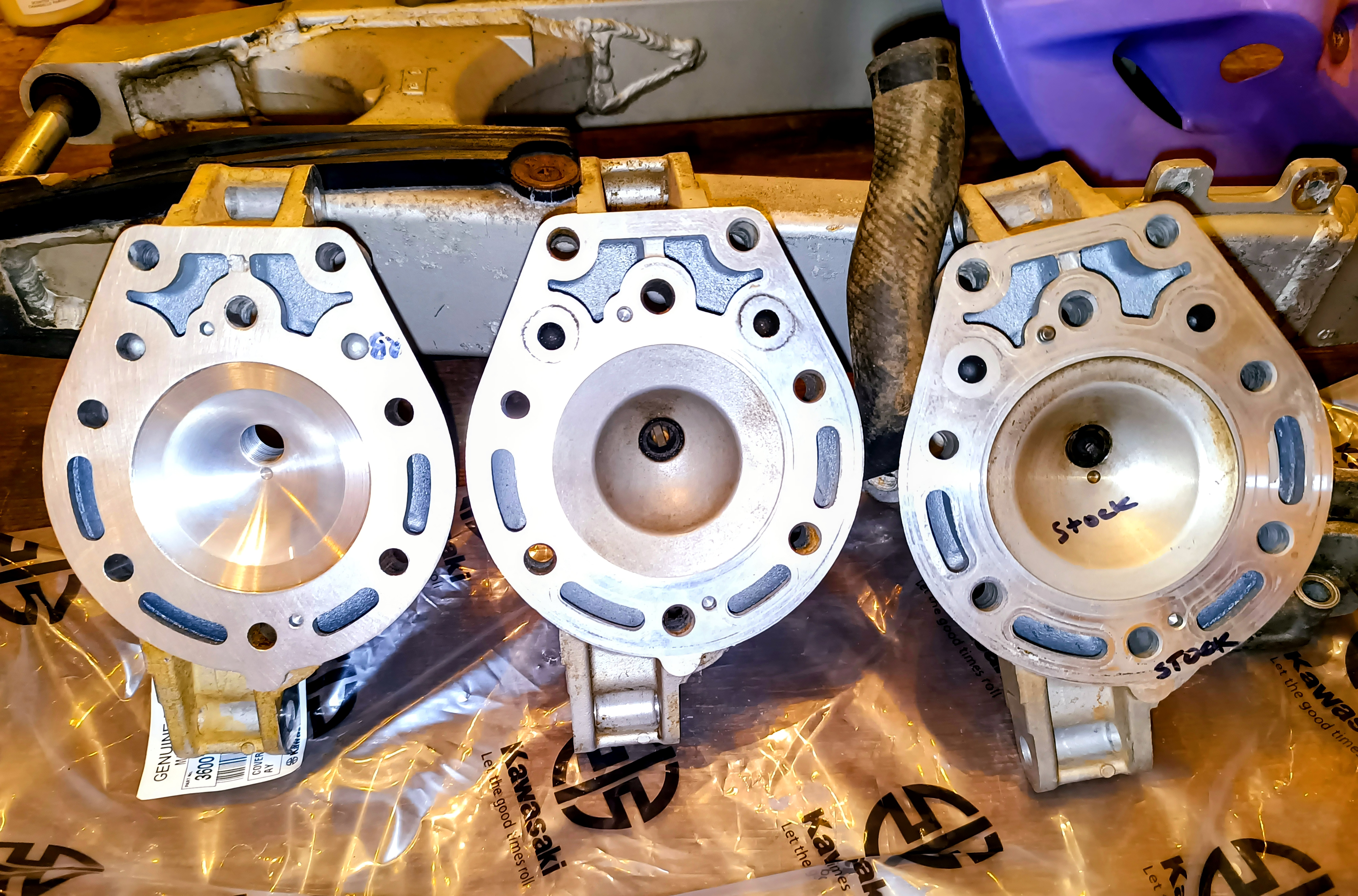

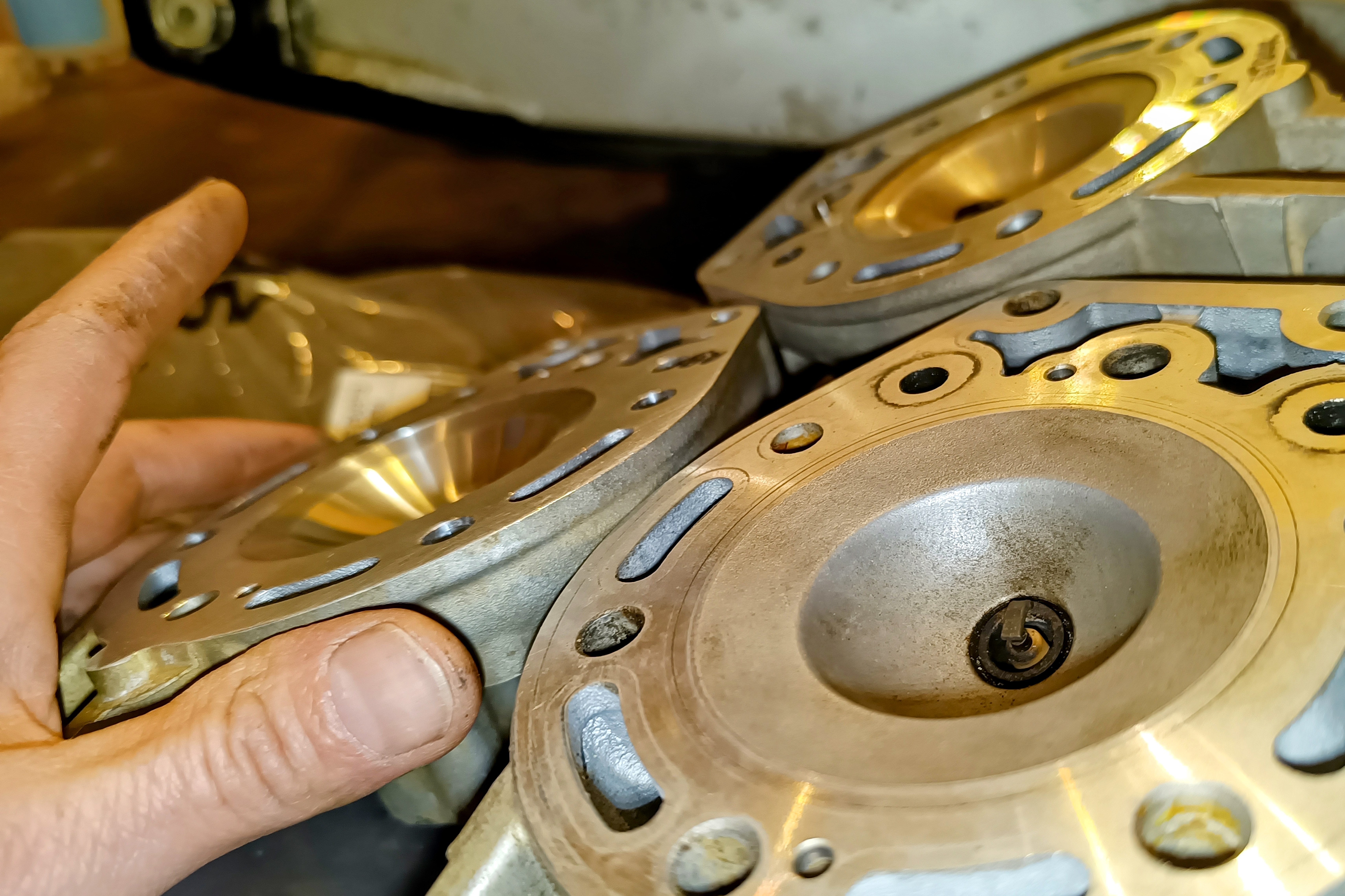

RB 220 vs 220SR vs stock 220.
The SR squish band height tapers off to virtually nothing, I can catch my fingernail on the step down from the gasket surface to the squish band area, but it is very miniscule, perhaps half that of the RB head and a tiny fraction of what the stock KDX head has (which has a very tall squish clearance).
Now I need to get a oral syringe with 50 cc/ml graduations on it + a piece of plexiglass to measure the RB 220 versus stock 220R versus 220SR head. The SR head, looking at it next to the other heads, I believe I will definitely want to take some out of the squish band to enlarge the dome slightly, but I'm not sure what the volume is like, it is 5.5mm deeper dome than the stock head... That's quite significant! So I take it this one will need milled a fair bit as well. I'll measure the volume versus an RB head and try one stock, and then machine the other one to be closer to the RB head but not quite, I do like the low end torque tractorability but I also like to go fast. Excessive speed is what usually gives me broken bones though!!!
The shipping speed backfired on me, as I'd expected the package would arrive AFTER my wife went out of town for two weeks. This one didn't come in under the radar unfortunately.
The present exchange rates were too good to believe, I couldn't pass up on that.

Following, very interesting, so you are thinking the SR head has a tighter squish band but less compression?
Did the swingarm come with good bearings so you didn't have the hassle and expense of replacing them ?
I was always amazed at how quickly I received parcels from Japan

Significantly tighter squish band than stock , slightly tighter than an RB head by a very small margin, but perhaps same or similar compression ratio / volume as stock.kdxdazz wrote: 08:13 pm Feb 06 2025 Following, very interesting, so you are thinking the SR head has a tighter squish band but less compression?
They have a 5.5mm deeper chamber/dome - but a massively wider squish band which takes up a lot of additional space in there, hence why the chamber is so much deeper, because the chamber's o.d. is much smaller due to the wide squish band taking up so much of the volume.
I'll try & cc it in the next few weeks
I didn't check the bearings but I'd planned on replacing them regardless. I need one of those Motion Pro installer tools for swingarm bearings or else turn up some aluminum press adapters to use with a piece of threaded rod instead of my prior method of using strategically sized sockets and threaded rod... I could machine a step in it to set the bearings at the perfect exact specified depth every time if I DIY it on the metal lathe

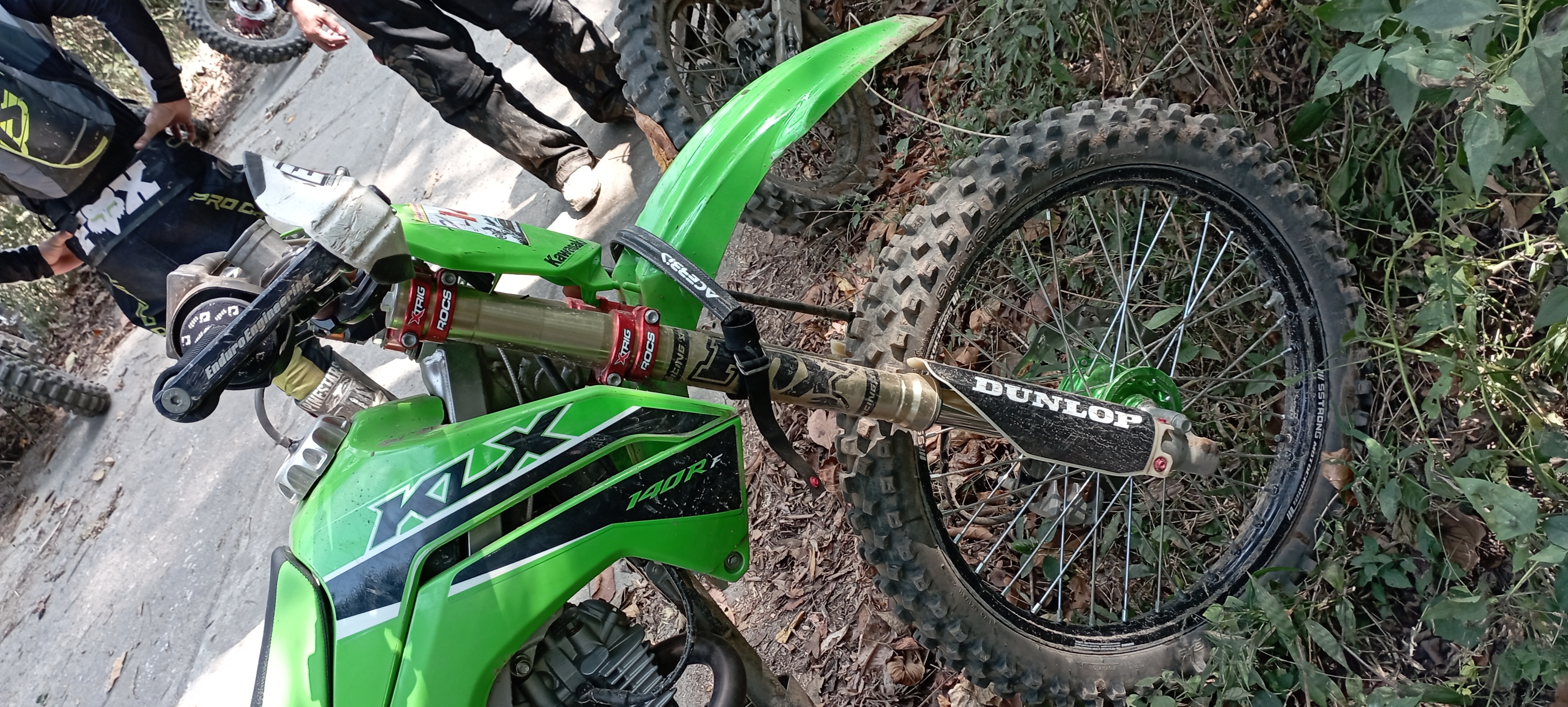

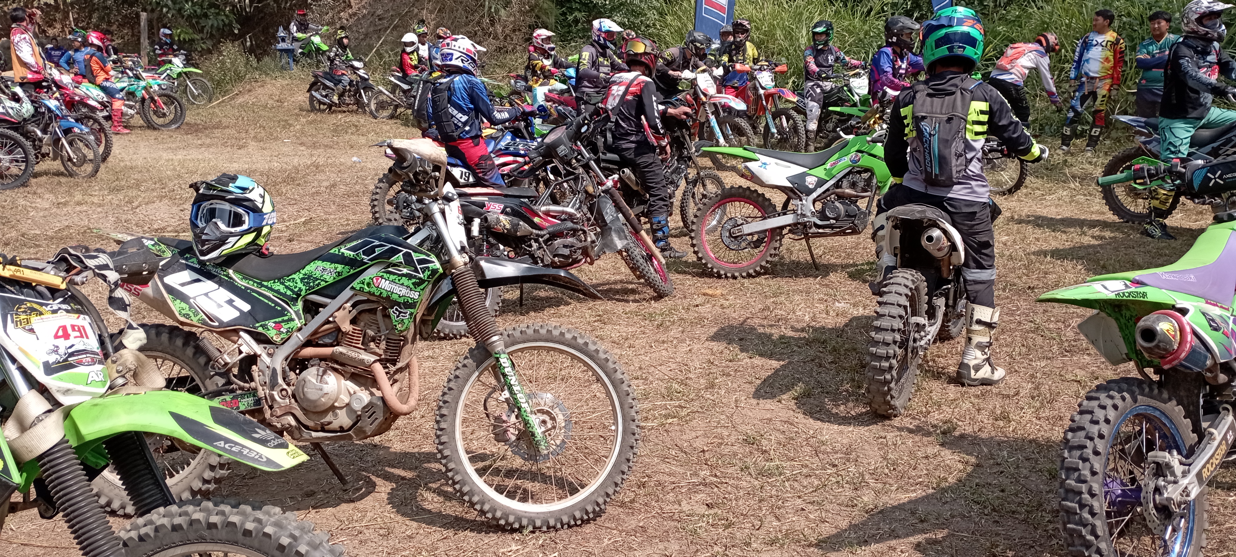

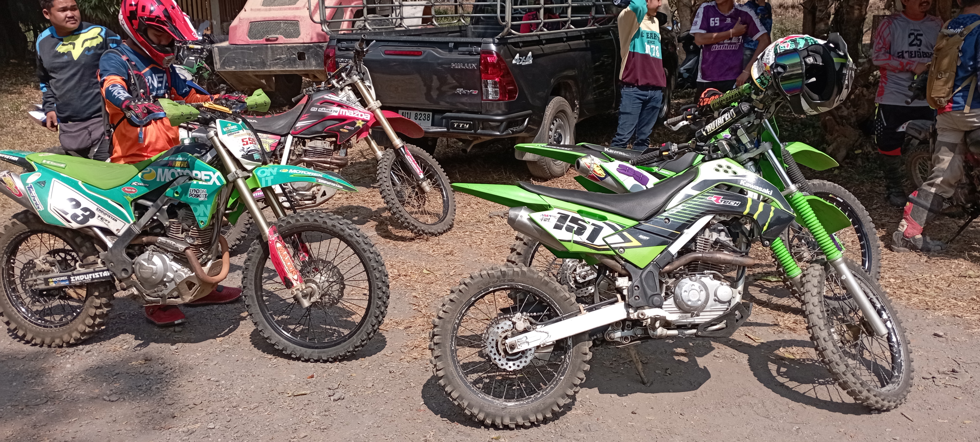

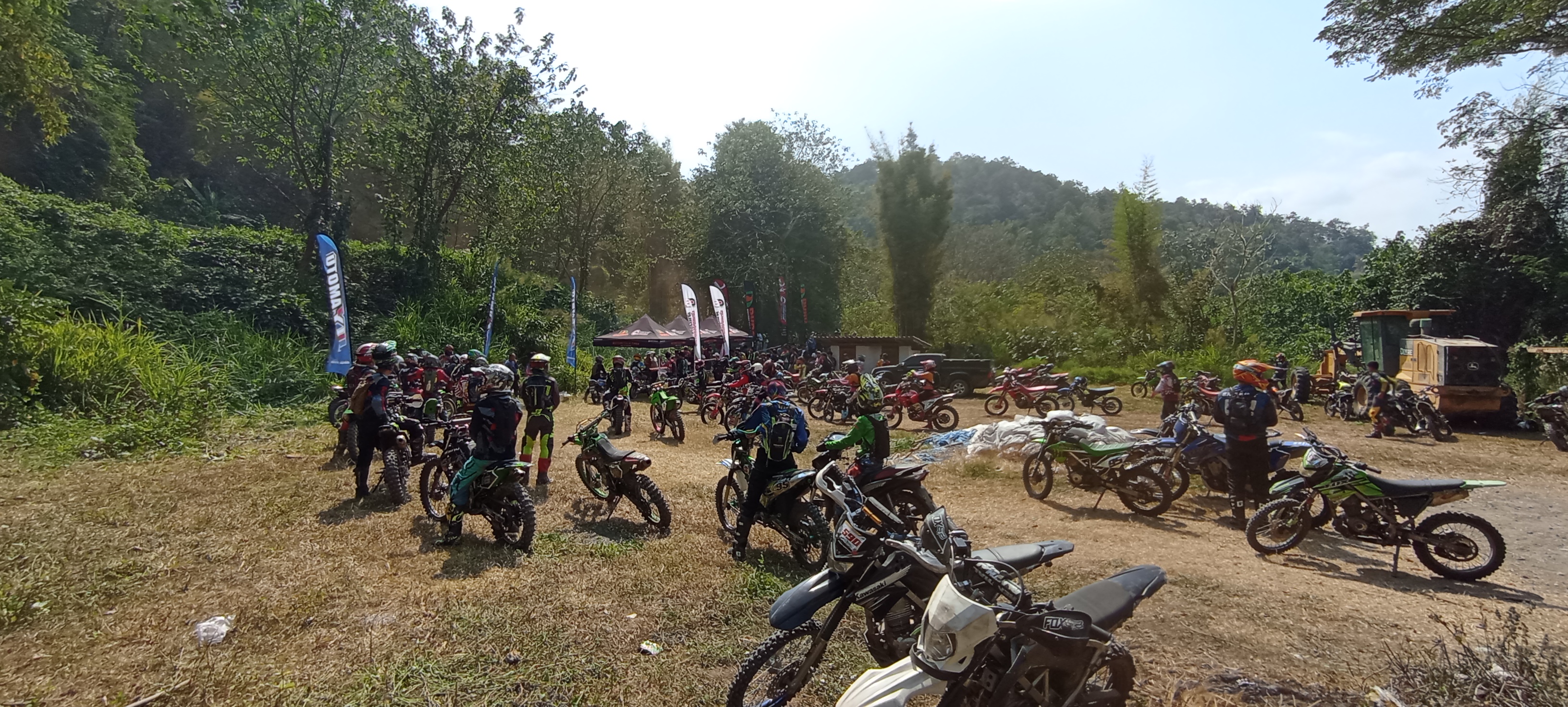

There was a local enduro race today so took some pics of the klx150's , over 600 bikes entered and I would say at least 70 percent were klx150, klx150bf klx140KDXGarage wrote: 11:22 pm Jan 31 2025 kdxdazz, if you could and have time, can you make a new thread with pics of some of the bikes you see? I am assuming the KLX150 is not the same as the KLX140 firt bike Kawasaki sells here. I know they have a ton of small cc bikes there. It would be cool to see some. Thanks.
Seems most popular fork conversion is crf150r, shortened and kx85 rear shock shortened

kdxdazz, thank you for photos & notes. It's interesting to see what's going on elsewhere. billiekdxdazz wrote: 05:29 am Feb 09 2025There was a local enduro race today so took some pics of the klx150's , over 600 bikes entered and I would say at least 70 percent were klx150, klx150bf klx140

WOW! Sea of green!
Thank you for the pictures. Guy had Xtrig clamps, pretty wild!
