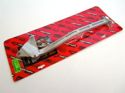

I've just learned that we have another 2004 KX125/250 kickstand option that several people have grafted onto our KDX's...
Fastway aka Pro Moto Billet part # PMB-01-2001
Has anyone here used one?

Do you have a link where the guys are talking about the installation on the KDX? I'd like to read more about it if so. I have a trail tech and like it but I'm not dragging the skid plate over big logs or boulders. I wouldn't like it so much if I was.
I had to remove the foot, cut off about 3/4" and reinstall the foot. On the pro moto billet, cutting it down isn't an option without welding it back together.

I’m considering this, but can it be ran with the ufo frame guards? Looks great

JZ05220r wrote: 05:32 pm Feb 20 2023 I’m considering this, but can it be ran with the ufo frame guards? Looks great
Better late than never, if you haven't figured it out, now you can't really run the UFO frame guards as they are stock with this kickstand mod. It requires welding and fabrication to do these the correct way no matter what, so that they will actually support your weight on the side stand for more than a year or two without cracking the flimsy chain roller tab that is not meant to hold up your weight, which all these bolt to.
I might convert to Yamaha aluminum frame style bolt on foot peg mounts and use the Trail Tech kickstand bracket that is integrated into the foot peg mount, then I can use Yamaha titanium foot pegs without modifying them to fit the KDX frame as I had planned to do originally, else I will weld on part of the Trail Tech kickstand bracket to the frame like the KDX 220 SR factory kickstand is, and the way all KDX's should have been, sadly only the street legal 220 model got it nationally. I have two of the KDX 220 SR swing arms being shipped from Japan as they don't have the welded on kickstand mounting lug like all the rest do, e-series, 220r, 200h, KDX 250 etc. that way I don't have to Mill off and TIG weld shut the holes. I'll strip them and sand and highly polish them plus clear coat + 3M adhesive backed thick clear vinyl protective wrap layer on the flat outer surfaces.
