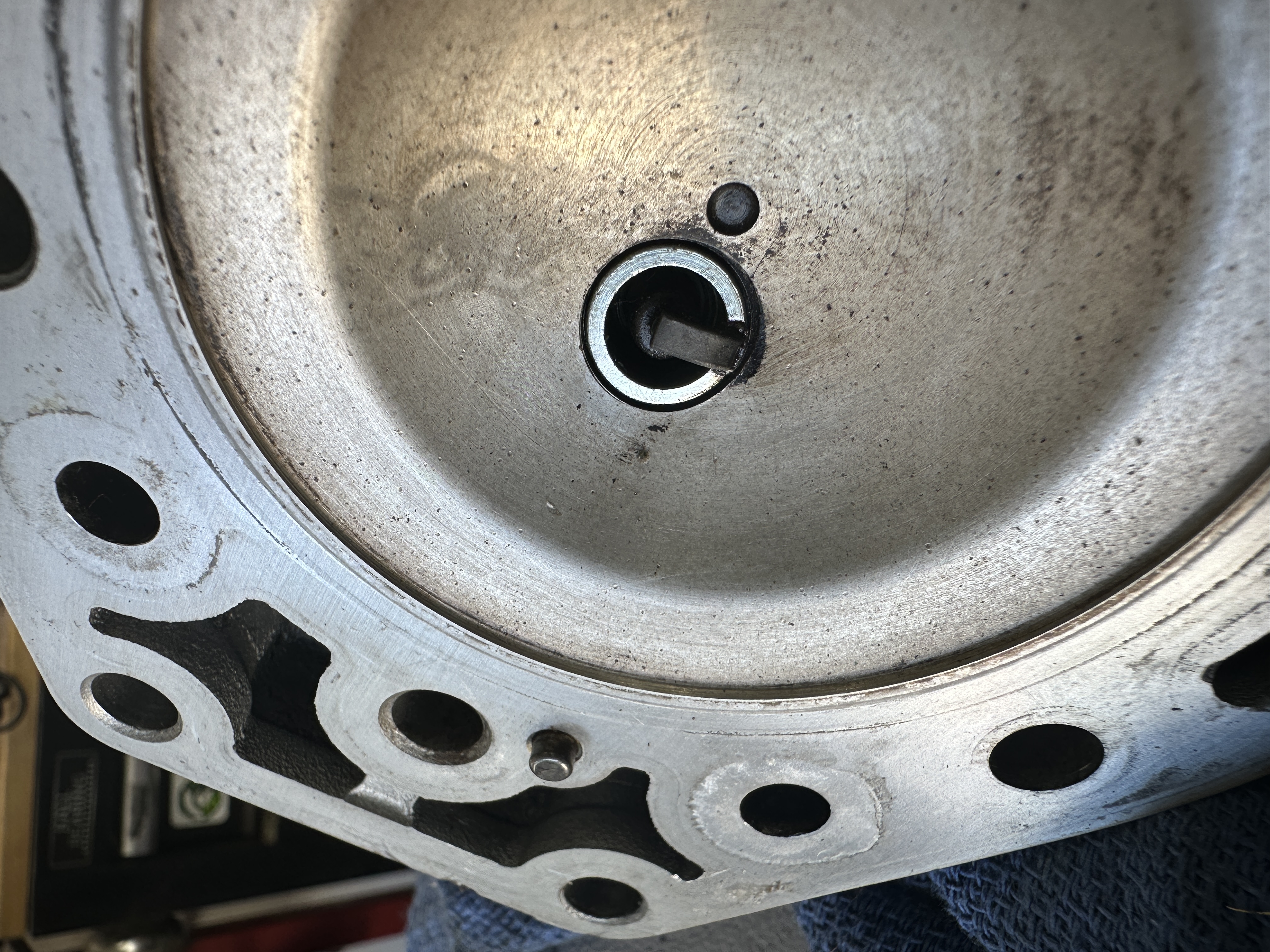

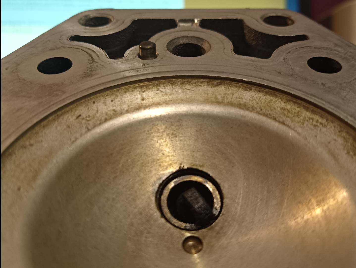

Re: Identifying RB modded head
Looks like maybe not?
I'm fairly certain that is totally stock, not shaved, definitely not rechambered as Ron Black the great KDX tuning master once had done.

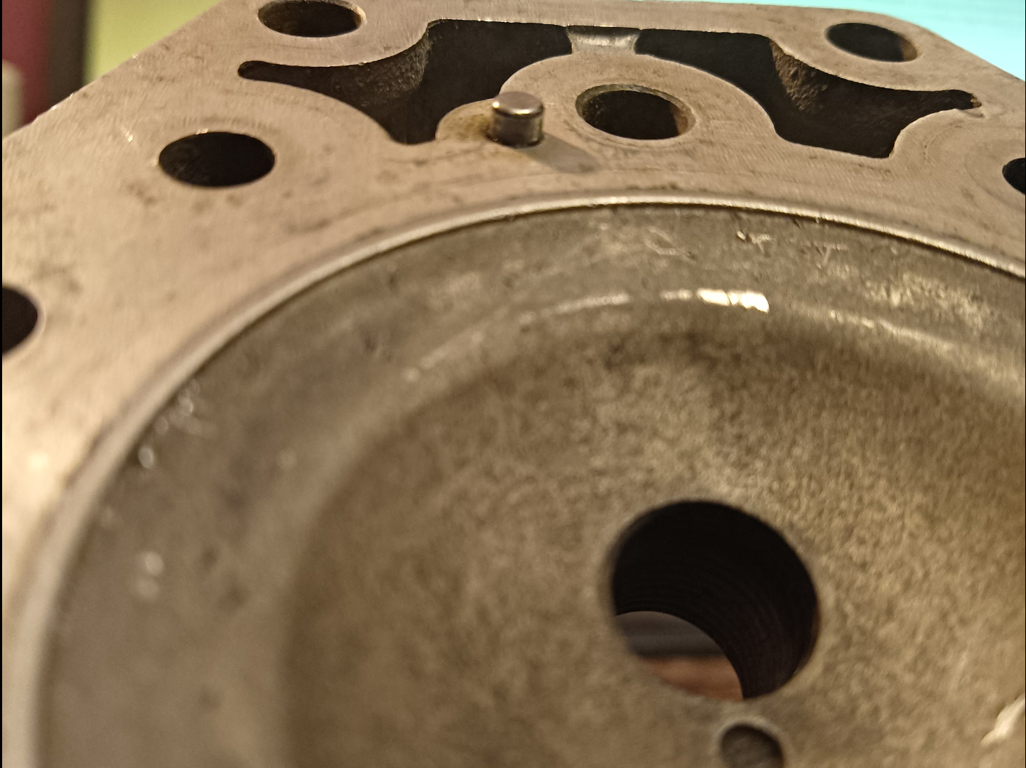

Stock 220 head:

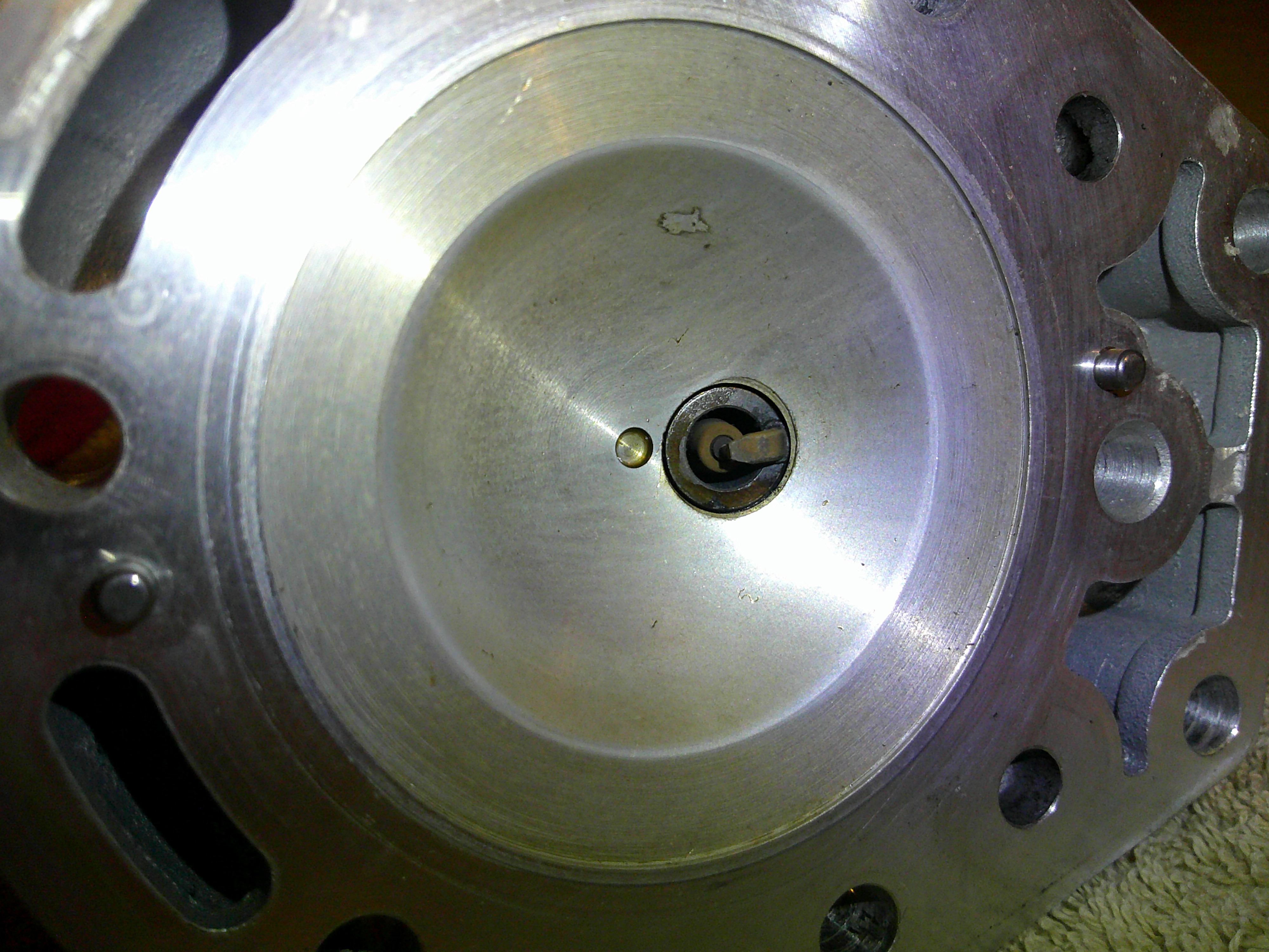

Milled 220 head (Fredette?):
(with some detonation damage marks, this is a fairly high compression head requiring high octane, octane booster, or race fuel)

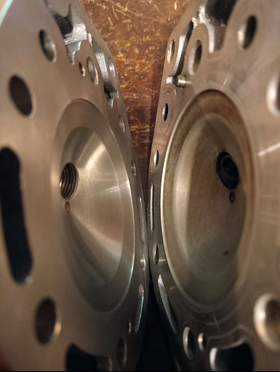

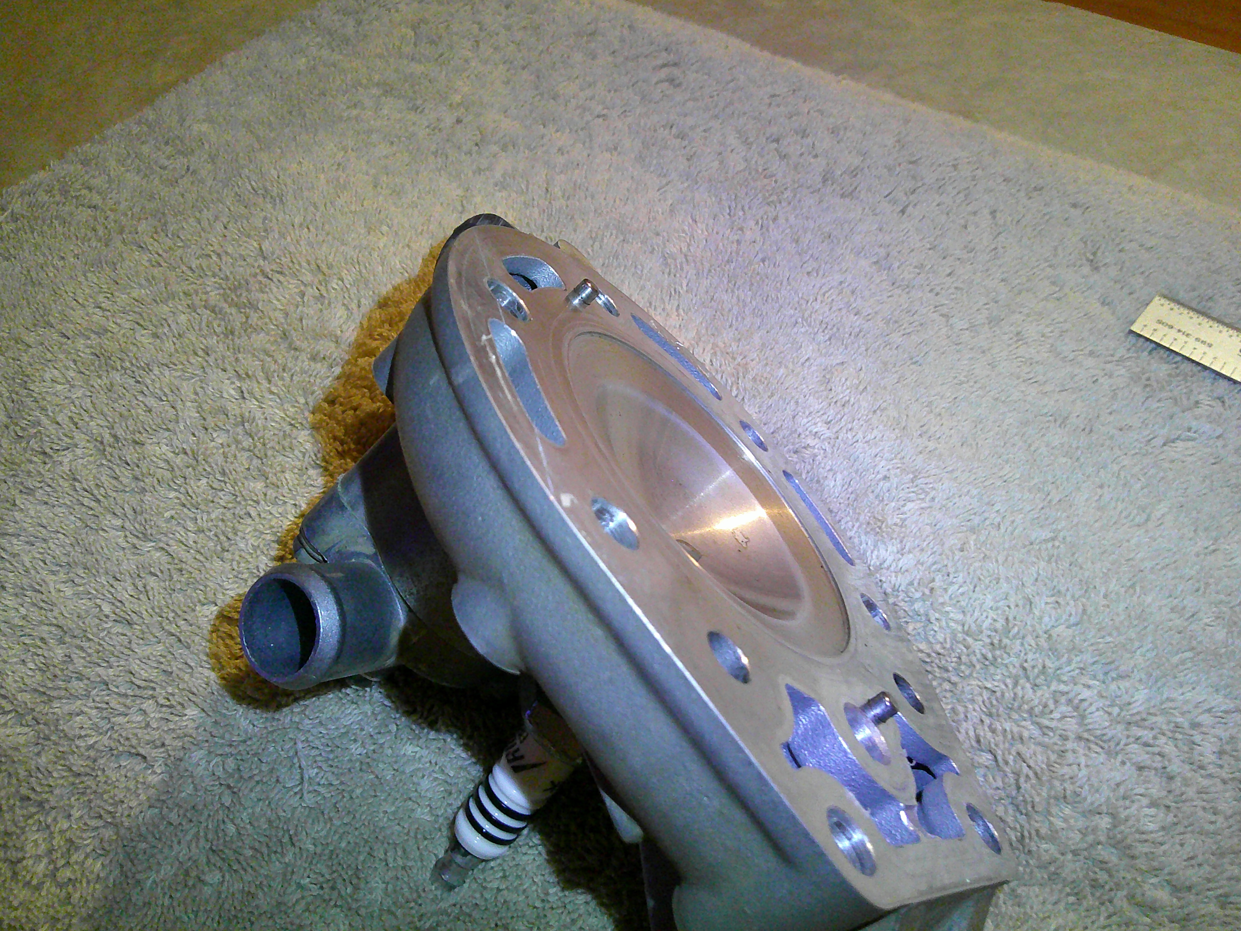

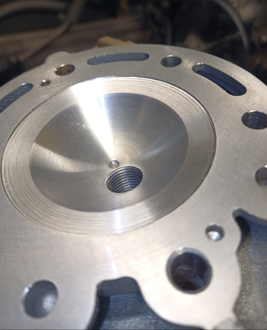

RB 220 head, milled and rechambered, similar compression ratio to stock (higher octane pump gas recommended) but a tighter squish clearance and sharpened transition between squish band and combustion chamber dome):
Ron Black 220 vs stock 220:

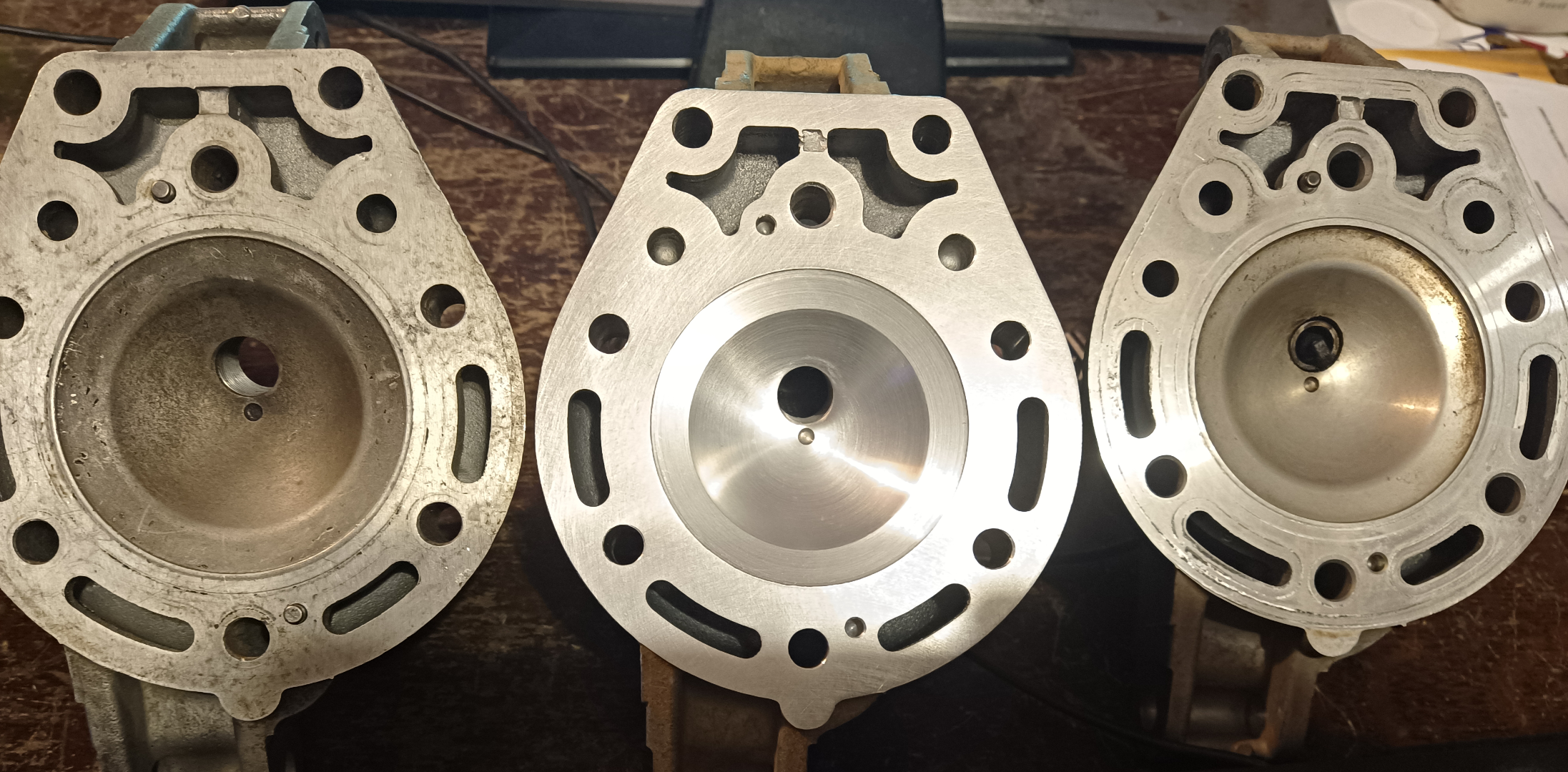

All 3 220 head versions:
