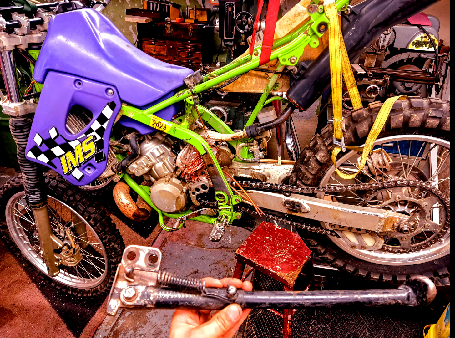

Re: Kickstand
Here ya go, I had it sitting across the room from me as I typed the first reply!
