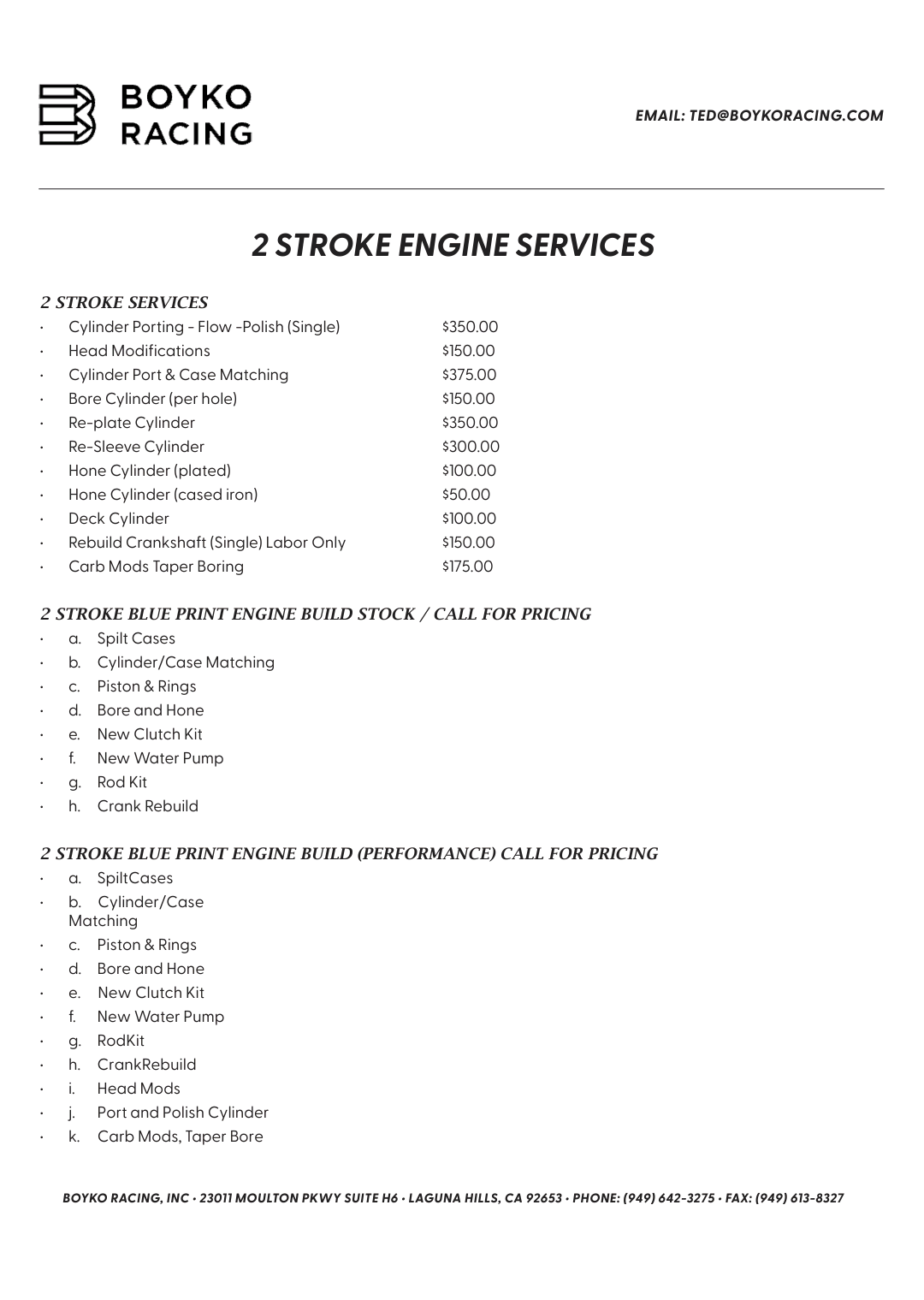

Look up Ted @ Boyko Racing in California. He's a porting/head wizard, and has been since the late 1970's on the DG/Suzuki race teams. He's done a KDX200H cylinder and head for a friend of mine who actually works part time 1-2 weekends a month for Ted in the busy seasons. He milled the base gasket area down to lower /advance the port timing instead of taking such a substantial amount off of the head, which is an approach for the 200 porting that I would fully endorse in order to get it to run more like a modified 220...
I may send Ted a cylinder or two of mine very soon.
https://boykoracing.com/
Ted Boyko Pricing
Ted Boyko Pricing
Sebastien in California who helps out Ted at his Boyko Racing shop part-time during the busy seasons when Sebastien isn't working his day job, he sent me a long video via WhatsApp comparing a cylinder that Mitch Payton the founder of Pro Circuit had recently ported, and comparing it to a cylinder which Ted at Boyko Racing had just ported for him. If anyone else would like to see this, I can forward this video via WhatsApp Messenger.
