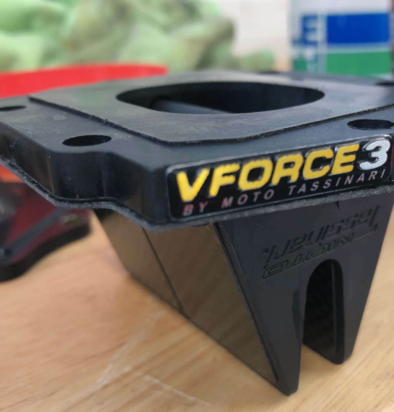

Hey guys
Is this a possible knock-off? Purchased from a private seller on Trademe (NZ equiv of eBay)

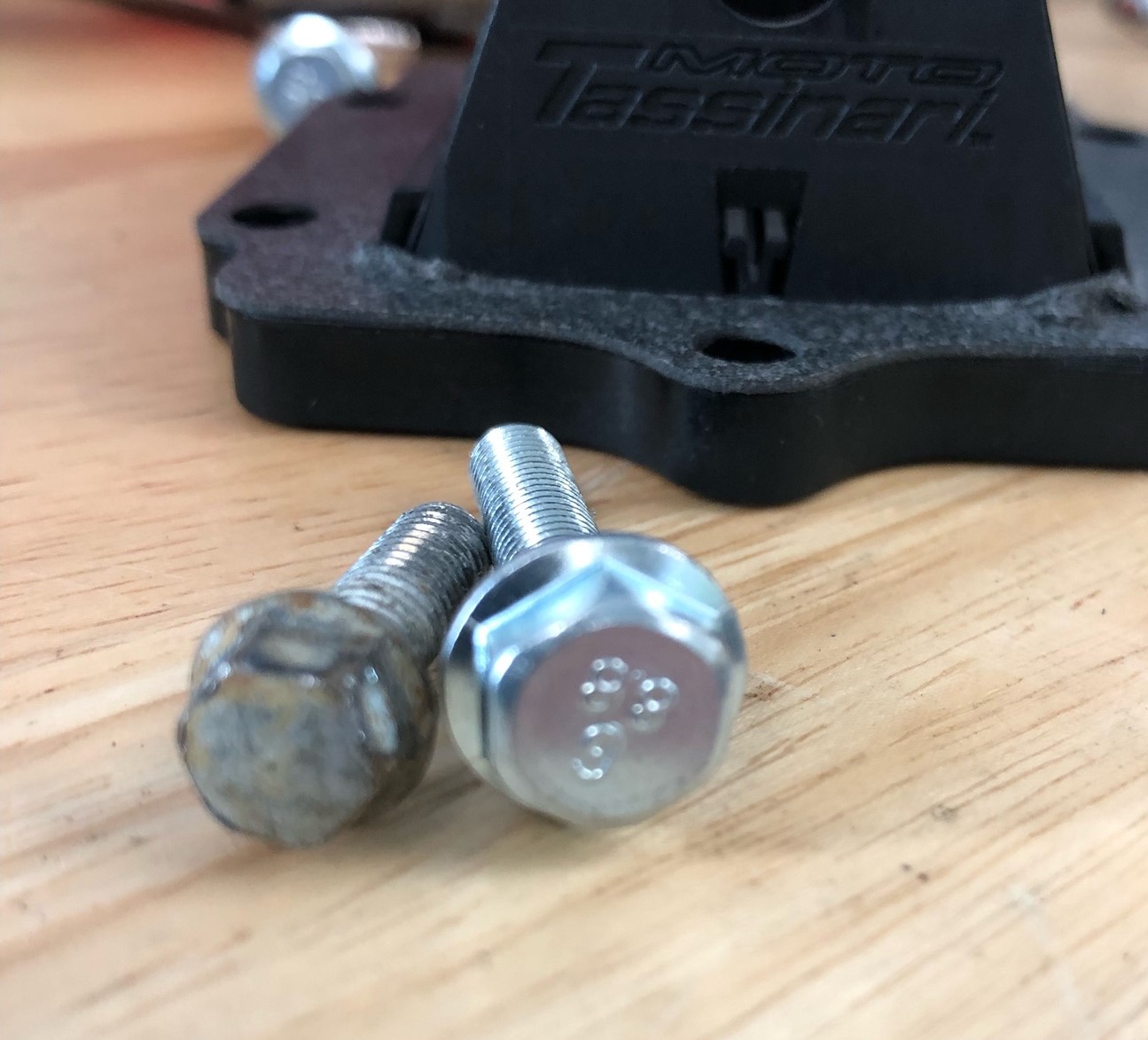

1) Supplied bolts have a larger hex size, too long, and come with nuts!

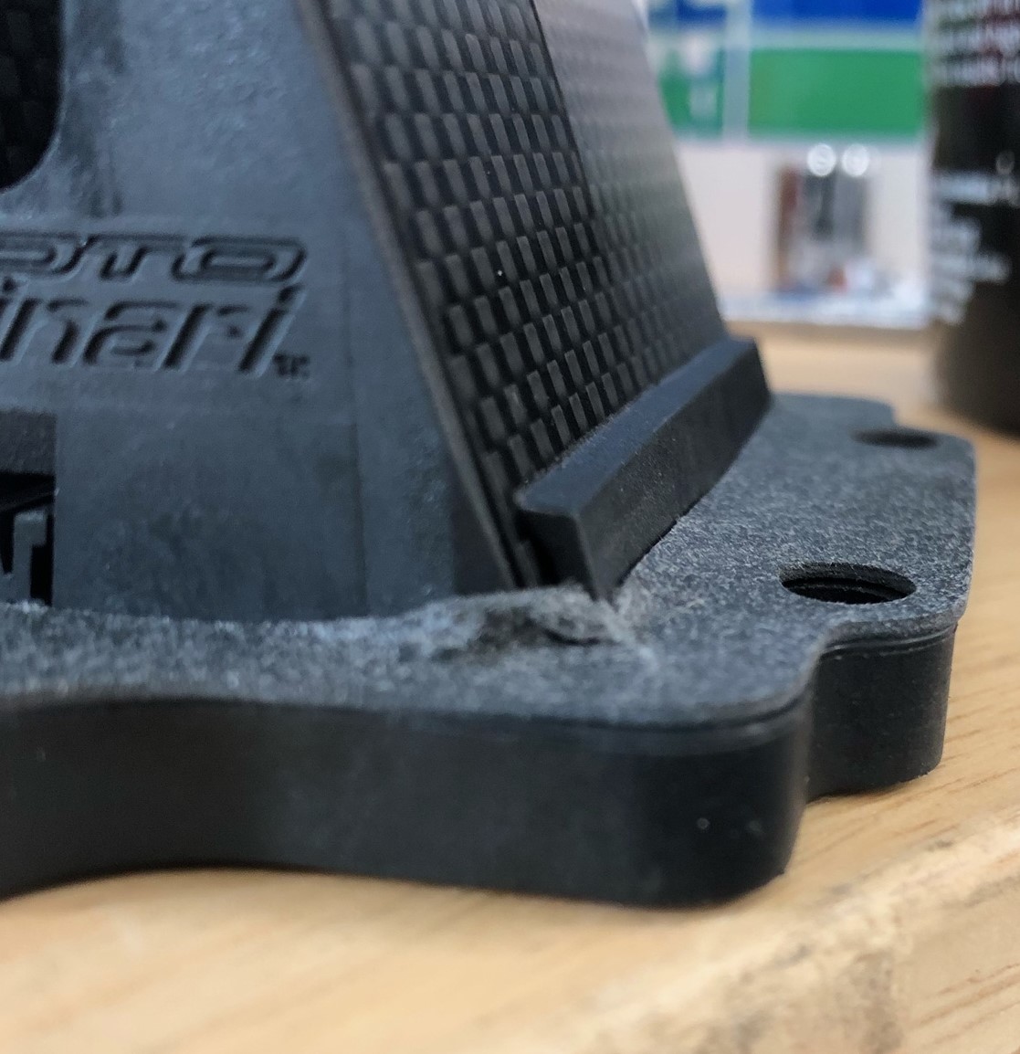

2) Gasket was tight on corners, therefore didn't sit nice and flat.
3) insert is raised about 0.5mm
Your thoughts? Install and send it?
Cheers

Yep confirmed via email from Moto Tassanari "without question a counterfeit VFORCE3 reed valve system"
