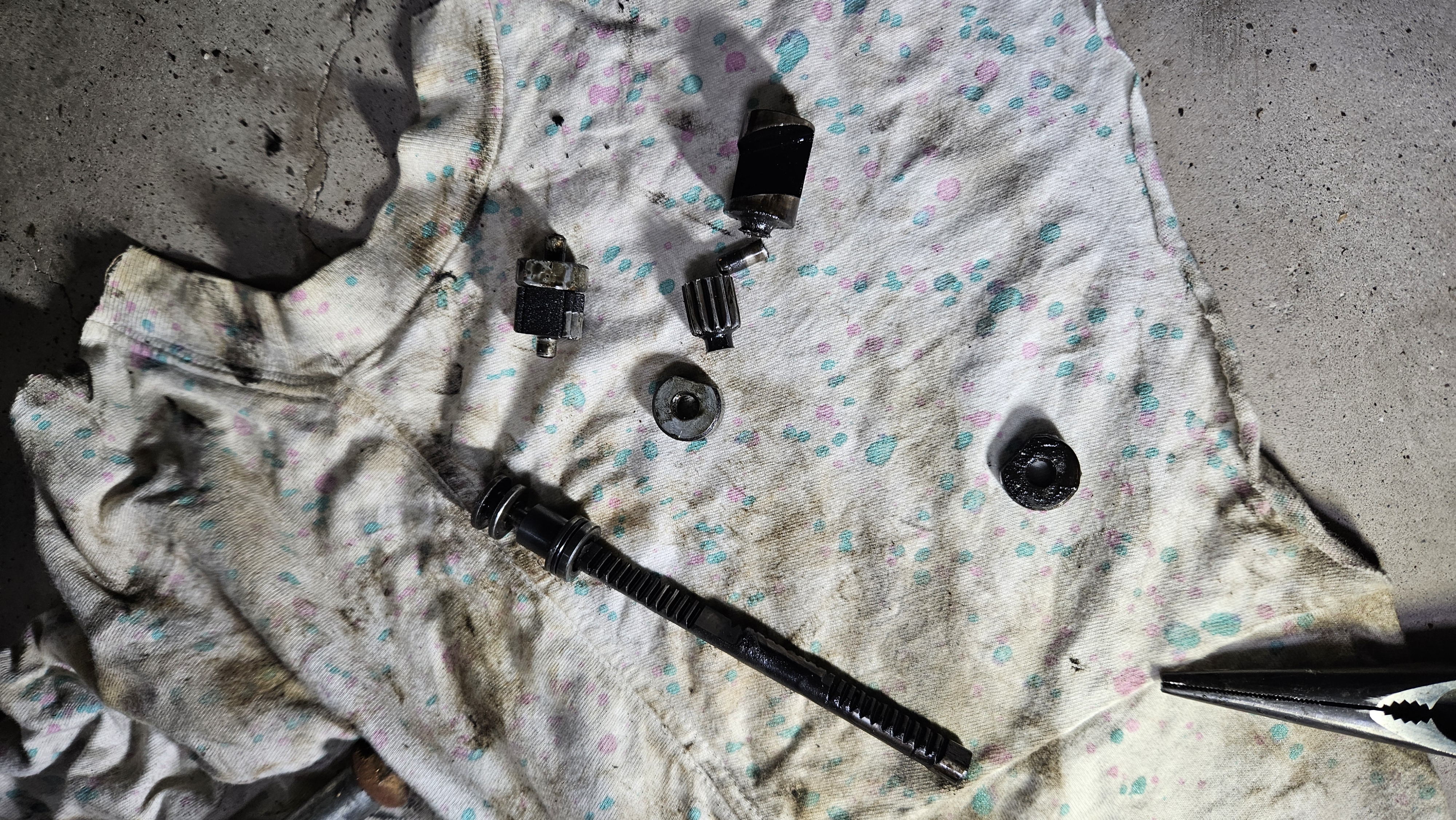

Hi guys, I have a 1990 kdx200sr that desperately needs a new set of kips valves. I have read conflicting info as to whether E series kips valves fit into an sr. I have emailed bkd but no response as of yet. I have a race day coming up soon and would like to order some valves asap as I am in Australia so I thought I'd ask on here while I wait for James to get back to me.
Does anyone know if E series valves fit an sr with little to no modification?

- 20240322_193337.jpg (2.77 MiB) Viewed 27157 times
- 20240322_195000.jpg (3.68 MiB) Viewed 27157 times
- 20240322_194835.jpg (3.75 MiB) Viewed 27157 times

Hi Ben
I have used the BKD valves in my 1990 SR with no issues. I am also in Aus.

Hi Hooters,
Thanks for the reply. I ended up buying an E series cylinder so I can run an fmf pipe with the spring style attachments rather than the bolt on type. It should be back from the platers tomorrow and I'll bolt it to the sr bottom end over the weekend.
Cheers
