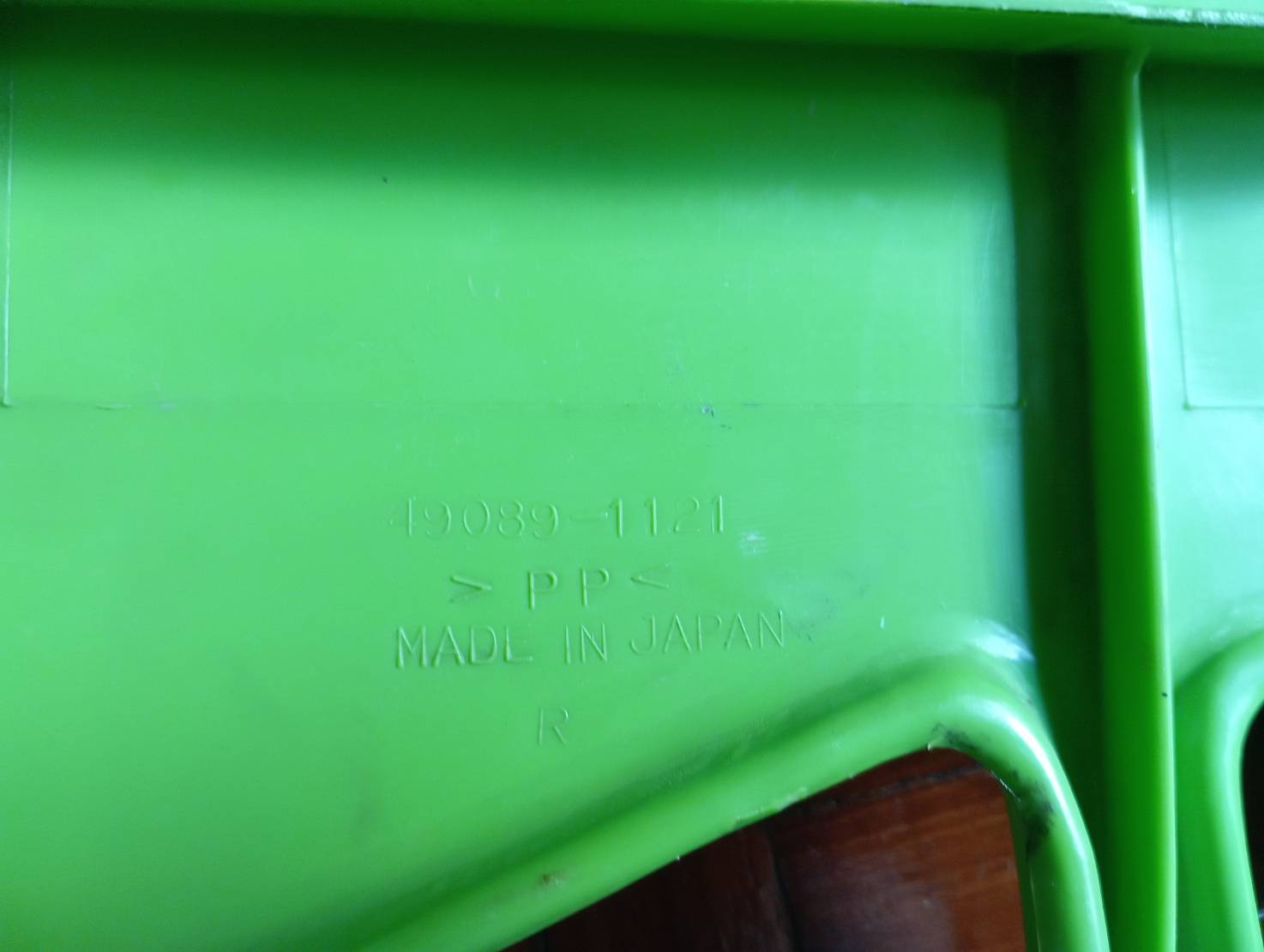

again you are incorrect, the side plastics,front and rear guard and headlight shroud are made from PP, polypropelene, which is clearly labeled on the back of the plastics, the side plastics are made from a much harder plastic(PP) than the others to resist scratches where as the green plastics are designed to be flexibleSS109 wrote: 01:29 pm Dec 22 2023You are correct! I don't know why I said that. Must have had it on the brain.

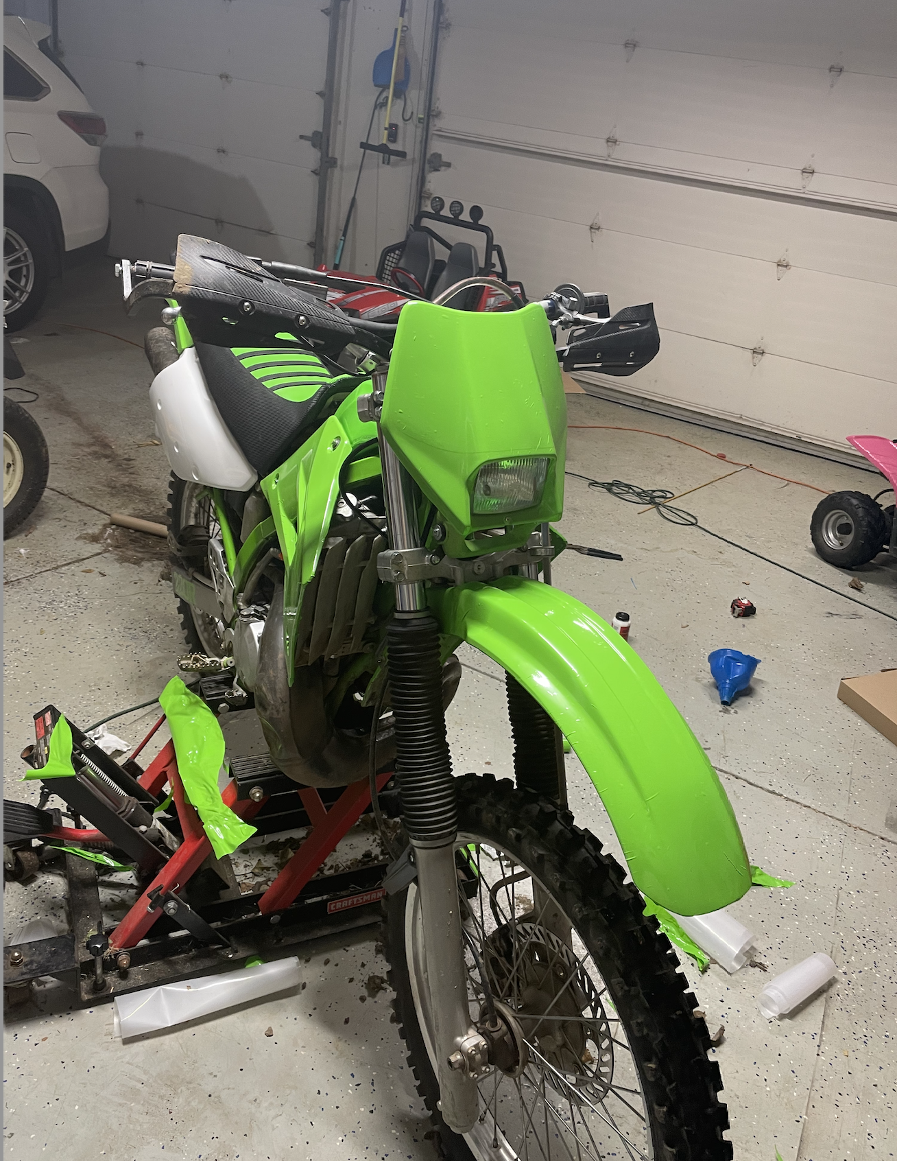

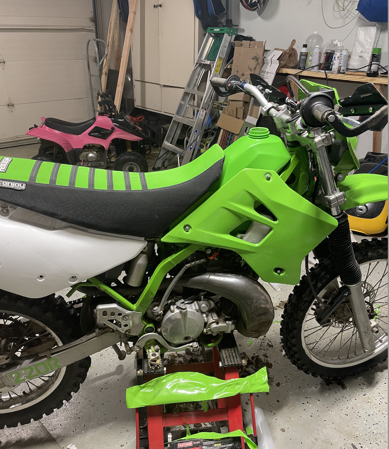

small update on my end. I tried some light sanding on the tail, also tried a heat gun. I was a bit nervous taking it too far and ruining things further. Over the holidays I decided to go another route and wrapped the pieces with vinyl. My brother also ordered me a new Clark tank for Christmas, so I wont be needing to patch the hole.
First time doing vinyl, it was harder than I anticipated and I rushed a few areas which led to the outcome not being great. But from a few feet away it looks shiny and updated, which was the general goal. Color is slightly off from the new tank.

It still looks pretty damn good….great questions that we all have or have had over the years.
