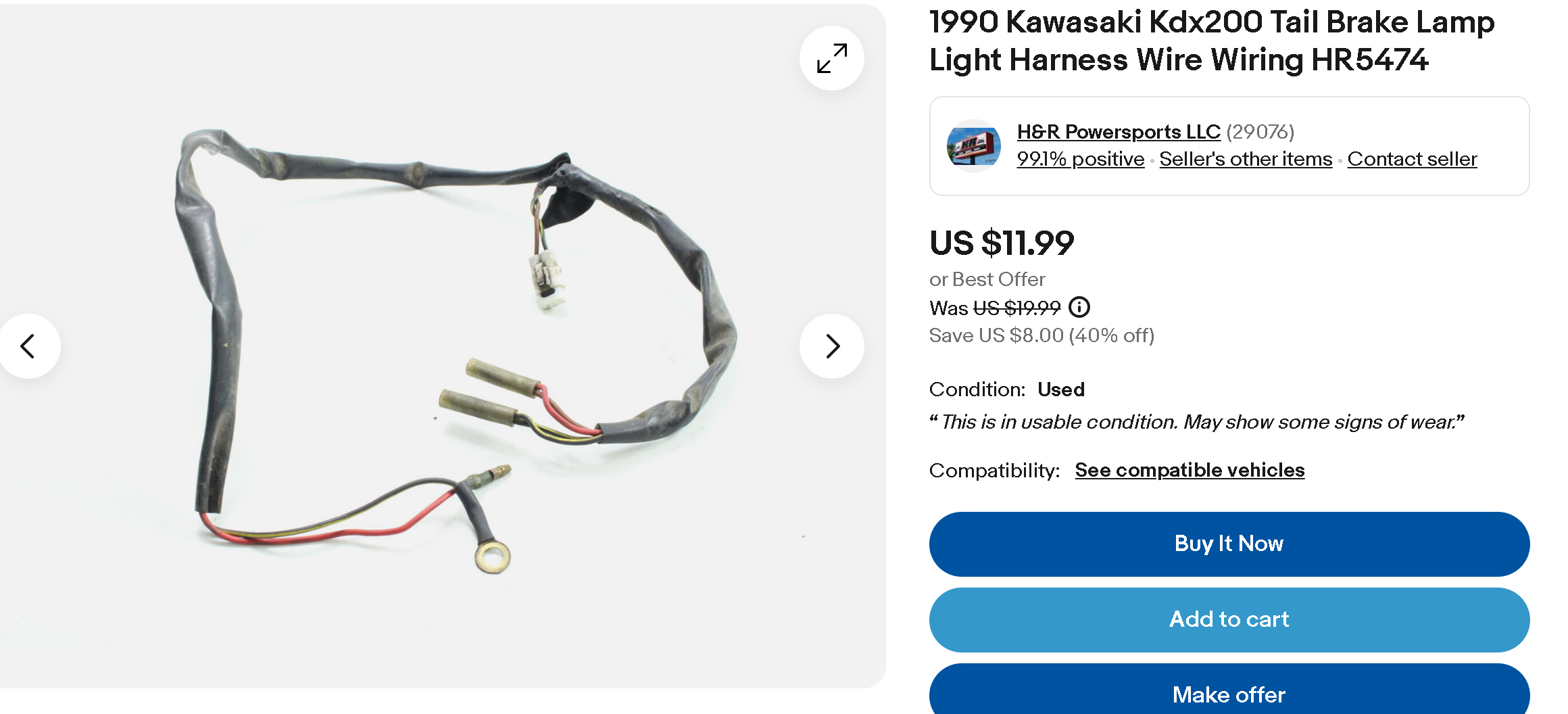

When i got my 1990 KDX 200 all my lighting stuff had been removed including the harness. i've been slowly trying to piece the bike together and i'm now looking for a front light shroud and harness for my bike. I've been trying to source a harness off ebay but i've run into a problem as im confused on what harness i need to get. i've seen two types of light harnesses on ebay the one for the 89 kdx 200 which has the socket for the front light which i assume i need and the one labeled for the 1990 with no socket and only pigtails. ill include attachments of both harnesses
- 1990 kdx harness
- 90 wiring harness.png (404.44 KiB) Viewed 7607 times
- 1989 kdx harness
- 89 harness.png (1.77 MiB) Viewed 7607 times

Hi.
I know this is probably a bit late but I think I have an answer for you.
The harness at the top is for a tail light and the one below it is for a head light. The headlight wiring in the lower pic has the lamp socket connected while the white plug in the upper picture is for the voltage regulator located on the airbox lid.
