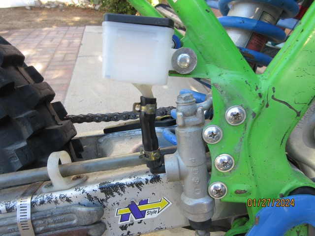

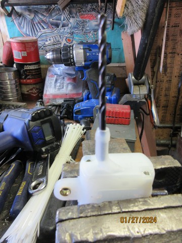

I have an old 1992 KDX250 with a broken rear brake reservoir to be replaced, OEM for ~ $30.00. So, this is an excellent replacement for the price but it will need a simple modification for this to work, at least on my bike. I need to move (bend) the reservoir hose nozzle by bending it from the present position to a straight-down position. A "controlled heat source set to ~440 F using a drill bit.
After Market  Reservoir
After bending
After bending
Installed
Installed
