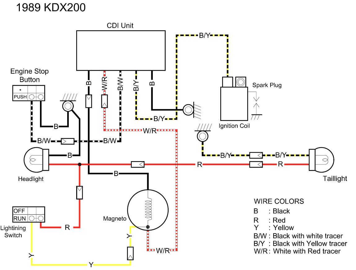

I checked the kill switch as you said and it checks good, but no spark. But when I disconnect the B/W wire I have spark. This is happening with both the old and new kill switch. I checked the harness last week, no visible signs of rub through. It could be a broken wire somewhere under the protective covering. I'm going to work on it tomorrow again. I'll start checking continuity from end to end of each wire.
Thanks for the wiring diagram, that will be helpful.

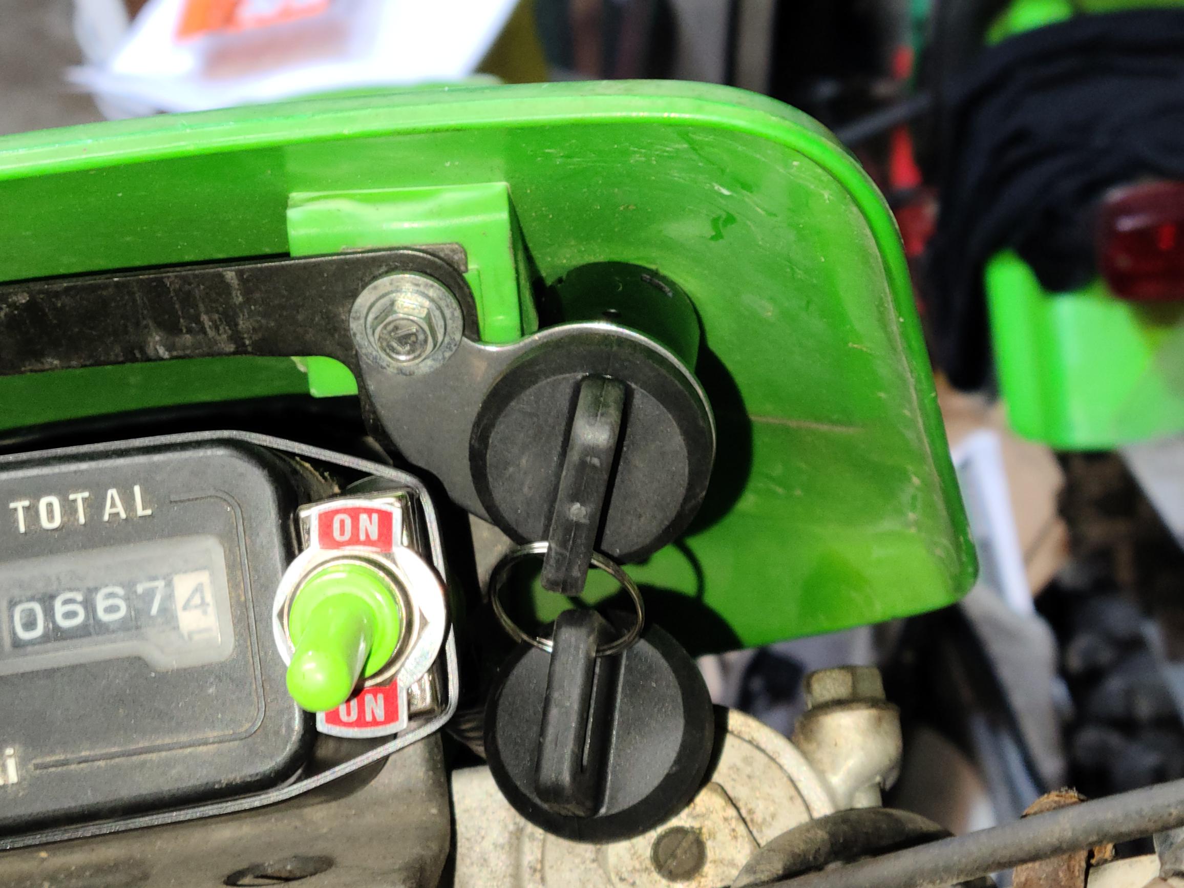

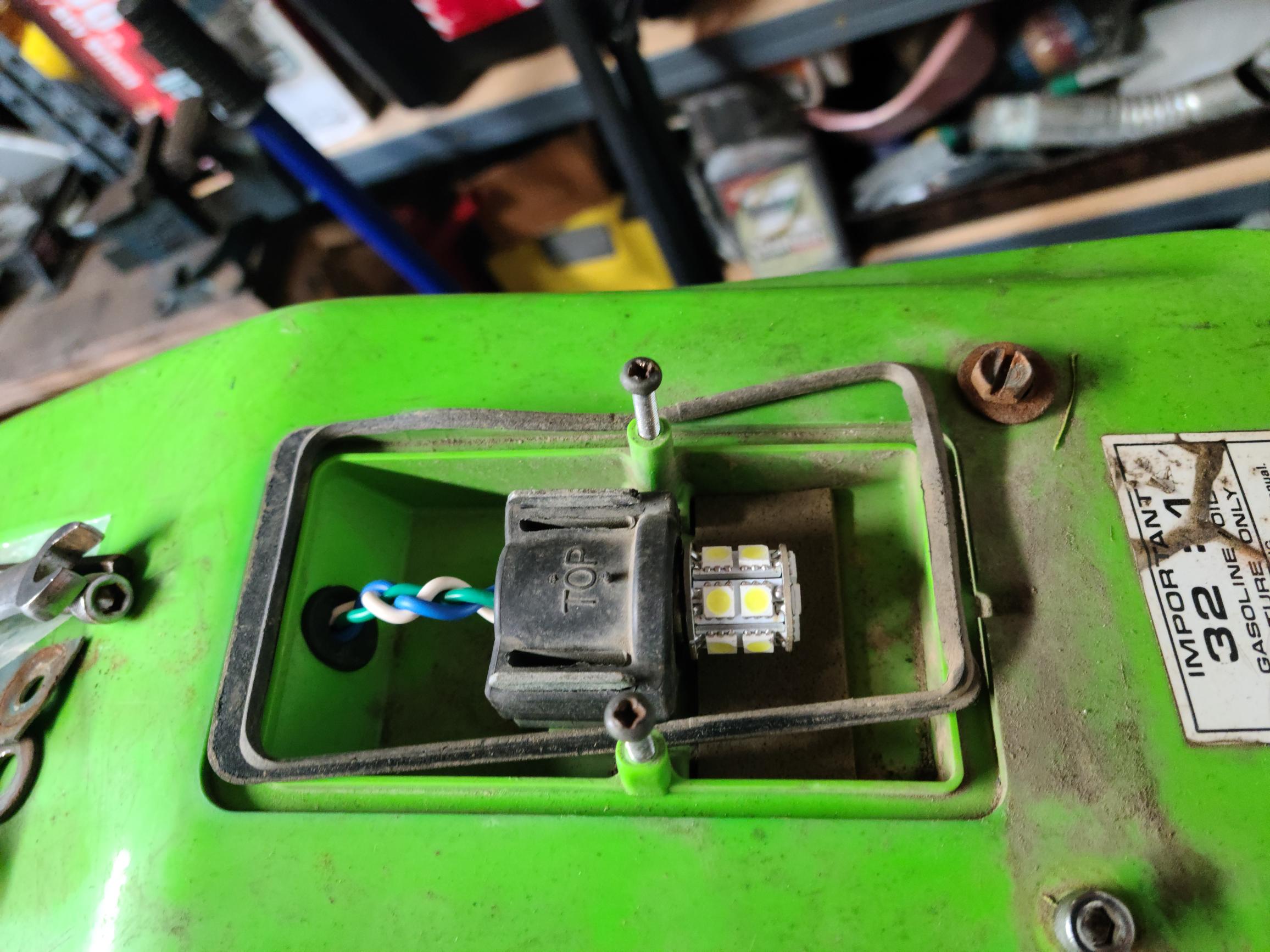

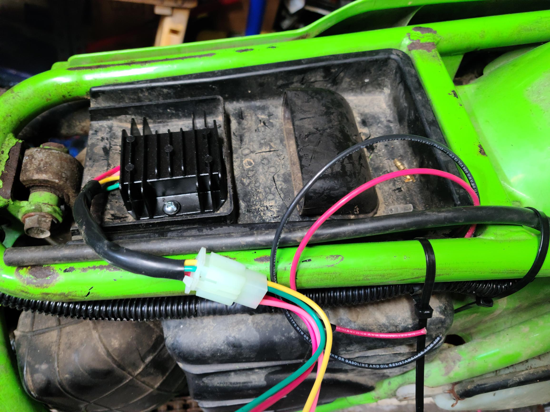

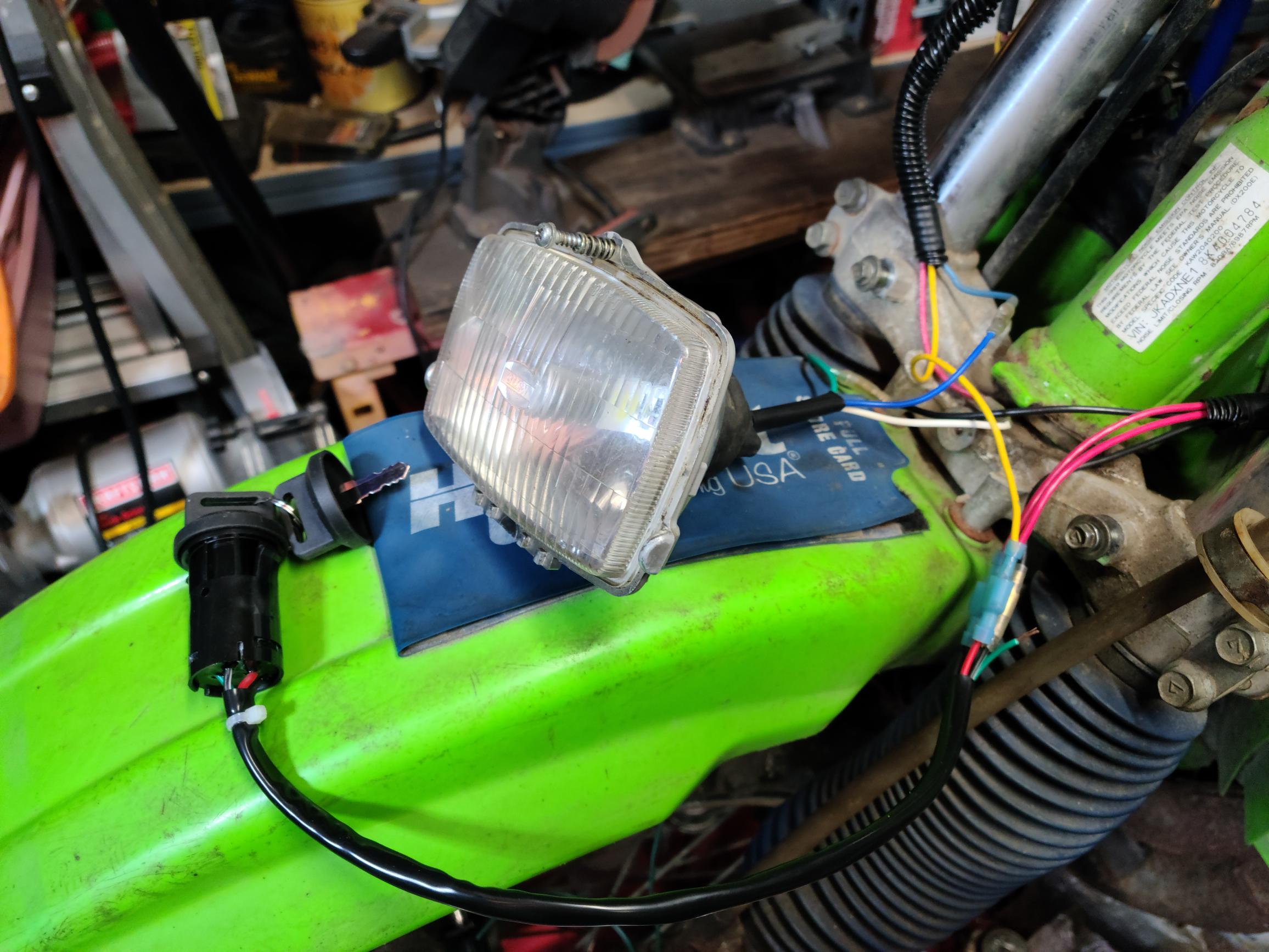

So far I have removed all the factory lighting wires, the bridge rectifier mounted to the top of the air box and ran new wires to the headlight. I replaced the headlight socket with one that is wired for hi/low beam and the taillight socket with one that can also do a brake light. I'm wiring in a SICASS Racing Universal Keyed Kill Switch. In the off position it works like the kill switch so the bike can't be started. In on position it will put power to the lights, eliminating the factory light switch. I'm also adding a KEMIMOTO Motorcycle License Plate Bracket with license plate light and the Tusk Enduro Lighting Kit Battery.

- Bridge Rectifier on Air Box Cover
- 20231223_223152.jpg (429.14 KiB) Viewed 7109 times

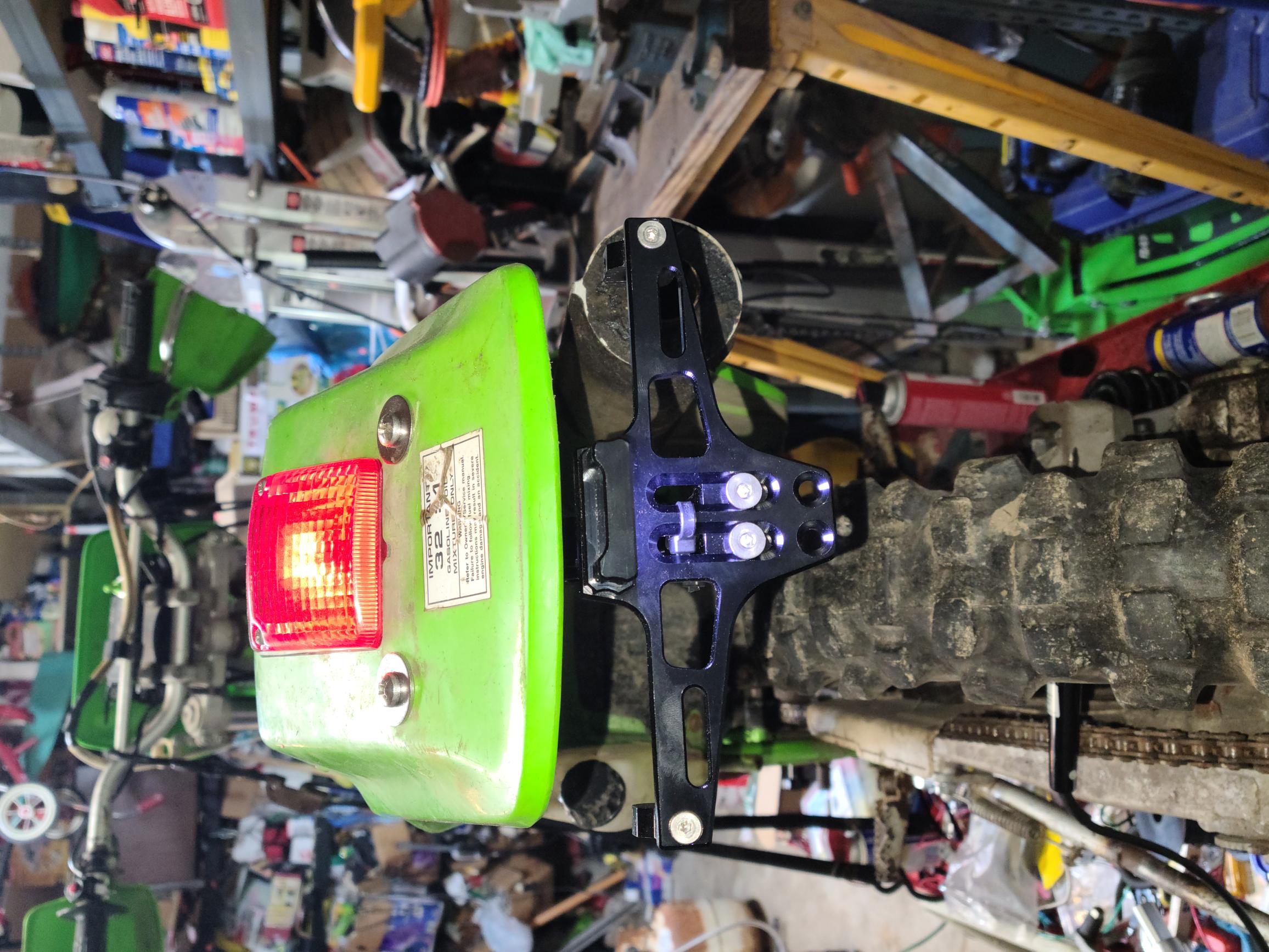

- New Taillight Plug installed in the stock rubber mount with 1157 LED bulb
- 20231223_223119.jpg (358 KiB) Viewed 7109 times
- New headlight socket installed with original rubber cover. Keyed kill switch almost installed, I need to solder on one more wire.
- 20231223_223042.jpg (353.56 KiB) Viewed 7109 times

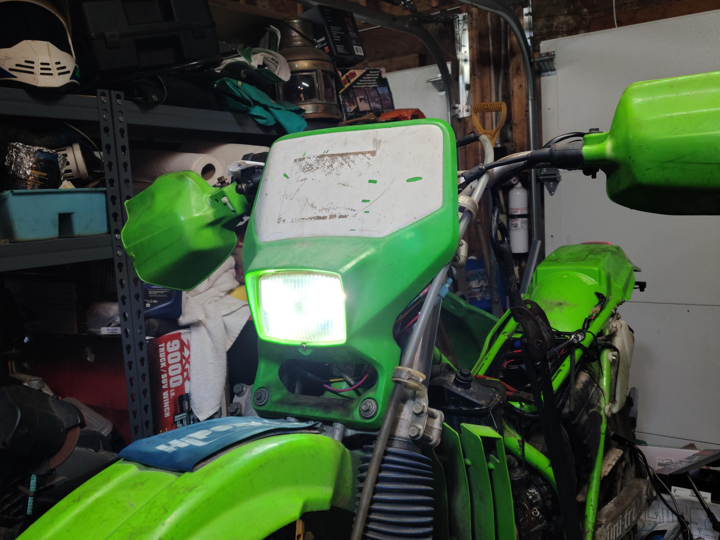

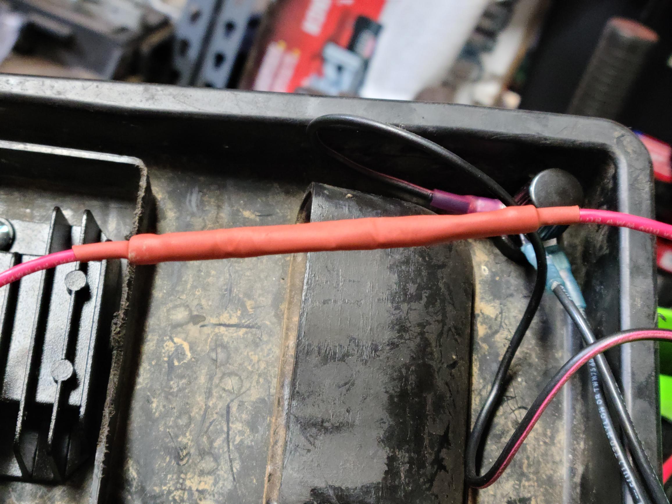

Well, It works good off the battery, lol. Before hooking the bridge rectifier int the system, I checked the output voltage. It is only putting out a little over 9 volts. So I ordered a Step Up/Down Regulator. It will take 8v - 40v and regulate it to a constant 13.8v. This should arrive tomorrow. We'll see how this works
Step Up/Down Regulator: https://www.amazon.com/gp/product/B089M ... =UTF8&th=1
Here is some picks on battery power.
- 20231228_162530.jpg (455.34 KiB) Viewed 7077 times
- 20231228_162515.jpg (329.3 KiB) Viewed 7077 times
- 20231228_162349.jpg (355.04 KiB) Viewed 7077 times

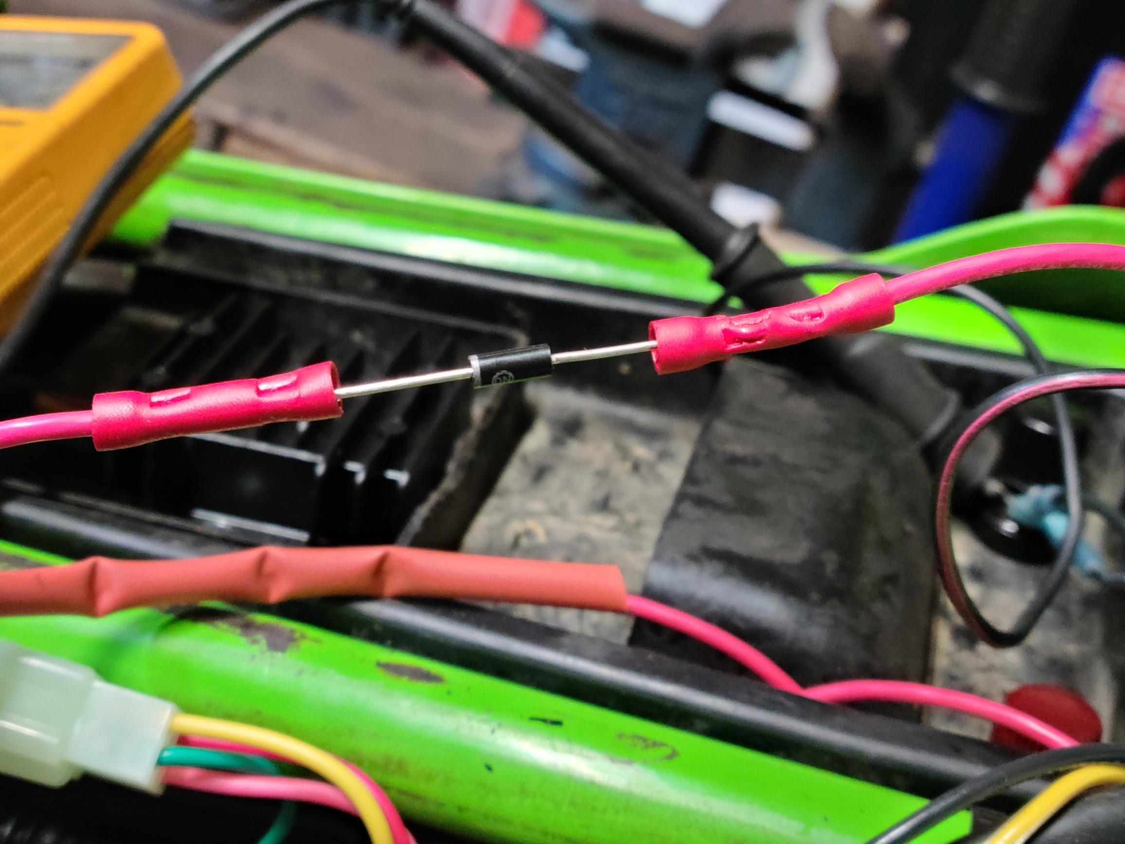

Thanks. That's the Hi/Low beam switch and that wasn't originally planned. I needed one on/on switch for my 1986 KLR 600 project. I could only order a minimum of three. It came with two black covers and one lime green. I had to use the lime green one for this project.
Today I attempted to install the regulator, it was bad. Go figure, cheap Amazon items. So I'm returning it and I already ordered a replacement. It will be here on Wednesday. I put a diode in line with the battery positive wire so it doesn't overcharge.
I put in the pressure brake switch in the front master cylinder. I'll wire that up tomorrow as well as take off the front caliper and see what shape that is in. The rear one was frozen, I'm hoping the front one just needs a good cleaning and new pads. I'll find out tomorrow.
- 20231231_205642.jpg (284.44 KiB) Viewed 7037 times
- 20231231_144348.jpg (418.02 KiB) Viewed 7037 times
