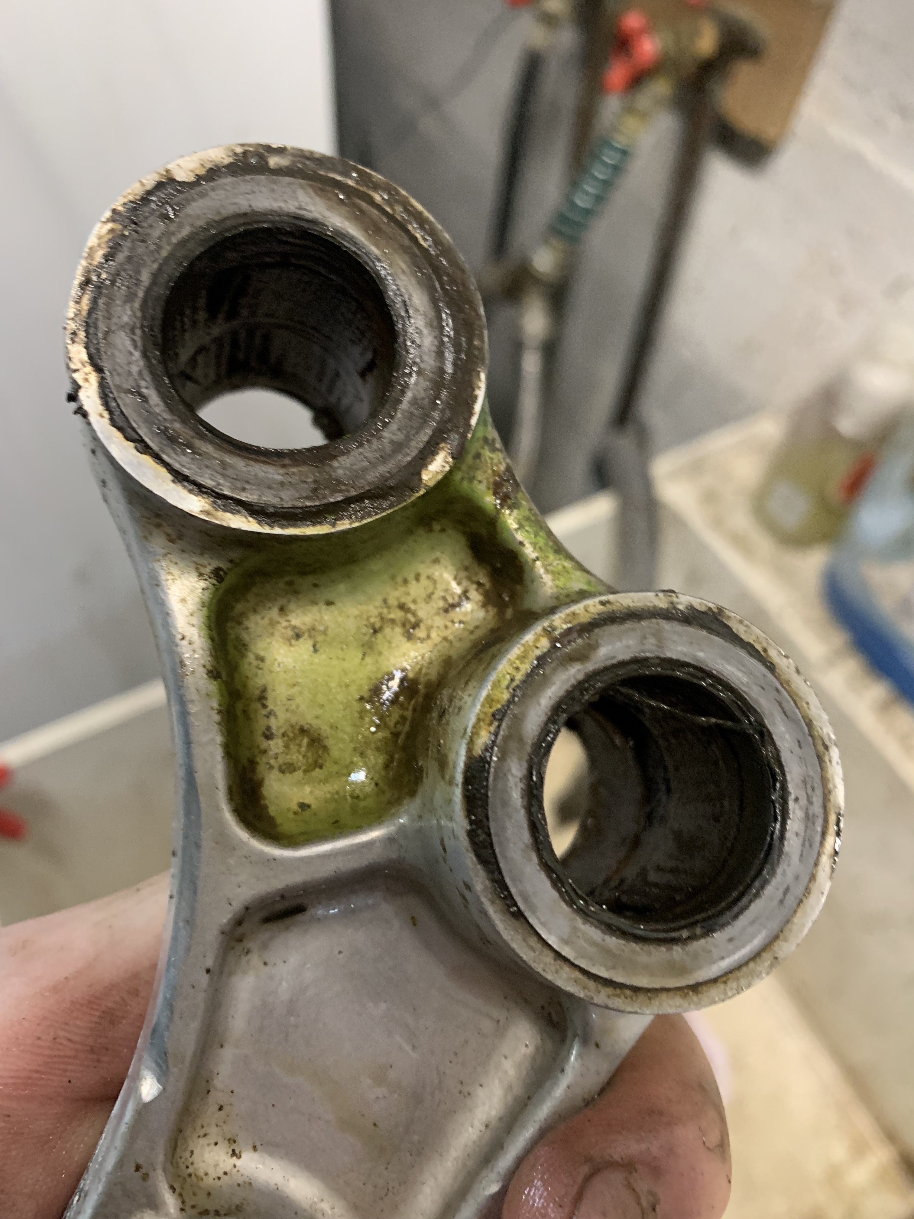

The swingarm bearings, linkage bearings and shock bushing were all completely shot so we had to installed those. Went with pivot works on all of these and was generally pleased. I think the swingarm bearings were caged with minimal rollers, but generally worth the money (i guess time will tell). The rocker connecting rod on the linkage was also completely wallowed out so we had to replace that. I also sent my shock out to Corey at Protune to have it revolved, sprung, and serviced.

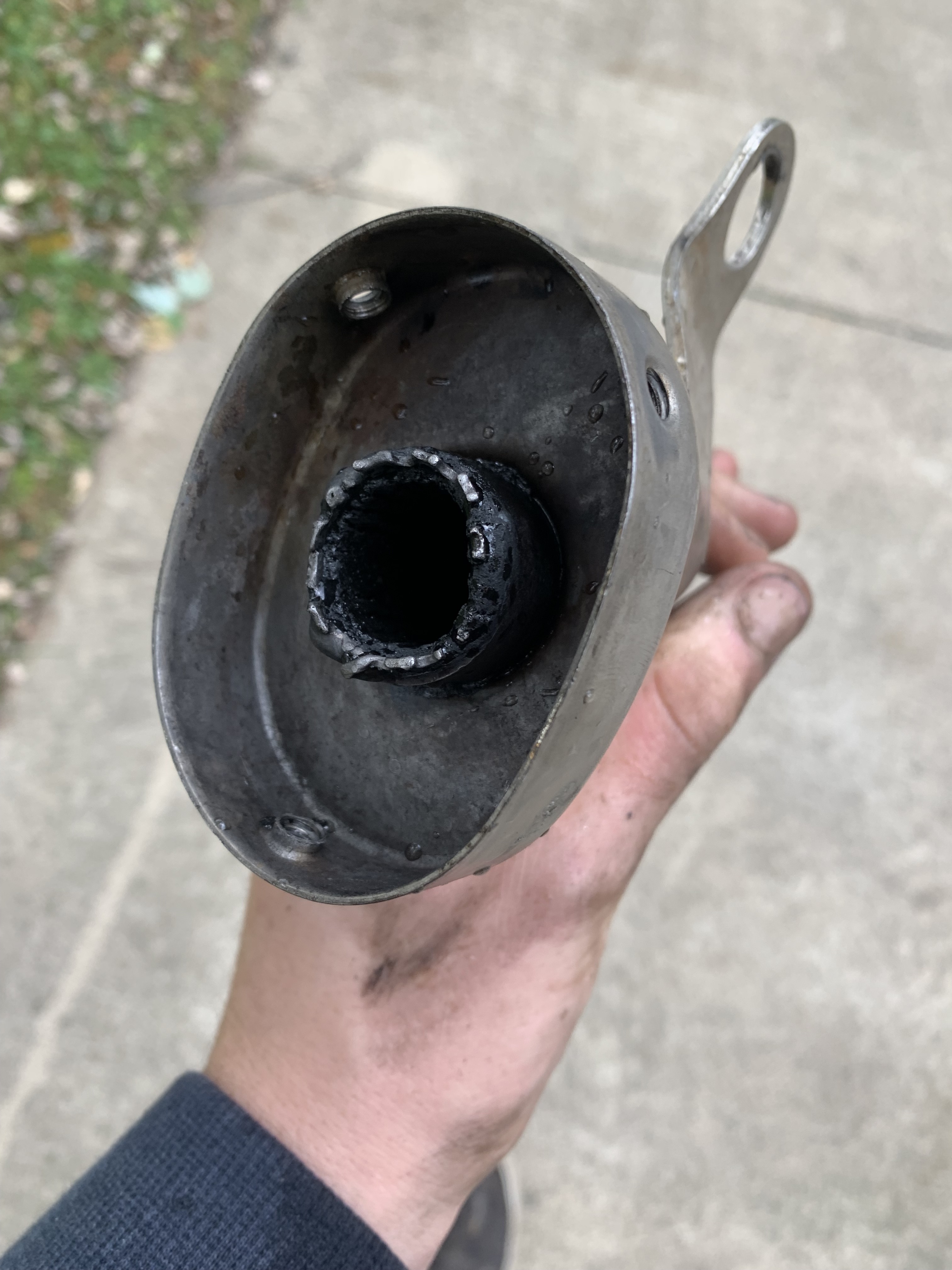

The silencer core had snapped off inside of the muffler, which we discovered when we went to repack the exhaust. To fix that we drilled out the rivets, cut down the body of the silencer a 1/2 inch and basically sandwiched the core between the end cap and the base of the silencer. The rubber connector between the header and the silencer was split and oil was coating the swingarm and engine case.

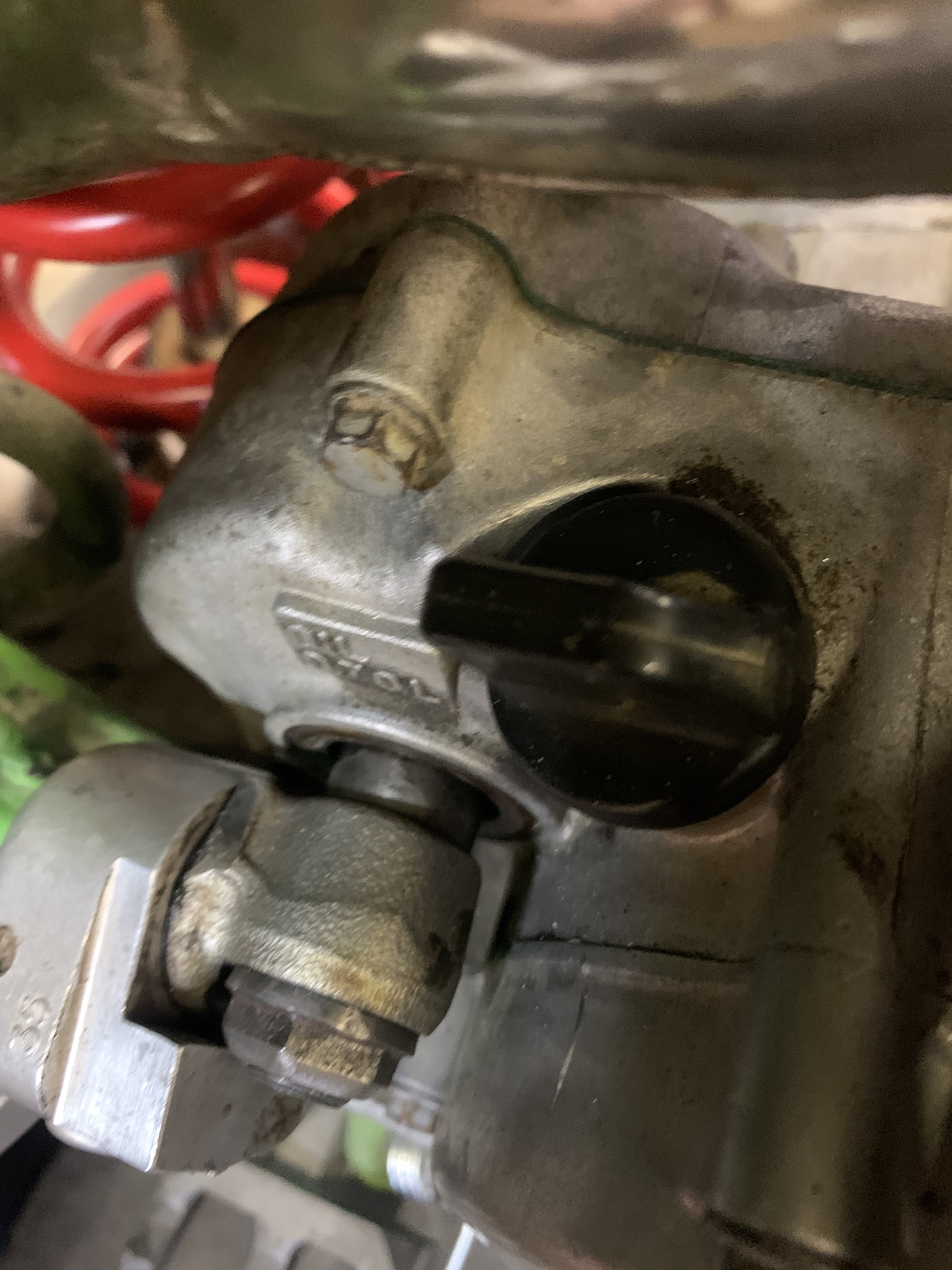

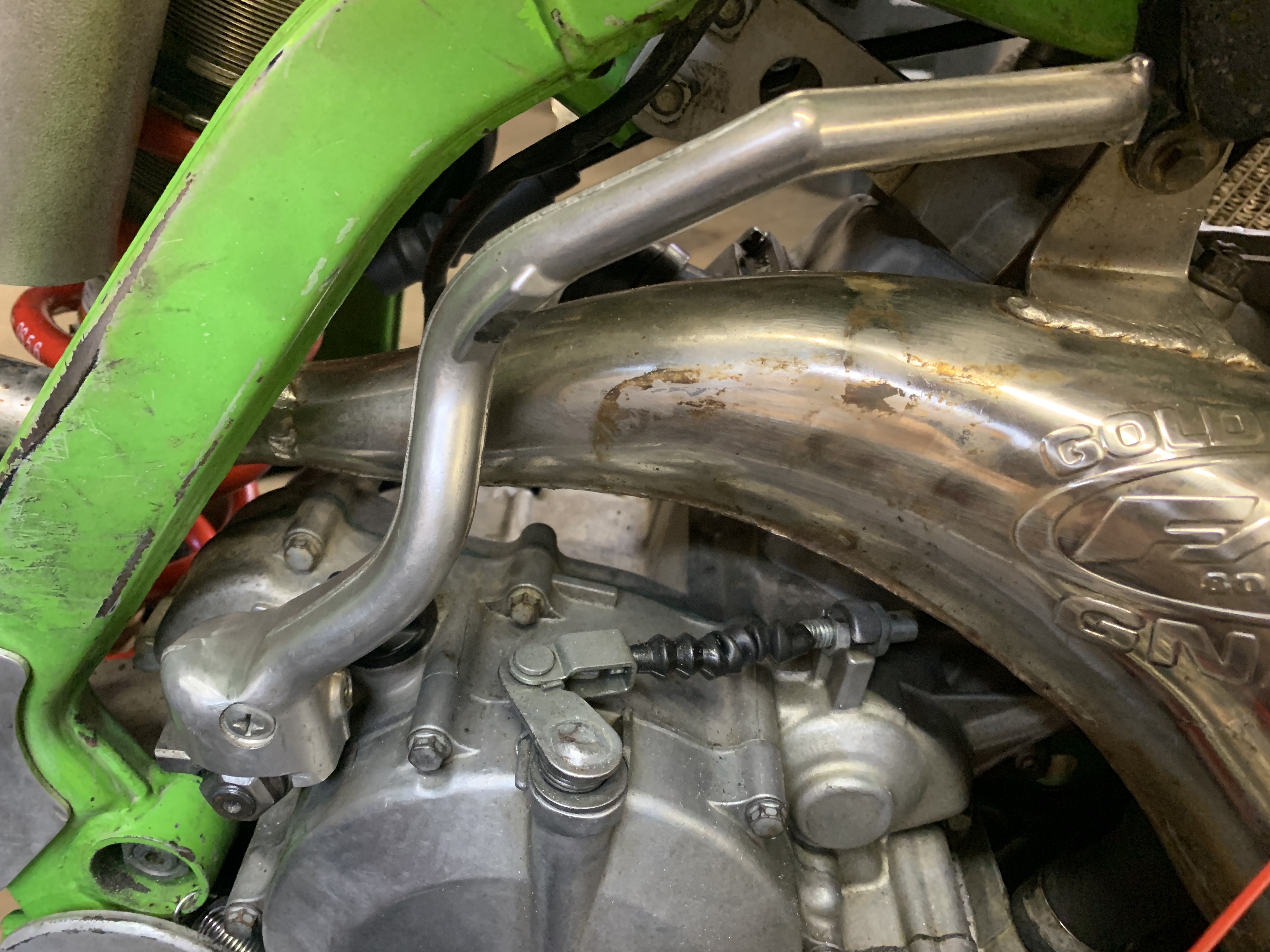

I picked up a KX250F kicker and we installed that since the OEM kicker had a ton of play in it and hard to kick the bike without your foot sliding off. Installing that was a breeze, we clearanced the kicker for the frame and the clutch cover. We didn’t need any spacers since we put a shoulder on the 17MM nut we had which allowed us to put the kicker further on the shaft. Didn’t have to cut the kickerstarter down short for gas tank clearance either which worked out well.

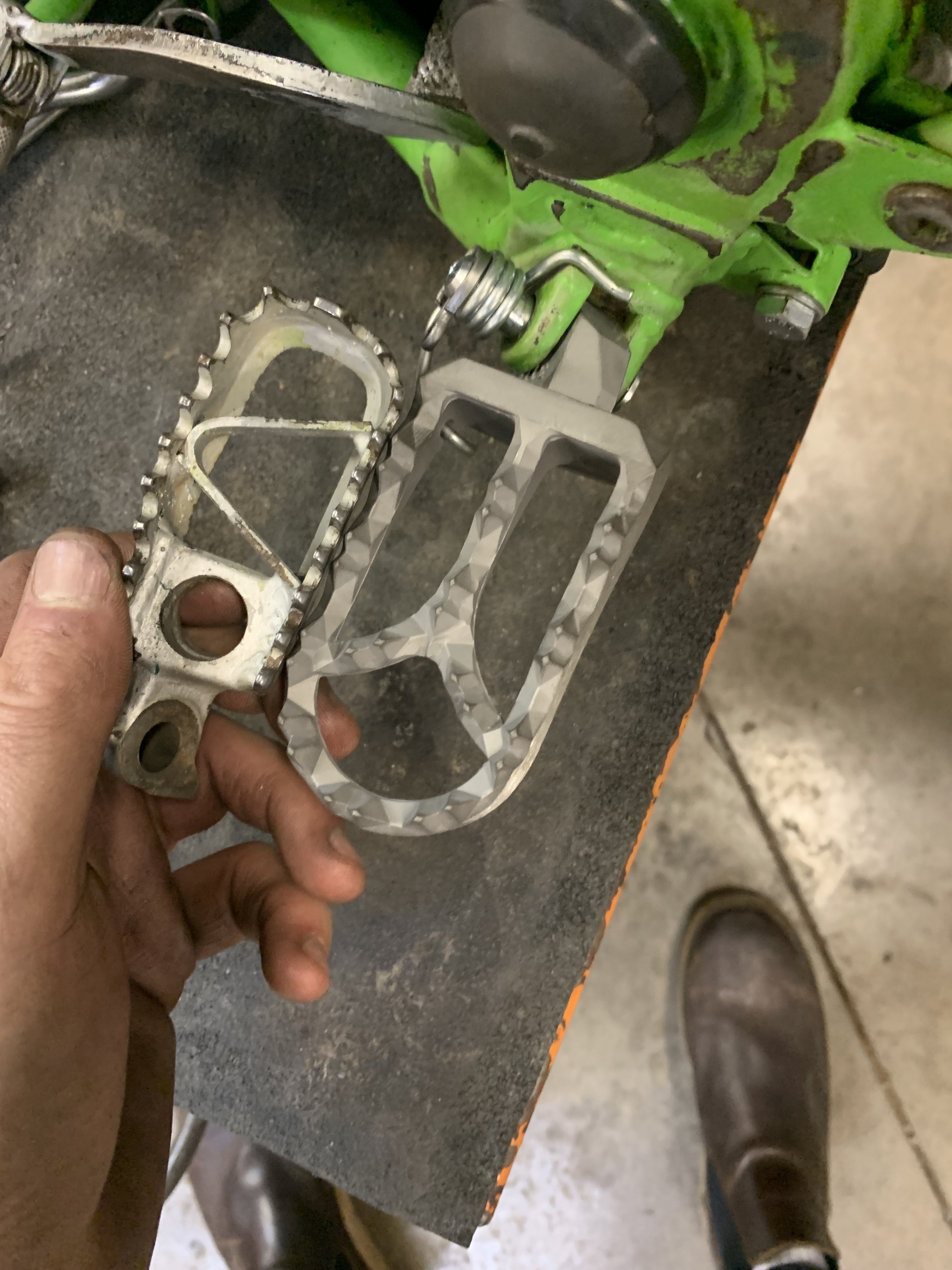

Final touch was IMS core enduro footpegs with fresh springs and pins since those were OEM from 2000. Should note that the main reason I bought this bike is because the engine was completely fresh with a fresh cylinder and top end so nothing was done to that.

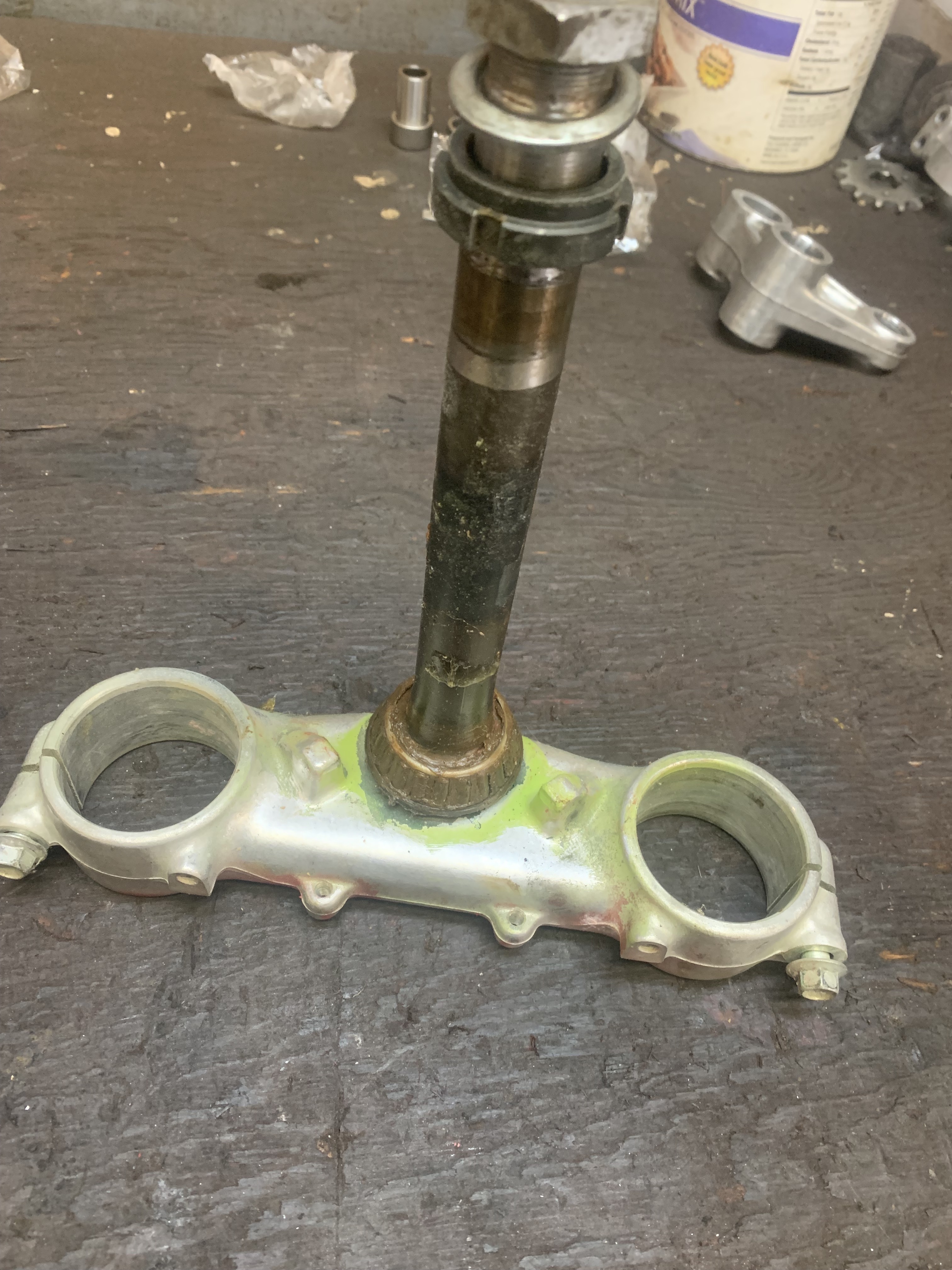

- KLX 300 triples with overspray
- IMG_7331.jpeg (2.3 MiB) Viewed 6939 times
- Exhaust core broken off
- IMG_7294.jpeg (1.46 MiB) Viewed 6939 times
- Swingarm bearings shot and oversprayed by PO
- IMG_7290.jpeg (1.93 MiB) Viewed 6939 times

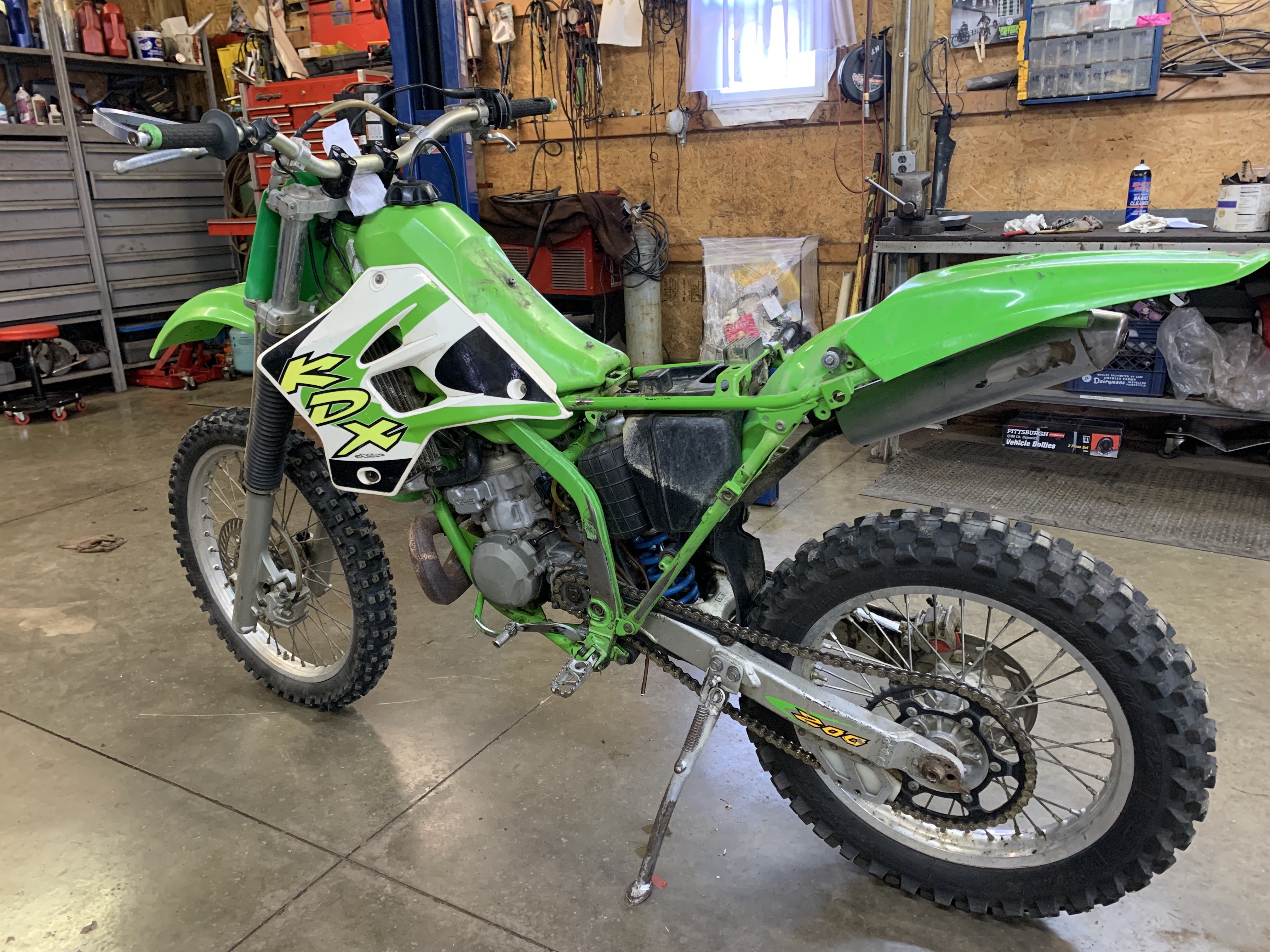

- Before - yes it came with a seat
- IMG_7267.jpeg (2.56 MiB) Viewed 6939 times

- IMS Footpegs - way better for my big feet
- IMG_7376.jpeg (2.05 MiB) Viewed 6938 times

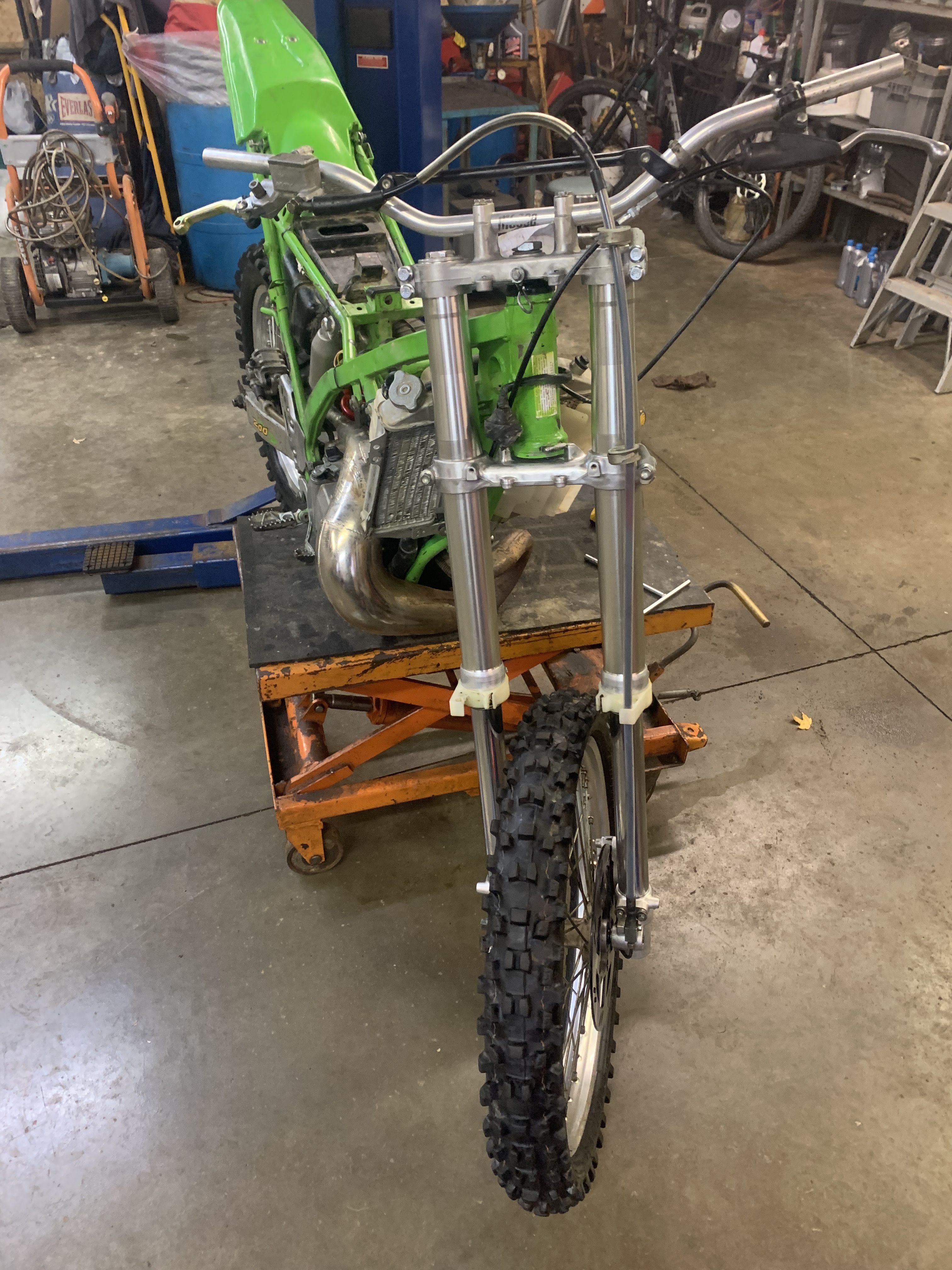

- Installed front end - built up some weld on the steering stop.
- IMG_7372.jpeg (2.82 MiB) Viewed 6938 times

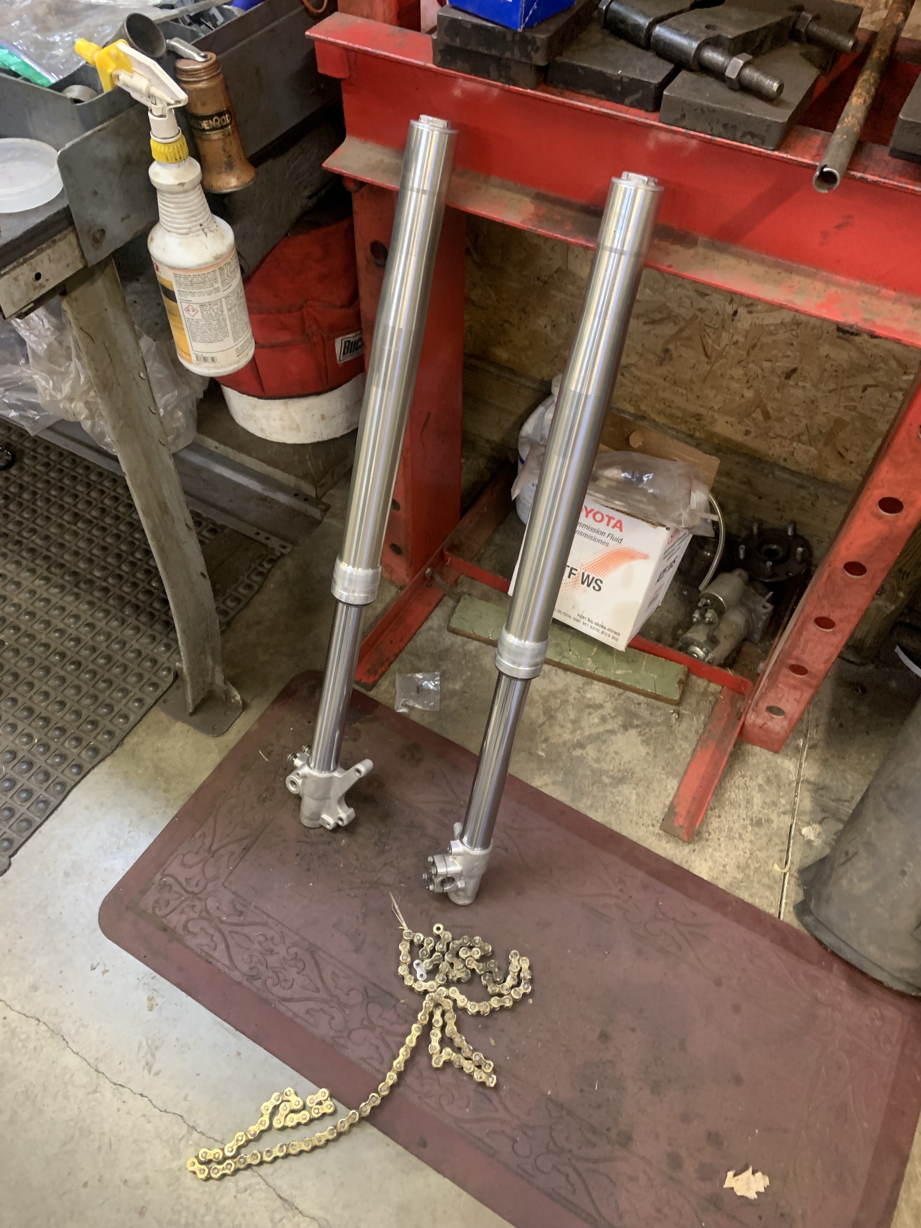

- Fresh rebuild on front forks
- IMG_7356.jpeg (2.11 MiB) Viewed 6938 times

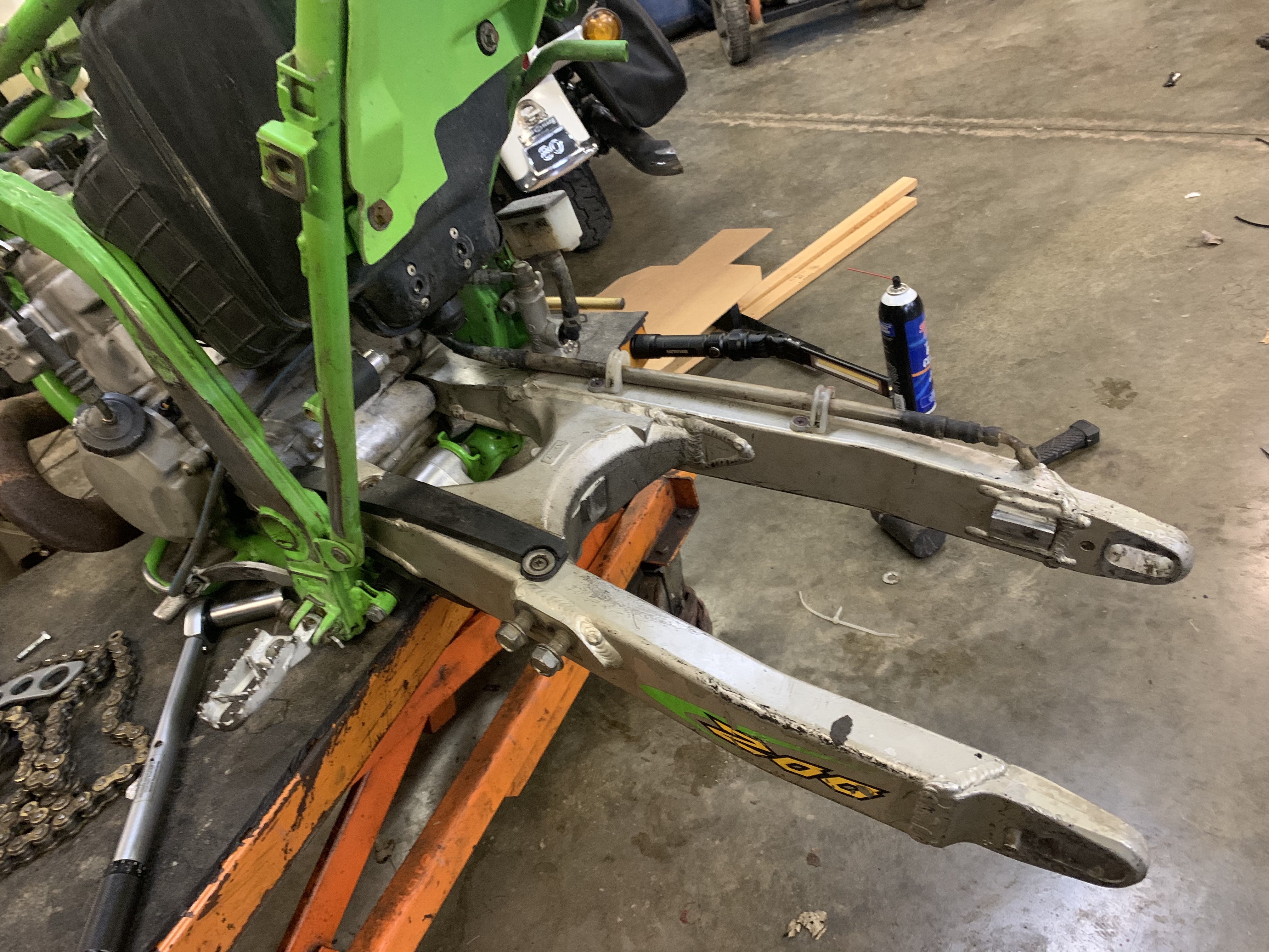

- Swingarm rebuilt with fresh slider as well
- IMG_7343.jpeg (2.88 MiB) Viewed 6938 times

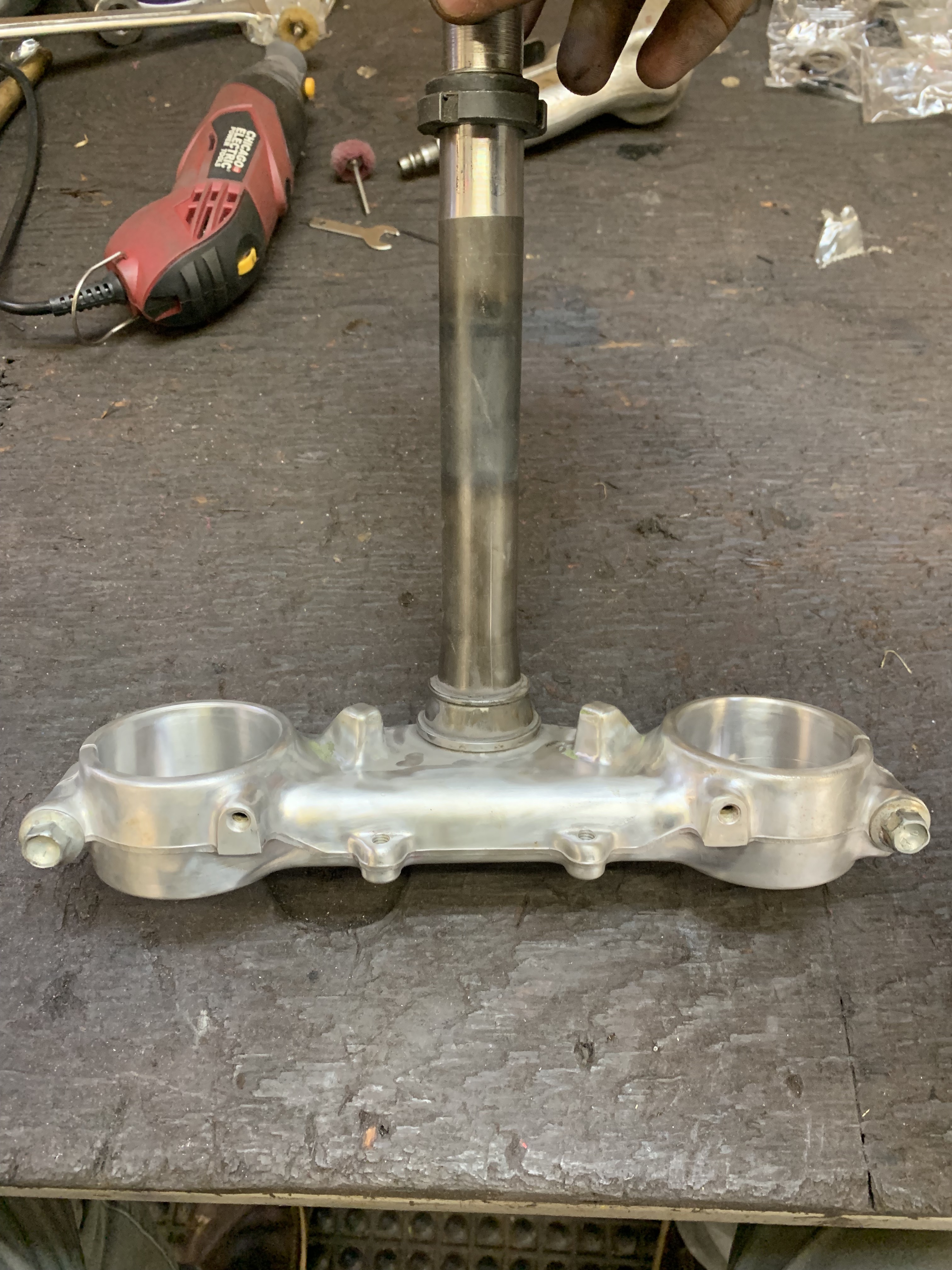

- Triples after buffing
- IMG_7332.jpeg (2.19 MiB) Viewed 6938 times

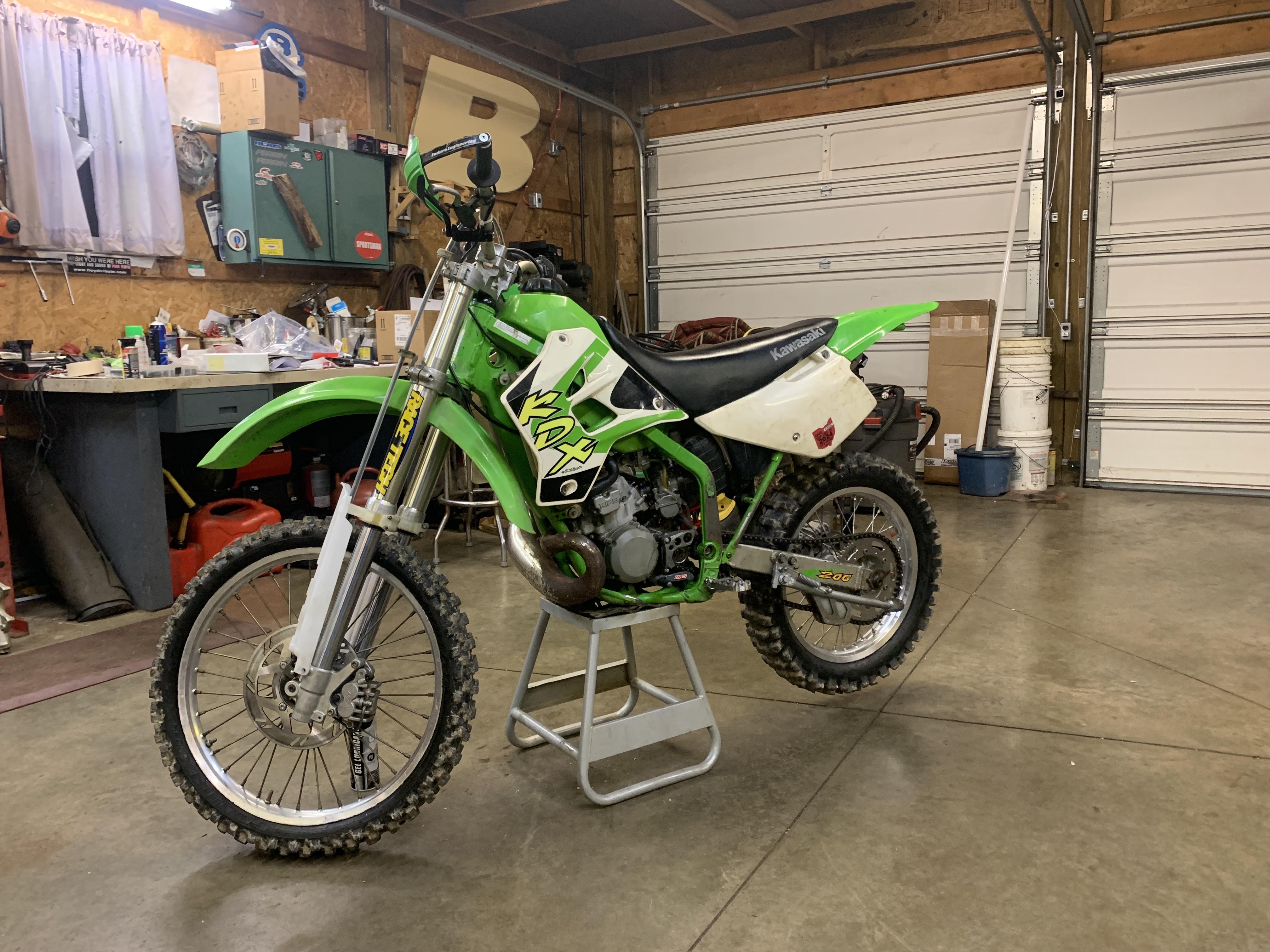

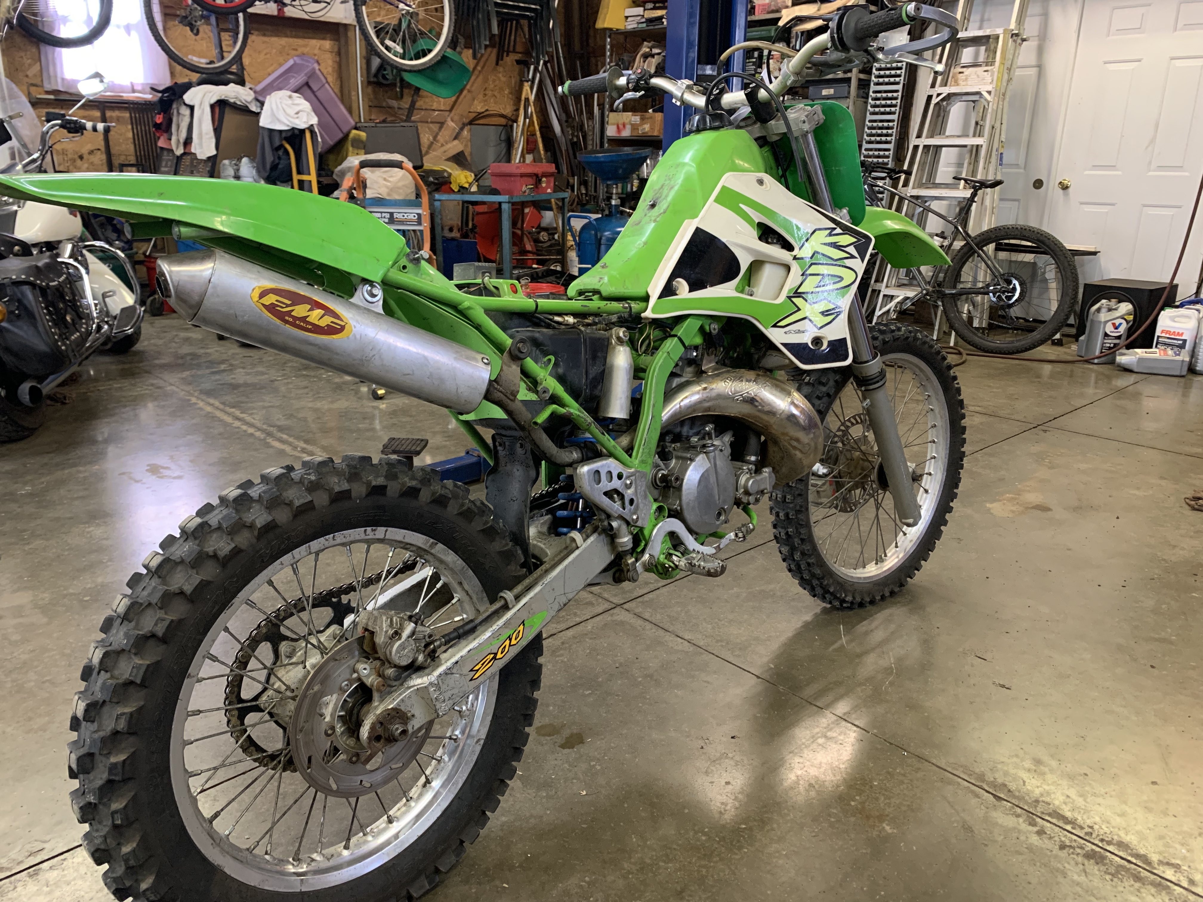

- Final product sans the front number plate
- IMG_7388.jpeg (3.25 MiB) Viewed 6938 times

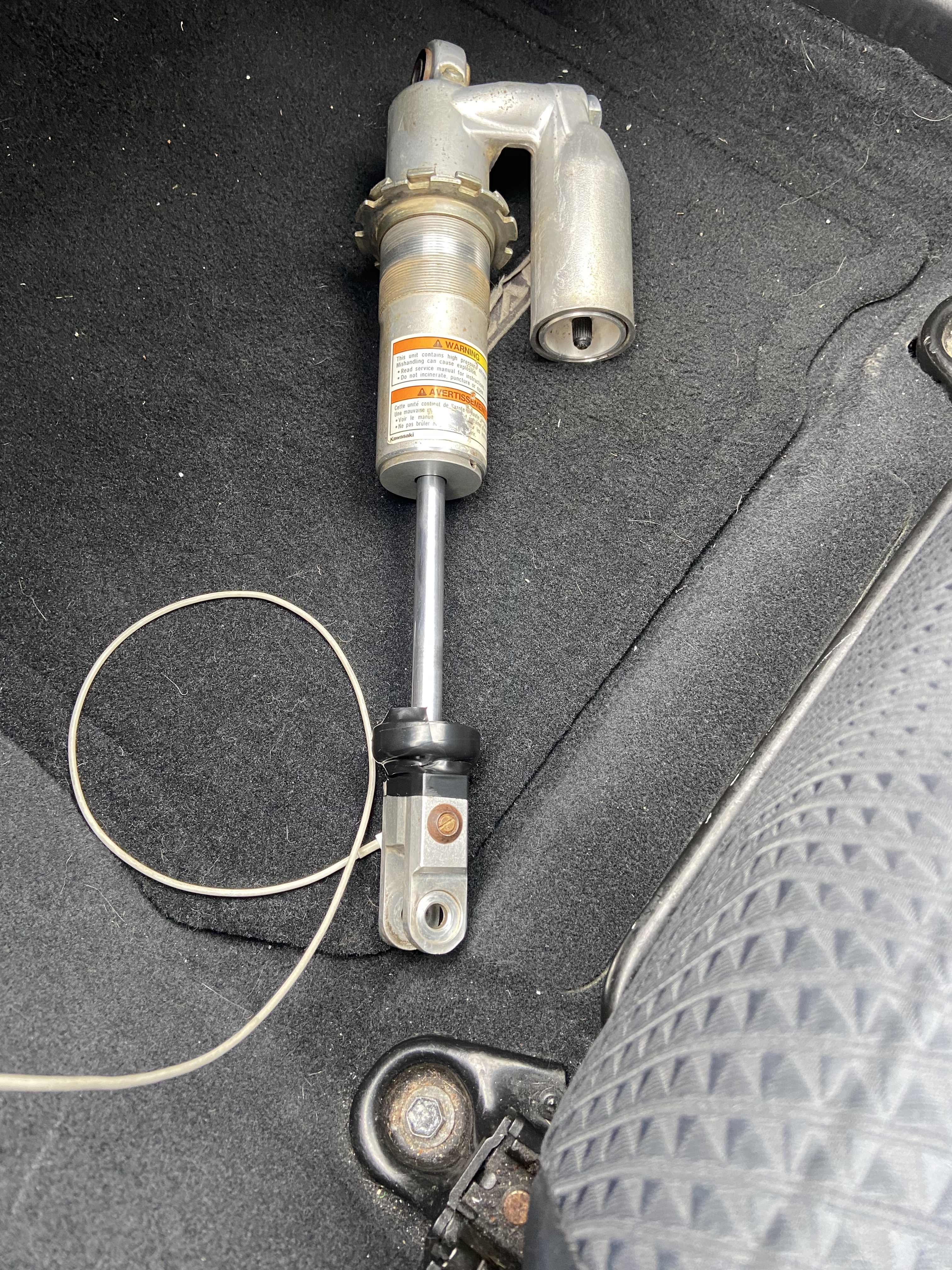

- Shock shaft was surprisingly in good shape
- IMG_8701.jpeg (3.95 MiB) Viewed 6938 times
- Kicker installed
- IMG_7383.jpeg (1.9 MiB) Viewed 6938 times
- Modified nut
- IMG_7382.jpeg (2.71 MiB) Viewed 6938 times
