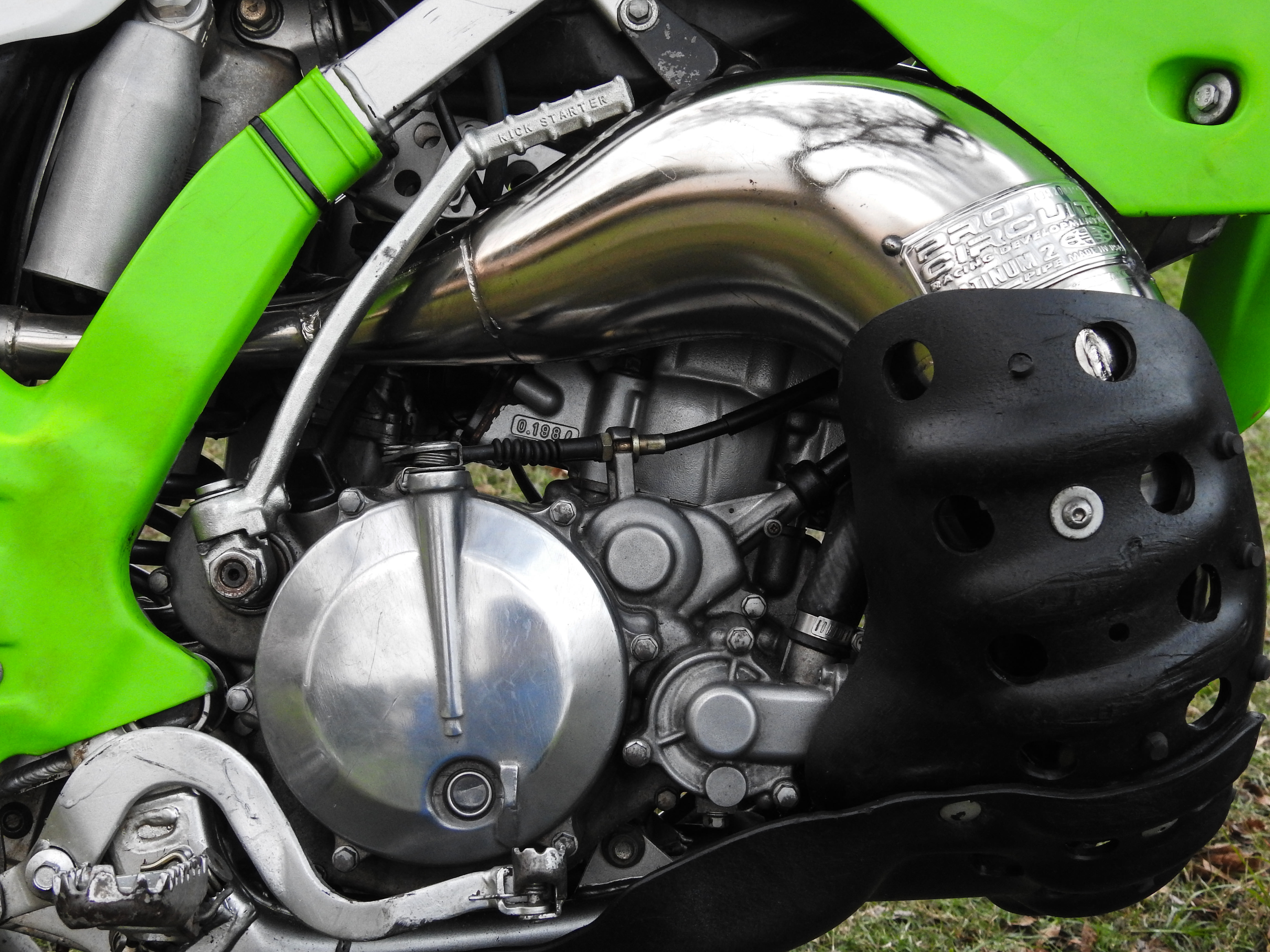

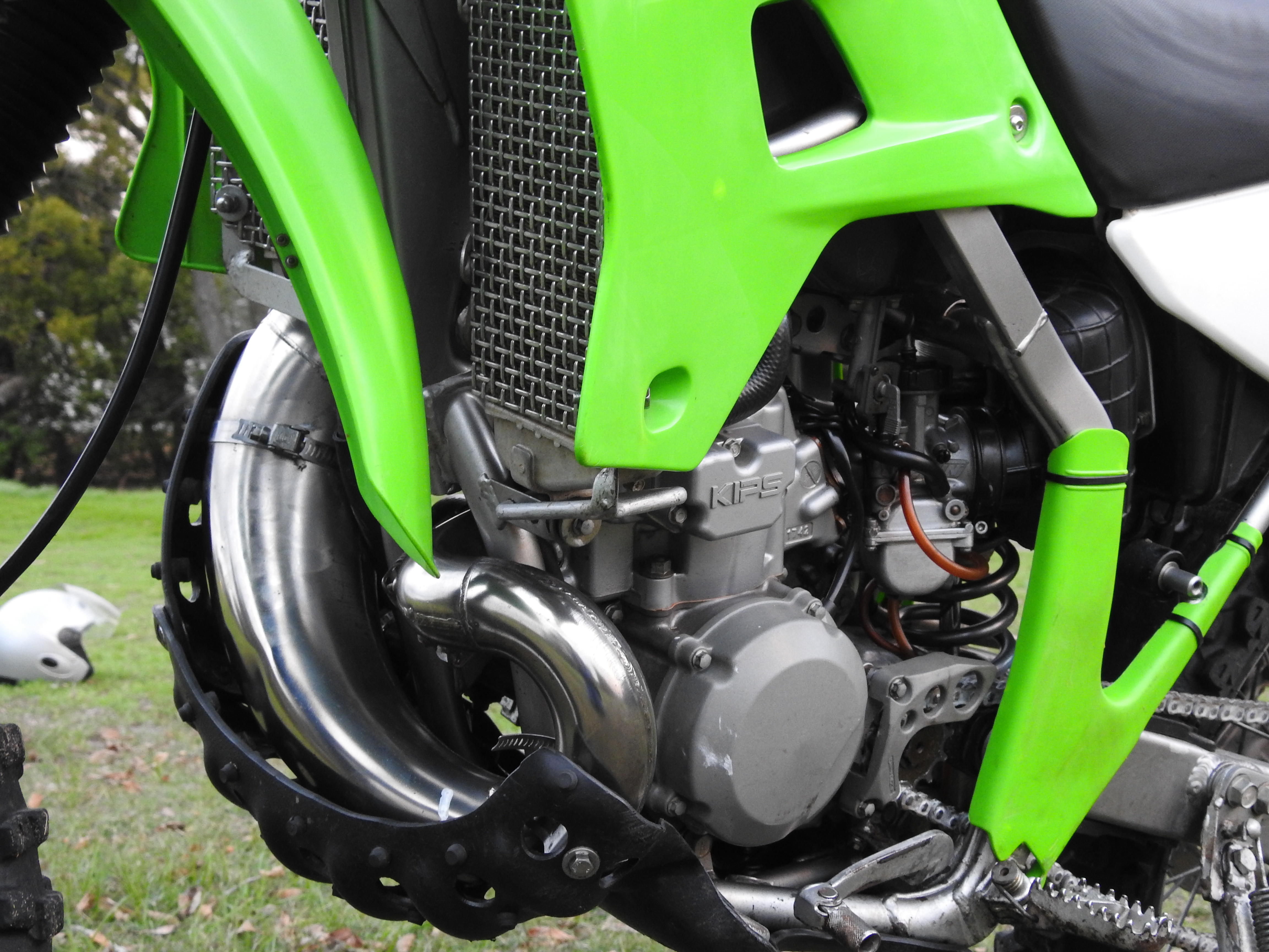

Also other updates, the Gnarly Woods pipe makes the Hyde Racing skid plate a lot easier to install around the front lower exhaust mount!
Additionally, Hyde Racing has the pipe guard skid plate combos BACK IN STOCK! 18 showing in stock when I ordered mine. They told me they probably weren't going to make any more of those a year ago when I ordered my last standard skid plate from them...
They say they are made specifically for the Gnarly Desert pipe. Well I was ecstatic to find a picture of this Hyde Racing pipe guard skid plate combo and zoom in to see it was on a Pro Circuit Platinum 2 pipe!
It doesn't make contact with the pipe in the middle at the front section, but it's pretty close, and the large section on the side looks to fit like a glove.... I'm pretty sure I could probably heat it up with a heat gun and another hose clamp and get it to fit the Platinum 2 as good as the Gnarly Desert.
