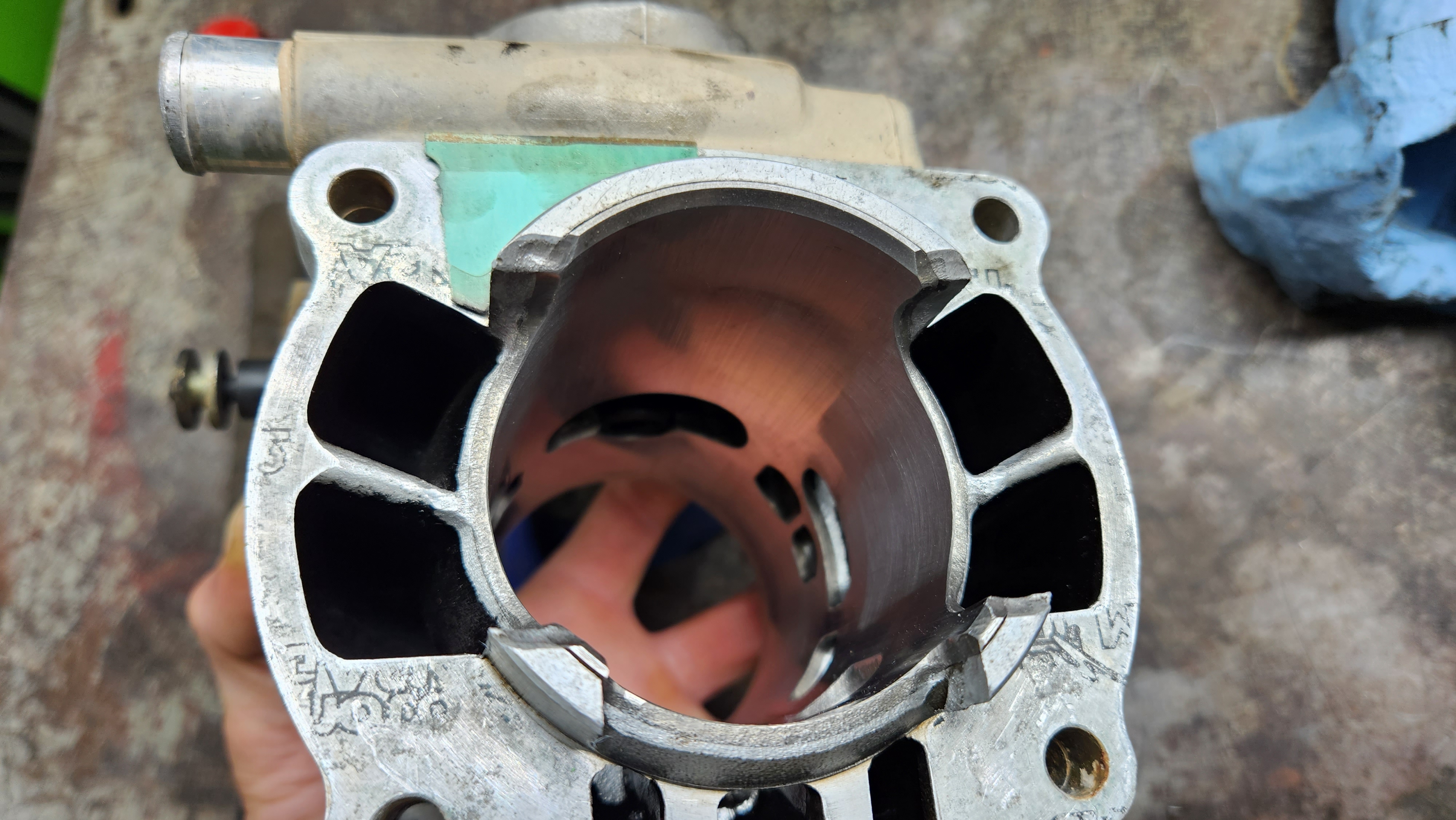

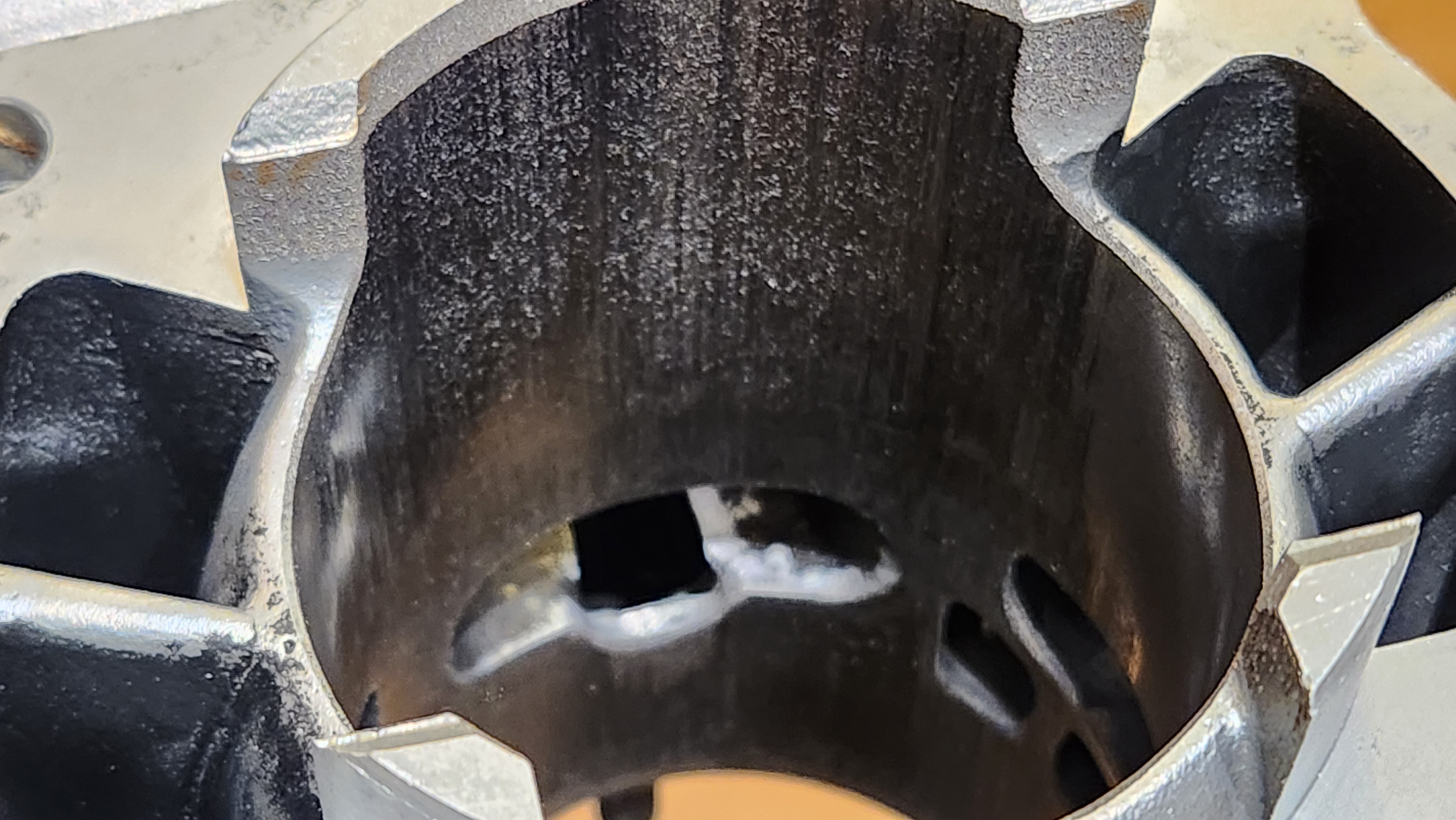

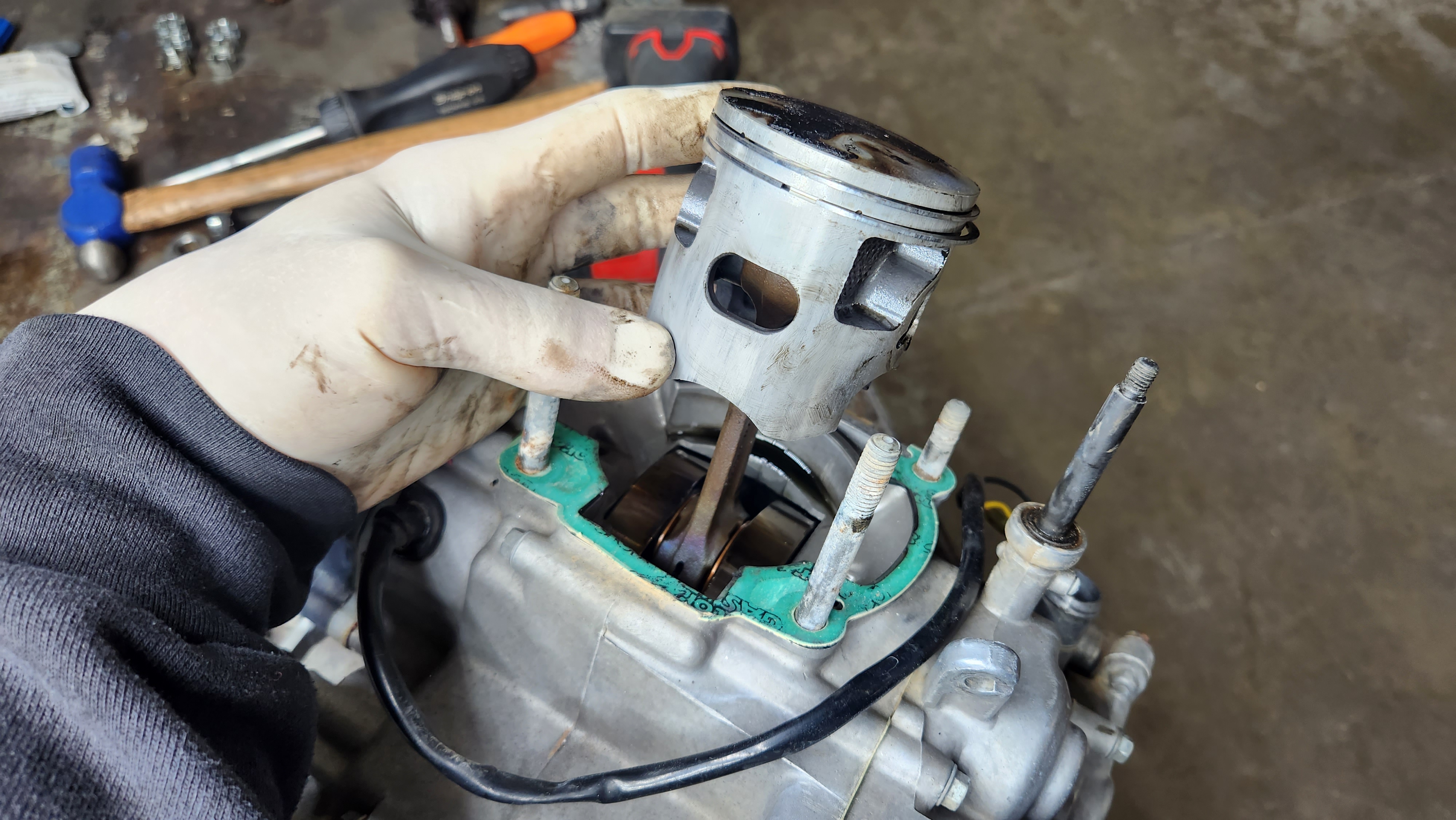

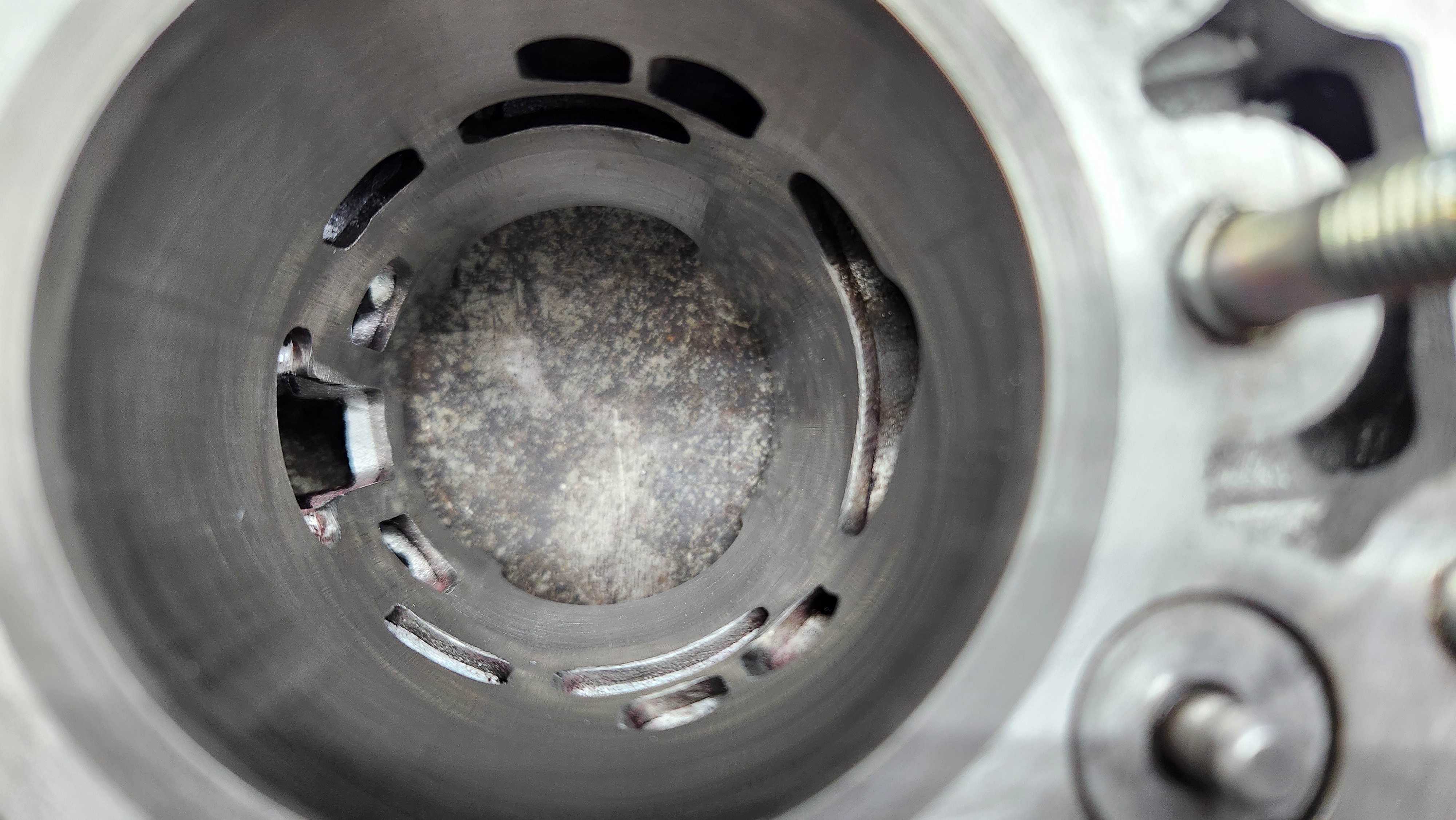

I'm doing crank seals (stator side leaks) and wanted your guys' feedback on how it looks. 140psi, cold engine and 7,000' elevation seems pretty good. I've got 45 hours on it since I bought it and supposedly the engine was rebuilt shortly before then. So I was thinking about leaving the piston as is, is that dumb to try and save a few hundred bucks?
I've yet to check out the power valve components.
The bike is trail ridden, a lot of low speeds, not raced.
87 octane ethanol free, lucas semi synthetic and Maxima 927 used.

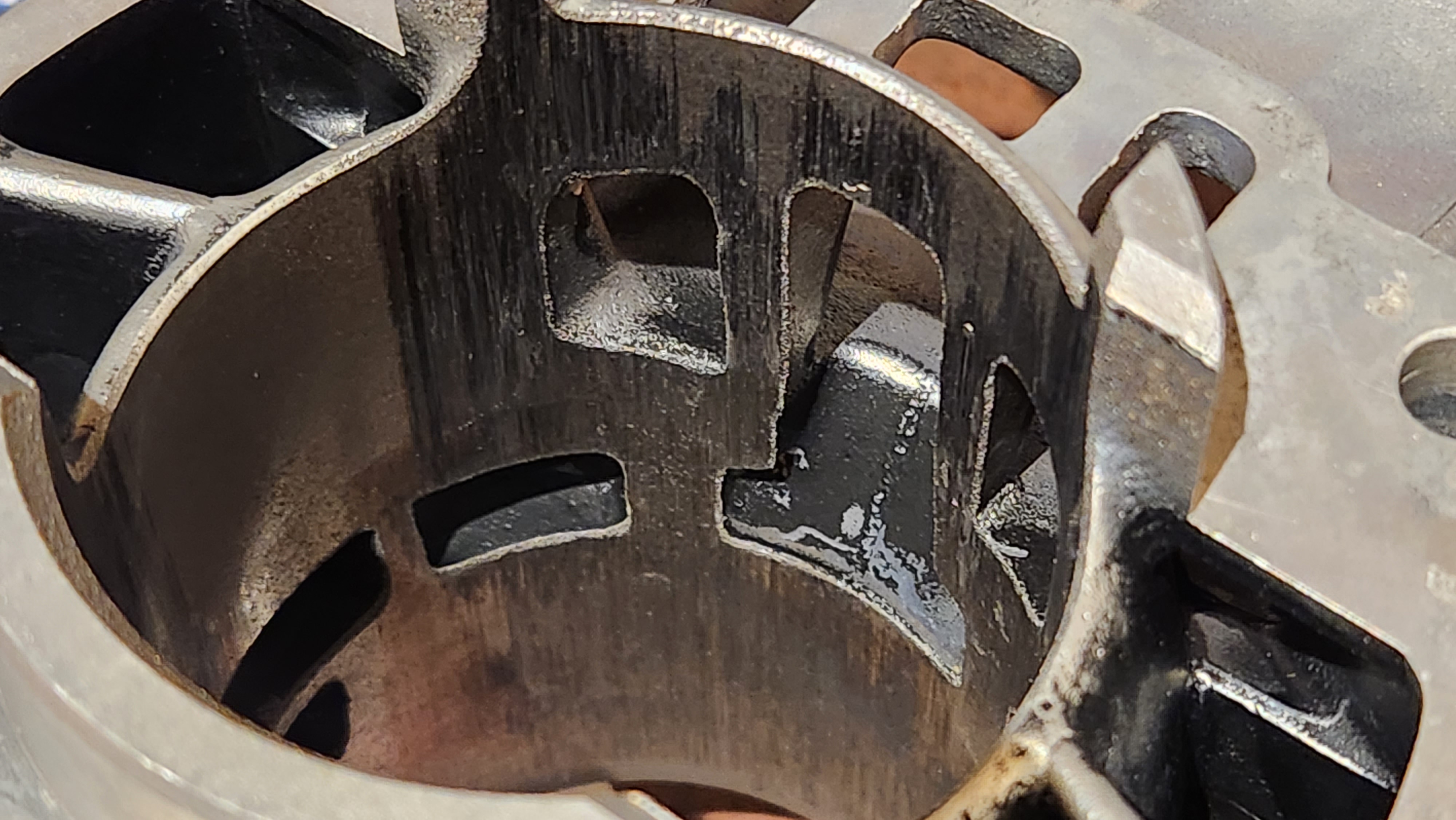

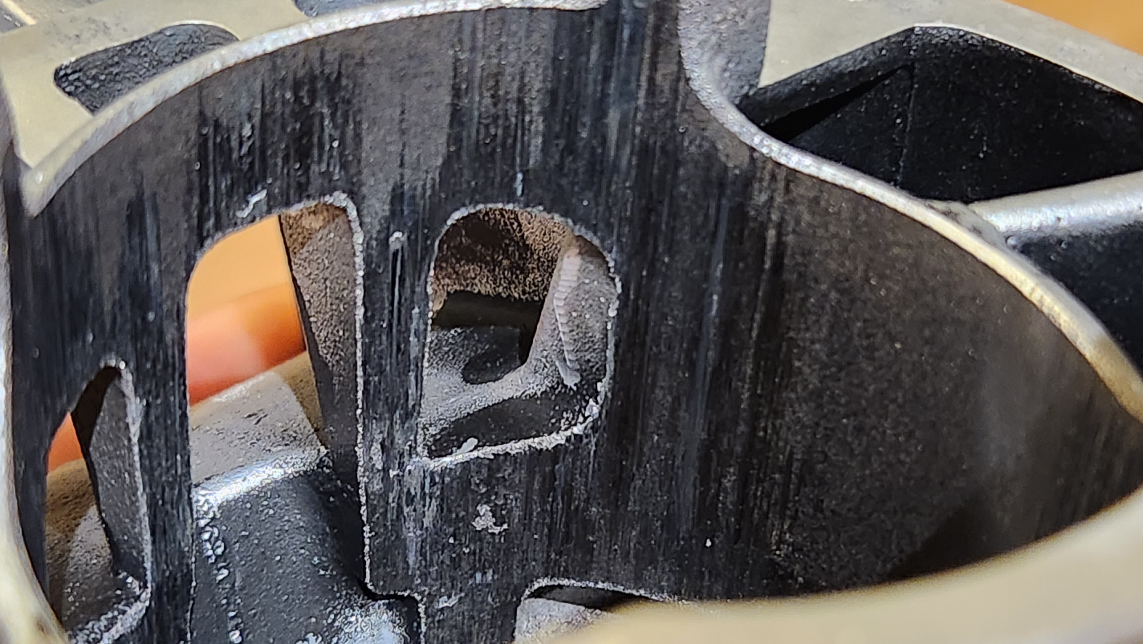

I would replace the piston since you're in there but that's just me. Those vertical lines on the cylinder and piston are from dirt getting in there. Make sure you're servicing your air filter regularly and getting it seated correctly. It's also a good idea to wipe out the air box with a tacky rag, or even a paper towel with some oil on it, to keep dust from falling in when R&R'ing the filter.

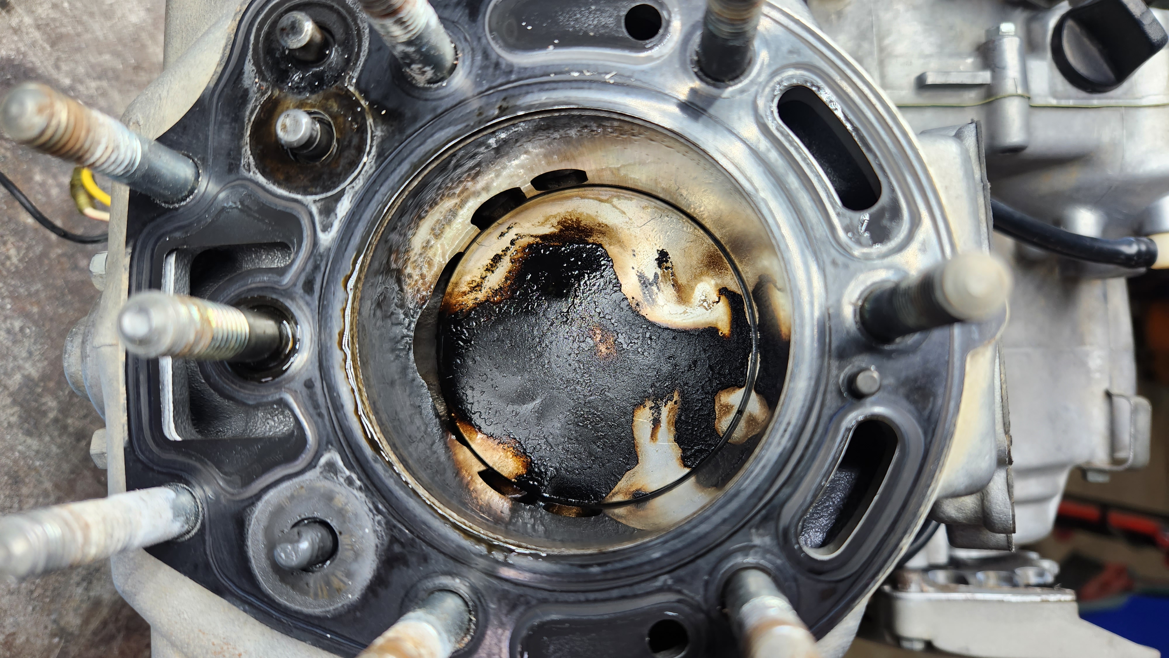

Oh, btw, you are jetted way too rich from what I see. You can tell by the piston wash on the crown and on the head chamber. It should be more uniform across the surfaces. Clean areas with thick carbon areas tells me you're too rich.

With it being that far taken apart, I would put a new piston in it if it were mine.

Yep, Pro-x piston inbound.
It also looks like i've got a steel sleeve in the cylinder, good to give it a hone? It measures out at 65.85mm

i know americans seem to replace things more often as they have access to cheaper parts but i am a little more old school. i would do what has been done since engines began and just inspect the piston and measure with a micrometer to determine wear and check the piston to cylinder clearance with feeler gauges, you are running a cast pro x piston which may last more than 1000 hours with light trail riding so 45 hours is near nothing,especially since its run in to the cylinder as are the rings.

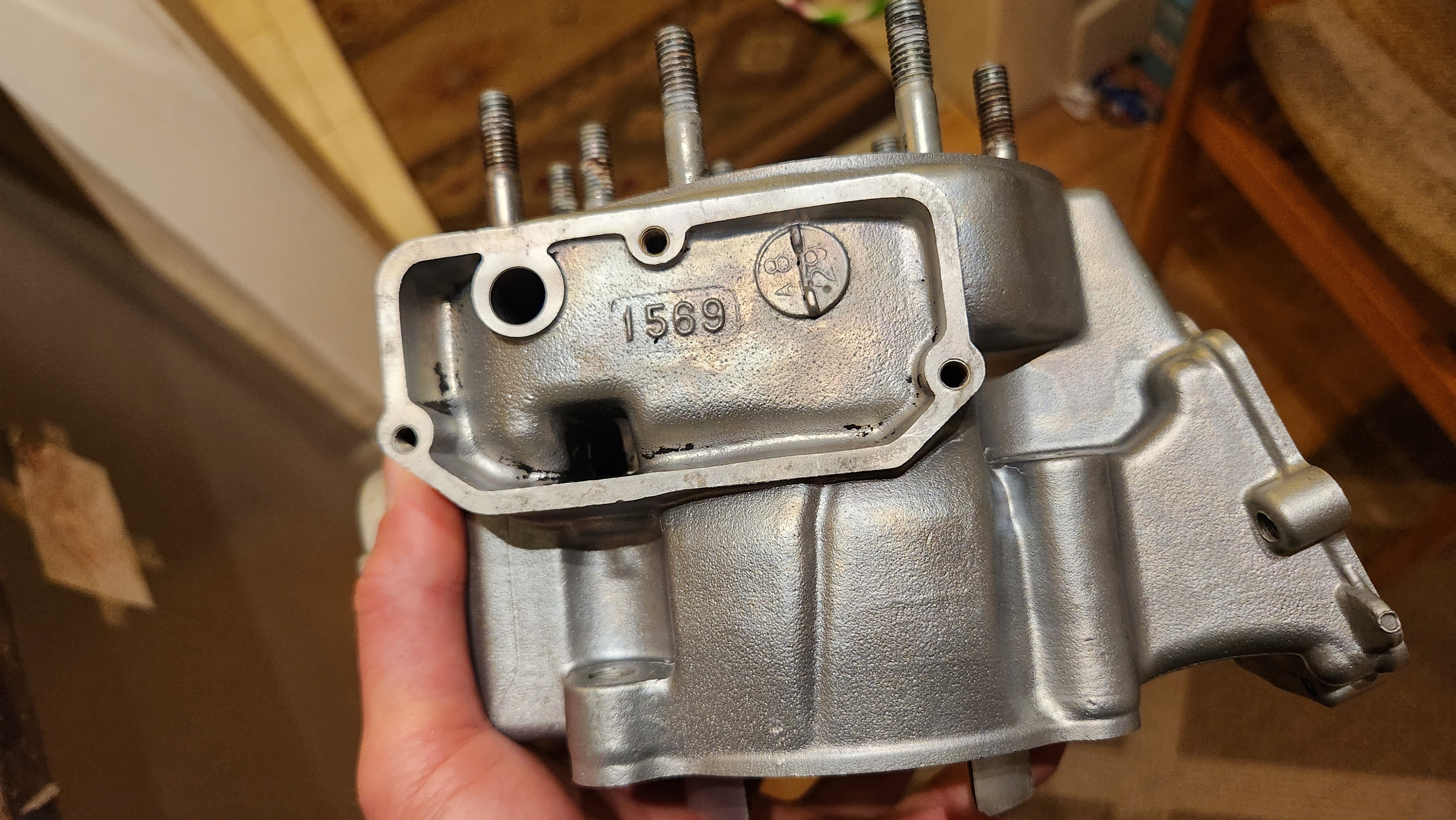

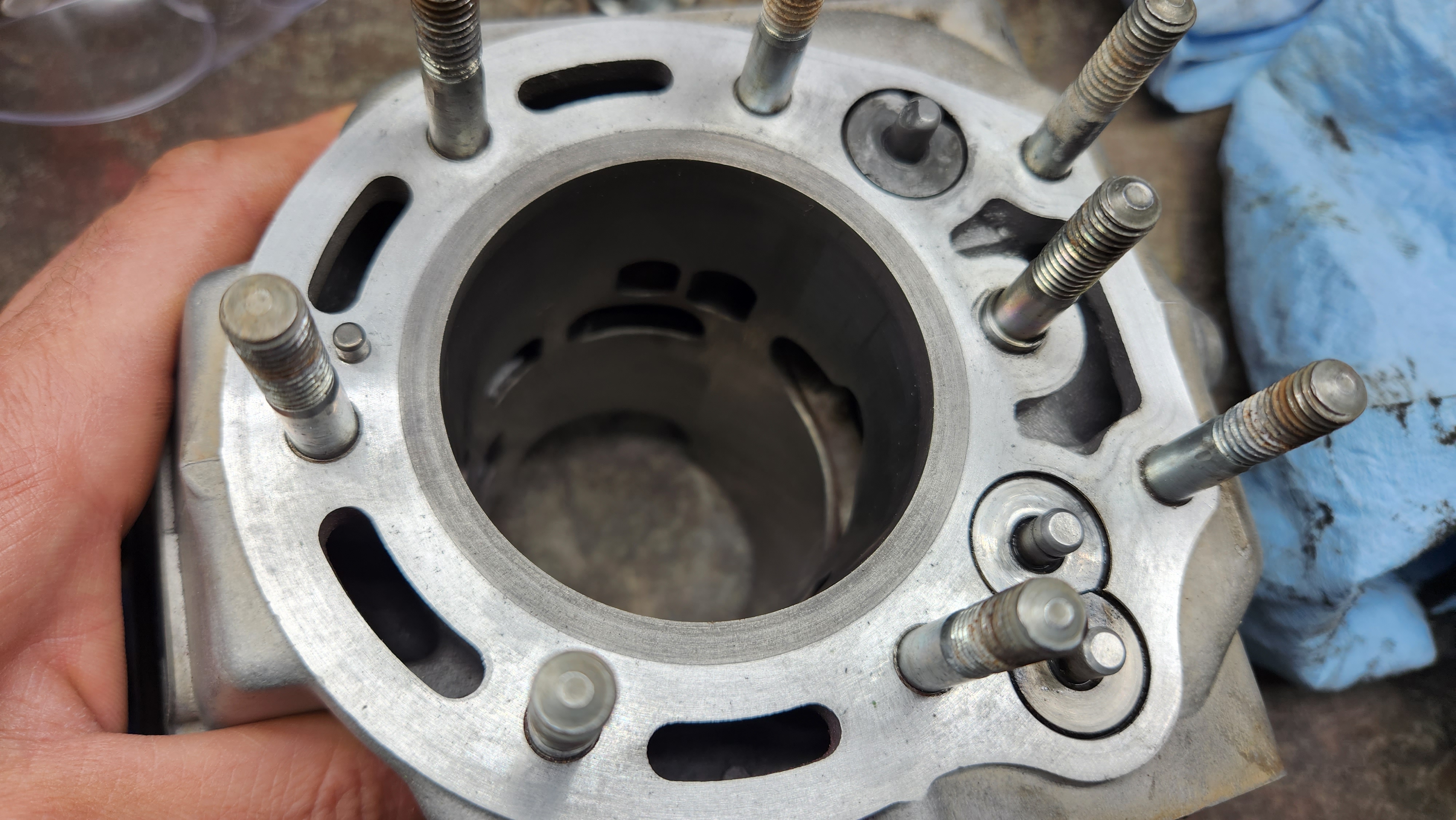

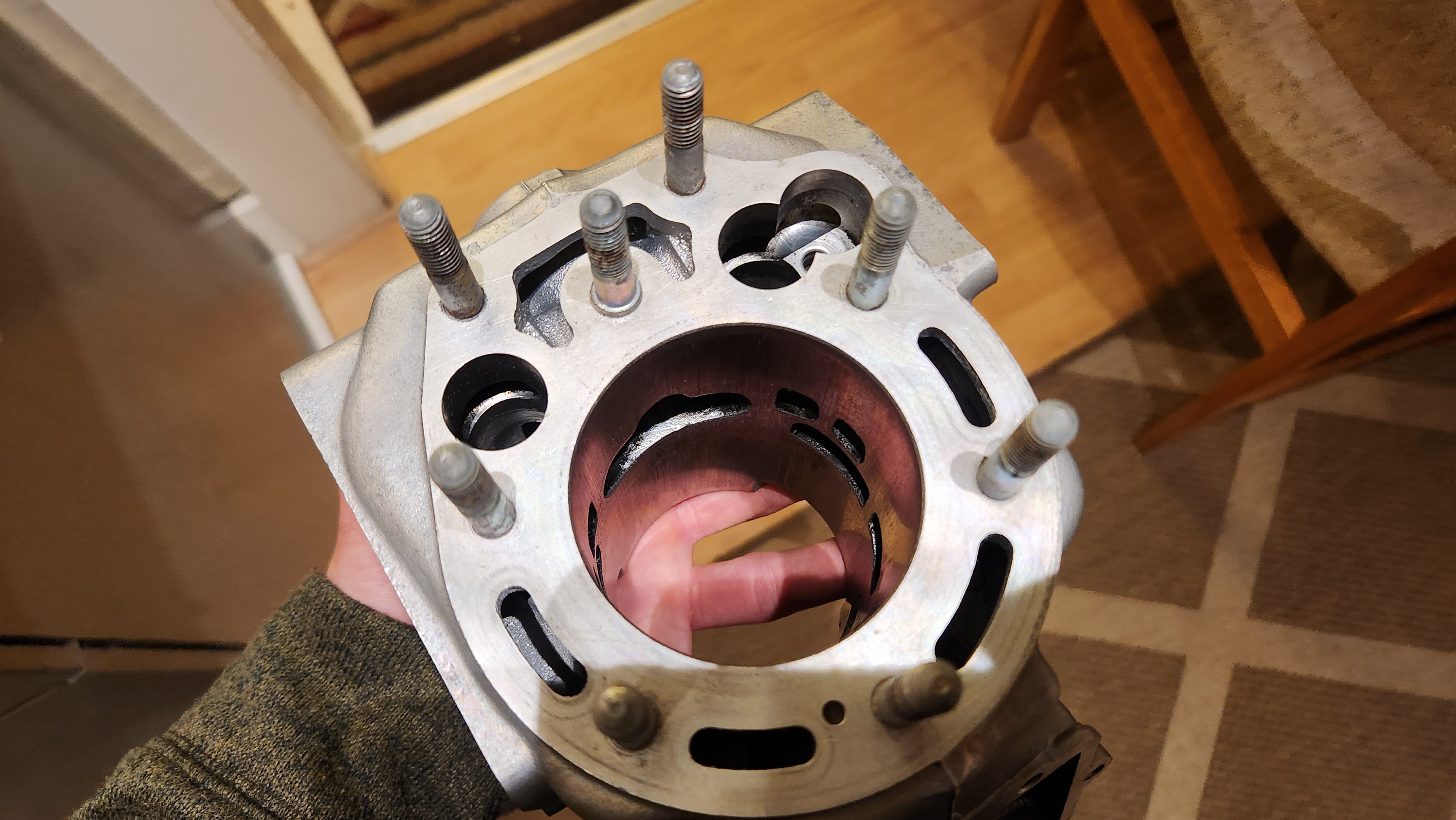

I've also got another cylinder that came with the bike, it's not sleeved but needs replating bad. I'd prefer the non lined cylinder but it's like $400 these days for a replate...

If your piston to cylinder clearances and ring gaps are within tolerance I would reuse the piston IIWM, especially if you're just trail riding. As kdxazz said, the cast unit will last a while under moderate usage as long as you do your regular maintenance, although I don't know where he gets 1000 hours since Pro-X recommends 12 hours, but certainly you could get 100-200 hours out of it as long as the rings last. They also don't recommend running their cast pistons in a chrome plated cylinder, so hopefully your sleeve is not. If you were to replate your other cylinder you're still looking at a new pitson/rings...unfortunately our hobby is not a cheap one anymore
Also as SS109 pointed out, you could stand to run through the jetting process once it's all back together. As for your crank...ouch. You could probably get it to a competent machinist and have the missing piece welded on and then turned down and threaded. They would also need to notch it for the Woodruff key. Not surprised it is still on the broken shaft as it is a tapered interference fit, but am surprised you haven't spun the flywheel as the keyway appears to have departed with the missing part of the crank. No way you put it back together and ride it that way safely as there is no way to torque it down. Best bet is to find a crank either on Ebay or elsewhere, cheaper than buying an OEM one (though you can still get crankcase halves and have a competent crank reman build it back up).

Thanks for the input. After doing some reading I feel like I should really get my other cylinder replated, seems as though they last longer and have much better cooling, which is something i've often needed on slow, rocky hill climbs. I've already ordered a ProX piston kit.bufftester wrote: 10:14 pm Nov 13 2023 If your piston to cylinder clearances and ring gaps are within tolerance I would reuse the piston IIWM, especially if you're just trail riding. As kdxazz said, the cast unit will last a while under moderate usage as long as you do your regular maintenance, although I don't know where he gets 1000 hours since Pro-X recommends 12 hours, but certainly you could get 100-200 hours out of it as long as the rings last. They also don't recommend running their cast pistons in a chrome plated cylinder, so hopefully your sleeve is not. If you were to replate your other cylinder you're still looking at a new pitson/rings...unfortunately our hobby is not a cheap one anymoreAlso as SS109 pointed out, you could stand to run through the jetting process once it's all back together. As for your crank...ouch. You could probably get it to a competent machinist and have the missing piece welded on and then turned down and threaded. They would also need to notch it for the Woodruff key. Not surprised it is still on the broken shaft as it is a tapered interference fit, but am surprised you haven't spun the flywheel as the keyway appears to have departed with the missing part of the crank. No way you put it back together and ride it that way safely as there is no way to torque it down. Best bet is to find a crank either on Ebay or elsewhere, cheaper than buying an OEM one (though you can still get crankcase halves and have a competent crank reman build it back up).

So I went out to the garage to inspect that other cylinder I have, it actually doesn't feel bad, I wish I knew the story behind it. I don't think I trust it enough though to run it as is. Still looks beat up to me but i'm new to all this.

Well I've been told by a man named Jeff that running my steel lined cylinder will be just fine for trail riding, so yeah I'm going to pass on the $400 replate on my other jug.
