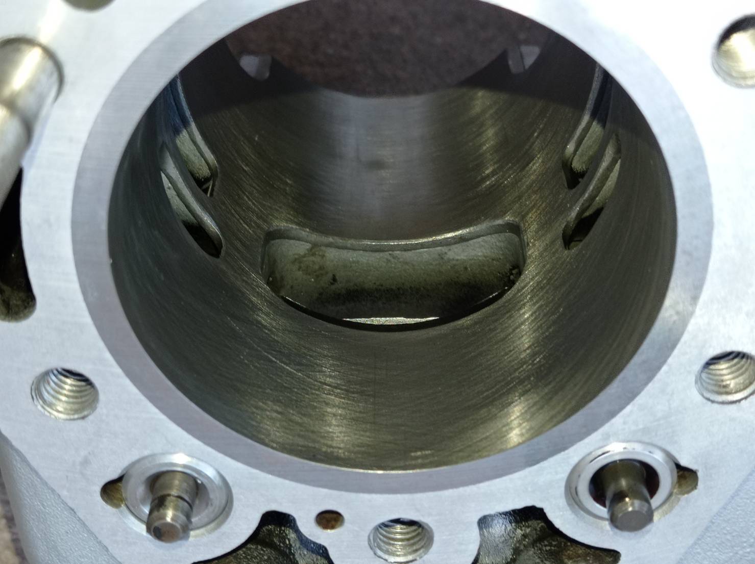

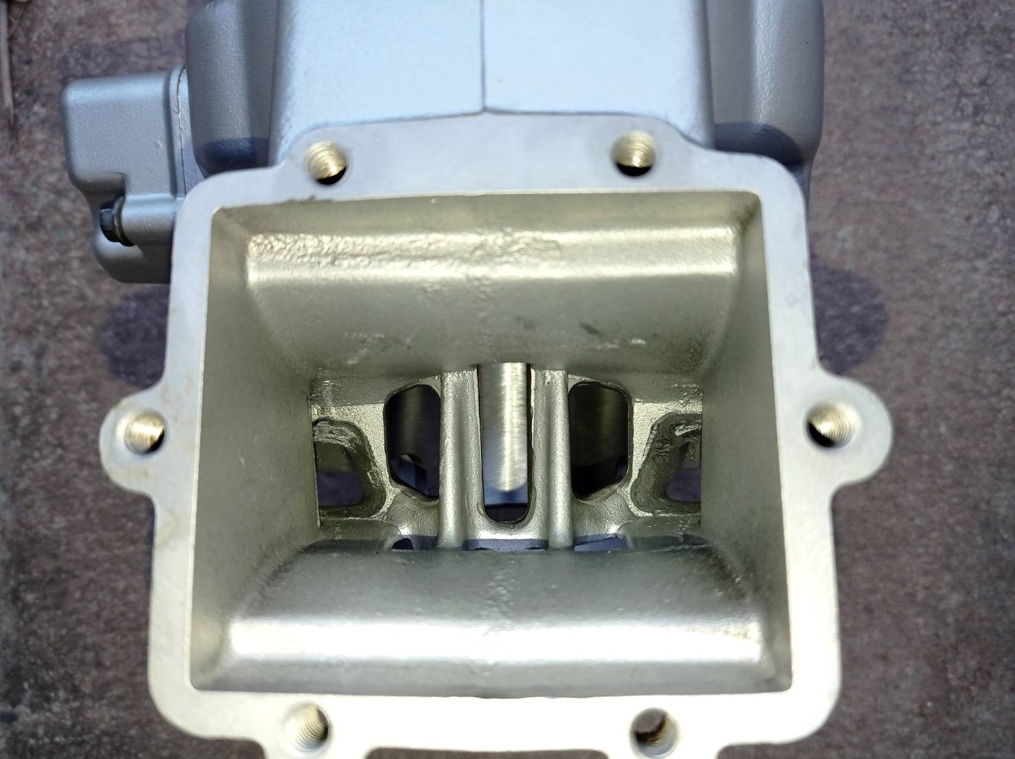

i have 2 kdx220's and just got them both sleeved, workmanship here in australia at serco was excellent ,ports lined up perfectly,i'll try post a photo for you when i get home from work, they used the la sleeve,

this is the la sleeve
- 183883_0.jpg (129.38 KiB) Viewed 36318 times
- 183882_0.jpg (130.83 KiB) Viewed 36318 times
