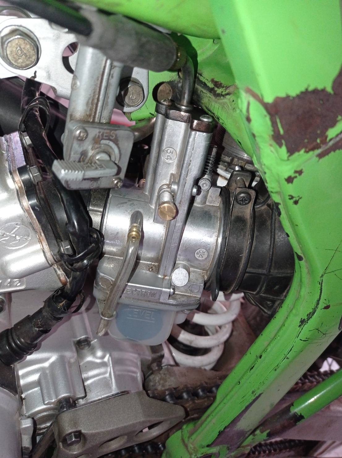

i'm yet to perfect the tuning of either the lectron or the pwk but my bike has never idled better as it does with the lectron and 70 percent of my riding is spent near idle speeds, also i have large swings in altitude and temperature and humidity so the lectron seems to tick all the boxes

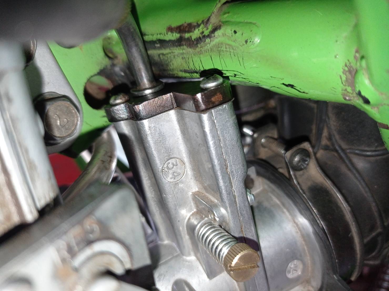

i'm just making up another custom top cap and 90 degree elbow for extra frame clearance on my other kdx, will post a photo when done as i see many people running straight cables which doesn't look functional at all

won't win any beauty competitions but here is my home made top cap,just made with grinder and file and 5mm steel, drilled for a 90 degree elbow which also takes the OEM brass adjuster nut, the 90 degree elbow is a factory item from a scooter i think and is teflon lined
the lectron top cap needs to be filed down so much that it made more sense to just make a new one and the lectron top cap has a weird brass insert that doesn't seem to fit anything metric
